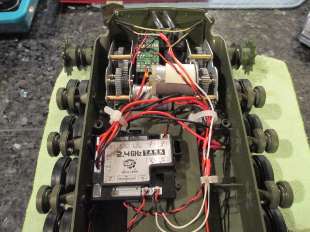

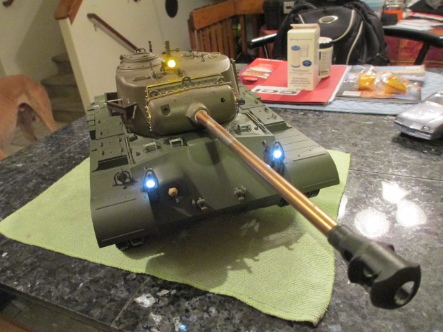

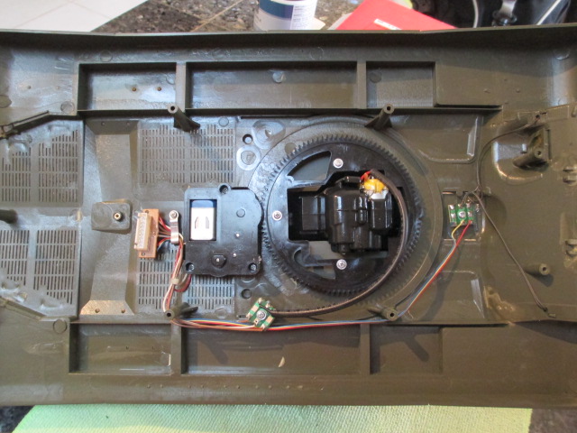

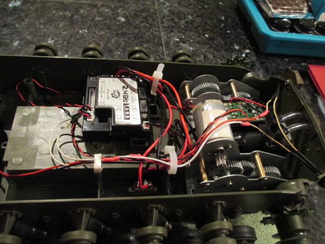

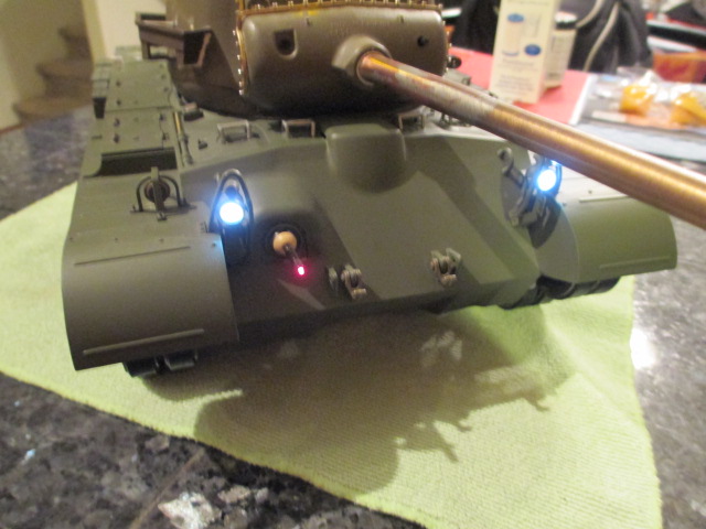

Alpha, you mean the 'Crackerbox Palace'? ;o) Last night ran late again. I discovered that the 'new' smoker I had bought over a year ago and had in storage was D.O.A. I had gotten it for the Mato Sherman then decided to save it for an eventual Pershing redo. 'Eventually' came around and BOOM!, no smoker. I spent some time doing an autopsy and discovered that the flywheel which runs the pump was bent onto the shaft freezing it in place. That fried the board no doubt so I'll have to locate one today. Hopefully one close by so shipping will not take forever. Everything else went great! Pictures:

Outside of the smoker, it wasn't so bad. One loose solder job on the On\Off switch and drilling a couple of tiedowns to screw into two of the leftover mounting posts for the old RX board left only the metal cable clamp which was a post screw as well. Then it was just a lot of plugging things in and routing through the cable tidys. I'm not going to open it up again until the new smoker from Artistic gets here next week. I got one of those clear jobbies like as came on the 'Palace'. I sent a 'Heads Up' email to Oz Armor as well where I purchased the defective one from. Can't be too mad at them, 'bad HL smokers' are to be expected. While I'm waiting, I'll touch up the Commander and paint assemble the new .50 cal and some detail bits I will be using and reusing.
P.S. New brass air soft barrel worked a treat as well. ;o)
