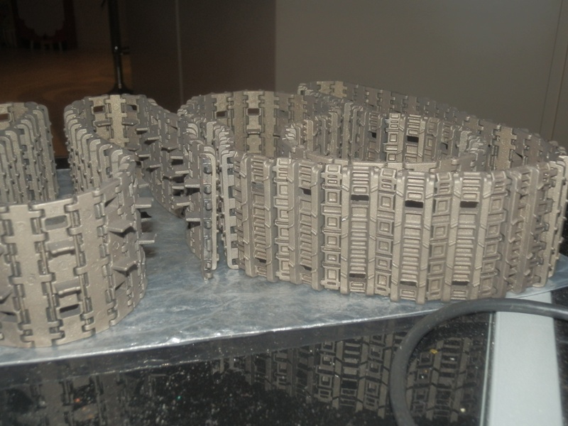

Worked up the "post traumatic eating/drinking disorder" that is xmas day food today & got the paint on the tracks.
This time I kept track of what I used.
German grey, base colour.XF 63
Red Brown, a splash, XF 64
Flat black XF 1 to tone down.
Dark Copper XF 28 to get that slight rust/weathered tinge.
Gun Metal X 10 to give the light refracting metalic look.
Entire lot made up 15mls of a tamiya mixing jar, then the thinners wentin to fill it up.
I knew from White Tiger tracks that these things would eat the paint, so a full 35 odd mls was in order.
Put the tracks outside to warm up & hit them with the airbrush.

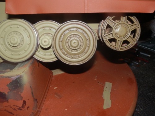

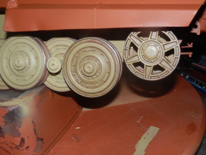

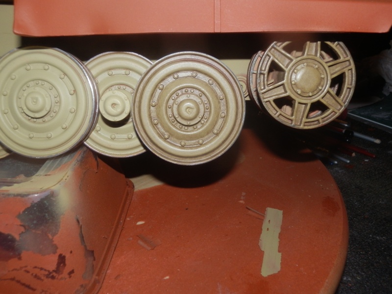

Also tonight over a few egg-noggs I tried out a Humbrol dark brown wash on a couple of spare roadwheels. Not scared off I took it to the King & did the left idler & one roadwheel to see how it ended up.
Gives a great effect of grime & dirt in the nooks of each wheel without being over the top.
I think I will use it on the entire lower hull gelb area & not use any heavy compound on the sponsons to mud up.

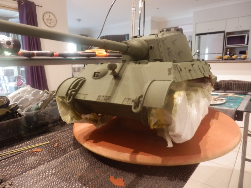

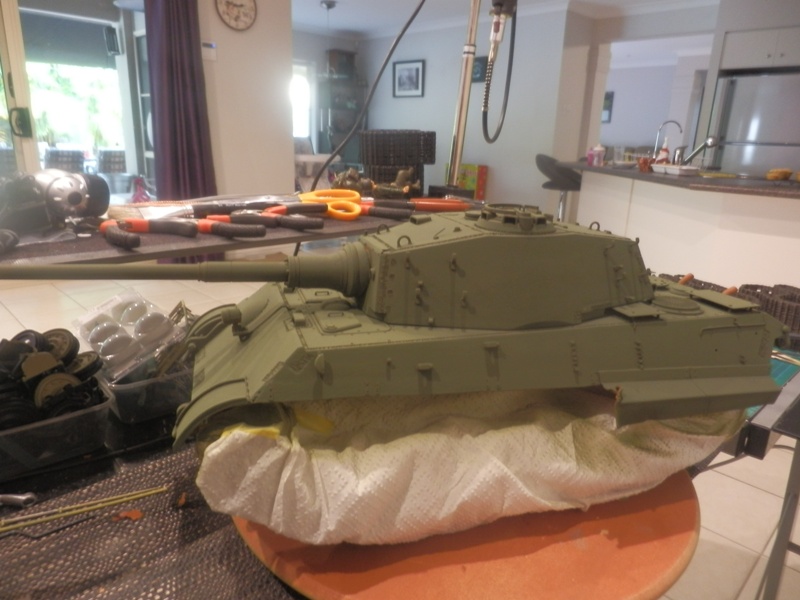

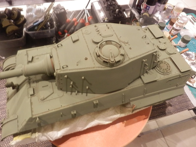

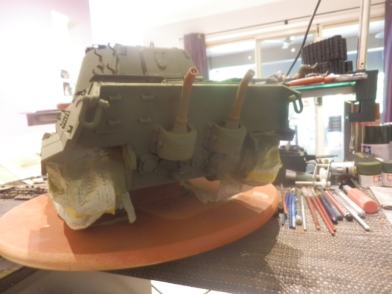

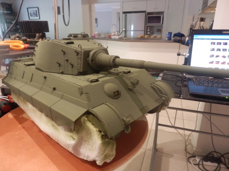

Well lads here it is................seems like I left the door open a bit last night and a Sherman sneaked in & got its freak on with my King Tiger :O :wtf:
Used a mix of XF13 JA Green & XF 58 Olive Green roughly 60/40 to give a lighter dark green than the XF 70 or 73 by itself. Dark green is just to dark after testing.
Thinned 25mls of paint 50/50 in a big mixing jar that used to hold thinners.
Rotated the turret 90 degrees & hit the rear deck. The turret overhang is long & would have left a real patch on the deck if not rotated out of the way long enough to spray the covered section.
Again with the controler on the deck, kept turning the turret out of the way until I had suffiecient cover under the areas exposed by the different positions.
Paint shortage or not at this time in the war, I cant help feeling that with the threat from the air a King Tigers greatest problem outside of fuel supply that a factory would have left the turret fixed straight ahead & painted over the outside, leaving a mosaic pattern of primer red visible from the air by a drunk ,blind pilot when the turret was rotated. :think: !
Some areas are thinner on the green than others, mainly around raised features, which shows the red oxide through just a bit.
Rushed paint application, with short supply..............thats my pick.
Still no smarts in leaving the primer under the turret exposed though :think:
Seems to have worked.
Next of course is the masking up of the gelb patches & then..................... :problem: :problem: :/

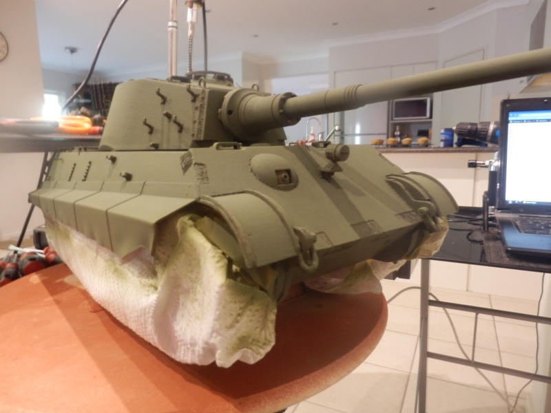

The top coat has bought out a few ticks.......................
The super glue coating on the large flat surfaces seems to have done the trick of rolled armour texture, the primer has soaked up just the right amount of top coat leaving patches of varying colour, and the green over Gelb roadwheels sure does make a contrast. The patch on the left side turned out pretty good as a first go at filling a hole.
Masking next
