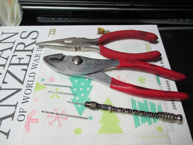

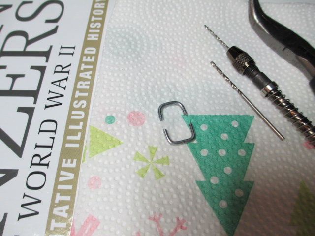

PainlessWolf wrote:22nd Day: UPS delivered Christmas Goodies I had ordered for others but no USPS today. I managed to steal a few minutes while making dinner to make a handle for the lower Engine Bay door. I had already removed the molded on slab that HL used for a handle so all that was required was to find or make a replacement. I counted up what I had in spares and what Schumo sent and I had 4 handles, enough for the turret and front hatches. No love for the needed fifth handle. No problem. I had learned this trick from Wibbly-Wobbly and used it before on my HL King Tiger which had also come with molded on hatch handles. I grabbed a small drywall brad and clipped off the head. Then I used two pair of needle nose pliers and bent it into a reasonably scale handle. A measurement and a twist with a #61 and yankee drill for a pilot hole were followed up with a 1\16 bit. A couple of drops of glue and the handle was installed and ready for eventual painting. Pictures:

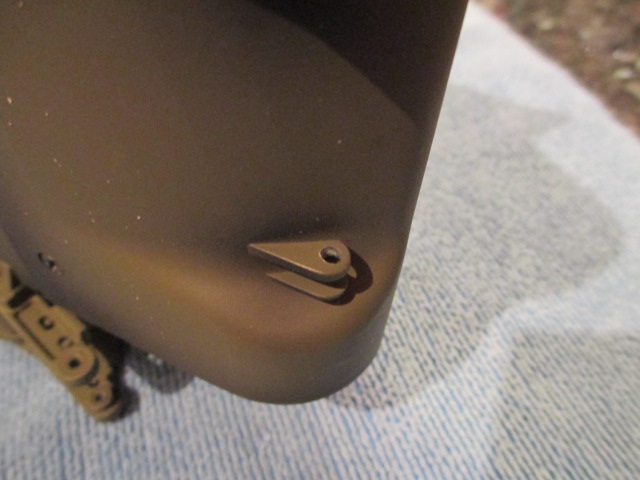

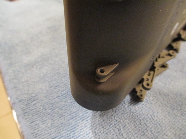

23rd Day: Last part arrived in the post. A neat feeling to have all the spare bits in place. Tonight I continued on the lower hull and drilled out the tow mounts all the way around. On the front two I will use the welded strip step. On the back two, standard tow hooks. To that end I did a test fitment after the drilling. It worked out very well. I'll use some plastic card for the front steps one of the upcoming nights here soon. Pictures:

Test fitment of the rear tow hook is a success
Test fitment of the rear tow hook is a success.JPG (84.77 KiB) Viewed 1992 times
Rear mounts drilled using a #61 for the pilot hole and a 1\16th for the final drill out
Rear mounts drilled using a num 61 for the pilot hole and a 1 16th for the final drill out.JPG (85.28 KiB) Viewed 1992 times

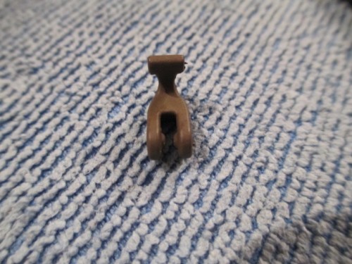

HL tow hook from a Pershing

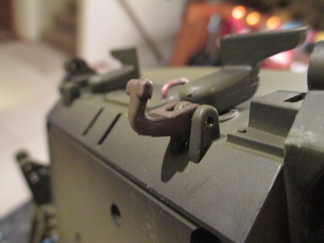

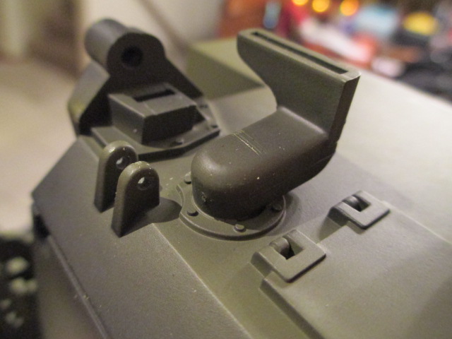

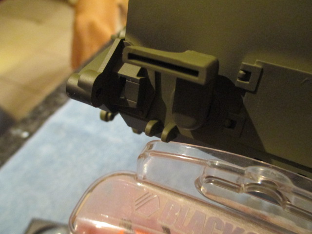

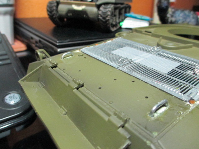

24th Day: I managed to purloin an hour while grilling some chili burgers to make two more handles from brads for the rear deck. I had miscounted the previous evening when toting up how many the tank needed overall. A #61 and a 1\16 again saw places to mount them. A little glue and then back to Christmas Eve. Pictures:
Drilled, glued and finished
Two new handles
Two new handles

Molded handles cut off previously

PainlessWolf wrote:24th Day: I managed to purloin an hour while grilling some chili burgers to make two more handles from brads for the rear deck. I had miscounted the previous evening when toting up how many the tank needed overall. A #61 and a 1\16 again saw places to mount them. A little glue and then back to Christmas Eve. Pictures:
Man Painless... you sure know how to do Christmas Eve...Chili burgers... mmmmmmmmmmmmmmm ... sets me to drooling.... hope none of it got on you Sherman... would make for some unusual weathering :haha:
It's good to watch you and Canned work on these Shermans.. you all do things that I never noticed needed to be done... like those handles you've been placing
