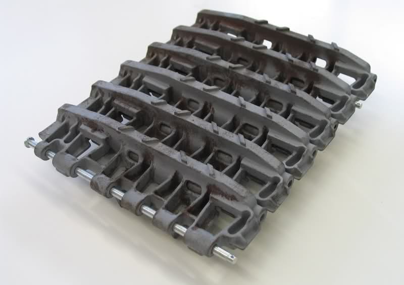

Hi What a great build you have done, Have one point which will make the tank run better and reduce the load on the gearboxes , the tracks need to be trimmed ,all the 1/16 scale King Tiger tracks are wrong , if you take a look at the photo you will see both inside and outer edges are angled which when running on hard ground reduces the amount of track in contact with the ground ( its about a 1/3 less contact) reducing this contact makes it easier to turn the tank also reduces the strain on the gearboxes and helps reduce the load on the tracks which King Tigers can snap.
regards pete
P.S. the short edge is the inside
regards pete

Hello Pete,971wright wrote:Hi What a great build you have done, Have one point which will make the tank run better and reduce the load on the gearboxes , the tracks need to be trimmed ,all the 1/16 scale King Tiger tracks are wrong , if you take a look at the photo you will see both inside and outer edges are angled which when running on hard ground reduces the amount of track in contact with the ground ( its about a 1/3 less contact) reducing this contact makes it easier to turn the tank also reduces the strain on the gearboxes and helps reduce the load on the tracks which King Tigers can snap.
regards pete
I'm wondering about your tracks; are they original?
Or are they a kind of adjusted tracks for model kingtigers? Never seen before...

Hi The tracks in the photo are armortek King Tiger tracks , I have trimmed mine to look like the photo,not exactly scale almost impossible to make each link the same if you file or dremel them, I cheated quite a bit rigged up the tank so it was running slow on one track only then sanded the track down on a belt sander they are not exact but have a shape similar to the photo at least they are all the same , it turns very easy on grass and will do fast spins if I wanted to, have run it in thick mud and not had any problems .

in General were the Henschel King Tiger of the model year 1944 delivered with the tracks Kgs 73/800/300. This track consists of two parts and was called double link track, the associated sprocket has nine teeth. This chain has a straight complete contact surface and were not angled at the outer edges.
For this reason has Torro everything done right with the used tracks, even the tread lugs are correct.
Certainly should this king tiger by Torro represent a model of the early autumn 1944. Signs for that are the still welded turret cupola and the existing armor protection on the air intake and at the hinges of the rear hatch.
A few months later, in spring 1945, was the track with the label Kgs 73/800/152 used. This is a single link track. Therefore was also again the sprocket with 18 teeth used, because it has again engaged in each chain link.
And now take a look at your tracks - certainly late single link tracks.
