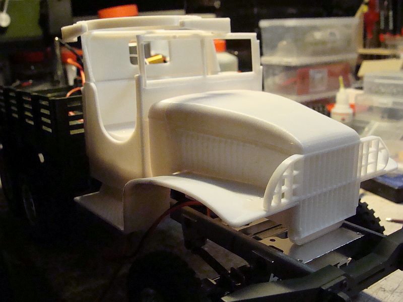

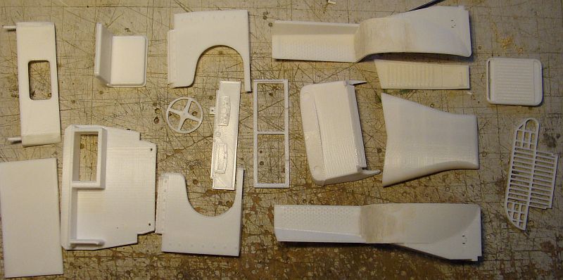

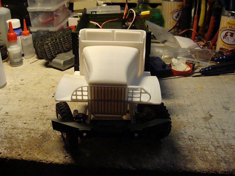

Hello,
first: a big thank you to Martin!
Here some Pictures of my WPL-Build:
first fitting
there is a lot of work neccesary,
the front bumper will replaced... and much moore
