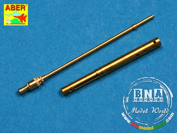

For a non-flashing MG with panzermantel (armoured sleeve) the Aber barrel has already been discussed:
The inner barrel is not hollow, so there's no way a fibre optic can be inserted, but mated to a metal standard MG34 it should look the part for a cupola mounted gun.

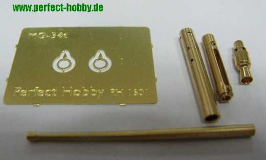

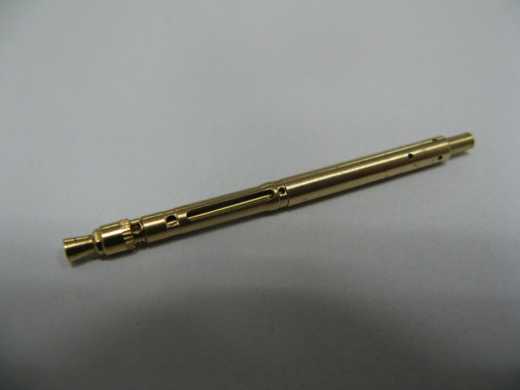

However, I also came across this pretty nifty alternative:
Perfect Hobby 2 x MG 34 Tankversion barrel with bore for light guide 1 16 assembled.jpg
Perfect Hobby 2 x MG 34 Tankversion barrel with bore for light guide 1 16 assembled.jpg (7.61 KiB) Viewed 6239 times
Perfect Hobby 2 x MG 34 Tankversion barrel with bore for light guide 1 16 component parts.jpg
Perfect Hobby 2 x MG 34 Tankversion barrel with bore for light guide 1 16 component parts.jpg (11.02 KiB) Viewed 6239 times
As the rough translation from the German says, this one does have a hollow inner barrel to take a fibre optic cable from an LED. The Perfect Hobby website is:
http://perfect-hobby.de/
As so often it is not very easy for a non-German speaker to negotiate, but Chris Hucko is a nice, friendly guy and writes back in excellent English if you send him an email. I bought the double set for 23.50 euros including postage.
Anyone know where I can find a suitable size (and colour) flashing bulb' to fit?

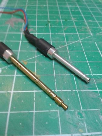

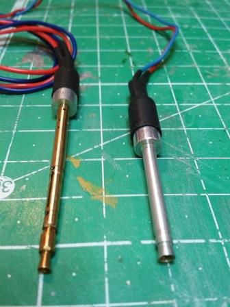

OK, OK, so I'm back from France - and I promise not to gloat any more about it. Nice to get home and find lots of goodies in the post, though!
The original Tank Modelbau MG certainly doesn't look bad....jpg (32.35 KiB) Viewed 6180 times
... but the new one is even better!.jpg (33.12 KiB) Viewed 6180 times
The better detail on the armoured jacket is very nice indeed.jpg (33.79 KiB) Viewed 6180 times
Both Tank Modelbau MG34s - new one with panzer mantel in foreground.jpg (30.45 KiB) Viewed 6180 times
Both Tank Modelbau MG34s - new one with panzer mantel on left.jpg (32.89 KiB) Viewed 6180 times
Well these pics more or less speak for themselves. The new Tank Modelbau MG 'mit panzermantel' (armoured sleeve) is a lovely piece - but I have yet to wire it up... Not sure why it's so much longer though (possibly to fit a Jagdpanther as shown on their site?)
[Update - I have now wired up the new MG and I'm delighted to say that it flashes a very realistic orange.]

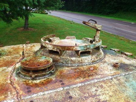

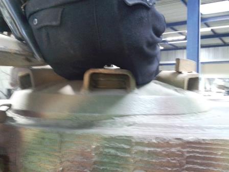

Some original cupola photos
These are shots I took of the Tigers at Vimoutiers and Saumur this year and last (and another from the web of the second Russian Tiger at Senegy(?). Obviously all are later production variants than mine with the reinforced turret roof and so it is important to bear this in mind when looking at how low the cupola appears to sit in relation to the turret roof. On an earlier Tiger like mine the roof was lower - so the cupola should stick up more...

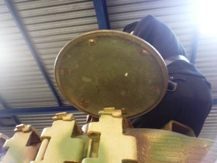

The Saumur Tiger still has six tabs on the underside of the cupola hatch - these are faithfully reproduced on the Hachette cupola.jpg

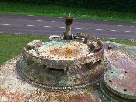

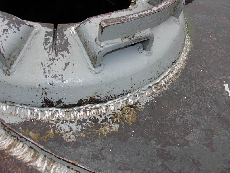

A clear view of the welding around the cupola which often fails to show up in photographs.jpg
A clear view of the welding around the cupola which often fails to show up in photographs.jpg (40.47 KiB) Viewed 6164 times

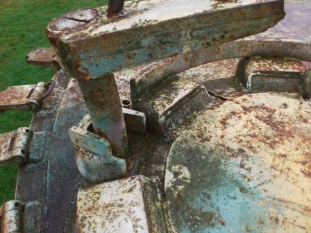

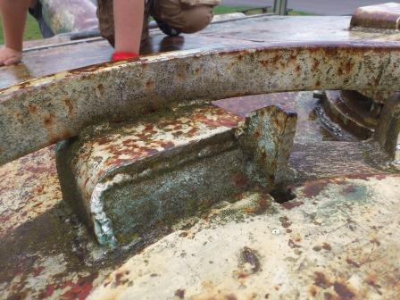

Obviously the hatch itself is missing - but note the additional tab to the pivot guard.jpg
Obviously the hatch itself is missing - but note the additional tab to the pivot guard.jpg (44.59 KiB) Viewed 6164 times

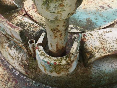

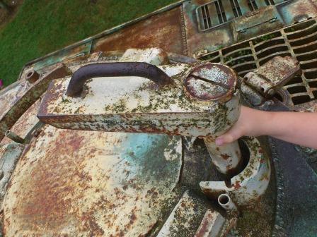

Here you can see the hatch handle, rain (or sun) cover support and the armoured sleeve around the hatch pivot (plus Arthur's hand for scale).jpg
Here you can see the hatch handle, rain (or sun) cover support and the armoured sleeve around the hatch pivot (plus Arthur's hand for scale).jpg (46.51 KiB) Viewed 6164 times

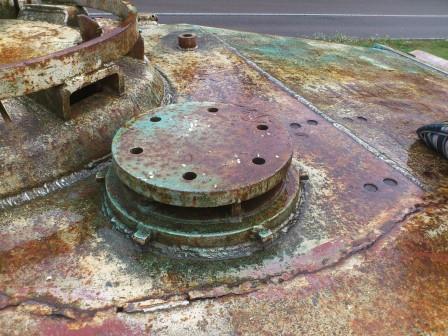

This is the weld bead across the late Tiger reinforced roof - the jagged line was an attempt to break up the tank post-war.jpg
This is the weld bead across the late Tiger reinforced roof - the jagged line was an attempt to break up the tank post-war.jpg (47.22 KiB) Viewed 6164 times
These held a soft headpad. I have no photos of it.
David
