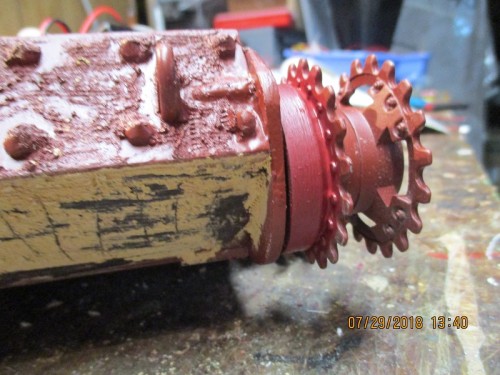

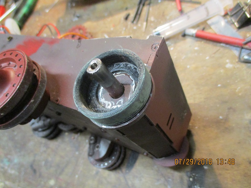

Some more parts designed and installed. Front brake drum and rear axle guard. Brake drum mounts to the wheel w/epoxy, and the rear axle guard mounts to hull with epoxy. All parts available at:

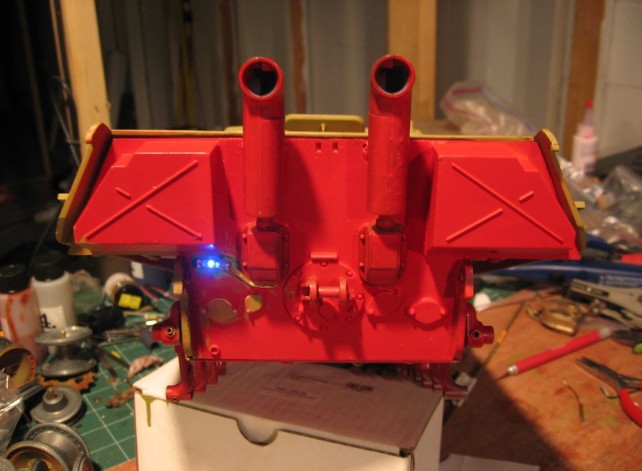

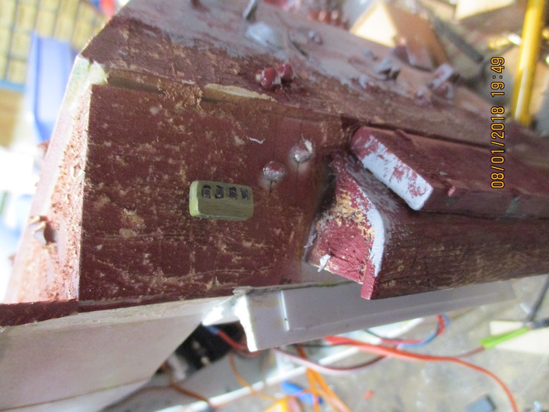

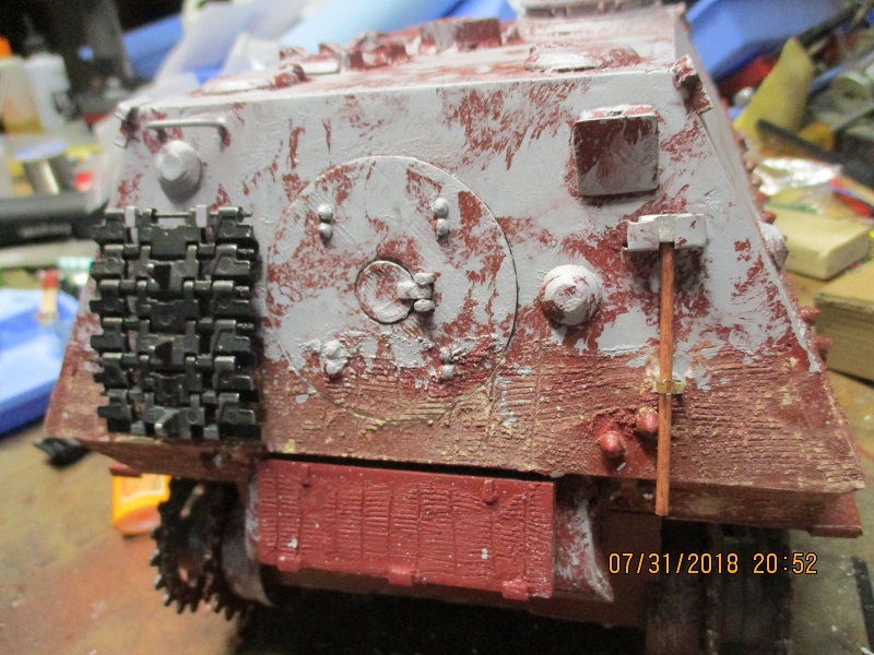

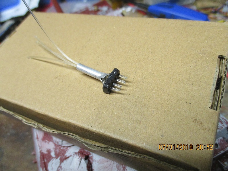

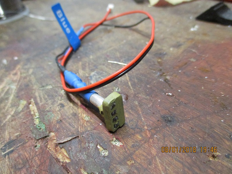

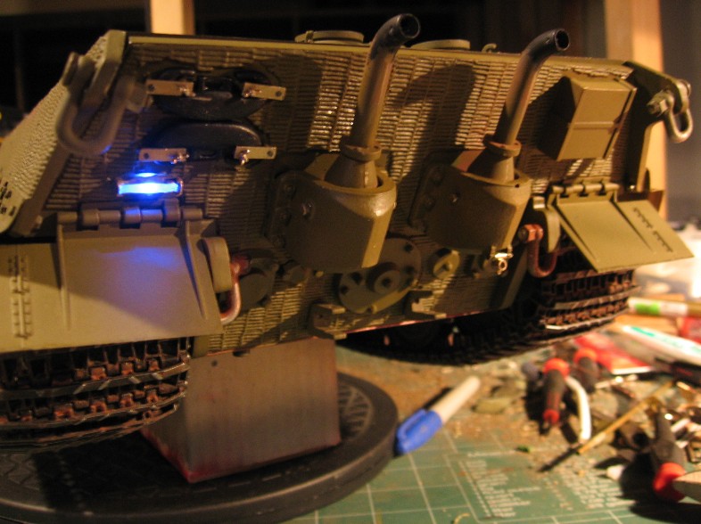

Rear convoy light 3D print. Ran some thick fishing line through for fiber LED 'lighting.' Half of the front track guards done. Wash of Tamiya basic putty thinned w/acetone for steel plate effect. Brass fittings made for rear castle....

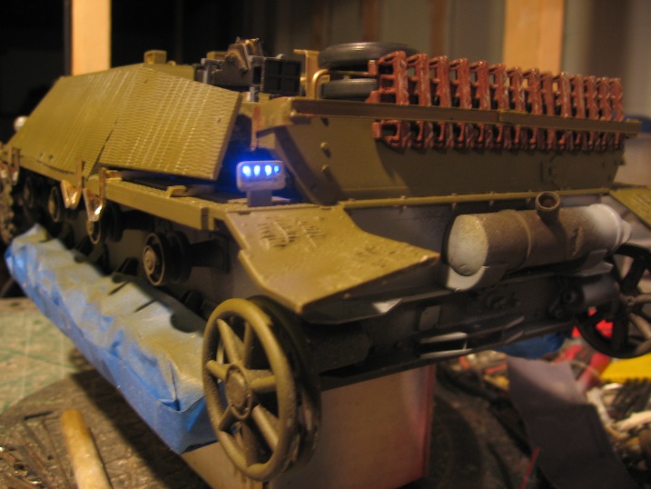

Post by xrad »

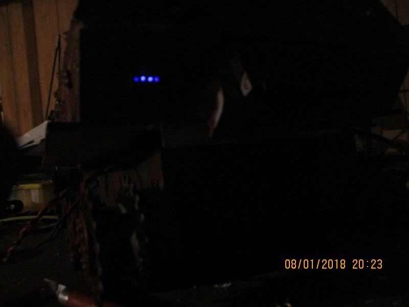

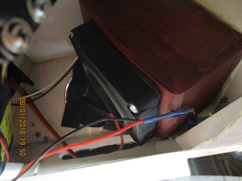

Thx Soeren. Here is convoy light in blue. 5mm LED heat shrink tube to aluminum tube holding the fiber. Luckily, it fit into body without hitting the subwoofer. The LED is plenty bright. I polished the inside ends of the fishing line w/1500 grit, but it was old poor quality line and not very reflective internally. But, I think it's scale brightness (in other words, dim).

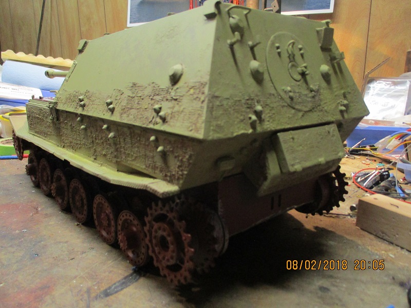

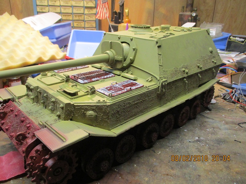

Track guard guides 3D printed and installed. Some prelim color. Looks too green in my poor lighting but supposed to be dunkelgelb.

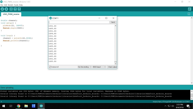

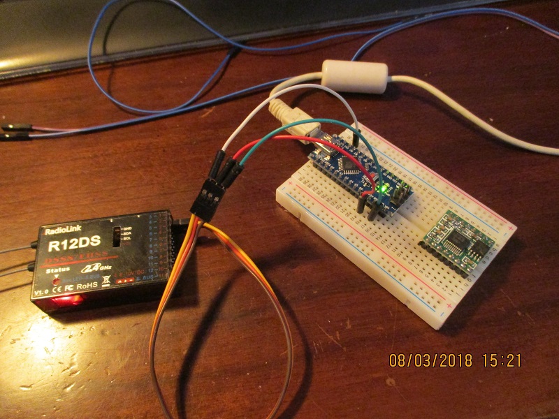

Trying out some coding for throttle sounds for fun. Using arduino NANO and WT588D.... I am able to see the pwm throttle channel input via the NANO(just one channel for now). And this then can trigger code to fire the wt588d via SPI. The wt588D can hold hundreds of mono sound bites and plays them back very fast. Obviously, I can't use Rx PWM mode when hooked up to SBUS (it's one or the other), but I can use the PWM output for the motor ESC off the OPTCB.
The milisec counter uses about 9% of memory. I am trying to get a single channel interrupt code to work which uses about 1/2 of that. will see...
decel to idle:
https://www.youtube.com/watch?v=TfwdlXcQOoc
idle loop:
https://www.youtube.com/watch?v=piGIMMeNRMM
you have to turn up the volume, only a .5watt amp...
