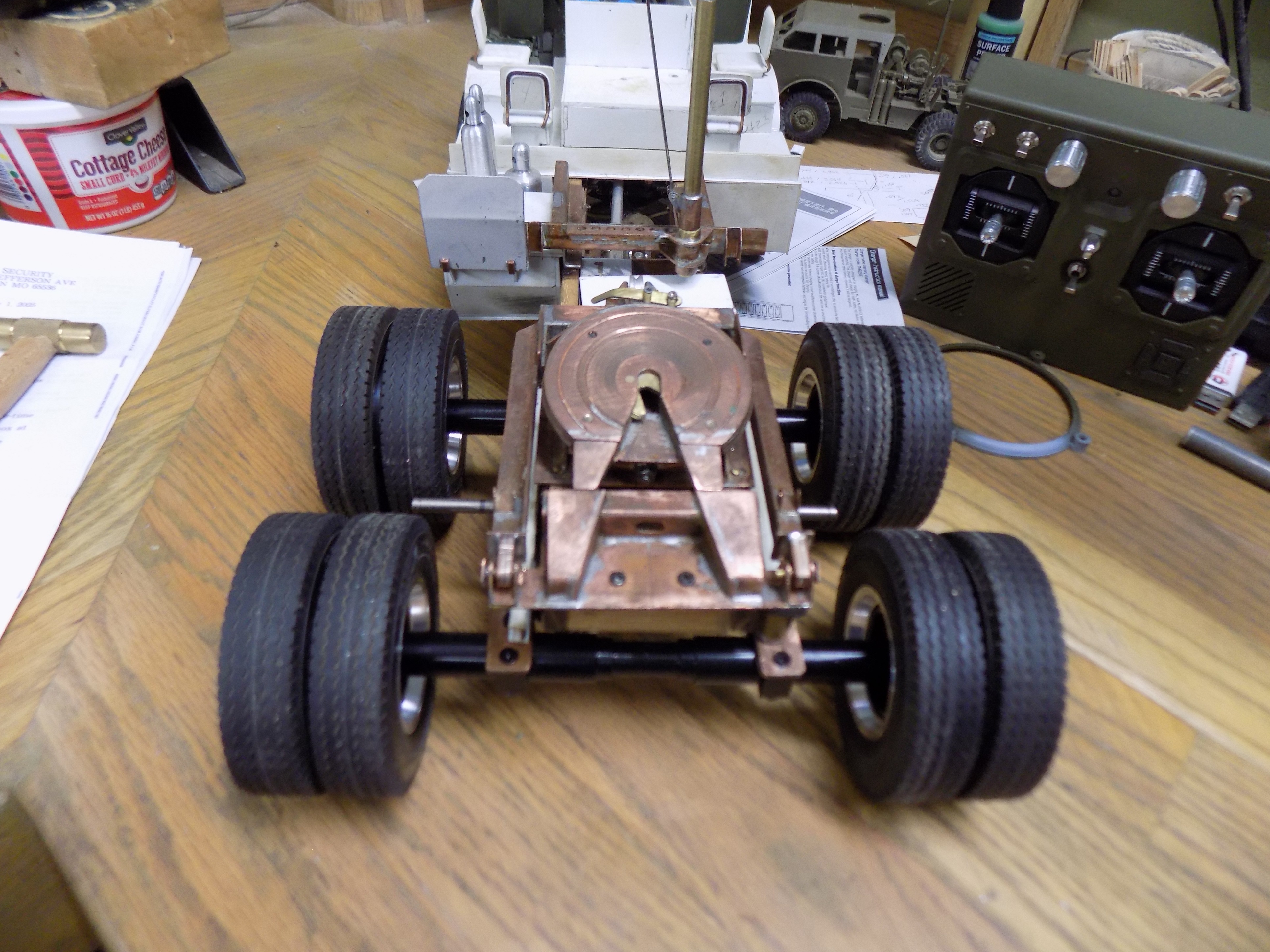

Wider trailer axles showed up and were installed on the D.W. Swapping out the axles was less fun than creating the suspension in the first place (believe me when I say I cursed the engineer). Unlike today's semi trucks, the steer axle track is the same as the inner rear tires (similar to a current dually pick-up).
97 rs.jpg (2.4 MiB) Viewed 697 times

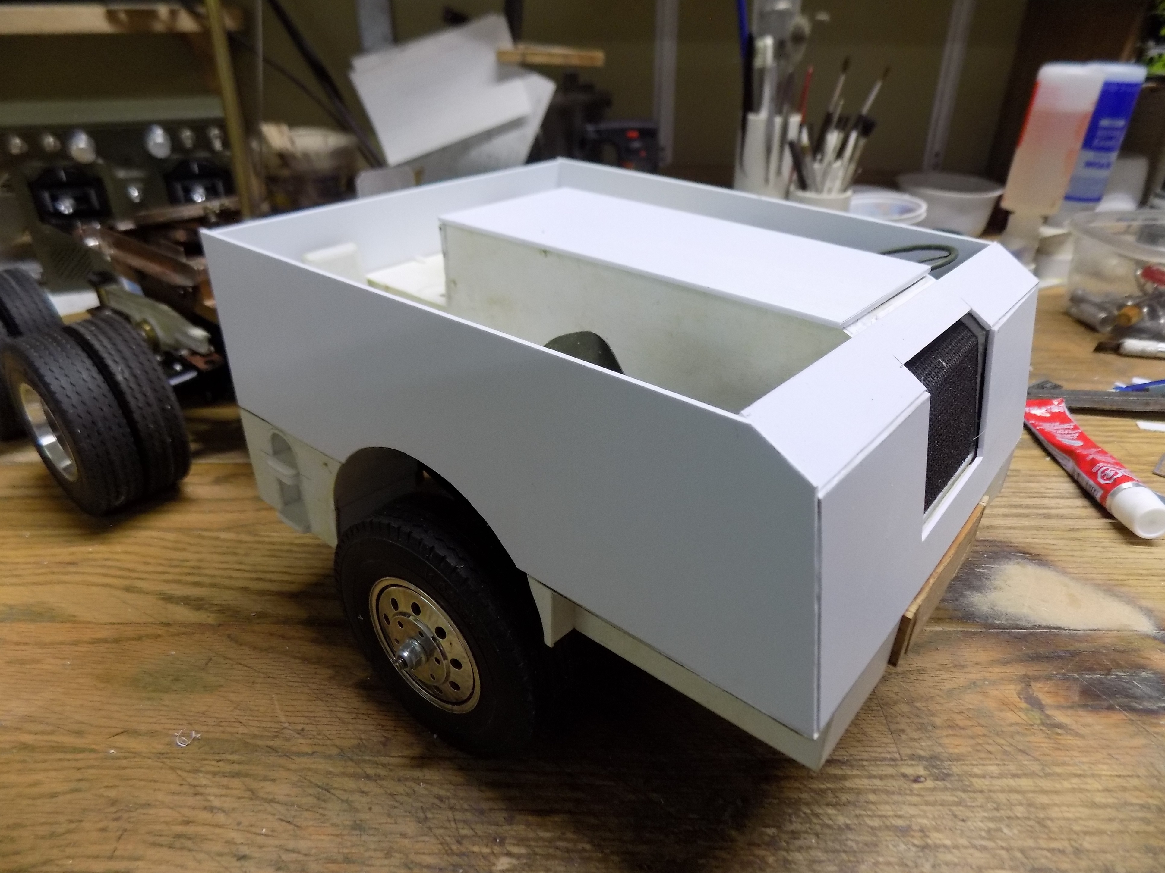

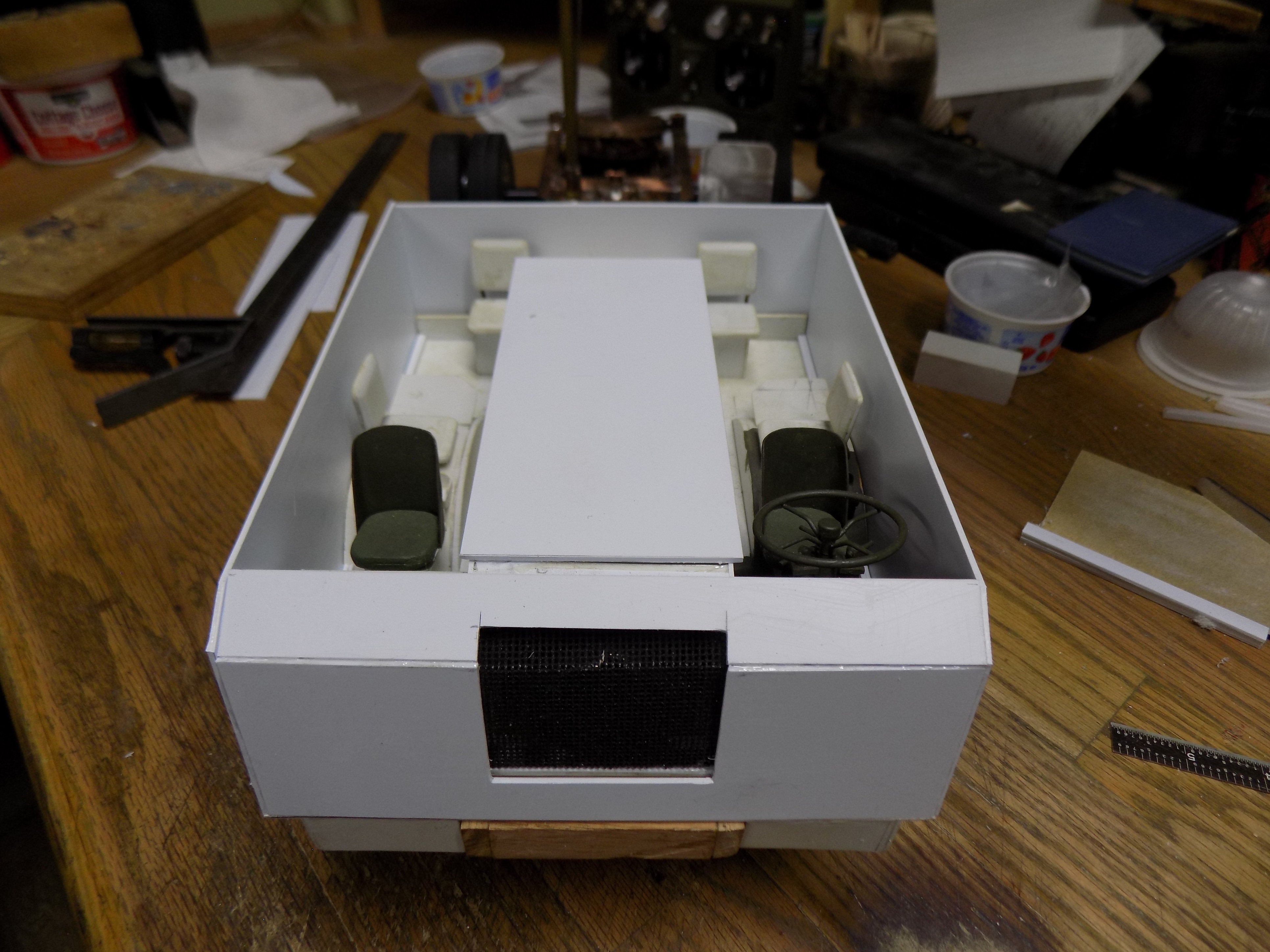

Starting the non armored cab (soft cab). There is laminated styrene in the front corners and where the nose leans back to the windshield allowing some shaping to get the round corners. I won't start the shaping until tomorrow when the glue is fully set. Door openings to follow. The upper part of the cab will be removable for now (is tacked in place at the moment).
98 rs.jpg (2.12 MiB) Viewed 696 times
99 rs.jpg (1.88 MiB) Viewed 696 times
100 rs.jpg (238.16 KiB) Viewed 696 times

Look at those seats in the cab, this thing is huge!!
Great work!
