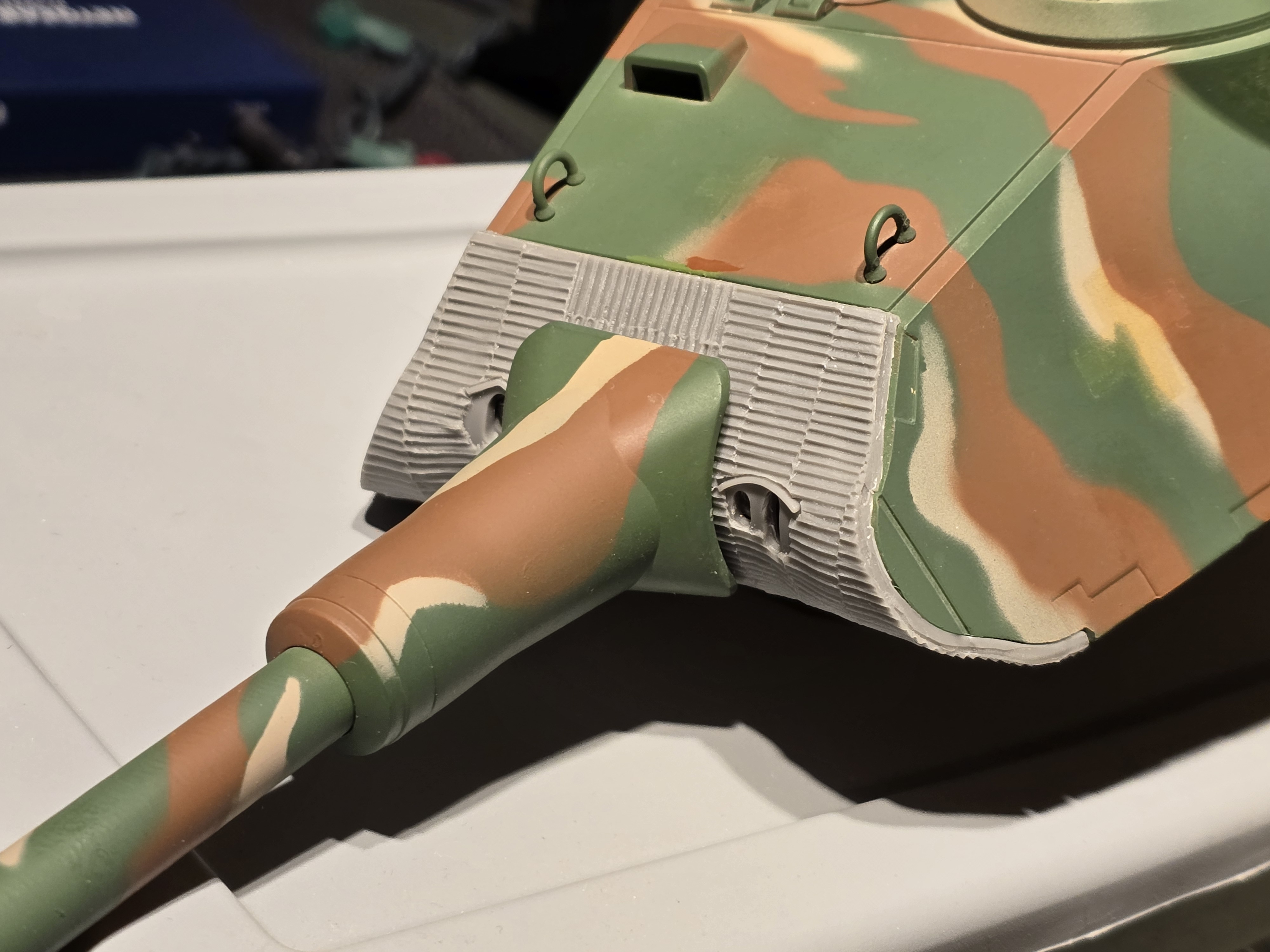

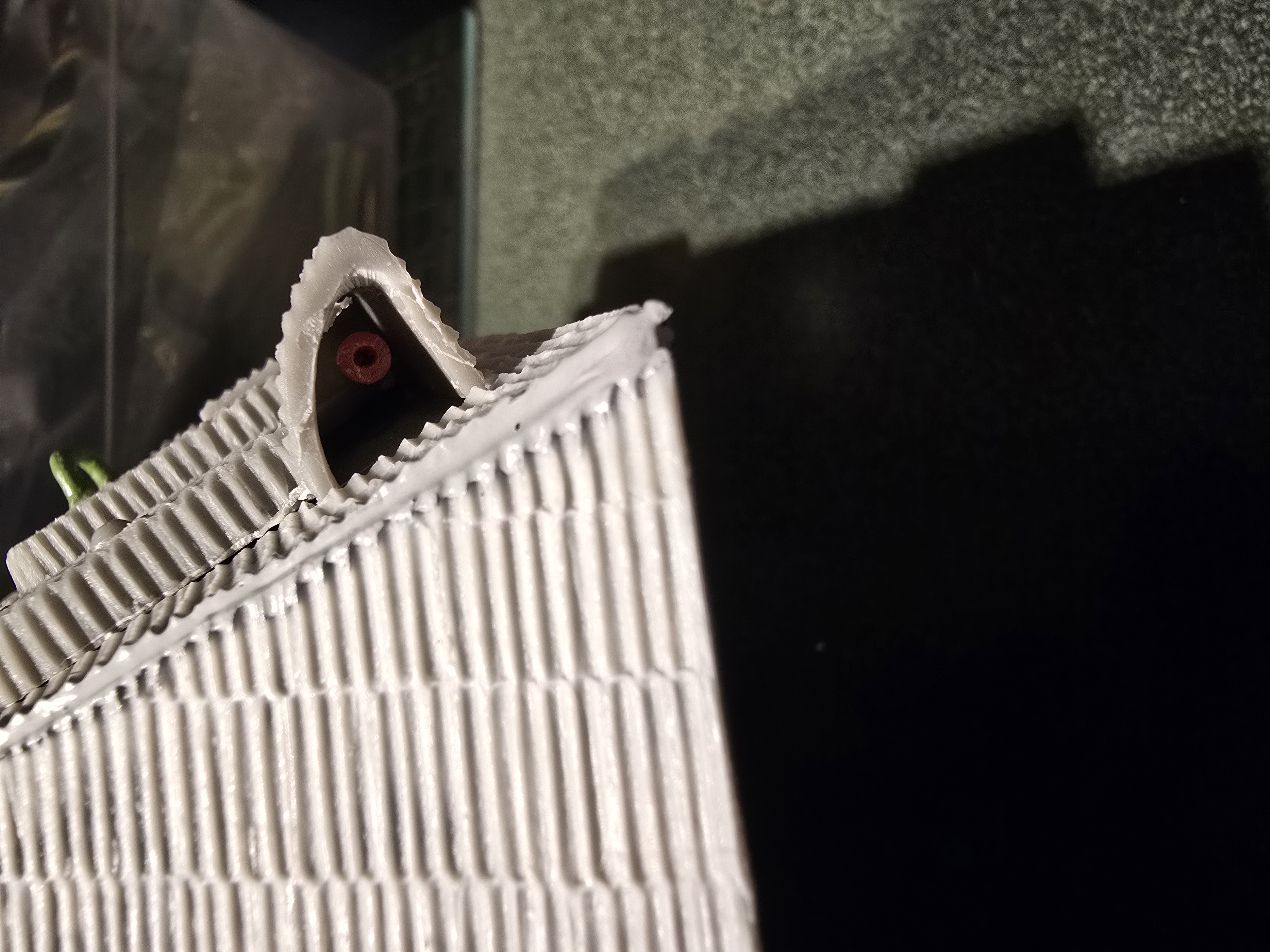

Last night, I removed the ancient HL Decals/Stickers from the Turret. I used a new type of razor blade, a plastic one, perfect for Hobby purposes. Some light sanding using 800 grit paper removed the last of the residue. The whole process was easier than I had anticipated. Time for new Cement and ATAK application.

The original 'P' turret mantlet from Heng Long can be disassembled (I know since I just repaired damage done to mine from years ago in the factory
) There should be aftermarket pieces available from Sites like Ludwigs or Tank Modelbau. Or you can go Louis' route and rebuild the original HL mantlet correctly.

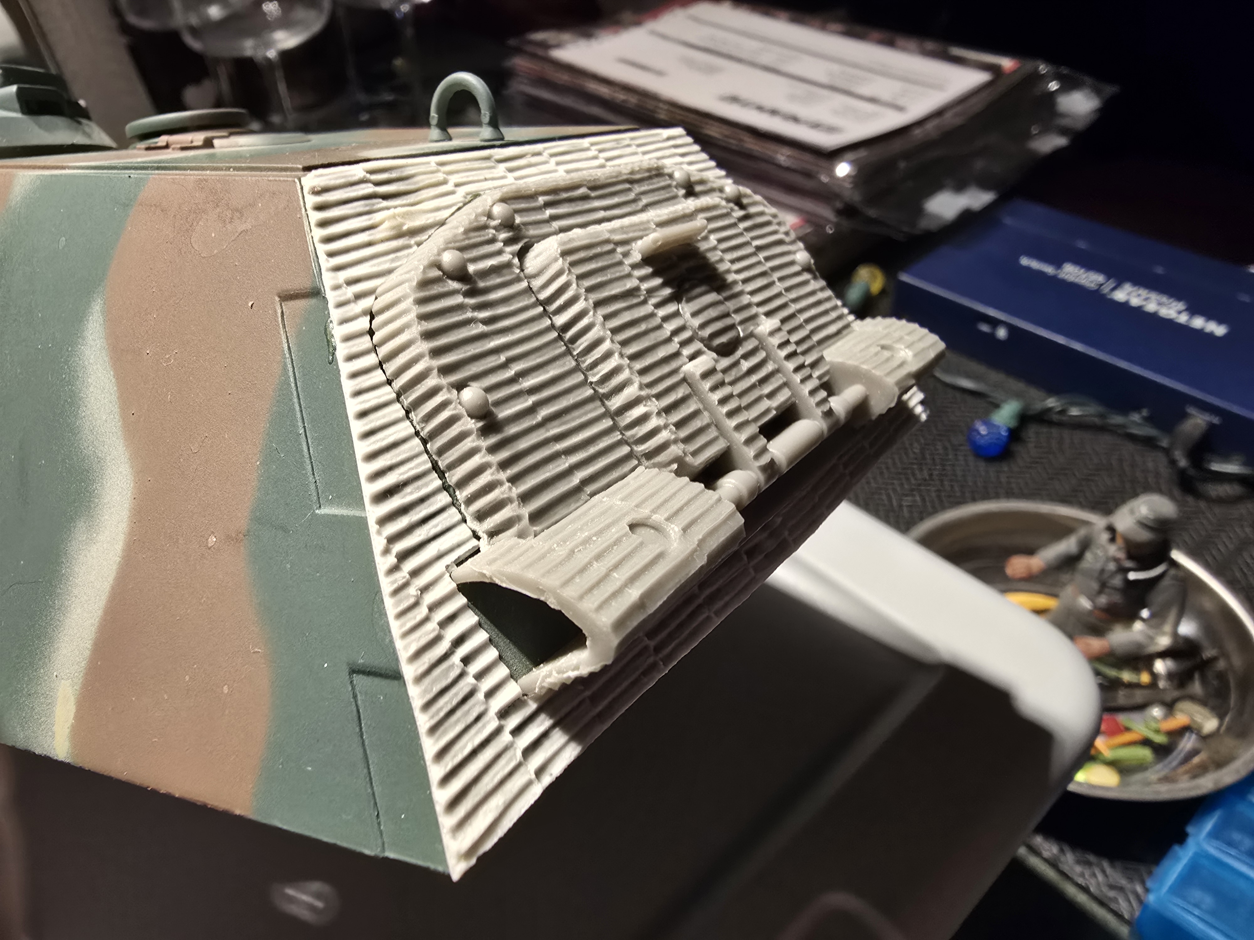

More Turret Work on the 'P'. ATAK applied and spare track holders(drilled and glued into place). A little modeling work was needed on the ATAK rear hatch piece. I drilled out the access holes and put false hinge bars in there as well as replaced the handle nub with an original wire one. On to details and Brass work next...
