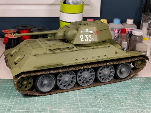

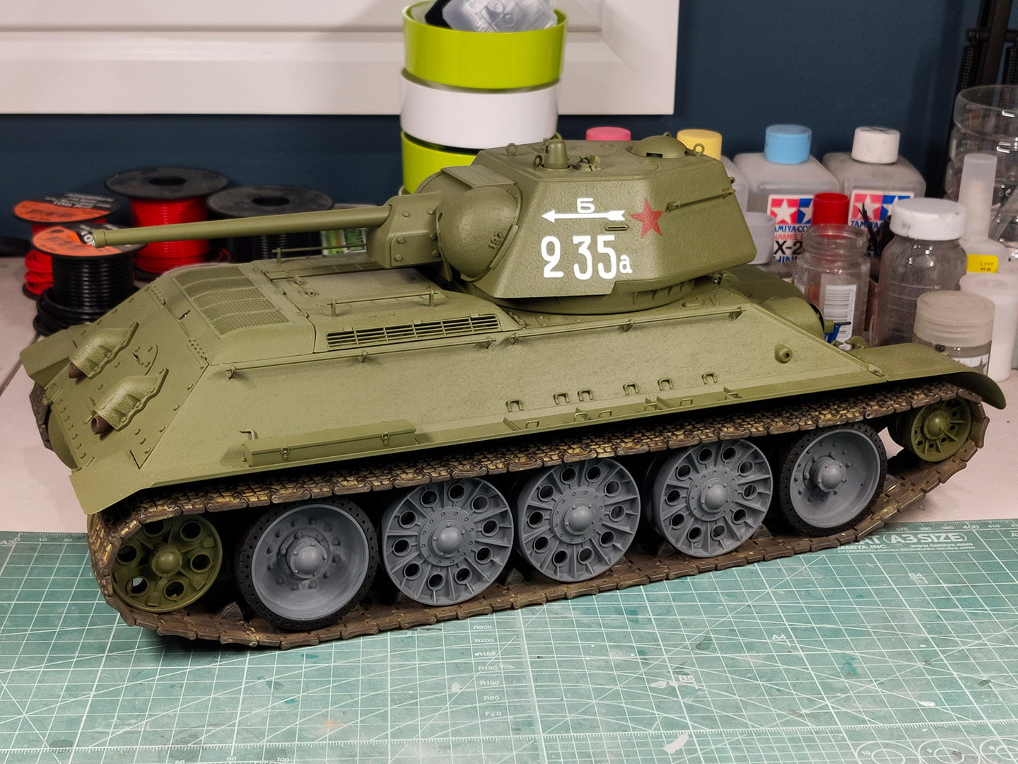

After an hour or two sanding the surfaces that are visible or contact the tracks, I've got my T-34 sat on a full set of printed wheels (the front and rearmost have printed early-style tyres too). I might finally get off my arse and finish the damn thing before Herman forcibly adopts it!

Just completed mine too. The flash, recoil and IR set certainly filled the small turret but to my surprise it all works really well. If you look close you'll spot that l've fitted a rather more discrete IR detector module, home brew, that's at least as good as the original Taigen apple but somewhat smaller.
I will apply my normal lightweight weathering this afternoon, nothing more than a light rain shower over a dusty body!
Now, the road wheels. They are Taigen metal on axles one and five and modified ballraced Trumpeter wheels on two to four. I doubt you'd find better but your printed ones look just as fine - a genuine well done.
Regards your front and rear roadwheels off the ground, just reduce the track tension a little. It does look a little tight but that's how Taigen supply them. I add a pair of links each side then adjust the tension and all is good.

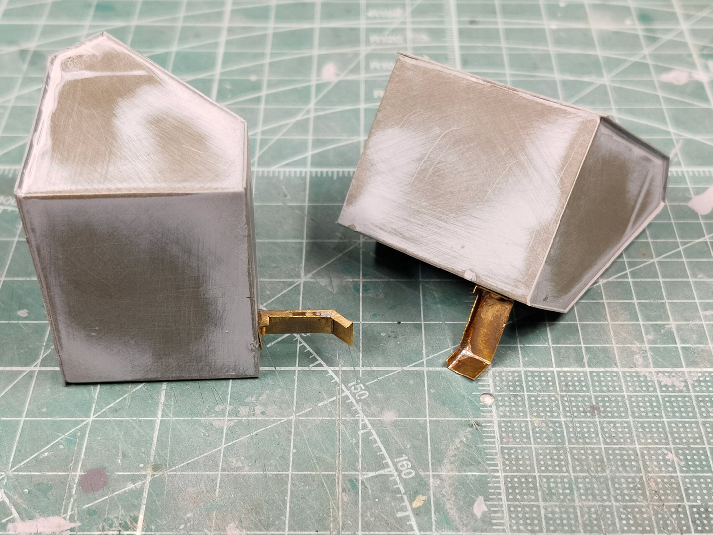

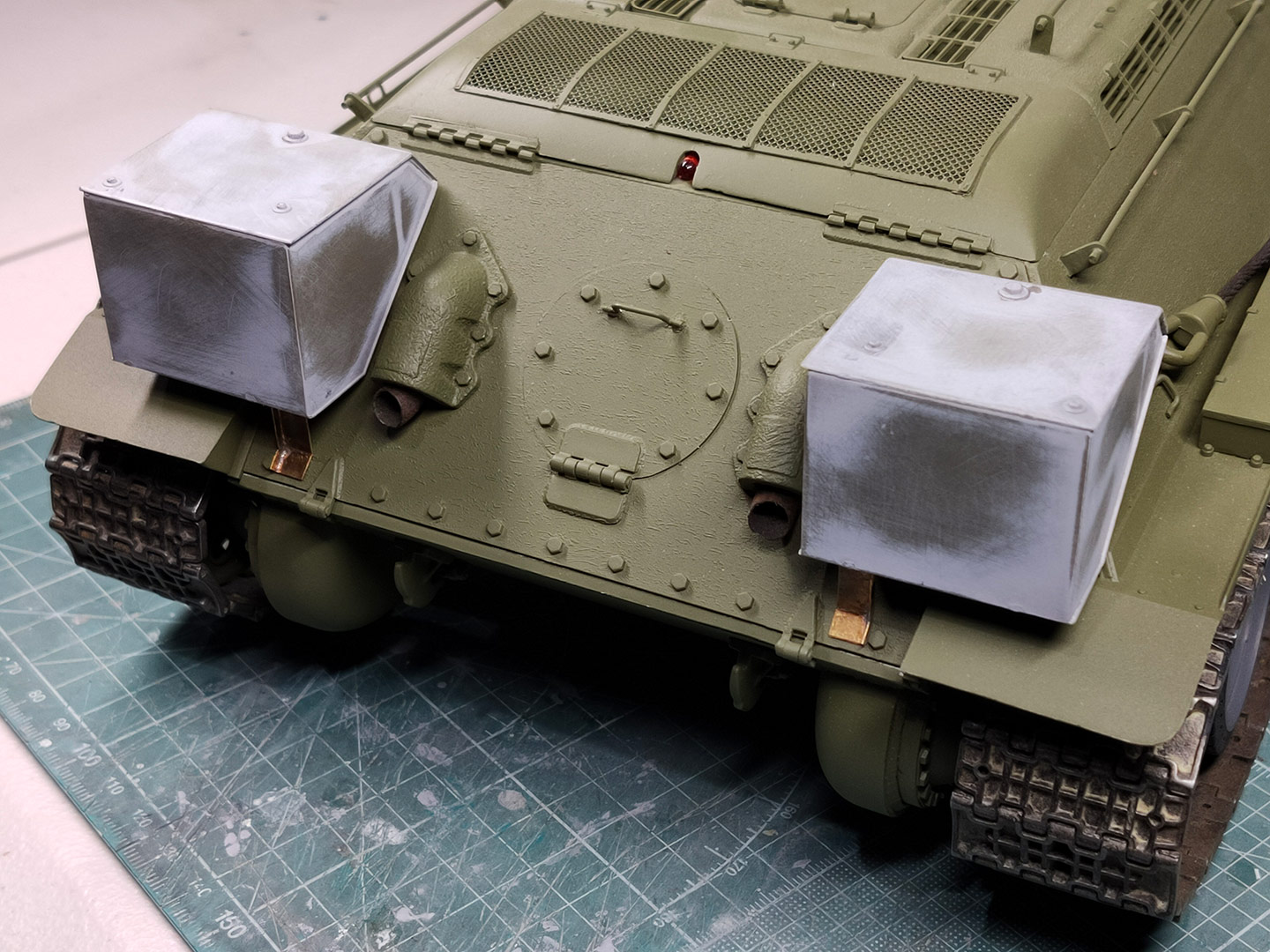

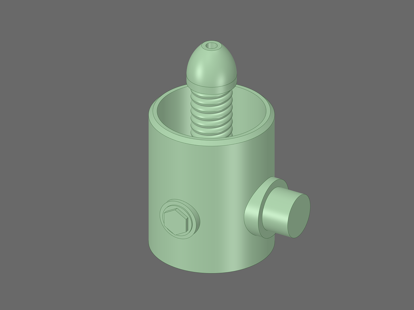

Spent a few evenings over the last week or so catching up on a few nagging little jobs on the T-34 while waiting for the reinforcements and upgrades for the printer to finally arrive. I really wanted the fuel tanks back on after I broke and lost the kit photoetch, so I finished off some stronger brass replacements. Drilled and pinned with Aber faux bolts.

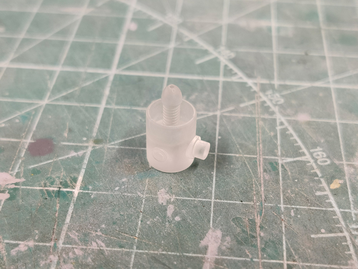

The other important detail that got lost down the laundry sink was the antenna mount, I drew one up based on photos and blueprints:
Printed in Siraya Tech Blu:

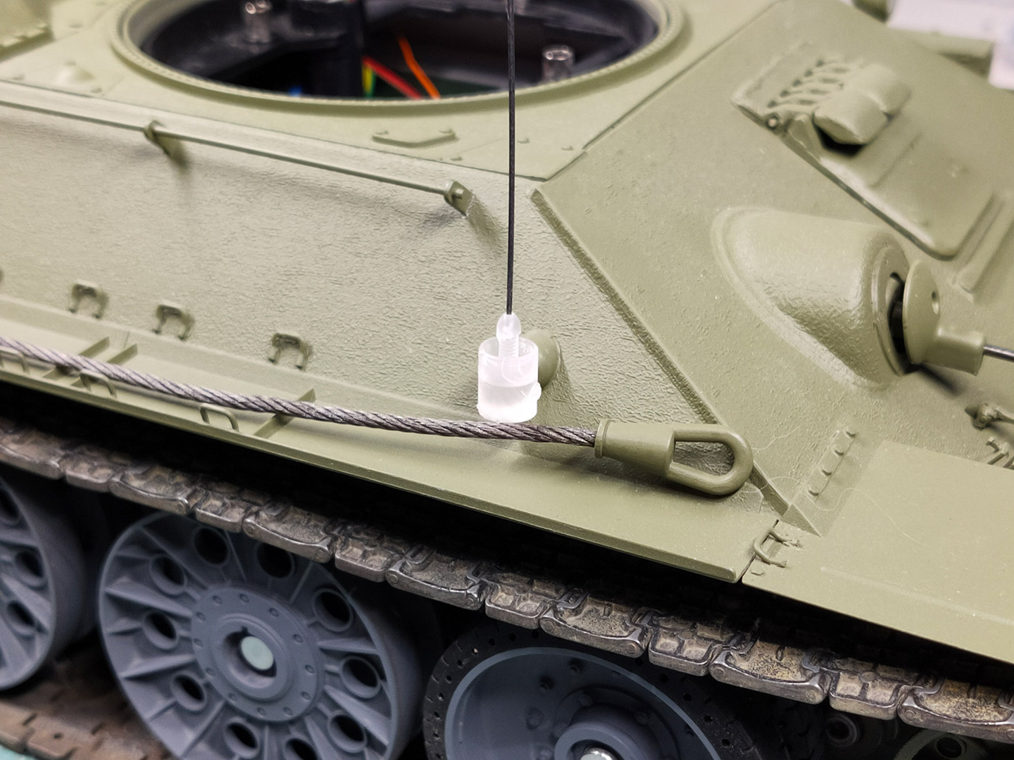

Drilled to accept the old metal antenna and dry fit in place:
I've got all of the reinforcements and upgrades installed on the printer, it probably weighs twice as much as it used to. The printer's all made out of aluminium and plastic, but now it's got a huge bracket made of 304 stainless holding the Z-axis in position. First few prints are looking promising, so I should be able to get those wheels I owe Herman for the SU-85 done soon!
