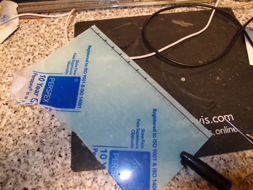

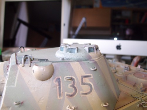

Getting near the end , periscopes from perspex.
3 mm light green perspex
Noticed a little fix required ,lifting loop needs some filler/weld.

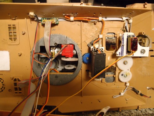

Drivers covered scope, checking if i glued the moving visor when i added the perspex . The barrel has some paint or grit stopping the recoil action , another turret strip down

Cool periscope movement! Please remind me which control board and receiver you’re using and how you made your periscope movable. I somehow missed those pieces of information.

Back in the '90s l used to have a 6 wheel Tyrrell P34 that had a Jackie Stewart figure who's head turned with the 4 front wheels. I did this by fitting a micro servo directly into his neck (!) and then mixed the steering channel to direct the servo.
I guess you've done something similar here, the auto mixing saving you having to control the periscope separately? You can of course still operate it manually on a tranny control. Unused to like to spook the other drivers by making Jackie stare at them on the start line!

Hi Jimster Its an Elmod fusion pro f board, just a spektrum 6ch receiver and the servo is in one socket set for the steering .
Easy fix, remove drivers visor, drill out the circle, fit tube for strength, cylinder to fit for gear in hull and refit visor on top.
Pic on page 7 , not played about with the sounds yet.

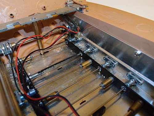

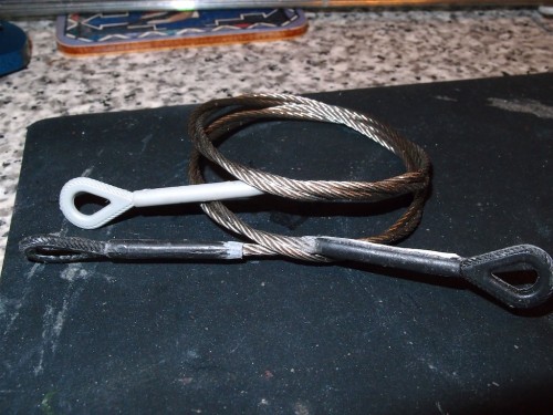

Hi LordPanzer Thanks for the praise , having a bog standard tank is a waste. Always try to have something extra or a little different , even if it goes wrong on a few occasions . Cast the tow eyelets and working on a firmer suspension using hacksaw blades on a spare hull.
Dark eyelets are cast ,light one is Trumpeter and SS wire from the boatyard.
Test for stronger suspension 3 cut junior hacksaw blades . Will try 4 sets front and back, need a slightly bigger brass sleeve on the fixed side.

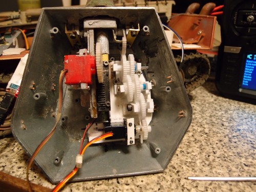

Elevation servo was stuttering and the metal barrel needed a counterweight to make life easy for the servo. A new setup ,don't like the elevation +/- speed . Made a rough gearbox to slow it right down. 1st version only moves a few degrees with a standard servo, continuous one ordered for 3/4 seconds or more for the travel. Need to have a search for the time it takes for max elevation.
Will make another with 2 rows of gears while waiting for a continuous servo.

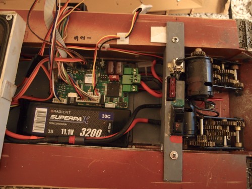

Tried my new continuous servo, a fail . Wonder if its the servo or the stick on the transmitter fluttering , no amount of playing with the pot on the servo would stop it in the neutral position on stick . Tried a few recalibrations on the TX, back to the original servo setup. Fitted a fuse to save any issues if i had a short between the battery and the board :O .
Redone elevation with a smaller geared servo.
Safe now fuse fitted, don't want a LIPO going bang.
