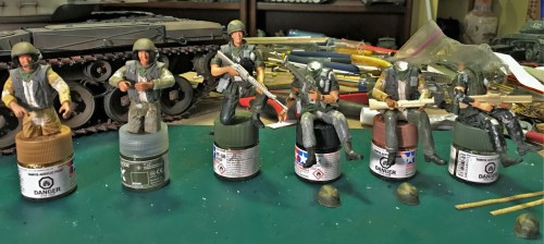

The construction of the figures is finished. As this is a build, i am showing them in details prior to painting so that you can see the construction in case you would like to do something similar.
The Army of the Republic of Vietnam (ARVN) or Armee Nationale Vietnamienne was created by the French during the Indochina war and was highly influenced by it. Its material was mostly WW2 and Korea vintage US weapons and gears with tight fitting indigenous uniforms of various colors and makers. More modern US material was later integrated, such as 1 million M-16 rifles, M-79, M-60 MG, flak jackets and gears.
I am picturing an M-41 in the 1973 to 75 period. As such, the mechanized infantry would be considered more "elite", better clothed and equipped than regional forces. And towards the end of the war, surplus US material would be more consistent. There are very few pictures or books on the subject, so I did my best to represent such unit.
Overview of the 6 figures. I previously showed the tank crew so I will focus on the 4 infantrymen on this post.

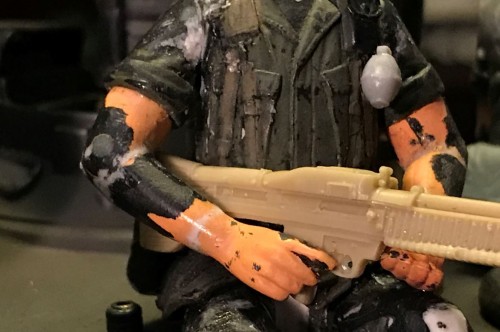

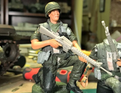

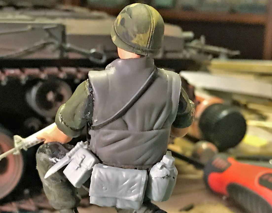

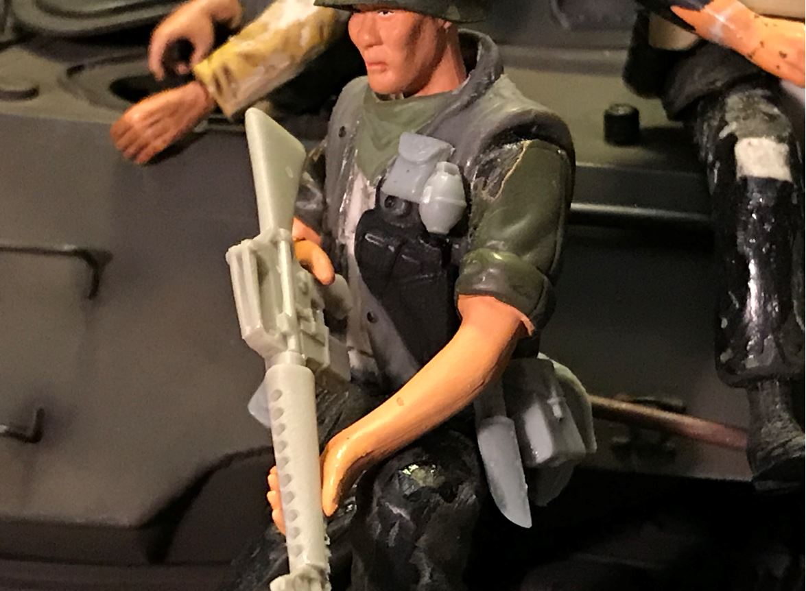

This is the squad leader, armed with Reedees M-16A1. Helmet, body and uniform come from 1/18 Ultimate Soldier 173rd Brigade, Vietnam series. Flak Jacket is from the M-48 tank crew. His gear comes from the 1/16 Dragon Vietnam seal figure.
Squad leader
Squad leader
Squad leader
Squad leader
Squad leader
Squad leader

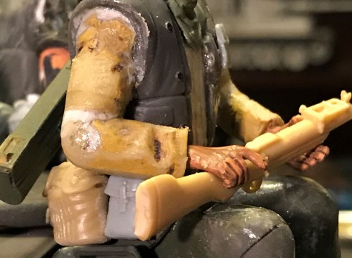

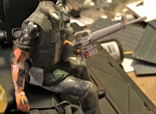

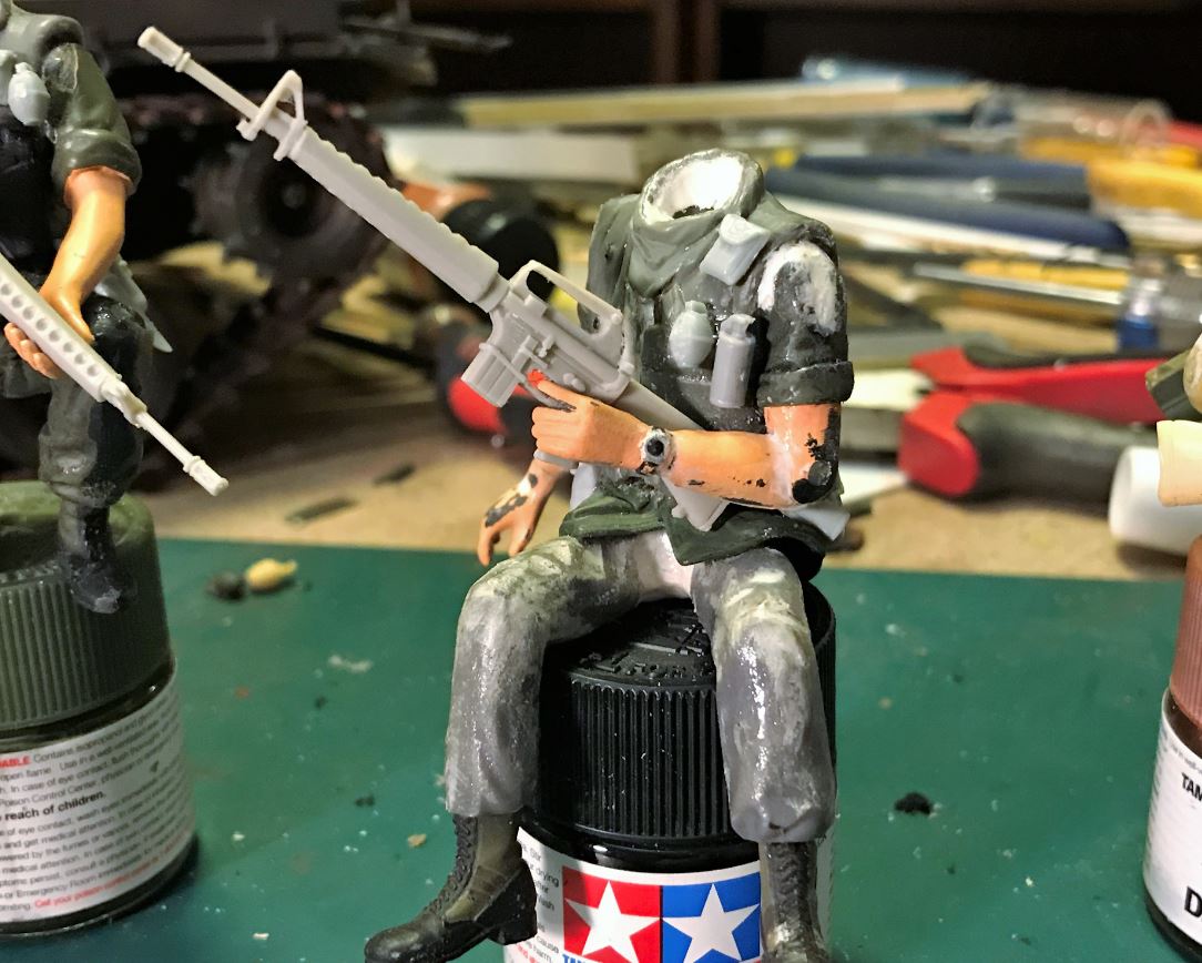

This is the M-16A1 rifleman. Ideally, I would have given him a AN-PRC 77 radio but did not find one. I will have to create one from scratch if I really want one. Legs and flak jacket are from the M-48 tank crew, the legs were trimmed a lot. Gears are from the 1/16 Dragon Vietnam seal figure. Helmet, lower jacket and arms are from the 173rd brigade figure, arms positioned with the rifle, adjustment points glued in place and then sanded smooth.
M16 rifleman
M16 rifleman
M16 rifleman
M16 rifleman
M16 rifleman
M16 rifleman

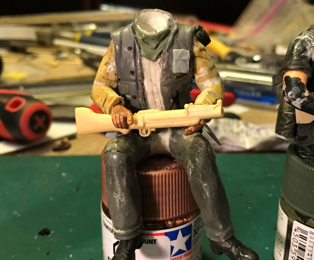

This infantry man is armed with a Verlinden M-79 grenade launcher. You likely have seen one in action in the movie Apocalypse Now at the Do Long Bridge scene where the soldier called Roach says "He's close man, real close". He is also equipped with a Verlinden M-72 LAW (Light Anti-tank Weapon) rocket launcher in case some VNA T-54 or PT-76 are encountered. Legs and flak jacket are from the M-48 tank crew. Legs were trimmed a lot, no side pockets. Gears are from the 1/16 Dragon Vietnam seal figure. Arms are from the Japanese Imperial Marines figure, positioned with the M-79, adjustment points glued in place and then sanded smooth. Helmet and lower jacket from the 173rd Brigade figure.
M79 gunner
M79 gunner
M79 gunner
M79 gunner
M79 gunner
M79 gunner

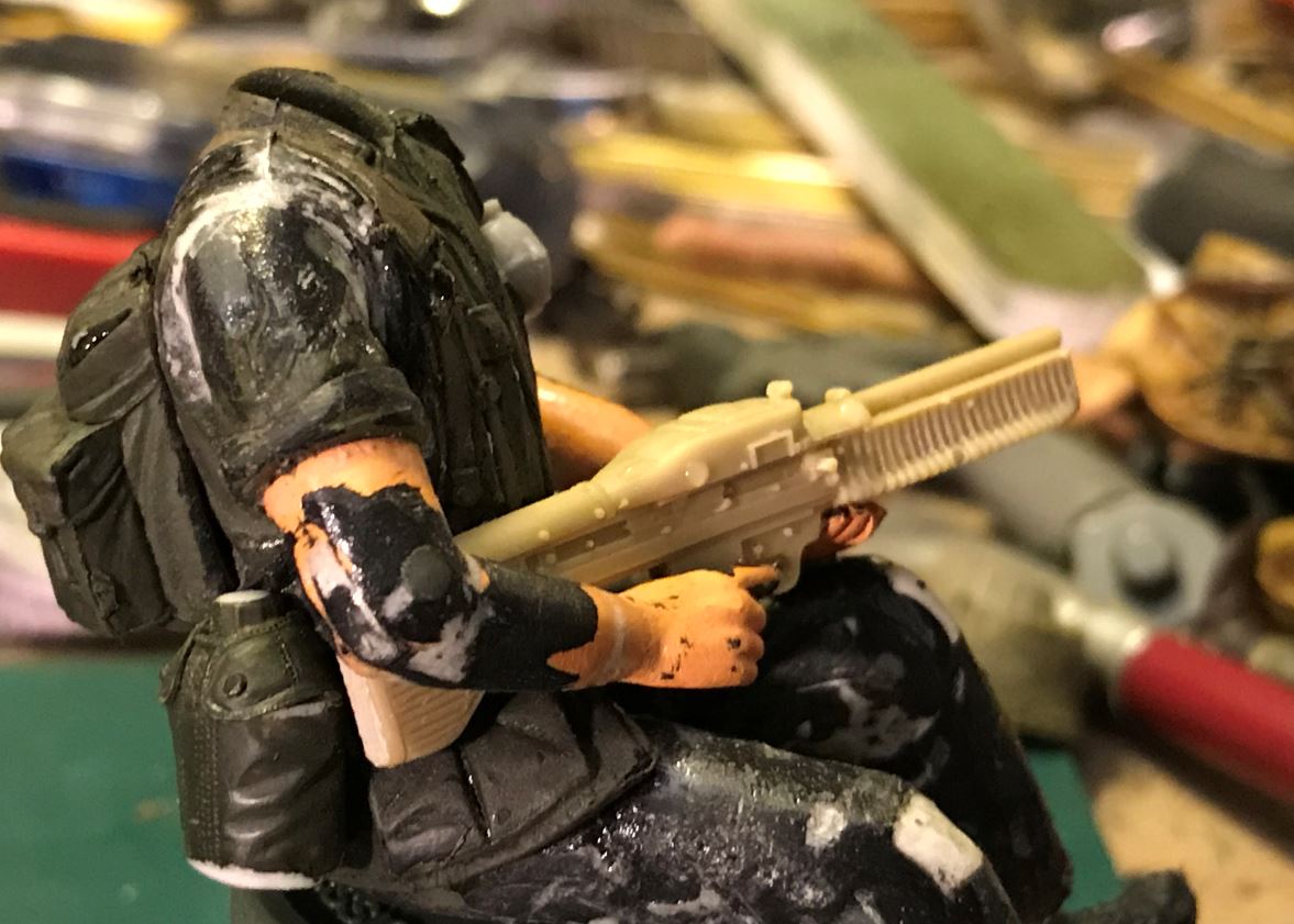

Continuing with the Infantry build up

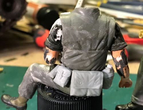

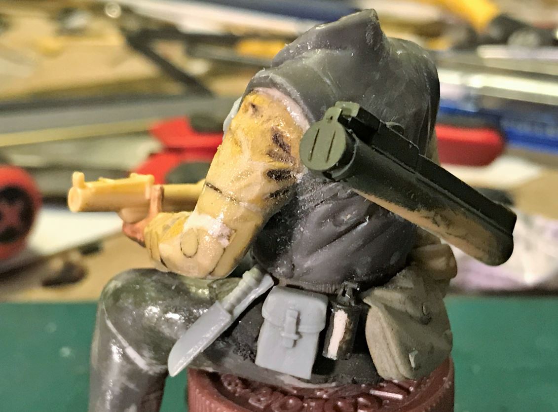

This is the machine gunner armed with a Verlinden M-60 from the M-113 ACAV conversion kit. The helmet and body are from the 173rd Brigade series. He does not have a flak jacket, I wanted to create some variations, so he is equipped with a small back pack instead. You can see the flexible arms and legs, positioned, glued in place, putty applied then sanded smooth. It will be provided with MG ammo around his neck and body. The M-60 will be assembled later because it is fragile.
On all figures, you may have noticed that superglue was applied to all areas where putty or heavy Dremel sanding was done, this is to solidify the surface and make it more even, which is then polished with a fine grain nail file. Superglue is a very polyvalent tool.
M60 Machine gunner
M60 Machine gunner
M60 Machine gunner
M60 Machine gunner

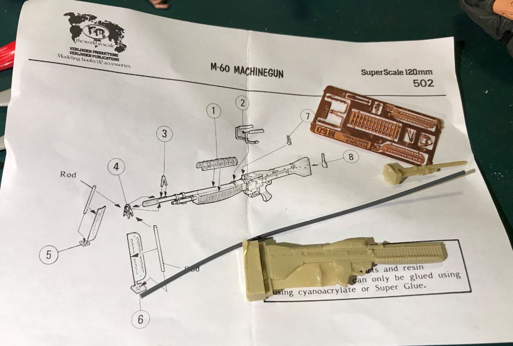

This is the Verlinden M-60 from the ACAV conversion kit which contains 2 M-60 MG in addition to the armor. These are the best 1/16 M-60 on the market, but they are fragile and construction of them is tricky, so they must be the last thing you will do on such build. These are currently on sale at 60% discount at Lots of Models (40% + 20% special discount) so these are a real bargain, and I have stocked up on them. Once they are gone, these will be difficult to find because these are discontinued.

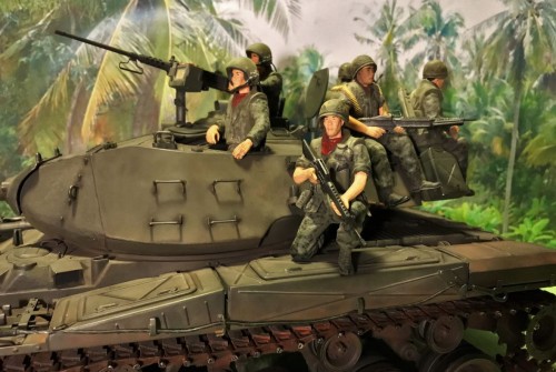

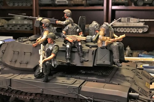

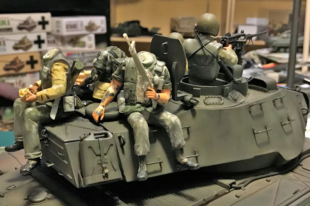

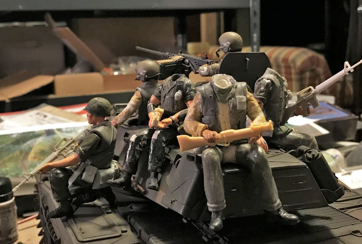

This is the general placement of the figures on the tank. Although the 2 tank crew will be fixed in place, the infantry will be removable when the tank is played with.
The idea is to show an M-41 riding through a wooden South Vietnam valley jungle road, with low visibility all around. So the crew is nervous, on the lookout for ambush, and is ready to fight at any moment.

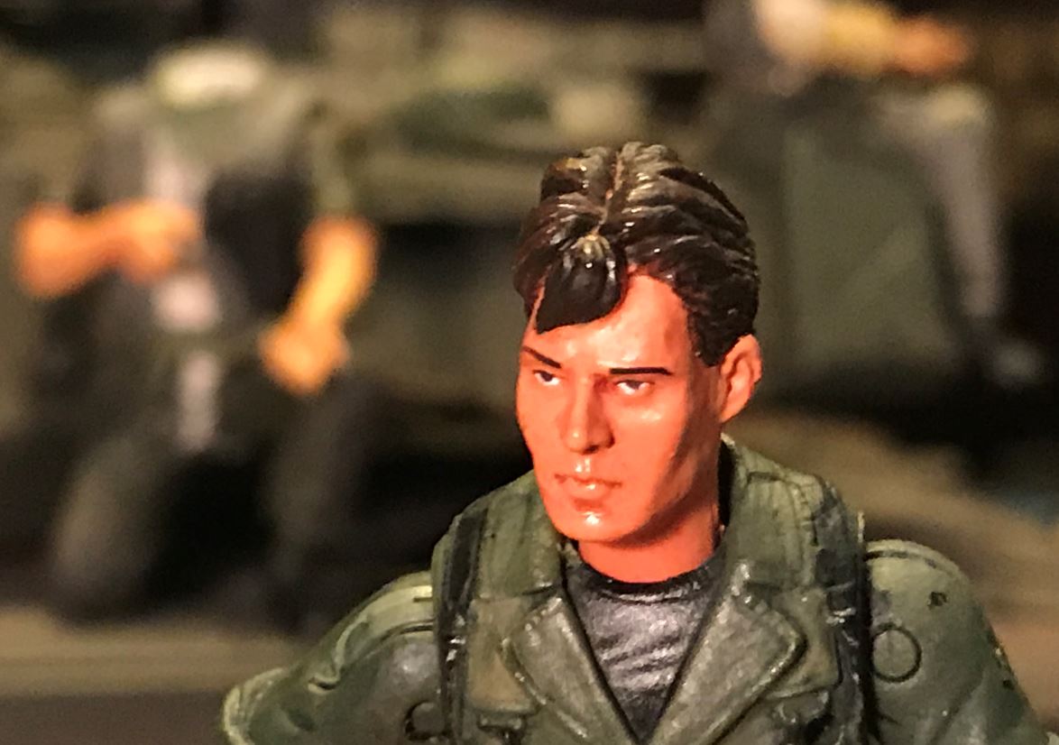

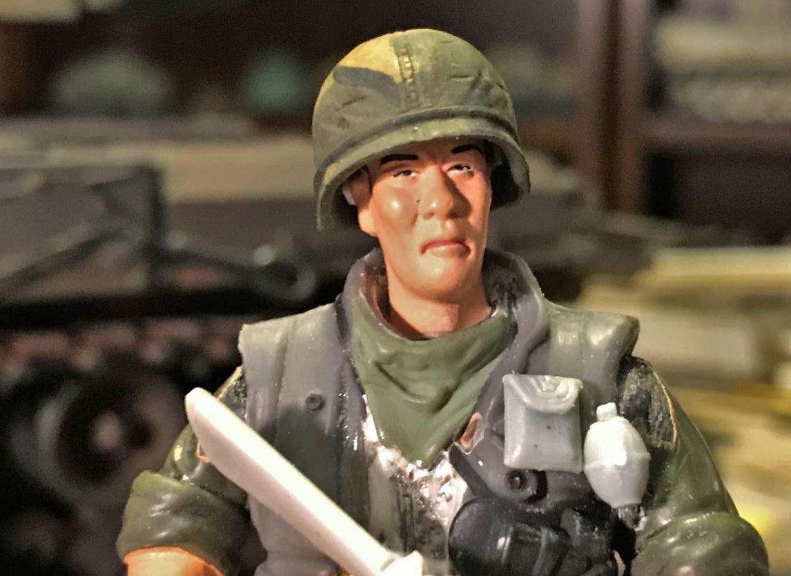

Next step is to paint the figures, and to install all the heads which are all coming from the Ultimate Soldier Imperial Marine series. The heads and helmets do not need painting because I cannot do better...
Vietnamese heads
Vietnamese heads

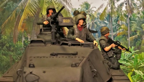

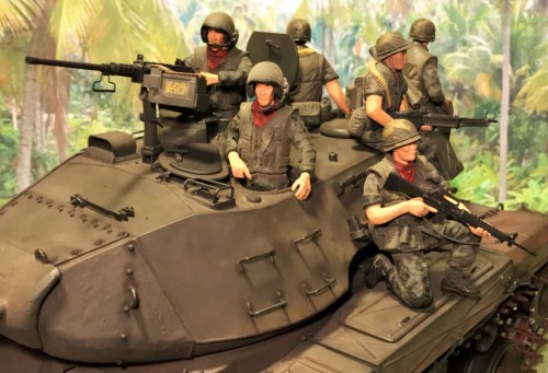

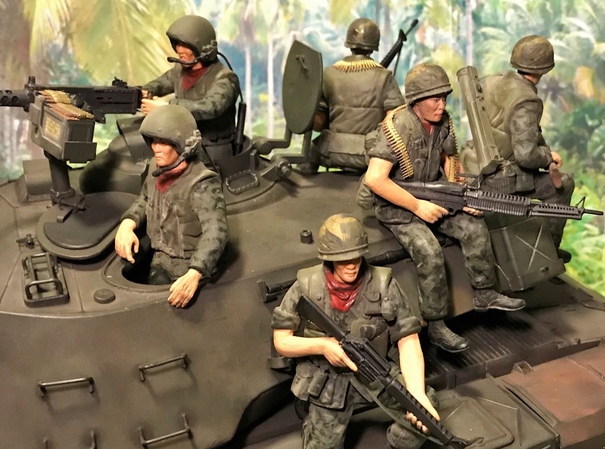

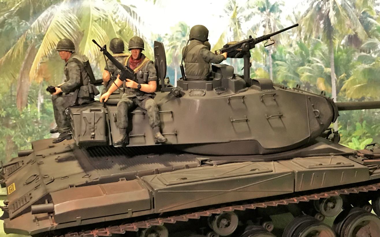

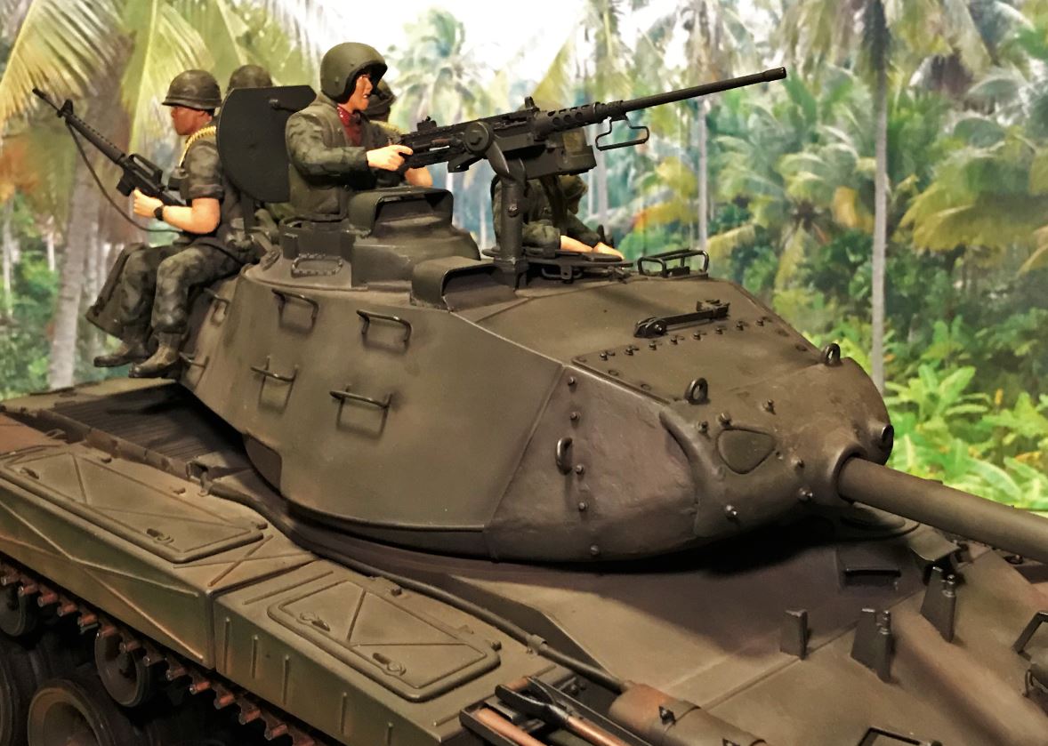

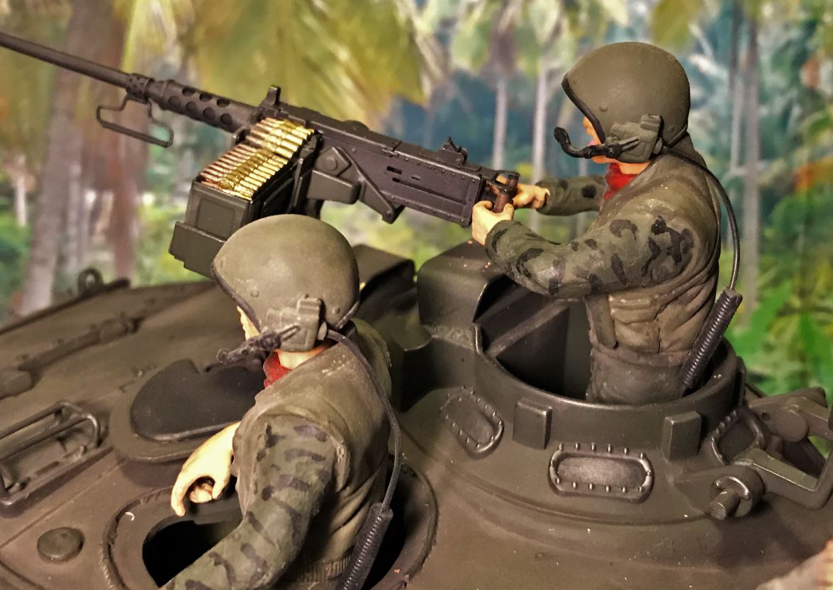

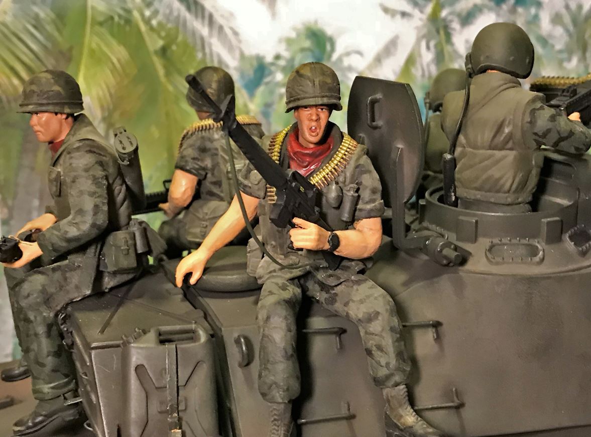

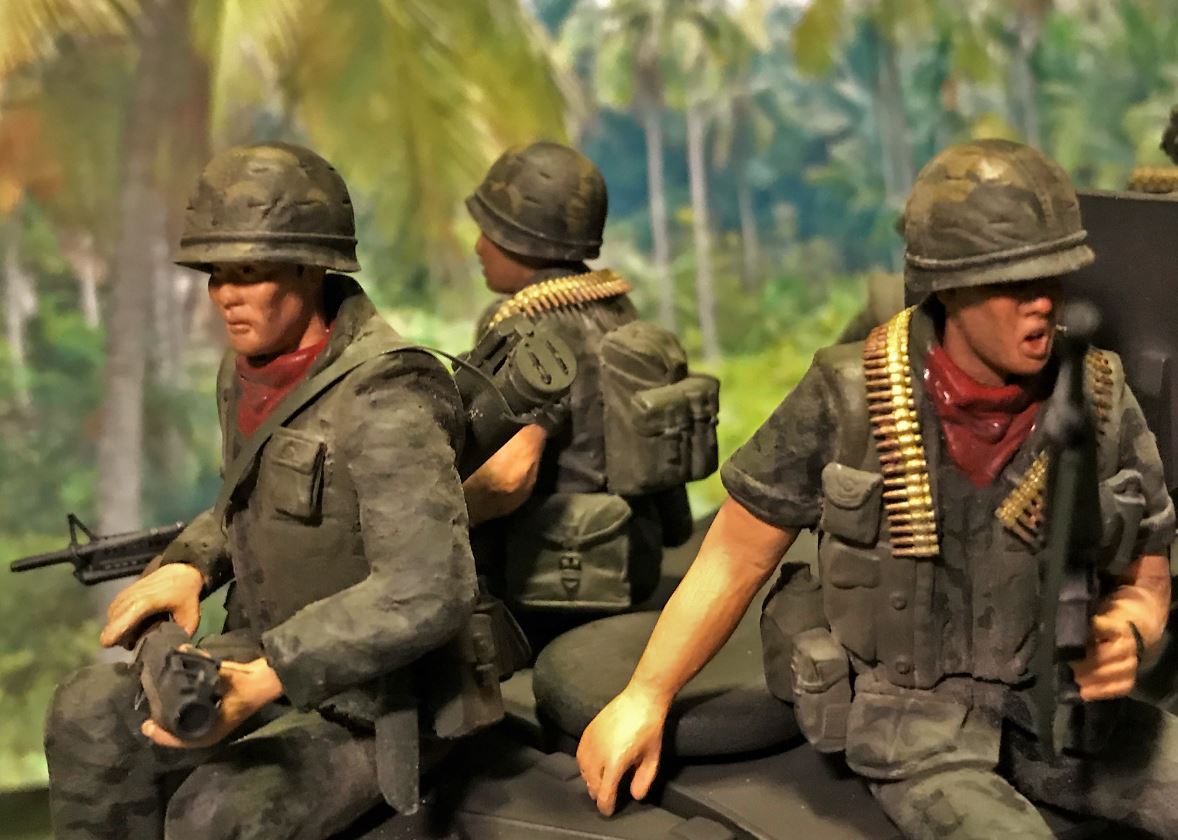

Now presenting the finished ARVN crew and infantry riders.
Here are the men in action during the last few months of the war in 1975, riding through a jungle road in South Vietnam. The men are apprehensive, expecting contact with the NVA who apparently has T-54 tanks in the area.
M43A3 Walker Bulldog 1/16 RC ARVN tank Crew and Infantry riders
Next step is the finishing touch on the model, and then I will bring it outside for some pics.
