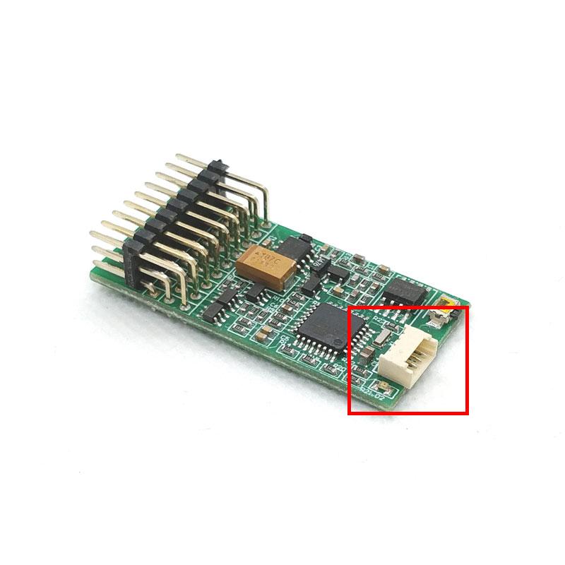

Good afternoon.Help please.Which connector is needed to connect the DasMikro tbs mini.The photo shows.

Hi, that board is the cloned benedini mini. I have no idea about that connector name. I just connected micro pins and done.wolodya295 wrote:Good afternoon.Help please.Which connector is needed to connect the DasMikro tbs mini.The photo shows.
Beware, the pirated board usually comes with no teach button. that button is in the picture, but not always comes.
