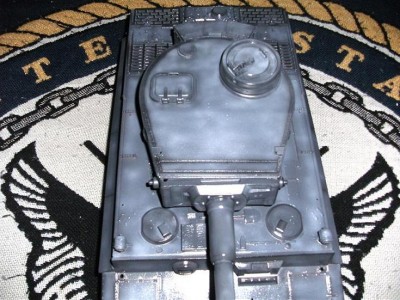

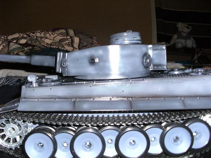

Pic 2/3 are of the Turret. The barrel, all Zimmed sides, and locker box, has had 7 klear coats, Looks Ok. The upper part of the turret is another story. This has had 14 coats of Klear ! Yes you heard it right first time. The cupola, Loaders hatch, vent port, looks ok, but the rest of the surface has an orange peel texture to it. When I painted the turret, I think the paint ratio was too thick and I should have held the AB closer to the model. The paint was drying before it hit the surface. This is why I am not getting a very smooth finish after using the Klear. Oz, I know you said, keep on re-coating it and it will be Ok, but after 14 coats it has now become a chore. Im hoping when I matt coat it, the Orange peel texture will not be as noticeable. I think it will still be all right to decal and I think the wash will still flow through it Ok. What do you think ?

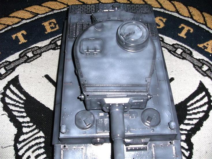

Pic 5 This is a close up of the turret top/orange peel finish :-\ :-\ :-\

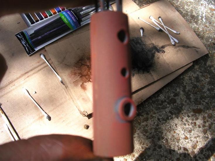

Sax, I used pastels, orange/brown to create a rust effect to the tops of the exhausts, but as soon as the klear went on it disappeared. Pic 4.

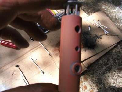

Steiner/Bran on the exhaust caps I am going to use the rust/brown/red pastels applied with brush wetted with thinner.When I was trying out different things with the pastels I did this and barely marked a piece and the color was their to stay,Back plate above the mud guard bracket.I will try this on thee exhaust as I have two sets,Will post tomorrow the result.Check out the forth picture of my posting of the pastels.the mark on the right above the mud flap bracket,that was made as described. sax
