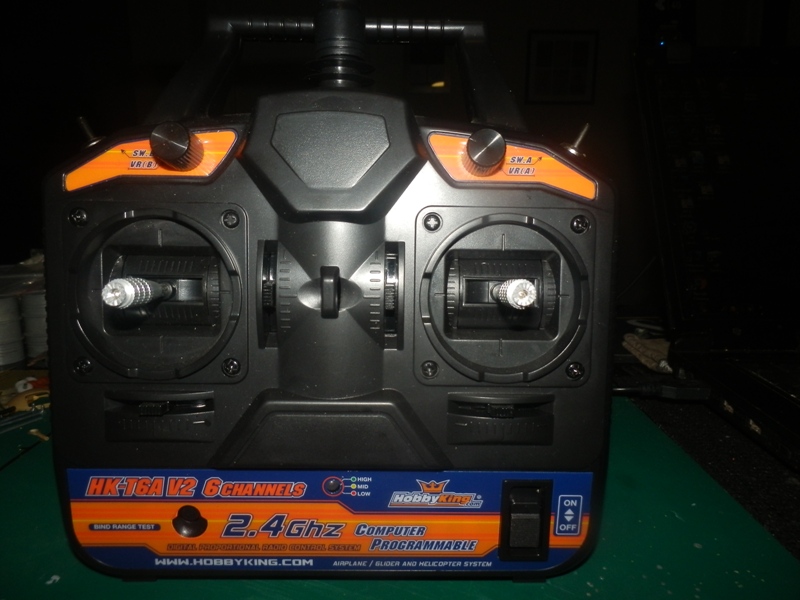

Recalibrate the tamiya unit again. Which radio do you have? Probarbly you only need to program it a bit. No need to touch any wire.
- Posts: 11726
Re: KING TIGER 211,506 S.PZ.ABT,GERONSWEILER,DEC '44
This one...........Rad_Schuhart wrote:Recalibrate the tamiya unit again. Which radio do you have? Probarbly you only need to program it a bit. No need to touch any wire.
- Rad_Schuhart
- Posts: 2089
Ugh... I dont know how to program that radio, but I think you have to plug it to a computer somehow...HERMAN BIX wrote:This one...........Rad_Schuhart wrote:Recalibrate the tamiya unit again. Which radio do you have? Probarbly you only need to program it a bit. No need to touch any wire.
I recommend you go get a true programmable radio, with a screen, so you can really enjoy driving the tank, and assign switches for the functions, like shooting the cannon and machine gun and so on...

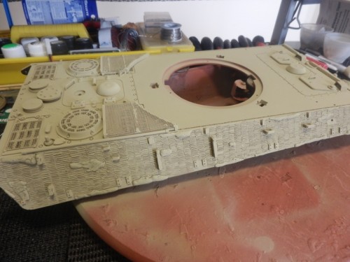

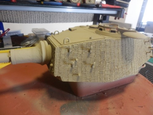

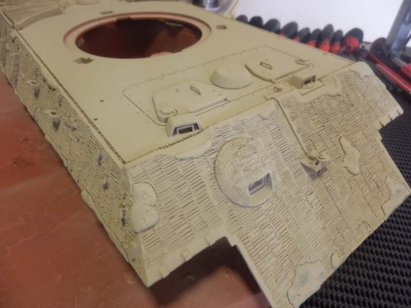

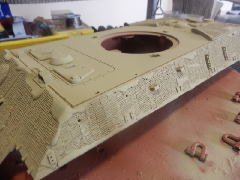

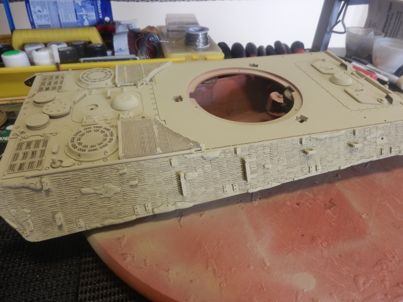

So, with a glimmer of hope in mind with the electronic functions working at least enough for me to move things out of the way during the painting process, Ive spent an inordinate amount of time fitting the Panzer Putty mask over all the patches of missing zimmerit on the upper hull.
Now I reckon that if I had remembered how long it takes to get the stuff in place after my F05 build, I would have not melted in so many missing patches !!
The turret I wanted intact, so smart move there.
The glacis plate has a thickened backing piece behind the missing zimmerit patch in case I want to add an armour strike with depth like the ones I've seen on real King Tigers.
Here it is now in base coat of a blended XF-60 German Dark Yellow and 50% XF-55 Deck Tan.
As I'm a heavy handed washer/weather'er this allows a lighter base to start the final process on without darkening it too much.
Plus after F05 I know that the zimmerit holds a lot of wash that cannot be removed by wiping it off as you can understand.
Hopefully the lighter base will end up just right.
Tools and their respective clamps can be blended in by hairy stick once secured.
As there are only so many ways to do a good ole Tri-colour German cam scheme, this one in keeping with its field applied intent will be less than uniform, and will have a measure of camo on the roadwheels.
The actual tank when captured did not have any whitewash at all on it, which is interesting in the sense that they either did not have time to do it, or, they didnt think it would make any difference as the thing had to keep moving to reach its objectives before the Allied airforce got active again & pissed on the parade !!
Surely they knew that the weather was going to be some of the worst in living memory as much as the Allies did ?
Who will ever know.?
Due to the remains of the previous owners work, some of the minor details are not recoverable or scarred, but thats life when doing a renovation. Any glaring eyesores will be dealt with somehow at that time.
As I've mentioned, if the battle system cannot be repaired or otherwise made to work, the only plan B I have is an IBU system.
Good thing these Tamiya thingo's are easy to get back into
I hope soon to secure a track tensioning system from a bloke in my old country- New Zealand.
Again, this can be installed later which is quite convenient !
