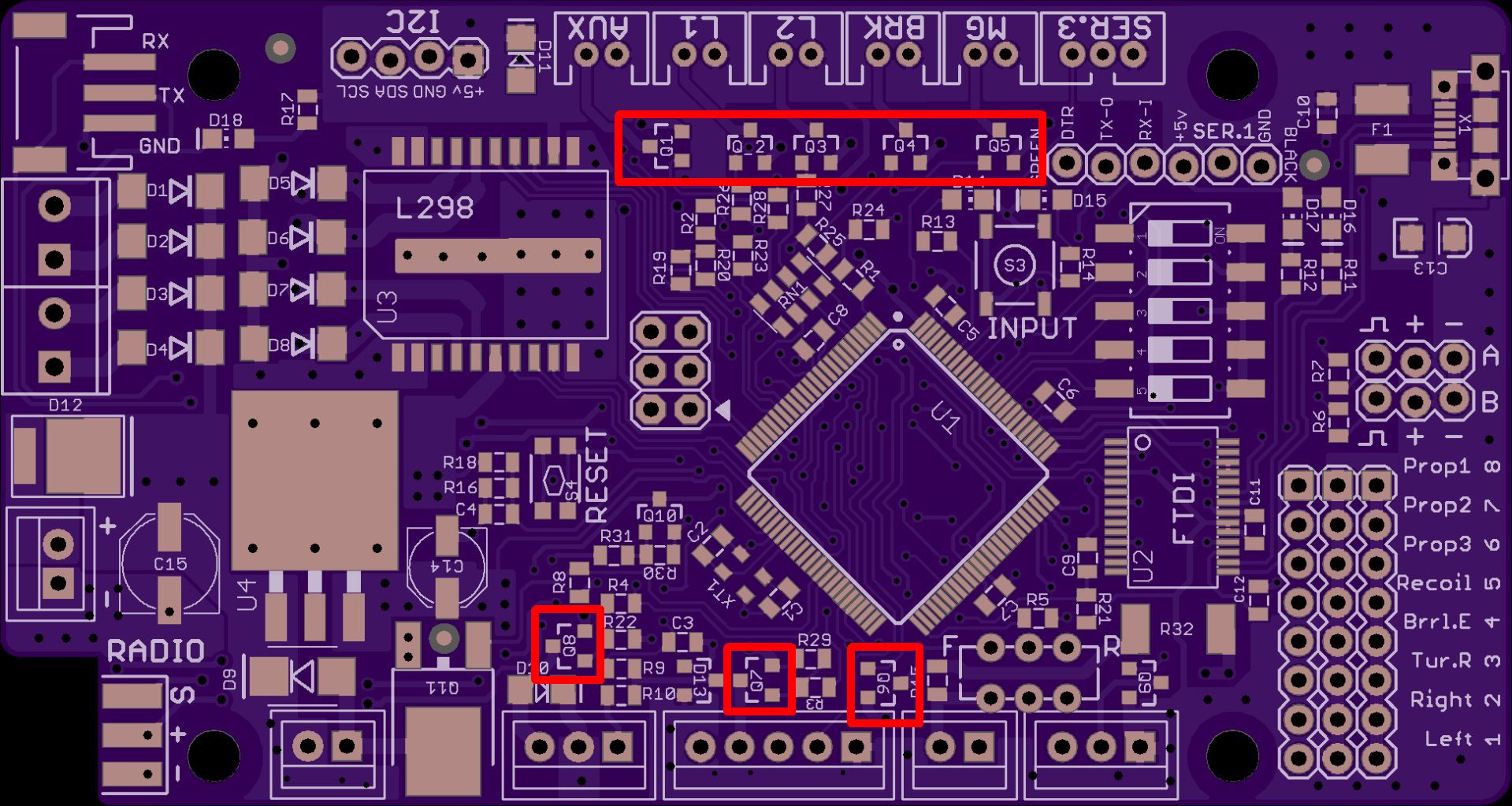

Stop the presses! One of our users who just ordered a "new" board has received instead the same board being sold this summer, with all the same, wrong components. As listed above all the "new" boards are in fact old boards with the parts manually replaced, but apparently they have not fixed all of them and certainly haven't tested all of them. Some do seem to be functional (the one they sent me is) but there is no guarantee what you will get.
I must conclude that Hobby King can not be trusted to get this right. It is not beyond their ability but they simply do not seem to care. If you have not purchased a board yet, I would suggest you do not unless you want to take a risk. If you have purchased a board, please examine closely the MOSFETs Q1 through Q8. If any of them have the markings "23EG" on them, they are wrong and your board will not function. The image below shows which components these are.
For those that receive faulty boards, you can take your chances and request an exchange, or if you want a refund let me know and I will provide you the email address of my contact at Hobby King so he can deal with this directly.

Re: Intro to the Open Panzer Project - and a new Control Boa
Luke I'm very sorry to hear this. I've the one from the original shipment and I've very carefully replaced the mosfets. Will be using it in one of my builds this fall.
Is there a serial number on the run from the first group versus the second batch of is it simply check the number on the mosfets?

c.rainford73 wrote:Is there a serial number on the run from the first group versus the second batch of is it simply check the number on the mosfets?
The best I or anyone else has been able to tell so far, there is only one batch in existence, so no, there is no way to distinguish between these boards and the summer boards since they are in fact one and the same. At least that is the case for the ones I or others have examined thus far.
