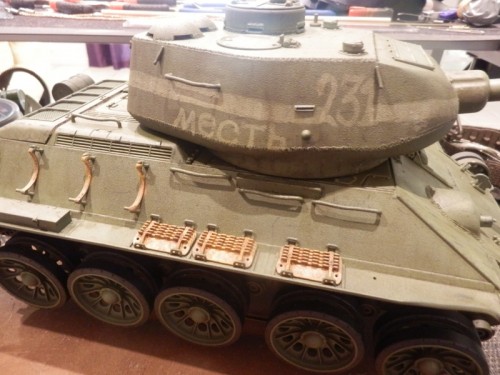

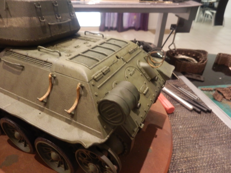

Well, I had my last day home today, managed to get some tank time in.
Painted the track cleats and secured them in place, also coloured the smoke canister & mounted it.

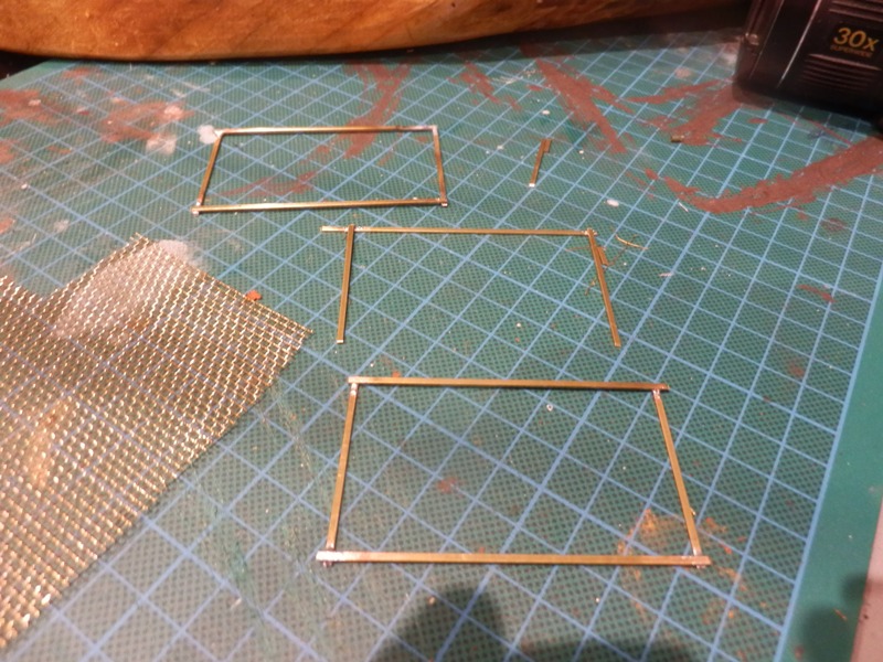

Began the bedspring armour panels.
Used 2.5mm brass flat for the turret frames. Looking at the pictures the frames were very light, and did not seem to be angle iron.
I will need to get some mesh with slightly coarser weave, mine is ok for the hull panels, but its to closed for the turret.
Again, the solder paste is a wonder to work with, that is until I ran out of butane for my brulee burner :-<
Oh well, My long suffering supply officer( Mrs B) will tour off to the camping shop in the morning for more.
Got some paint on the tracks while I was at it. Used a brew of dark brown, flat copper, and a dash of German grey.
Once the tread pattern is worn off and they are dusted the look should be right.

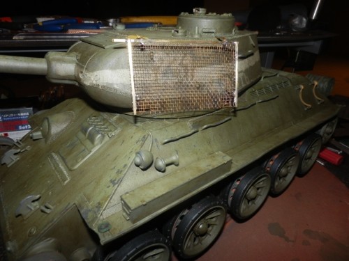

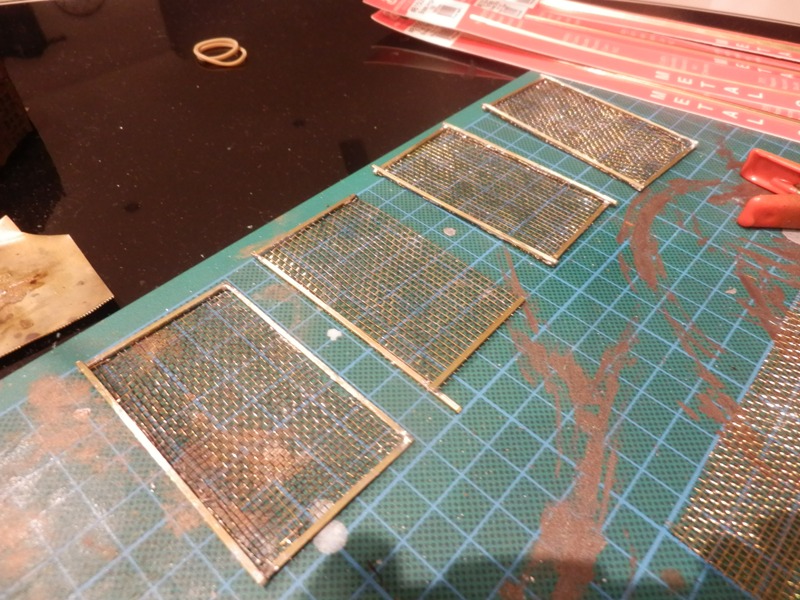

Been a bit of a "slow-news" week.
Off out in the boonies for a while, now back.
Got a start proper on the screens, fiddly and kept springing apart as the progressive heat went in to secure the mesh with the solder paste.
I was twisting off a bit and almost reverted to super glue..............at least that stuff does not react adversely when another run of itself is applied !!
The turret screens are together, but still lack the hangers.
Next up will be the hull sections.
Posts: 11638
Re: BERLIN BUSTER T34/85 'BEDSPRING'

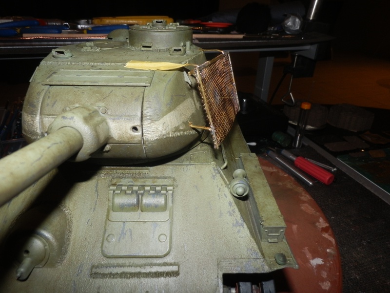

Got the first screen dry-fitted to the turret. As I dont have any popular purple tape, good old Tamiya yellow tape will have to do !
These things are rough, as I expect they would have been, but to get them looking right is not as easy as it looks.
One down, 9 to go :/
I really have to stop doing tanks with extra armour :think:
(I will get to the headlight Mr Painless-promise ;) )
