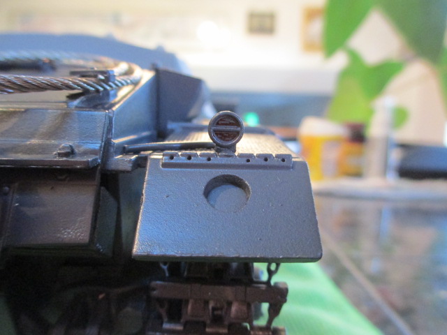

Good morning. I should have taken a pic of the Stix in use. ;o) It helped me hold the tiny brass squares I used on the front fender stays in place until the Gel glue set. I rotated the head of the Stix then and it released without tugging on the part. With something so small, I usually end up gluing my fingers or tweezers to the part so these are a huge help. Alpha, It looks like the Panzer IIIs ( at least some of them ) had these altered rear fenders as well. HL and Taigen should have molded the deck fenders with them already in place. http://freespace.virgin.net/w.oliver/im ... 20rear.jpg

Well I'm going to stay away from that detail on mine...just because of that "Stuck Finger Syndrome" :haha: ...it really does add to the detail of the front end though...thing is certain tiny parts I tend to stray away from... My L70 took 3 two foot headers :| ...luckily there was very minor damage...the small parts that did get dislodged...where the brackets that hold the rear shields...just like those parts you just installed..were very tricky to replace without taking the entire shield off.. did it though and all is solid again...That tank has been through more rough treatment that usual...but I have to say..the entire structure is very strong
Thanks for the picture...I guess the IIIs did have those indents ...will keep that in mind when I redo my PanzerIII ;) ...It does make you wonder why any of the Manufacturers overlooked that detail ...on the real deal you really can't miss them

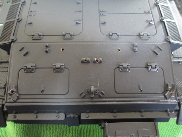

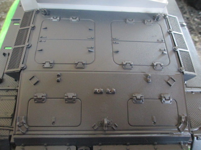

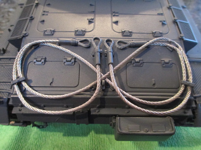

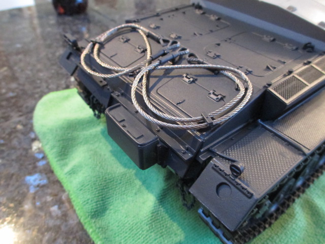

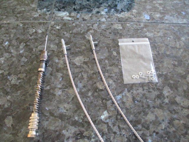

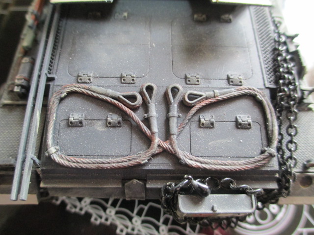

Nothing StuG related in the Post today ( A _huge_ box of Stuart stuff did come in from Sassgrunt for the coming Stuart build. Looking forward to opening that ;o) so I looked at the next bit of Deck detail. On the 1/35 Tamiya model, the rear tow cables are draped, artfully, just so... and look terrific! Mato's version of those cables are made of braided adamantium apparently and had enough torque when looped to shear off two of the mounting pins cast onto the cable clamps. Some cursing and drilling and pinning later, Pictures:

What I was trying to emulate
Six points later and some additional epoxy...
Rest of the six points of attachment drilled and enlarged with a 3/32nd bit
Rest of the six points of attachment drilled and enlarged with a 3 32nd bit.JPG (98.58 KiB) Viewed 4391 times
Initial two pilot holes drilled with a #61
Initial two pilot holes drilled with a #61.JPG (99.3 KiB) Viewed 4391 times
What you start with, a couple of bridge cables and some seemingly flimsy mounting hardware.

The cables sure do look as you say - just so. The layout on the H/L PzIII is similar. Almost a shame to cover them with stowage !
