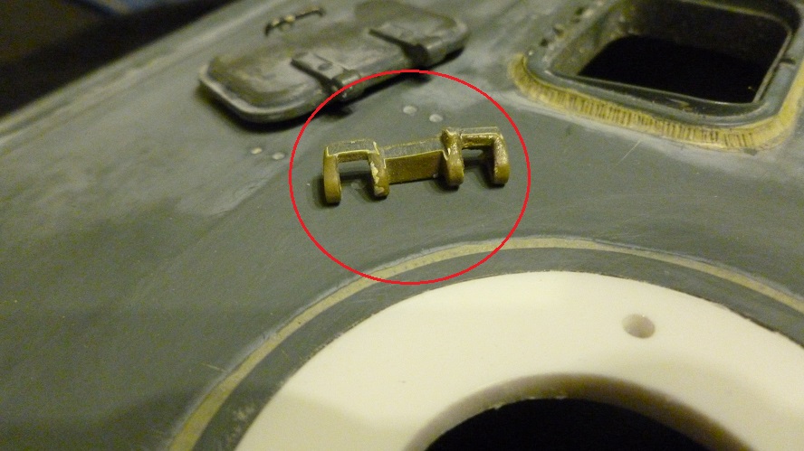

- Original HL Hinge for Loaders Lid needs retaining.

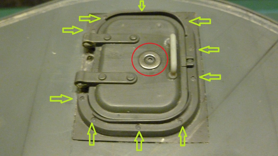

The last small job was to drill replica's of the small recesses around the Loaders frame as arrowed. These on the real Hatch held the Taper bolts that held the frame in place, only the splash guard upstand was welded to the hatch. The small circular feature is to replicate the external locking latch plate featured on some of the Mid-Production Loaders Hatches. The handle on the Tamiya Lid is the lifting handle from the Hachette Cupola which fitted a treat ( What Sprue contains the actual Tamiya handle I have no idea !) I was going to use a Brass 1.5mm wire but the Hachette Cupola handle whilst not to scale for its original application was perfect for this one. Once again I will fill the slight gap around the frame with Milliput once I have done all the other cutting and conversion work on the Turret.
- Drill around the frame to replicate the recessed bolts and external locking plate on lid formed by small steel washer.
