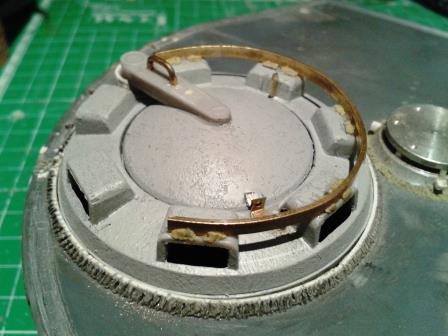

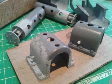

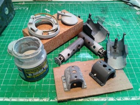

Mr Surfacer 1200 - what's not to like? That crazy name for a start... I bought this a while back. It's basically a quick-drying light grey paint which flows quite freely for the first minute or two - but then allows you to stipple it with a brush. The idea is to make a roughened texture on plastic which gives the appearance of cast metal - or rust. There are several 'grades', but 1200 seems to be the most useful in 1/16 scale.
As well as the cupola I decided to try it on the exhausts. The collars that fitted around the lower part of the exhaust were cast pieces and I had already added the lifting lugs from plastic rod and plastic circles cut out with a punch and die set. These are even missing from the Tamiya Tiger. Elsewhere I added Mr Surfacer to the exhausts themselves and the inside of the top of the shrouds where rust would inevitably form. I only used it where it will be visible once the parts are assembled.
The texture paint applied to surfaces where a cast finish is needed - or where there will be rust.jpg
The texture paint applied to surfaces where a cast finish is needed - or where there will be rust.jpg (31.5 KiB) Viewed 4390 times

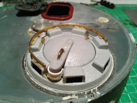

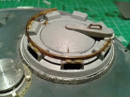

As far as the cupola itself is concerned I liberally applied Mr Surfacer but took care to avoid the weld beads, AA rail and other brass additions. I will see how it looks tomorrow, but I may have to sand it back a little so that the texture is not excessive. Oh yes, and that fiddly hatch stop behind the front periscope guard is proving problematic - for now I have replaced it with brass.

Care was also taken to avoid the weld beads and various the brass fittings.jpg
Care was also taken to avoid the weld beads and various the brass fittings.jpg (30.52 KiB) Viewed 4390 times
The cupola is still not fixed in place - and will require a little more work to fit it snuggly where the Taigen cupola used to be.jpg
The cupola is still not fixed in place - and will require a little more work to fit it snuggly where the Taigen cupola used to be.jpg (31.68 KiB) Viewed 4390 times

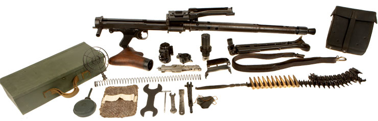

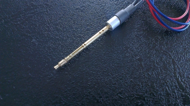

So, as we have already established, the Tiger carried two MG34s. Each had a reinforced barrel for additional protection from shell splinters, etc. So whether the MG was being used in the hull or co-axial mounts - or the AA position - it should be the same type.
Here is a shot of an original MG34 recently for sale in the UK:
Panzermantel MG34.jpg (38.21 KiB) Viewed 5242 times
Although not terribly clear it does show the 'fatter' barrel sleeve with a slot in the upper front end and without all those perforations which we associate with the classic MG 34.
I bought my hull MG from Steve at Welsh Dragon a while back - it was made, I believe, by Tank Modelbau of Germany. I thought it looked great at the time, although I recall that there was a 'fine line' version which I ignored. Had I known where I would be going with this build I should have snapped it up. But I didn't.
The hull MG that I bought was certainly an improvement on the HL versions (either painted clear plastic or, like my old, old original RX13 version, not even firing) but it was at least more of an approximation of the classic 'look' of the MG34 perforated barrel. I think this is just an example of how far this hobby (and 1/16 scale in particular) - and my 'detail threshold' - has progressed in the last couple of years.
Anyway, it now looks as if Steve no longer sells most Modelbau products (he used to have a separate tab for them) - which I am sure isn't his fault - but it's a shame.
So I started looking...
Basically I found a perfect MG34 'mit panzermantel' with LED ready to patch in to the HL hull (a great advantage of my previous MG). Here it is:
It's on the tank Modelbau site:
http://www.tank-modellbau.de
But I could only find it listed in the Jagdpanther 1:16 section. This is how it's described on the site:
2410
Aber Bug MG
Dieses Aber Bug MG wurde von uns so umgebaut das es nun für den Full optionbetrieb geeignet ist.
Lieferumfang: 1x Bug MG mit led Orange.
The number 2410 is important because when I emailed their website they seemed to think that the numbers were switched with the un-armoured version (2560).
Anyway,the important bit is that they are very friendly and can respond in English - although I did point out that their sales might improve if they improved their website!
At 25.80 euros it is not cheap - but given the trouble I have taken so far I think it's worth it.
