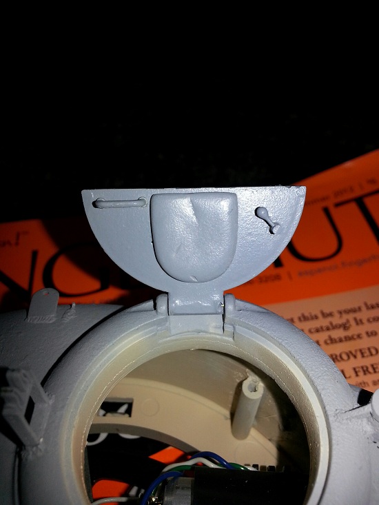

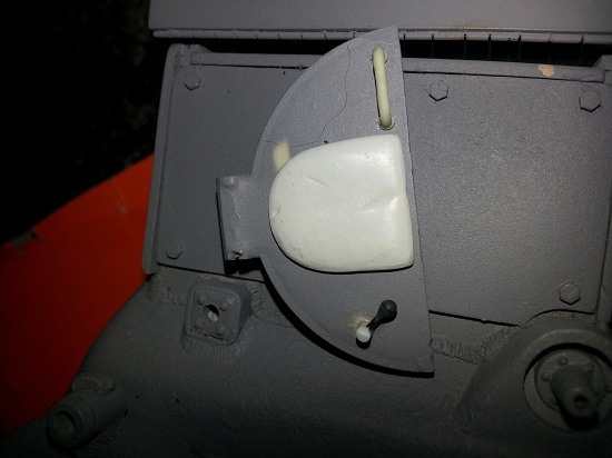

I am finishing up the small details and noted that the hatches were void of detail on the latch side. I needed a lever with a knob, a handle and a pad. I wound up using a spare hatch handle, an old style straight pin and a piece of plastic rod for the handle and I used a .015 plastic base and miliput to make the pad. Here is the completed product.
-Dan 8)

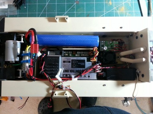

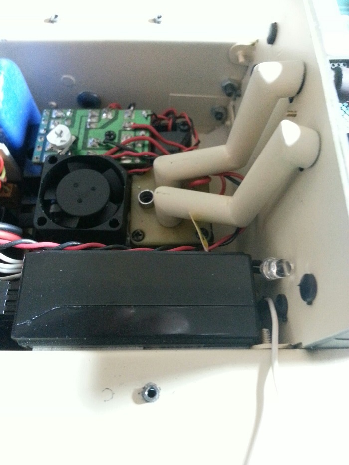

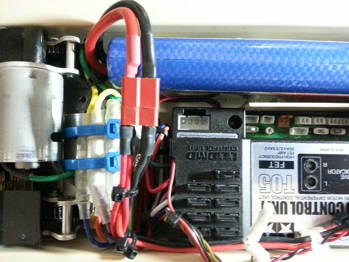

Well, I didn't take all the pictures I should have, but here are the electronics less the custom made speaker enclosure. It's complete, just not mounted for this group of pictures. As you can see, a smoker can be installed in a Tamiya Sherman, but not without a lot of work. The custom made exhaust pipes are shown to good effect here, as is the modified Heng Long smoke unit. ( Thanks, Norm) You can see the LiPo battery, the Novac battery cut off circuit is mounted below the receiver. The LED glows blue and flashes when the battery is getting close to cut off. I didn't want it to show on the exterior, so it rest inside. I will be posting the exterior as I finish mounting the final bits of equipment and the final phases of weathering.

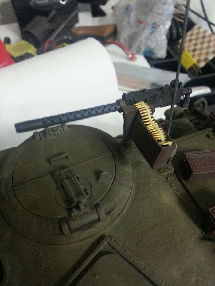

There seemed to be a bit of controversy regarding the use of the Browning M2 .50 on Fireflies. After a bit more research the issue seemed to stem from over and under growth in Normandy, and the inability to store the weapon on the back of the turret like their U.S. counterparts, which caused entanglement and often being discarded in the field.
I built an M1919, the ammo can holder, pintle and mount. I also used the turned brass .30 rounds and belt linked them being some felt it more appropriate for a Firefly.

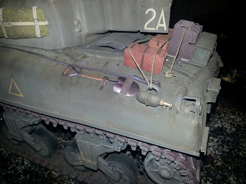

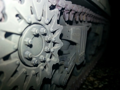

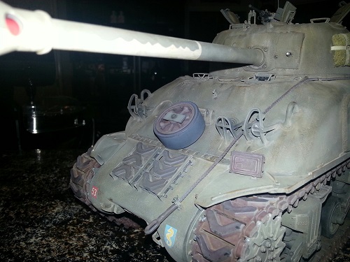

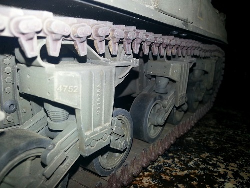

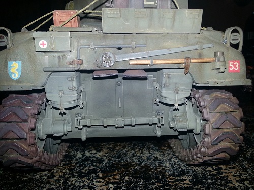

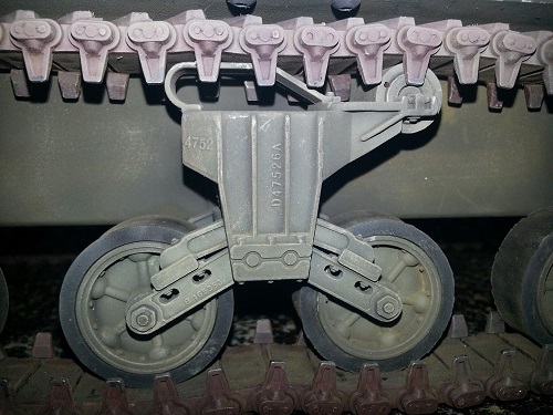

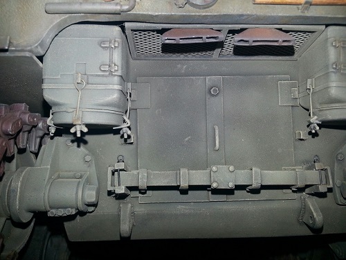

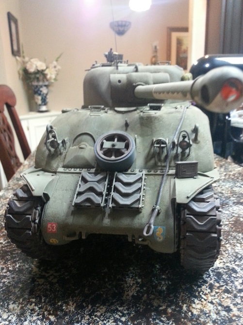

Well, I keep telling everyone I'm almost done. Well, I AM! Here are the pictures of a year's worth of work.. Off and on of course. Feel free to comment. I don't mind critique either. Enjoy! There will be about three pages of photos.
-Dan :wave:
