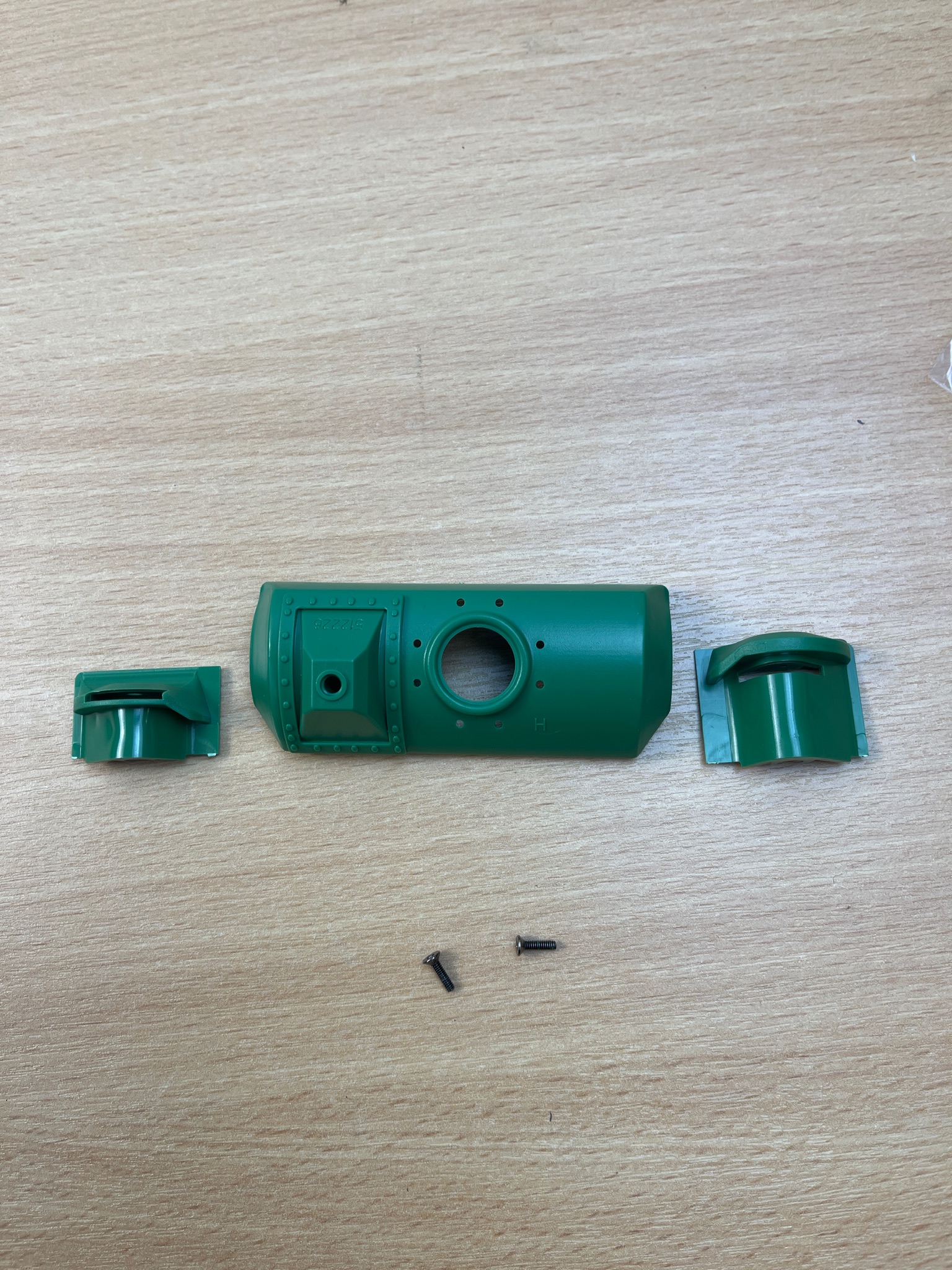

Amateur Build. Mantlet Disaster Strikes !
Post by zooma »
New parts on the way - but at a cost !
I fitted the gun mantlet to my Centurion KIT when I painted the turret. Those who have been following this build will recall that the two counter-sunk machine screws that act as a pivot and hold this mantlet in place (one of each side) were missing from the KIT.
As a previous model engineer (when I was younger!) checked my stocks of miniature machine screws and found a pair of the correct size countersunk M2.5 machine screws in stainless steel with TORX heads.
To fit the tested radio system into the tank I needed to remove the mantlet to fit the gun assembly into the turret - a simple job that only needed these two screws to be removed.
To my horror I remembered that these particular TORX screws had what was termed "security heads" on them. Basically they could be tightened-up OK (turn clockwise as normal when tightening a screw), but when an attempt to remove them was made, the anti-clockwise rotation caused the indentations in the head to shear off - so they could not be removed!
Although annoyed, I was not too bothered as I thought I could just carefully bore through the centre of the screw head and remove the screw shaft.
I had a good stock of new High Speed Steel drills (HSS) so I started with a 1.5mm size and blunted it almost straight away. A second and third (new) HSS drill also failed, so I increased the size to 2mm and then 2.5mm. This time honoured sequence should have worked easily (it always had previously!) but this time the "stainless steel" screws just heated -up and melted the surrounding plastic!
Even after being melted into the plastic (and wondering about in the molten plastic at various new angles) these steel screws resisted all attempts to have any metal removed from them.
The end result was two melted trunnion supports (one each side) and gun mantlet moulded hinges that these (hot) screws pivot in were melted too.
End result - three new plastic parts needed and two of the correct size screws - cost £24.99.
If the right size screws were in the kit this would never have happened ! Even if I found a way to damage the screw heads (unlikely) being typical 'soft" kit metal they would have been really easy to drill out.
Gutted !
I should have been more patient, and reported the missing screws and waited for them to be delivered.... I would be £25 better off too! :headbang:

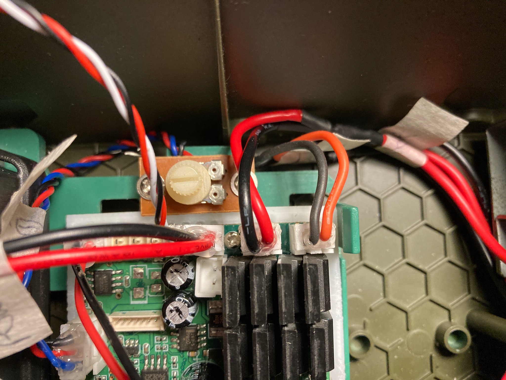

Amateur Build. HAYA Centurion KIT. Reverse Polarity Plugs!
Post by zooma »
Lucky  I spotted these reverse polarity plugs before switching the power on !
The motors and gearboxes were stripped out of my HATA Centurion KIT today to give me some access to solder on the new motor leads that I had just received in the post this morning.
I put everything back together and had also taken the time to put some hot-melt glue on the end of all the leads that would plug into the Clark board to strengthen them .
Unfortunately (when admiring my new neat and tidy installation), I noticed that the wires in the white plugs that fit into the Clark board were fitted the wrong way around!
The positive and negative wires had been inserted into the white connecting plugs the wrong way around !
Although I was gutted (second time in two days!) I was pleased that I noticed it as the reverse polarity could have caused me a much bigger problem if I had not spotted it before powering the system up again!
This has not been a good week for my HAYA Centurion KIT build - I was confident that I would have the tank running by this weekend and that I would be spending the next few days finishing it off and enjoying it!
As it is, I need to wait for the new mantlet parts to arrive and sort out another pair of motor leads.....and then strip the gearbox out of the hull again so I can solder and replace the motor leads (again!).
Can anyone let me know how to identify (by name or type) the white plugs that are used on the ends of the motor leads? If I can buy some of these plugs on their own I can make up my own leads when needed?
