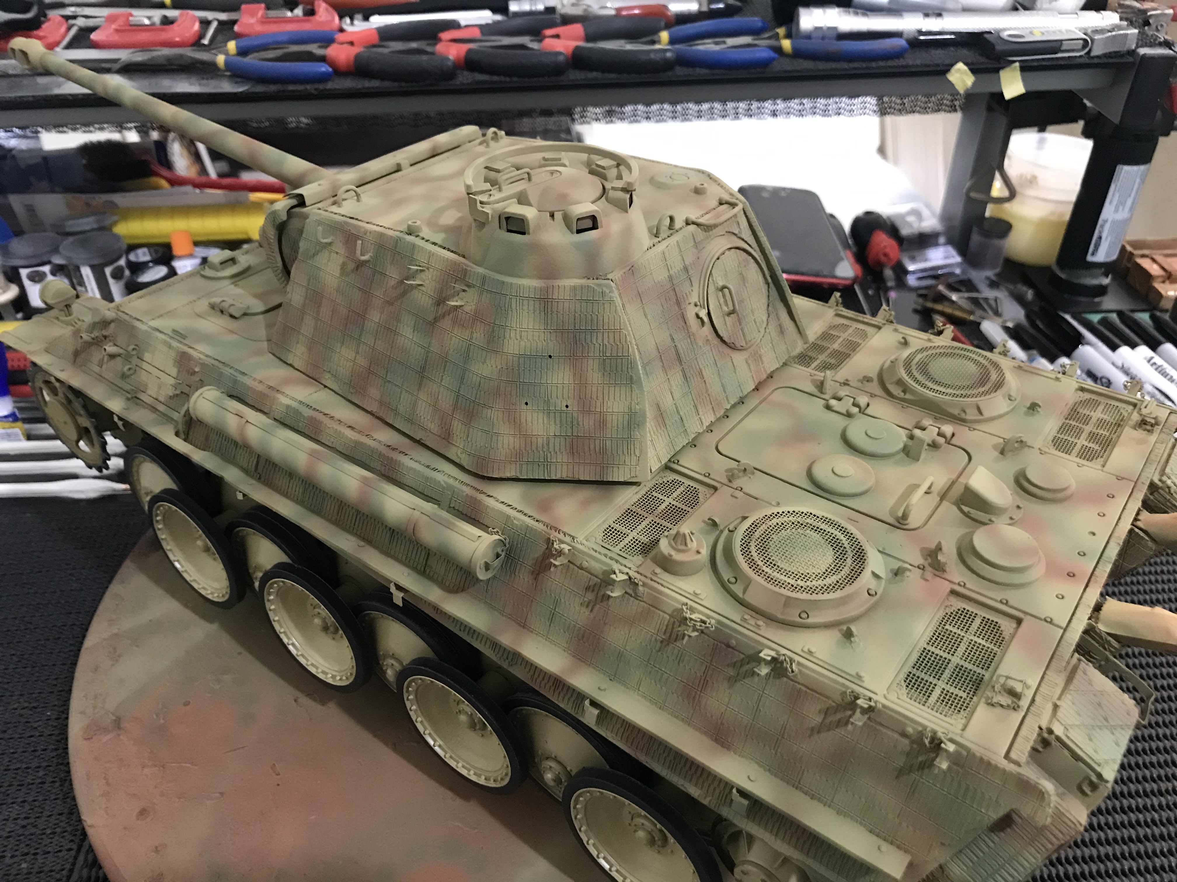

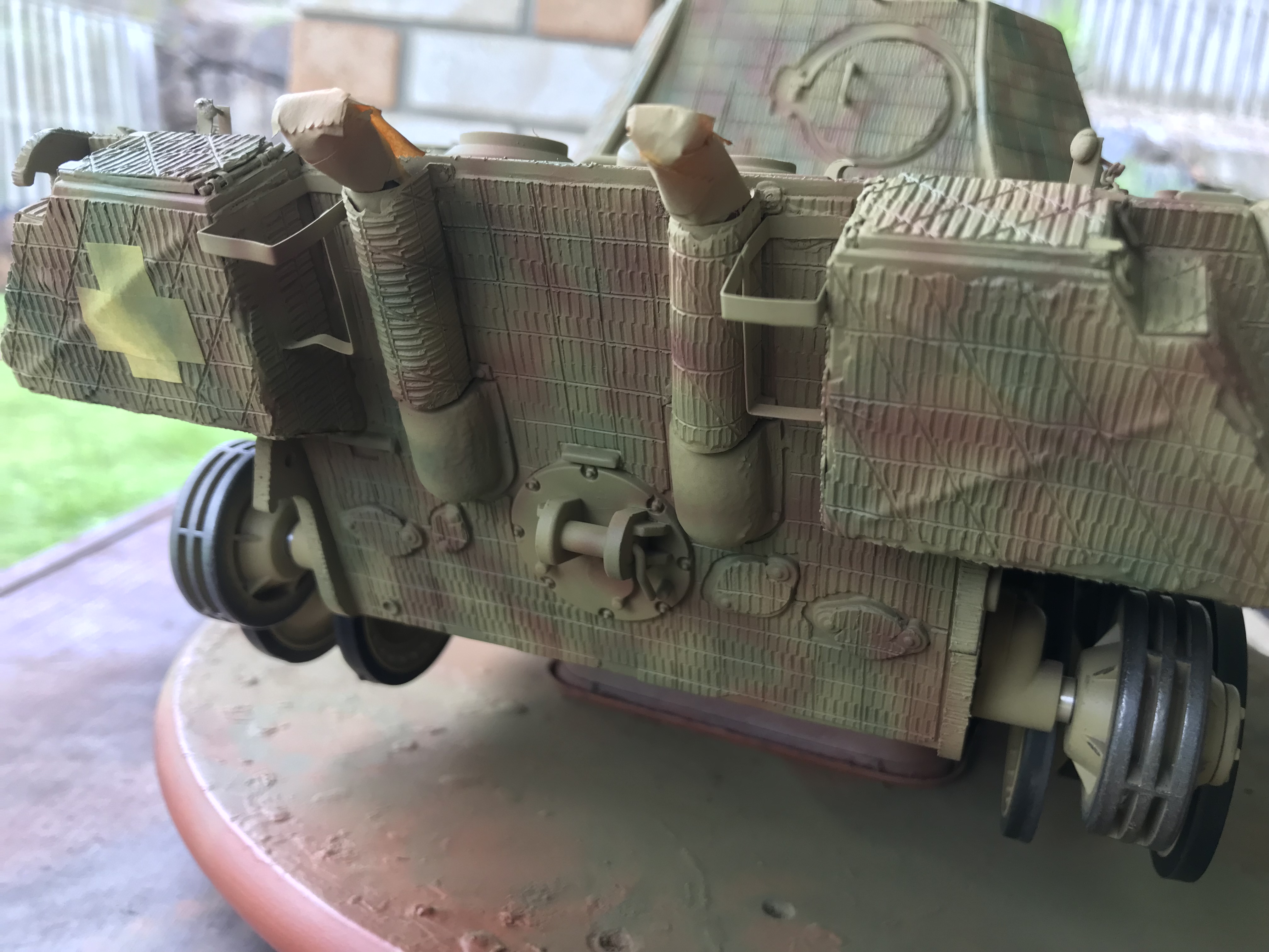

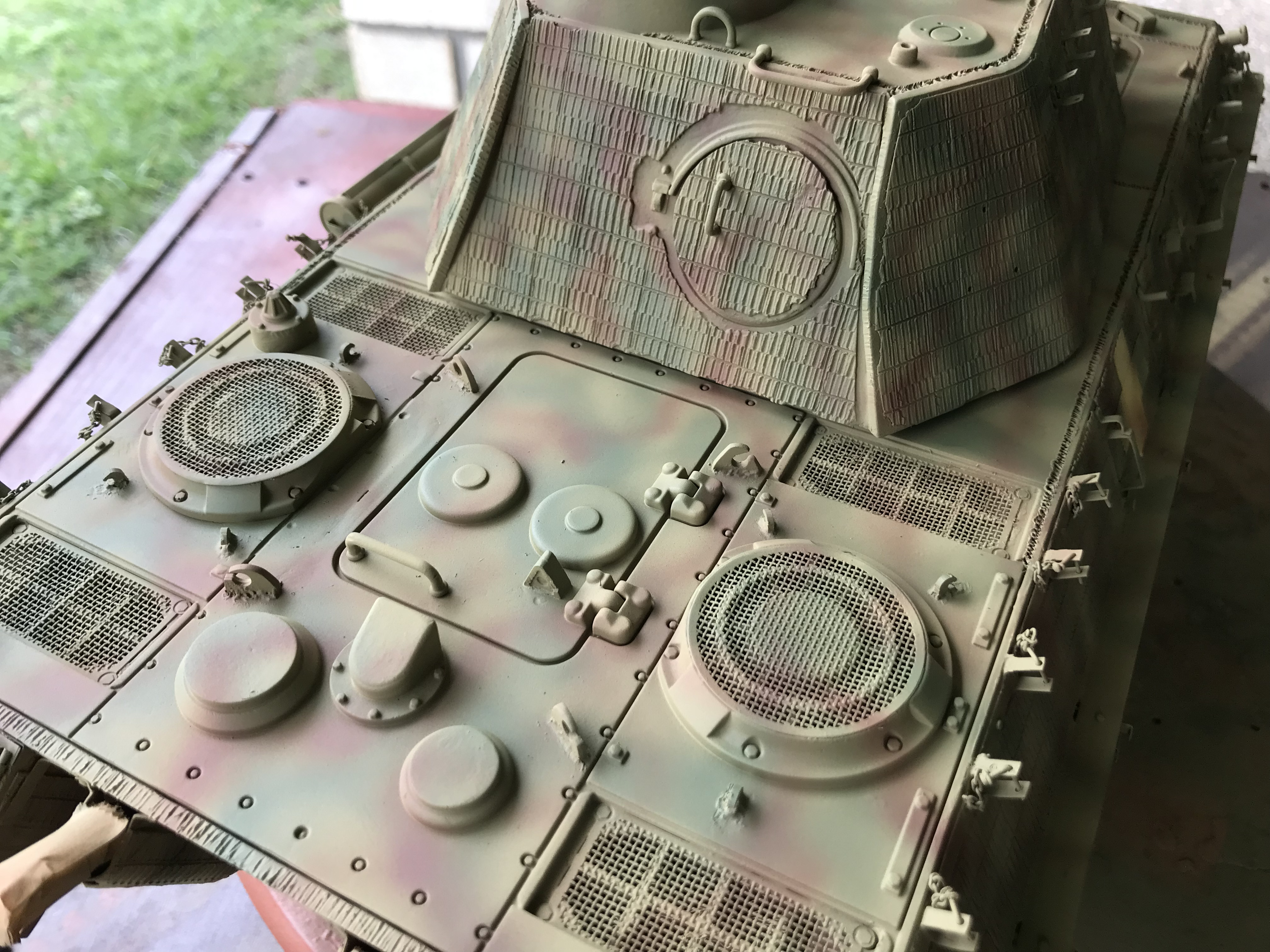

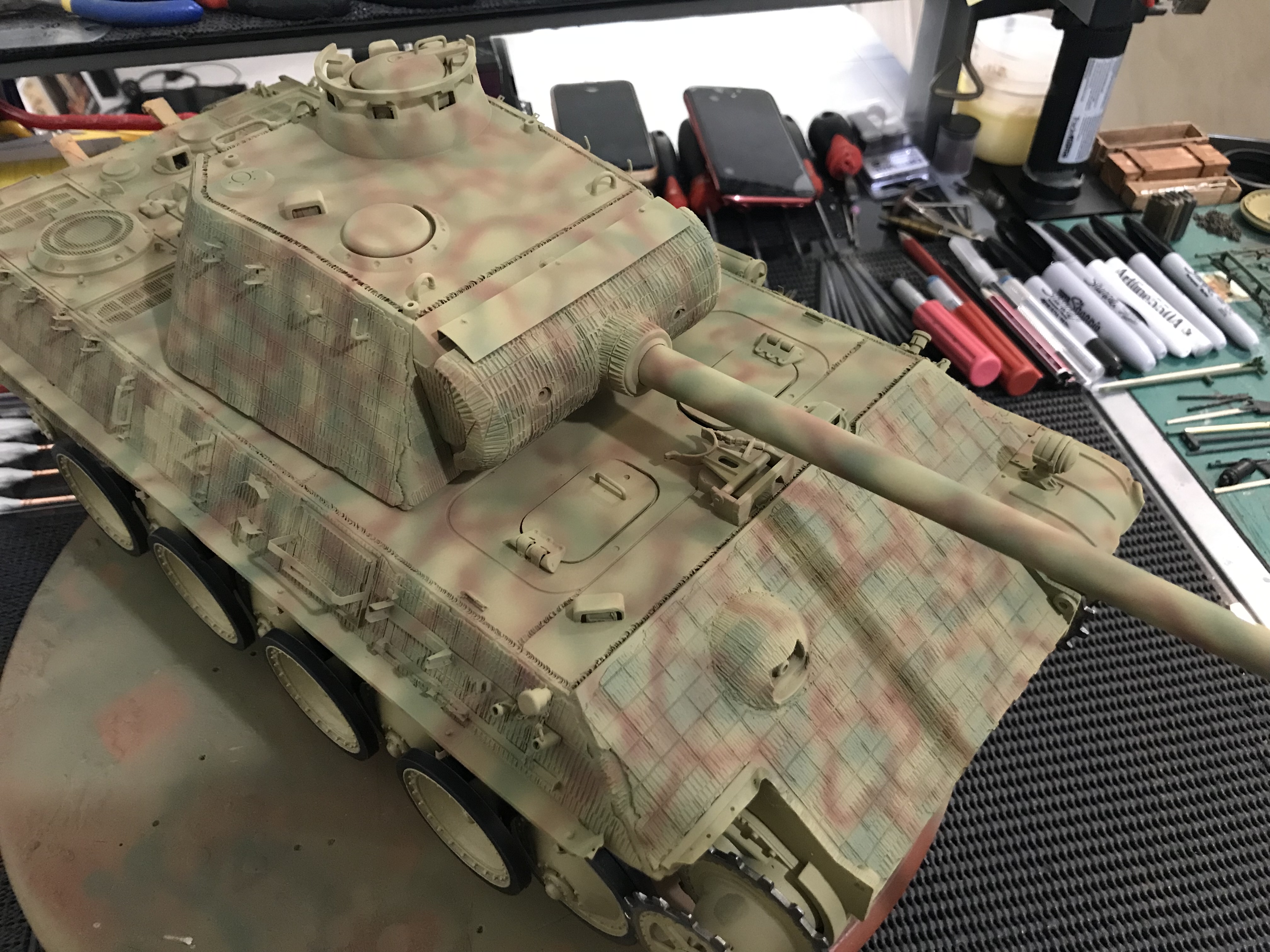

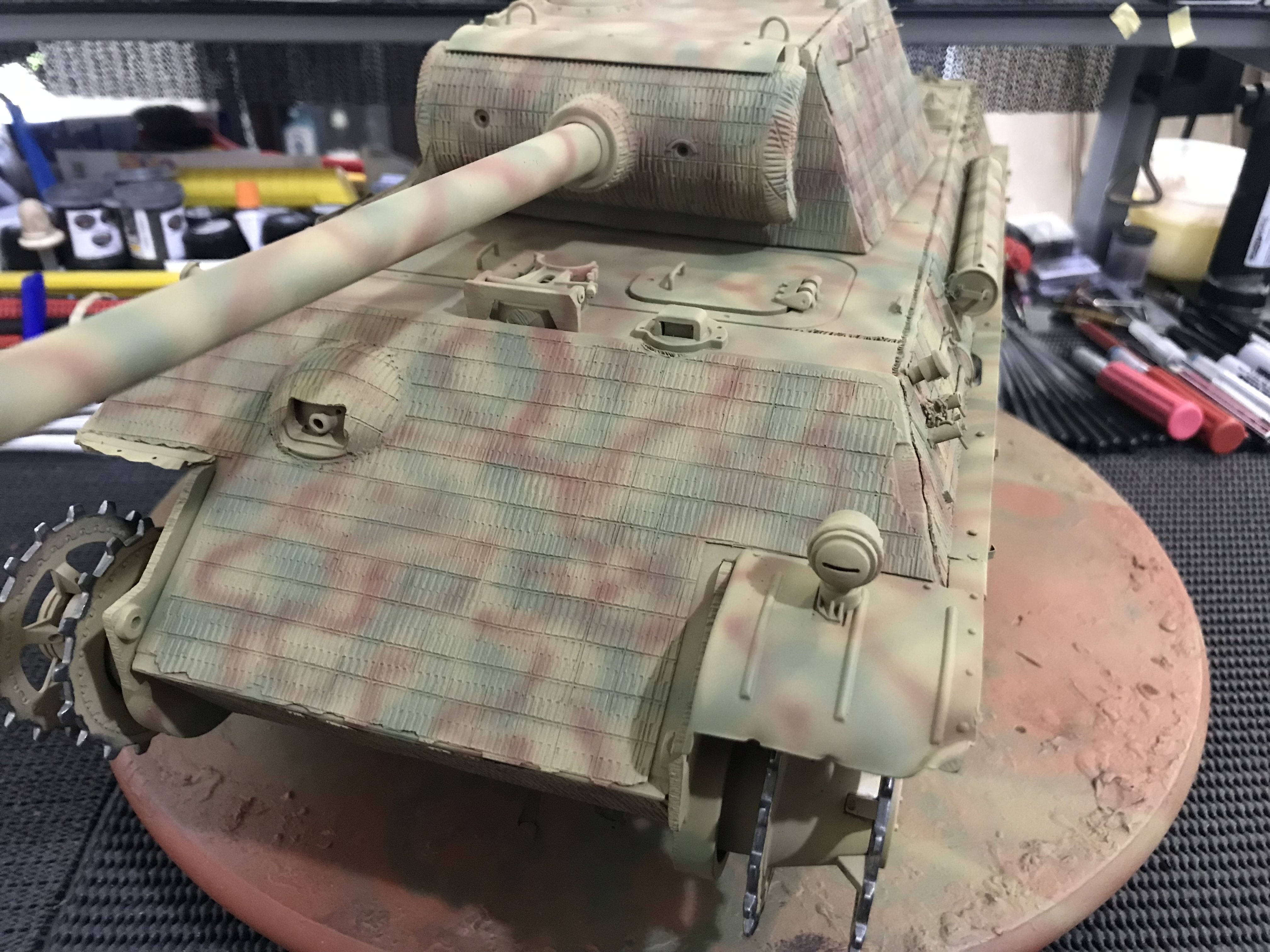

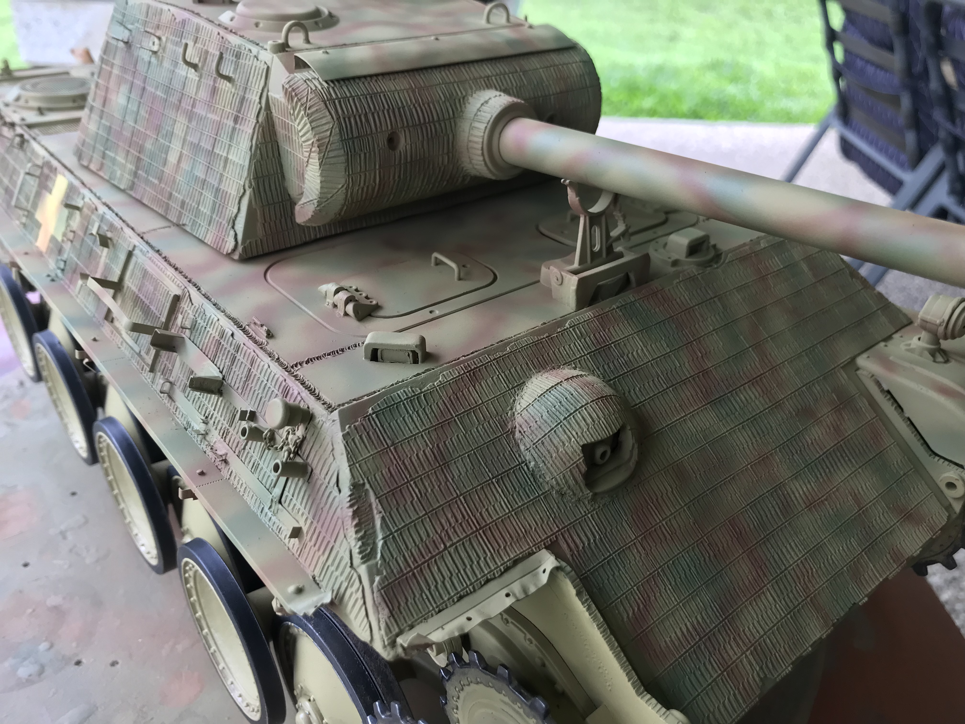

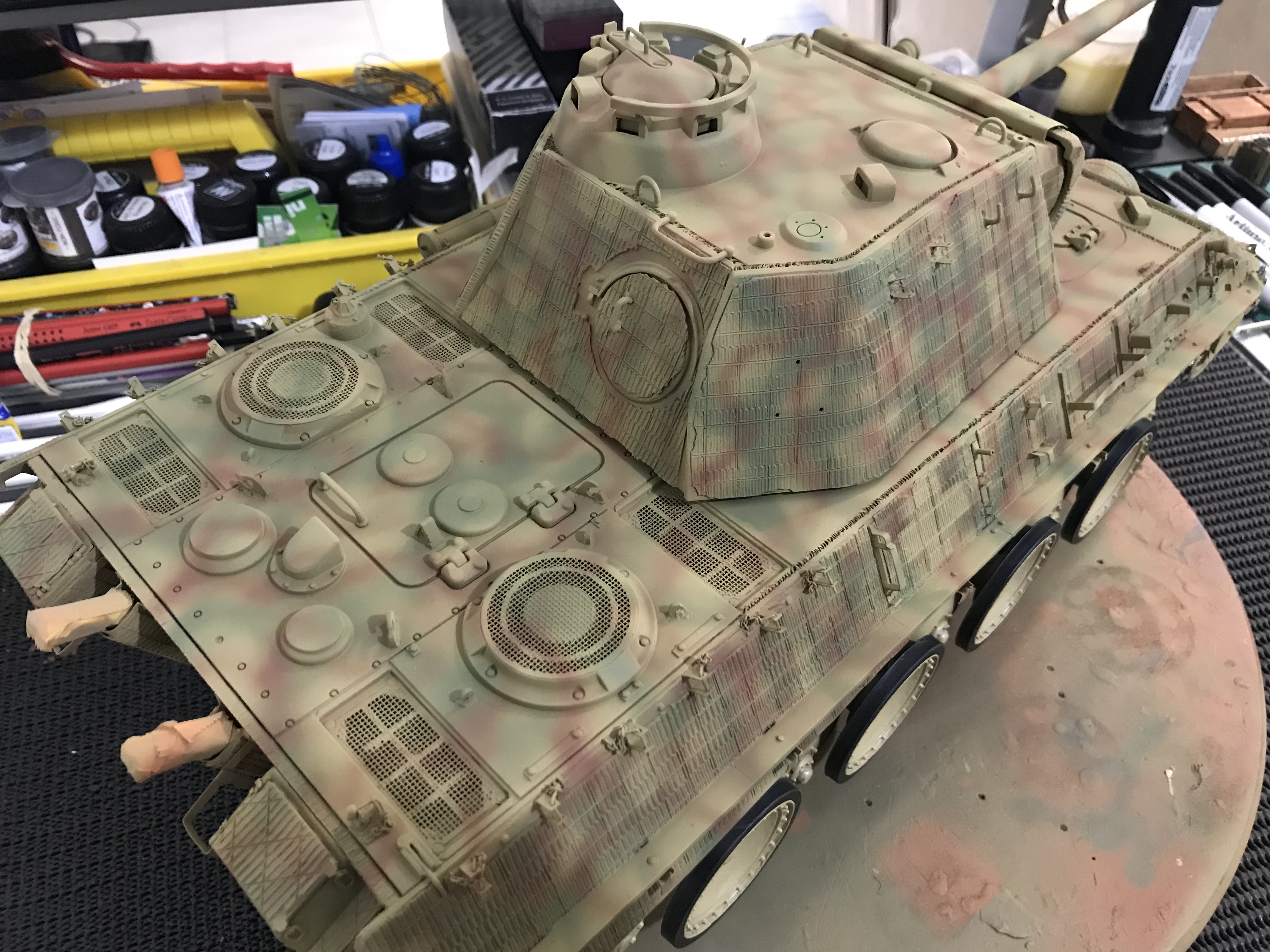

Camo done,
Still a long way to go before it’s a finished project though.
Turns out my typical man-atude to just push through an injury & she’ll be right, I’m in a cast, 3 breaks in my ankle , a terse warning from the medical profession that I could have punched a piece of bone out of my stupid skin had I gone on much longer 8O
I have 3 weeks of being a model patient because if I don’t get the bone to heal I’m on for an operation, pins and screws they say. So C 3 weeks to show improvement then another few to heal
Mr 43RR you will be well familiar with this little escapade !
Despite its messy appearance, this was the most difficult paint job I’ve done yet.
Hard to keep consistent width on each squiggly run,not too much, not too little, is the colour right, how would a 16th sized real human apply the paint ??
Constant comparison to the real pictures of the unit so I could keep the vision across the whole tank.
As I can’t drive I have to do my own crosses, so that’s thrown me a bit.

If I can offer some constructive criticism on the camo: it's absolutely mint. You've nailed it, 100%. I'm looking forward to see how the Magic Grime enhances the zimmerit patterns!
HERMAN BIX wrote:a terse warning from the medical profession that I could have punched a piece of bone out of my stupid skin had I gone on much longer 8O
Is that a direct quote? :haha:
All the best for a speedy and complete recovery Herman, hopefully you'll be able to make the most of some enforced time off your feet!

You needn't fret over the nagging questions whether you've been faithful to the 'real thing' or the width of your camo lines. Be assured, you've hit the sweet spot and have winner.
Take care of that ankle! We don't need tankers hobbling over track pins and wheel bolts.

Thanks Mr Ram, its one thing to feel ok about your own effort, quite another to have it validated by your peers.
