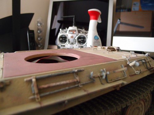

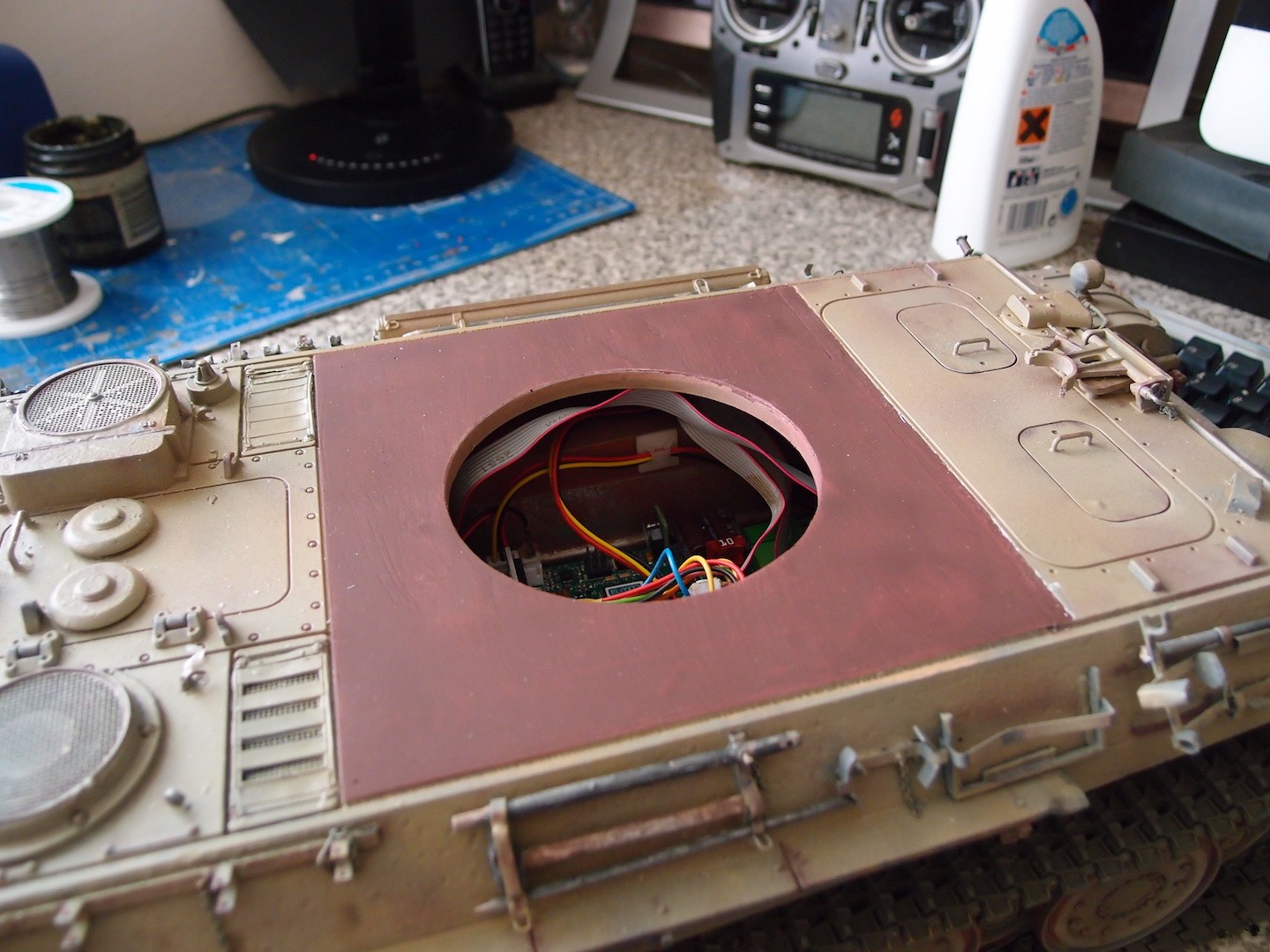

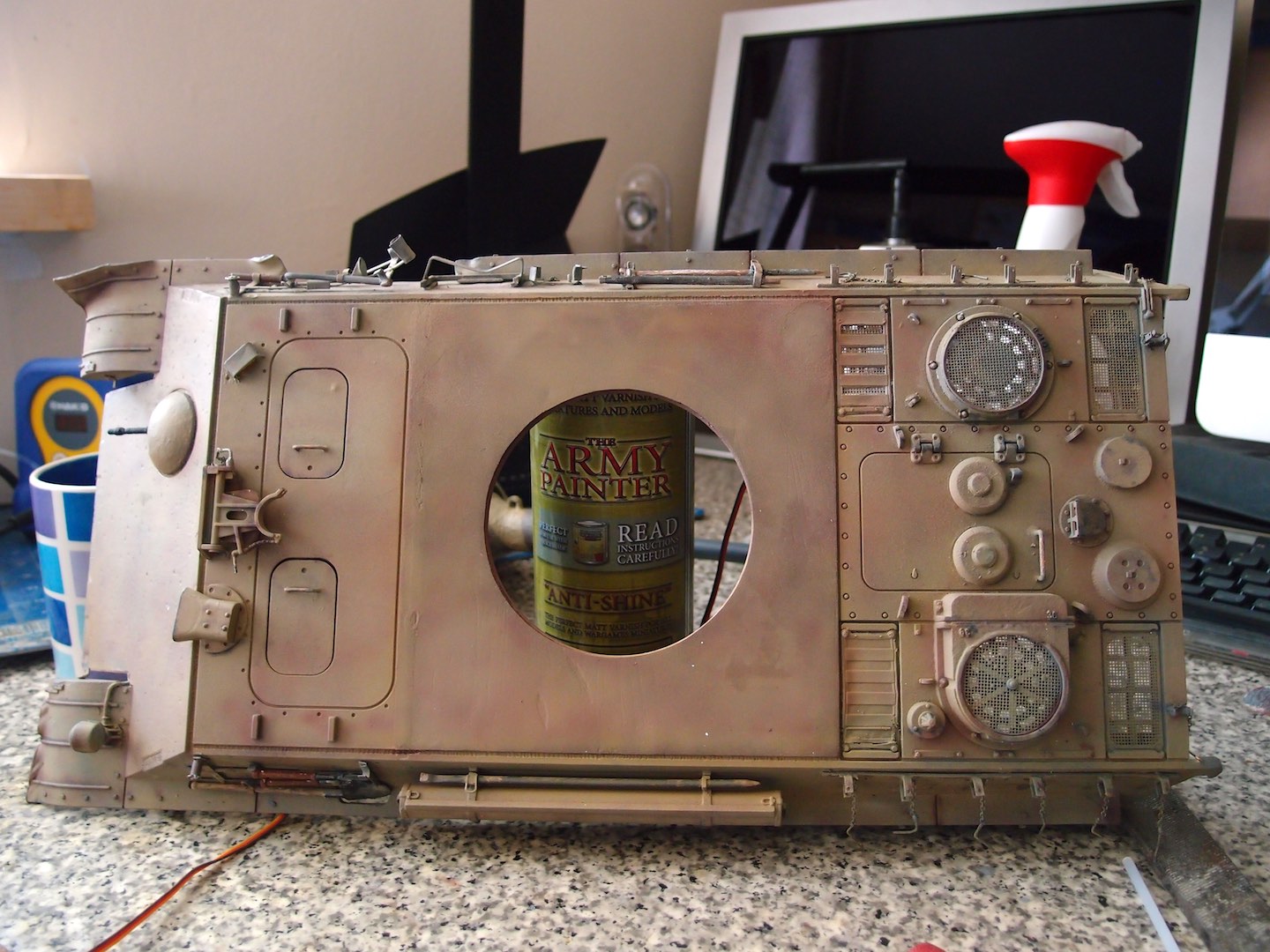

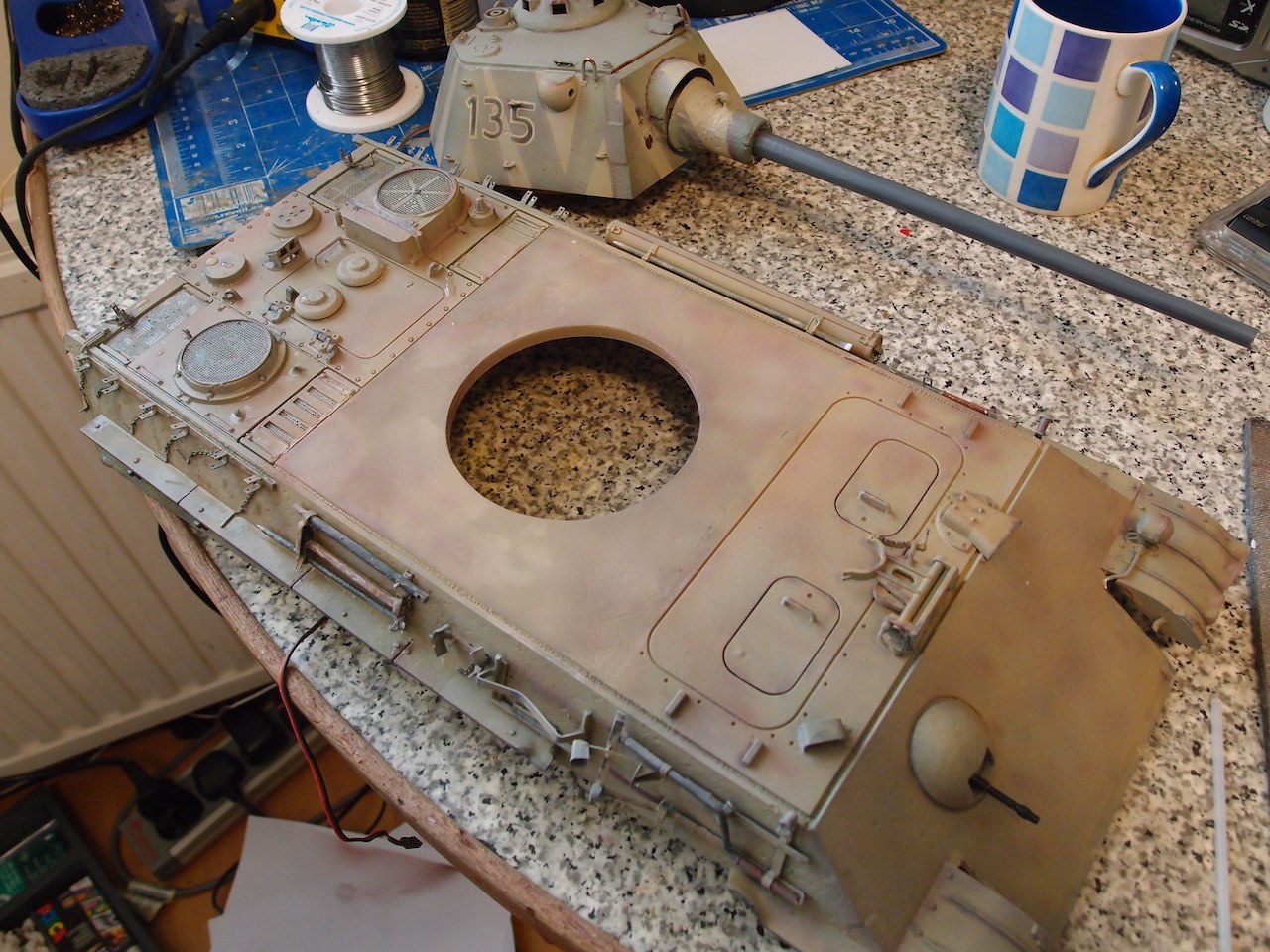

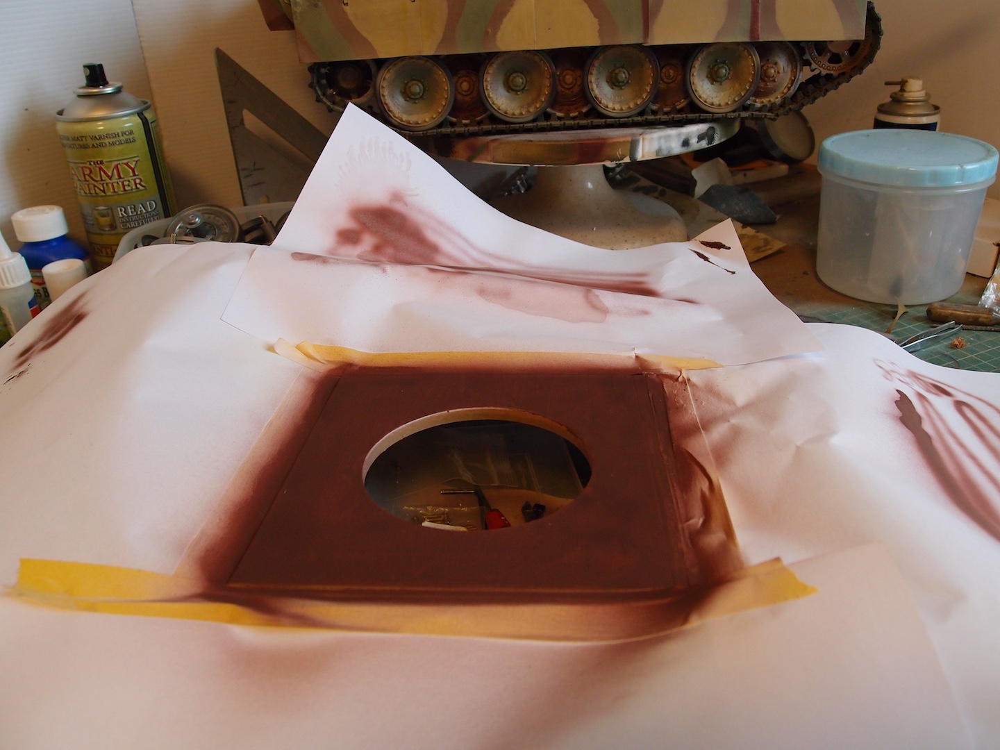

Fixing the deck part 2. Some styrene and Tamiya tape and paper.
Re: Panther F

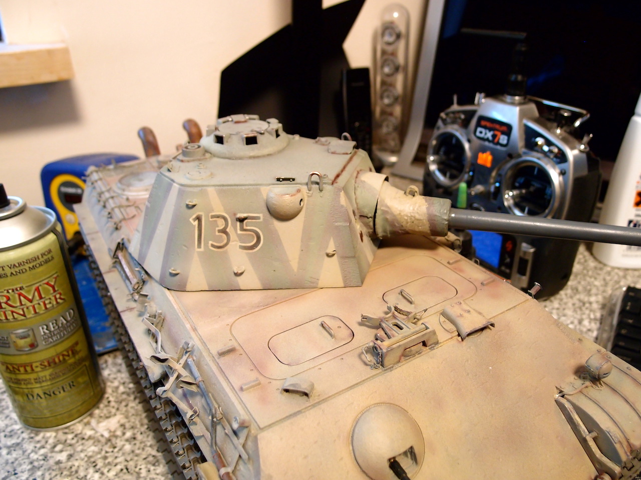

Part 3 painting the corrected deck, a little hiccup when i sprayed the matt varnish it slightly reacted with the paint . The army painter anti shine stuff is hot never left the paint long enough to harden , Tamiya varnish can go on after an hour.

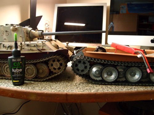

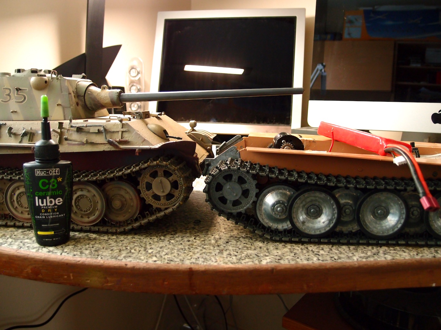

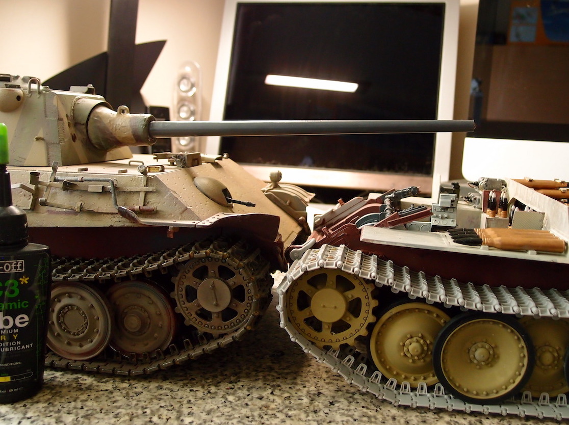

Almost fixed the sprocket hight , cant get it further forward . HL hull is easy as its plastic, and it has a good write up about fixing the angles of the hull plates at the front on the web

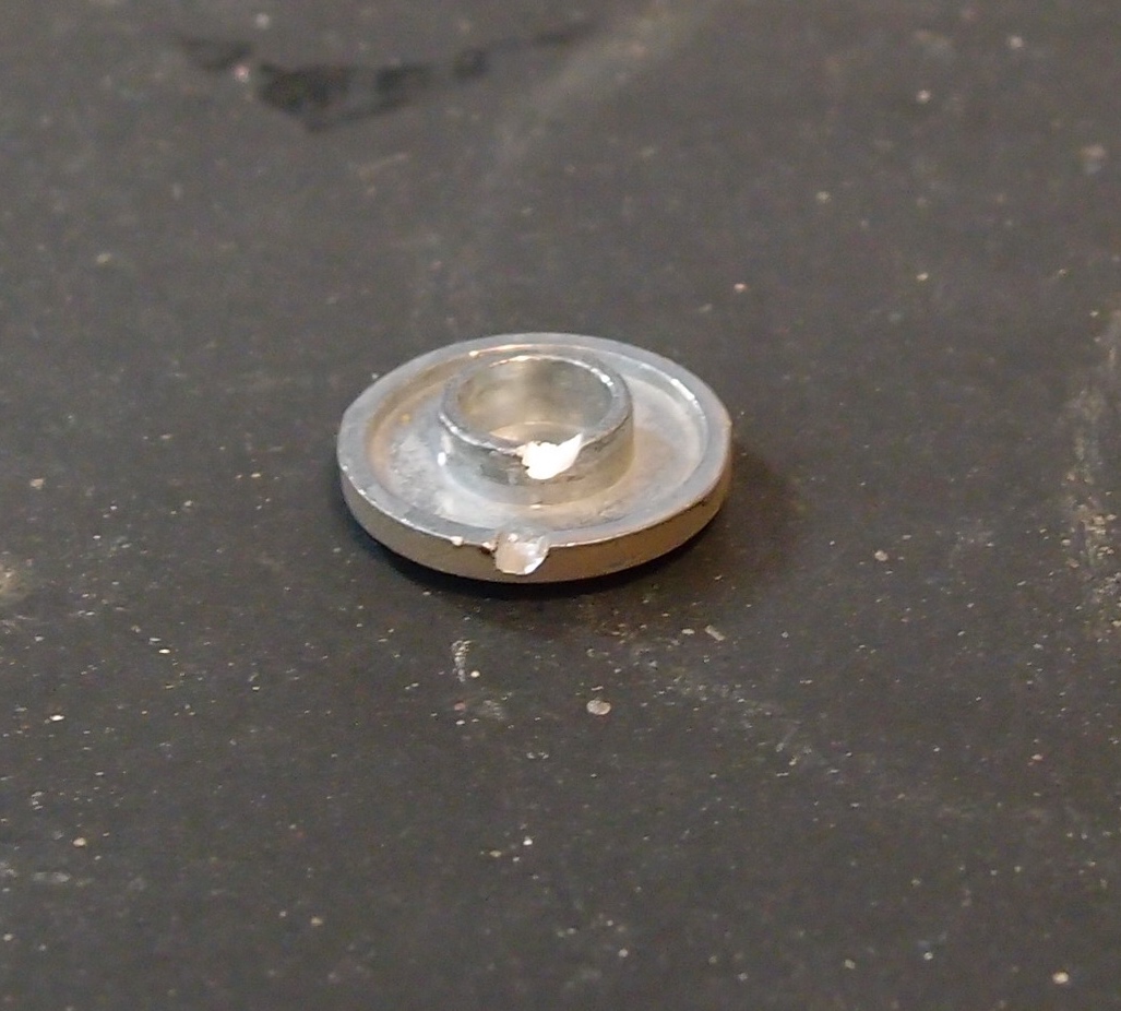

The sprocket caps are tight, cut a slot for small screwdriver to lever off. No need for magnets.

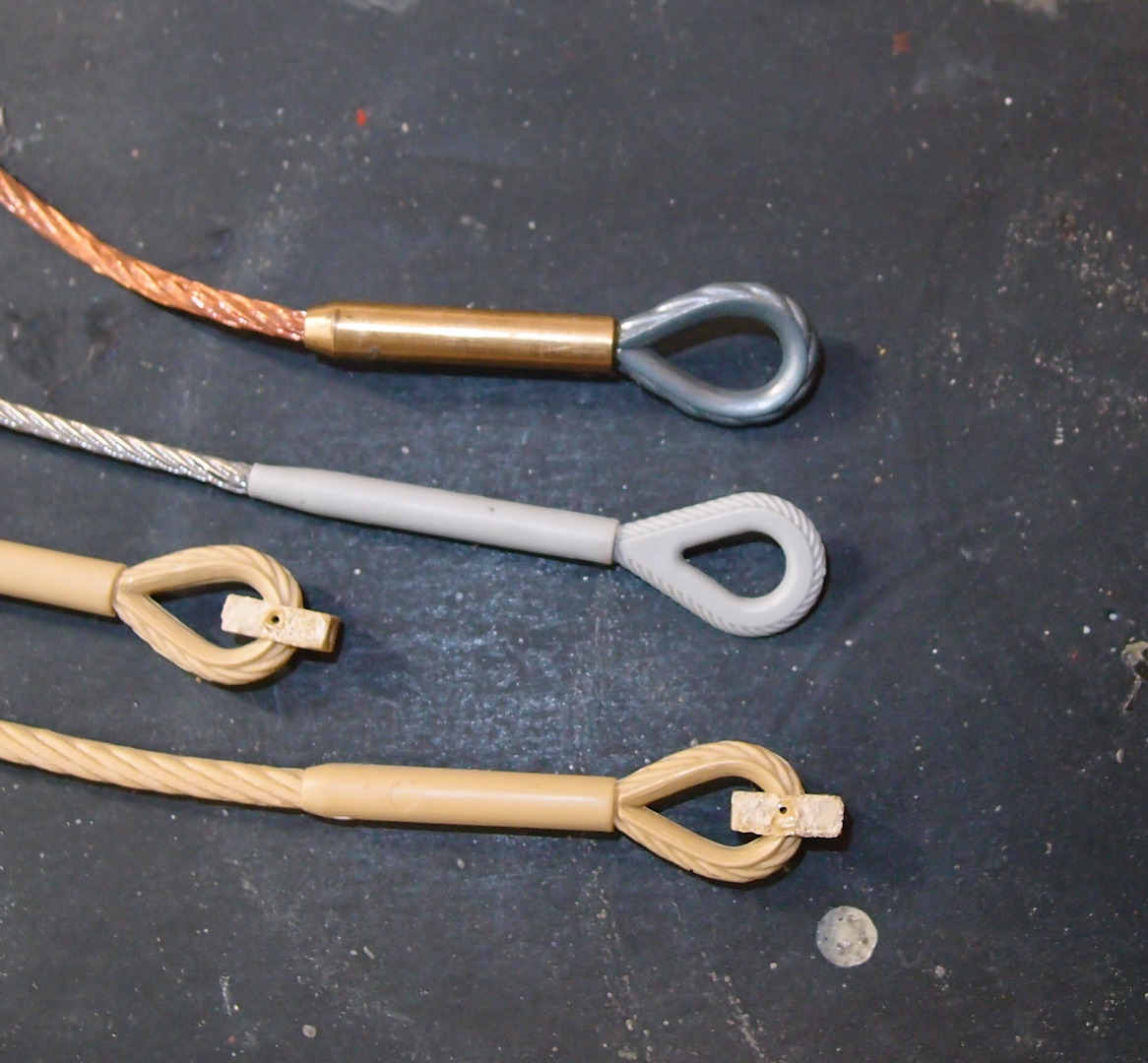

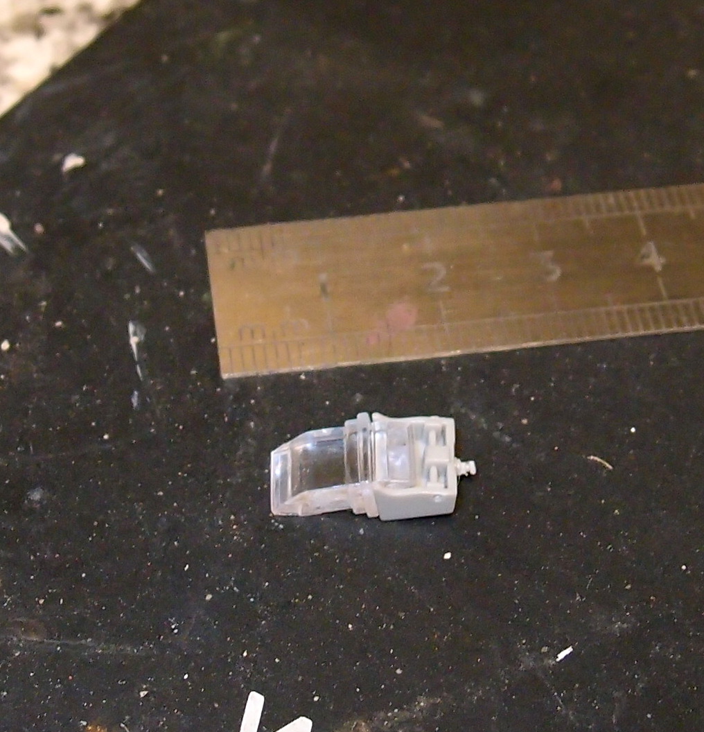

Onto the cables and periscopes, Taigen periscopes are too small. The tow cables , going for Trumpeter cable end as i have SS cable that matches the profile of the cable end
