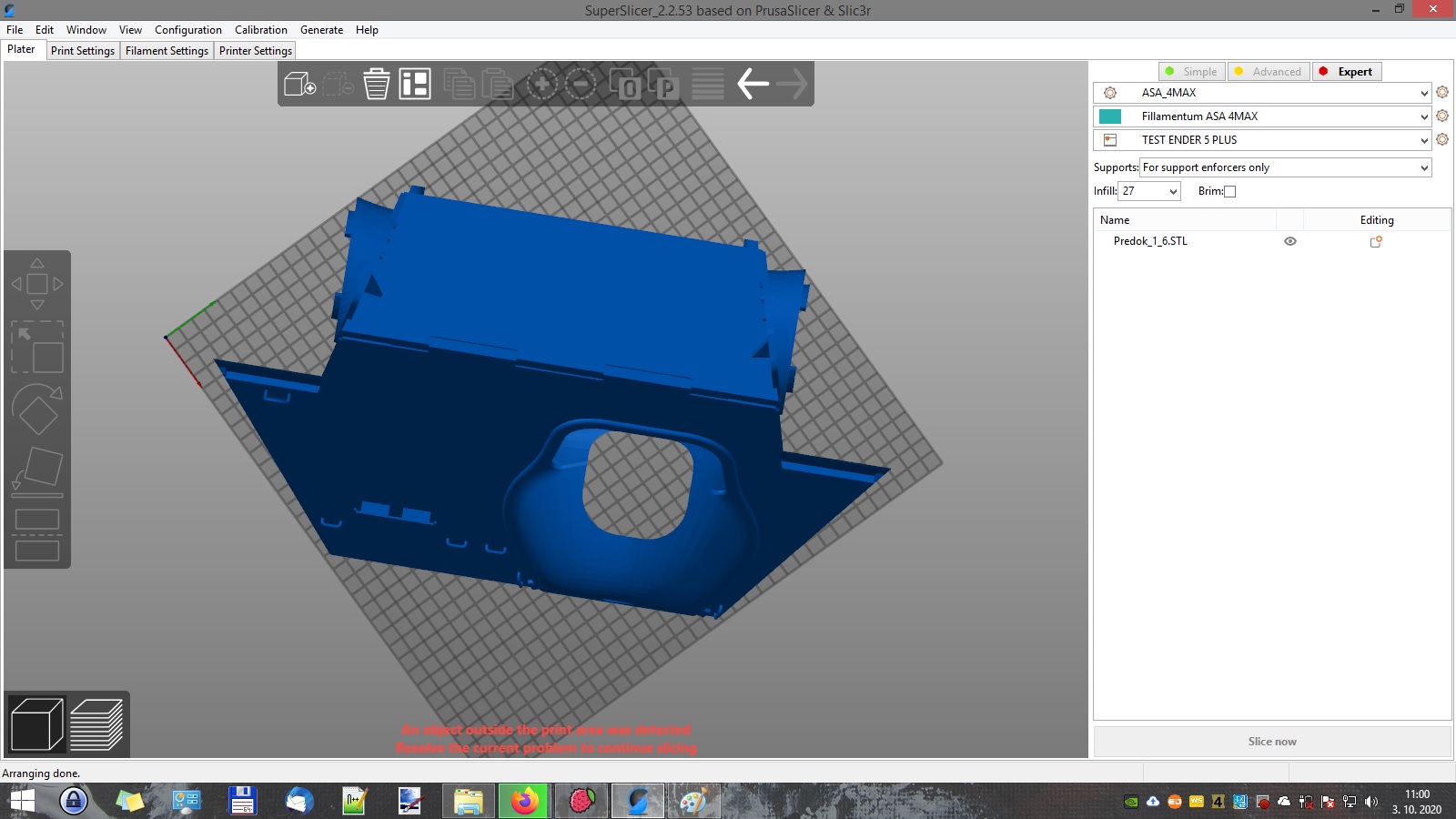

Its on the edge, but it seems to be printable with 350x350.
Rotated by 45°, just a fast check with SuperSlicer.

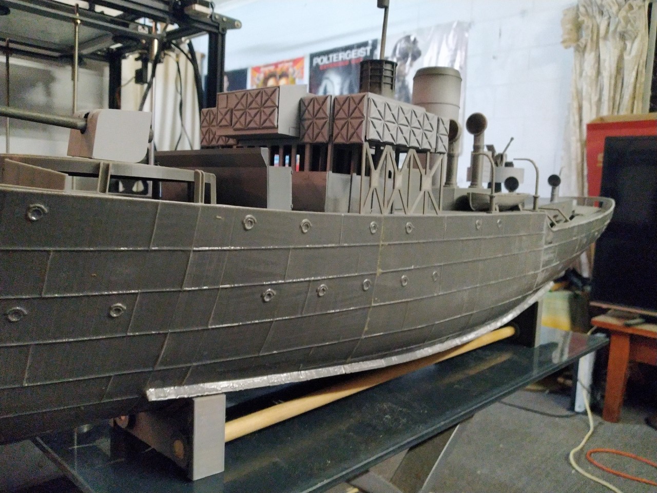

What medium did you print in Wayne ? I have about 10kg of PLA I got cheap , it prints good.
I made this with it but like I may have said I know very little about 3D prining but I know I like it.
That hull has a coat of fibreglass resin over it ready to sand back , that's why it looks globby I made the mix too strong and had to get it on fast.

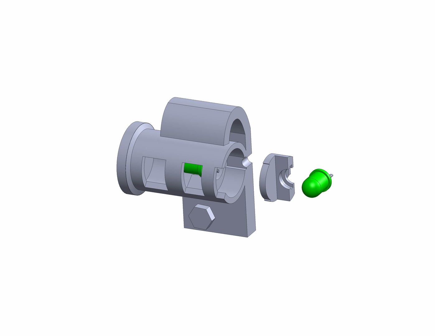

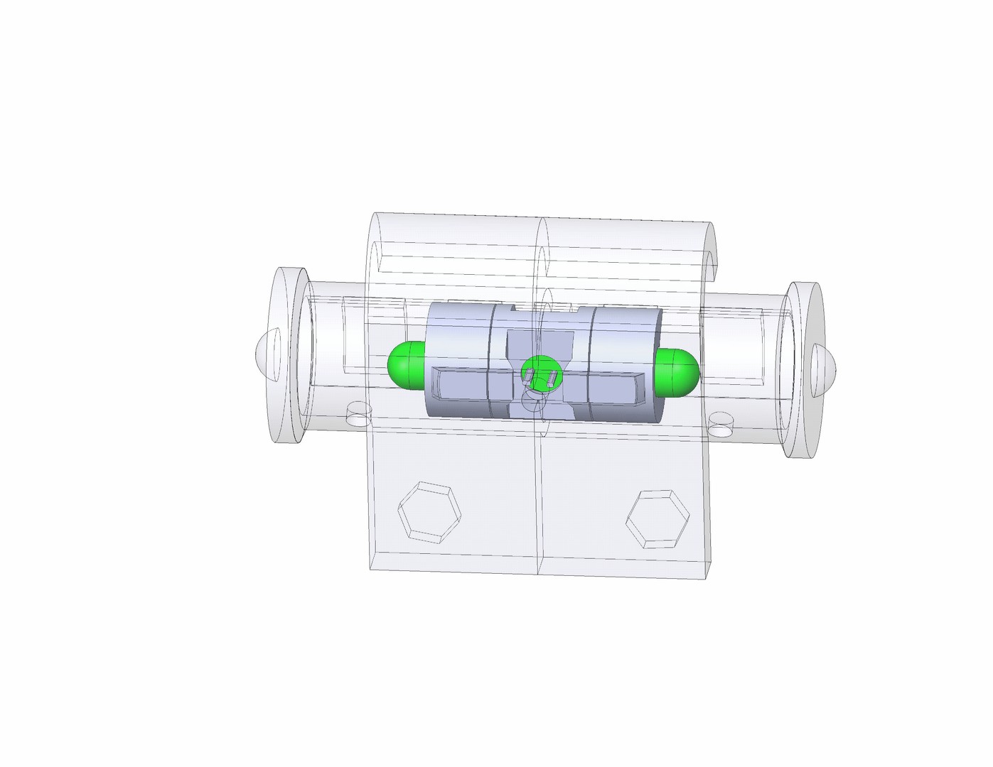

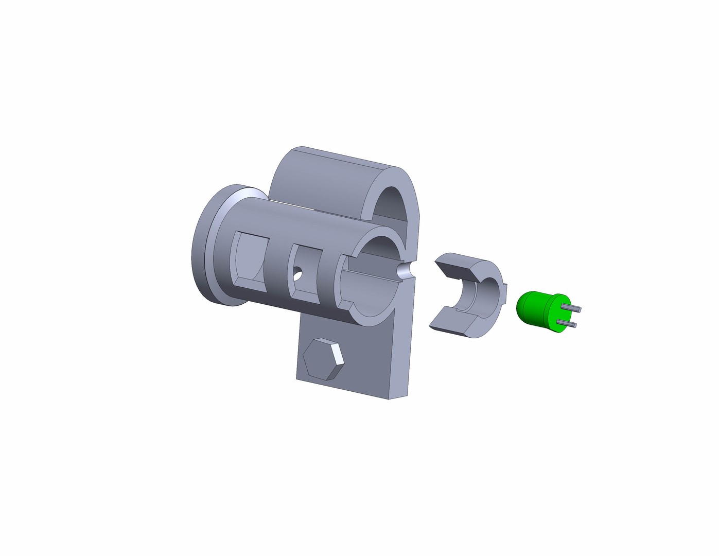

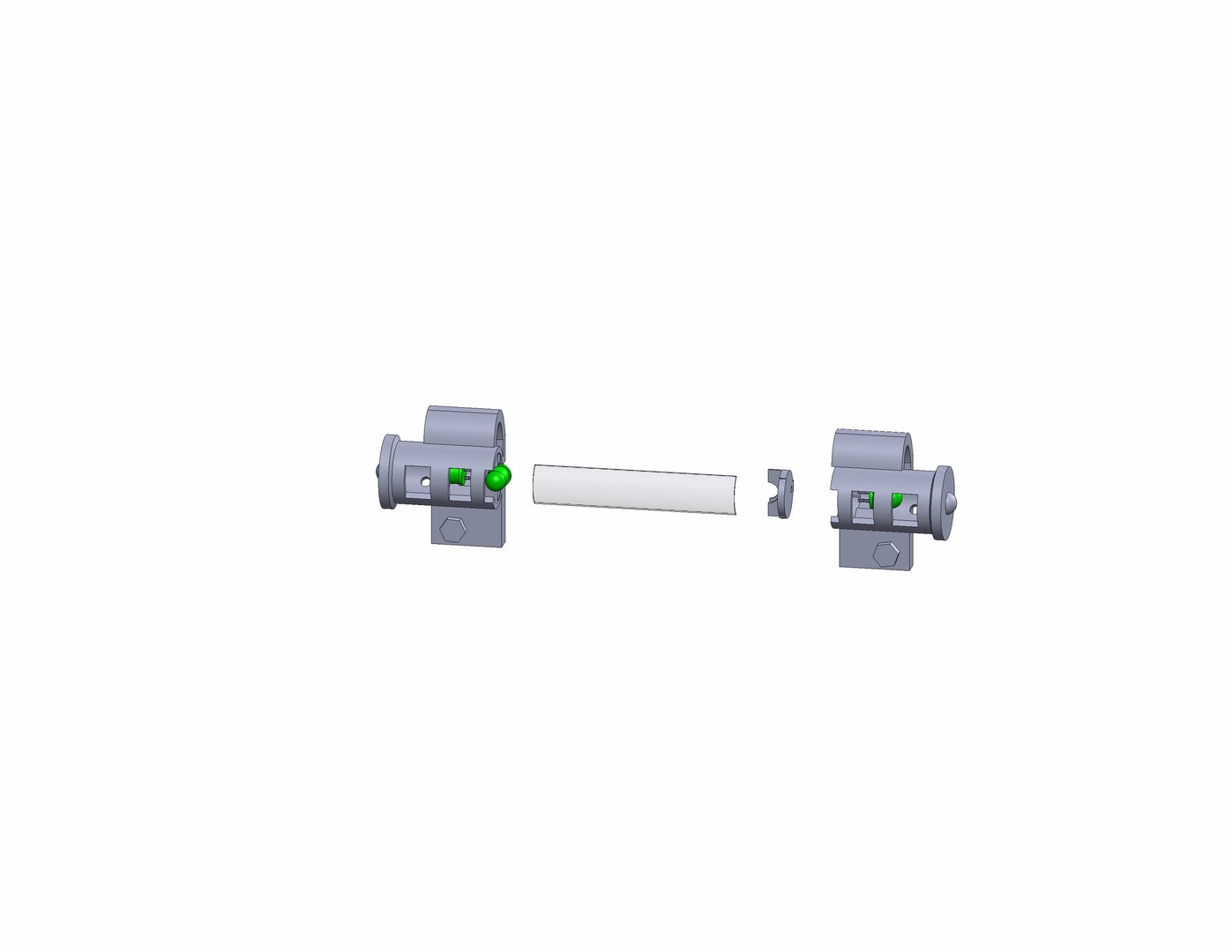

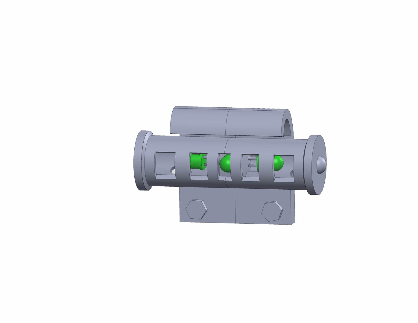

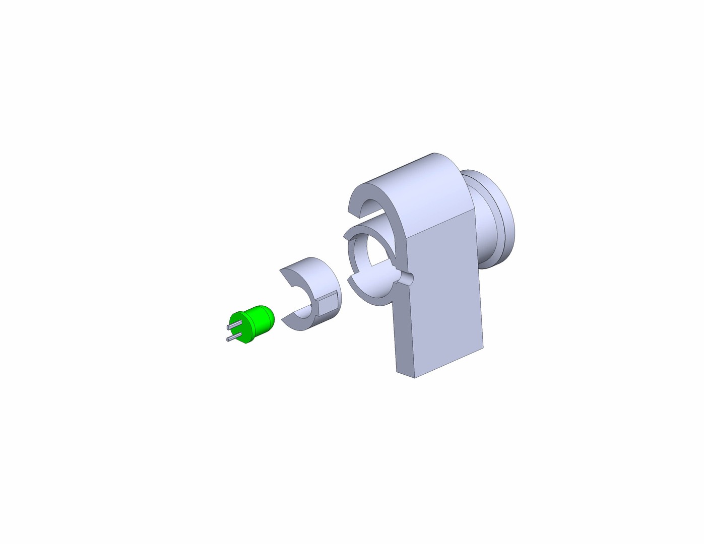

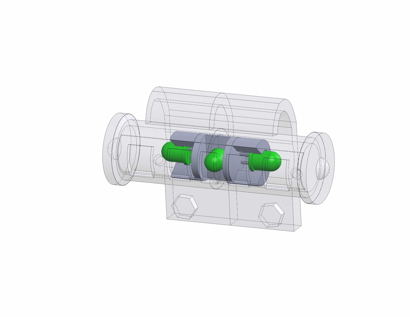

Here is a new tail light for the 1/6 Hetzer.
It contain 6 printed parts, 3x 3mm led lights and some thin transparent foil (of printed one).
