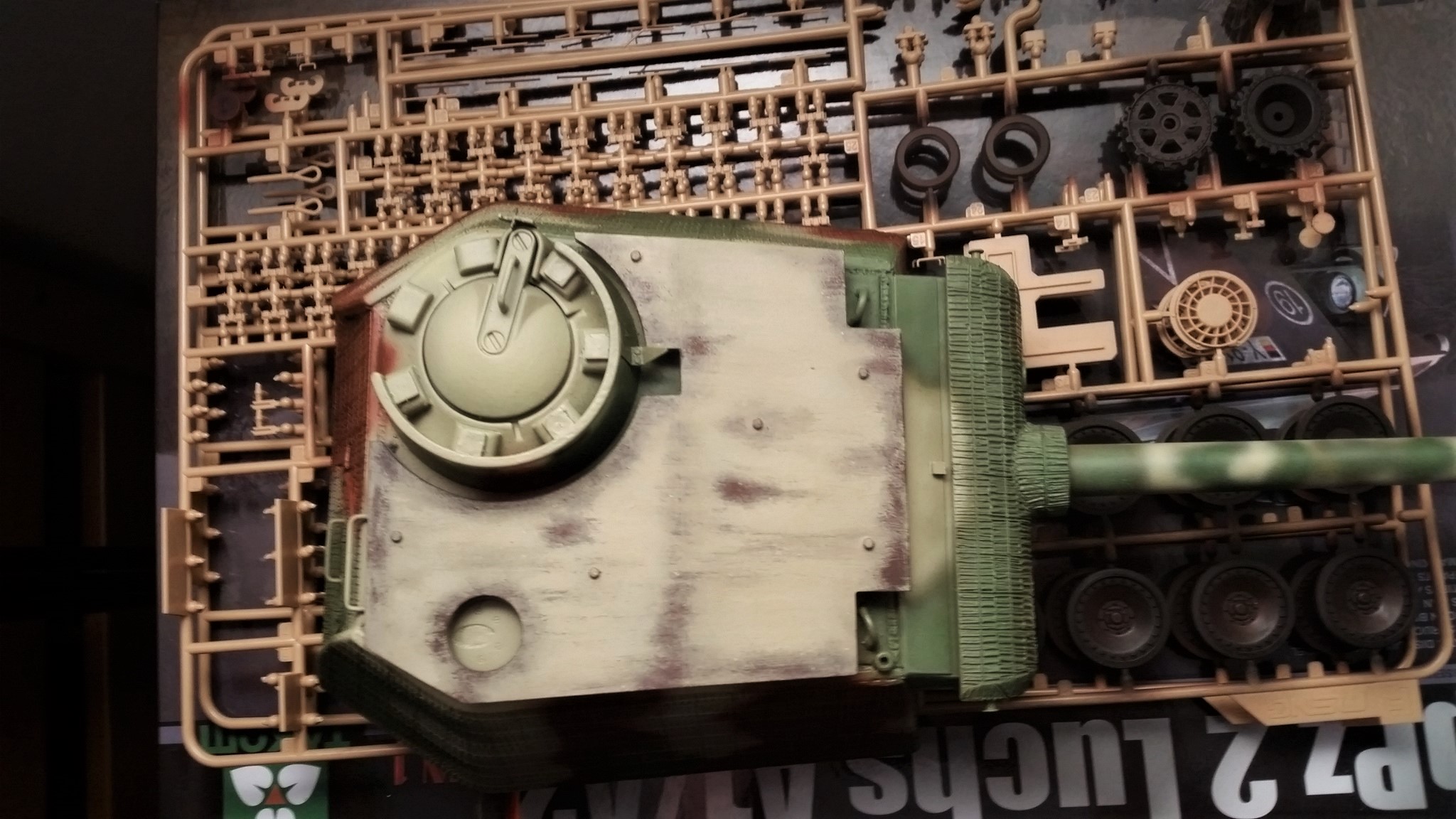

Thank you for looking and your comments.
The AK washable agent is straightforward. They recommend adding 10% to the paint. In the yellow I eyeballed and it was more than 20% and that made the paint really washable. I coated a darker German Camo Beige and then a highlight. The Washing and moving of the paint then resulted in areas getting rhrough to the brownish base coat with really fine chips, more like you would expect from a white winter camo. (note to myself, need to do a white camo one day). The two layers of paint, both washable, intermixed during the process. And gave it a flat varnish.
This was the intermediate result
The brown and green camo were then sprayed on with only 10% of agent and the paint reacted a bit different. With larger chips to appear and less "washing". Not sure it this is how it works. Have to try it more on some models.
The ArmyPainter washes then helped tone it down, especially the harsh CamoBeig with RAL 1001 highlights. Went with flesh tone and soft tone, both reddish brown translucent products, that really do well for glazing. Might work as acrylic filters as well.
