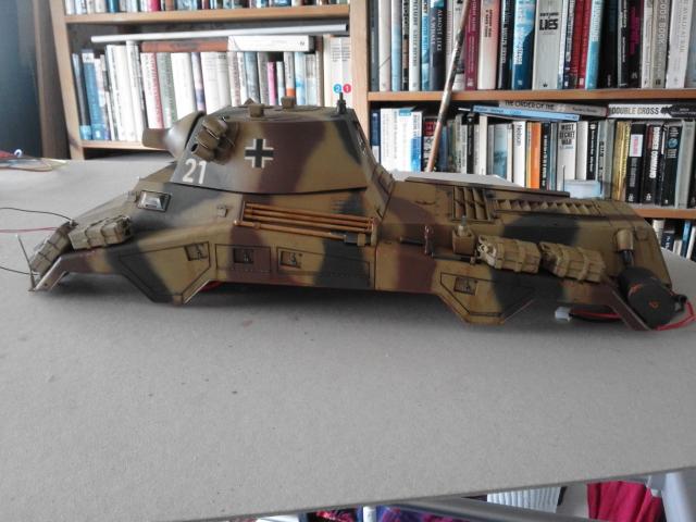

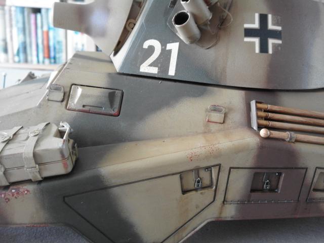

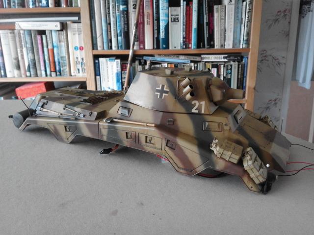

I've now had a go at applying streaking grime. I tried to get something that was noticeable but not in your face. I'm not sure how well it all shows up in the photos. It looks a lot grimier in real life. The vehicle has also had a coat of matt varnish, and I toned down the decals by spraying a thin coat of the tan wash that I used over the whole body. I am still wondering whether I should put some dust or mud on the lower portion of the mudguards. Constructive comments and suggestions are welcome.
The next stage is to remove the mudguards, fit the body to the chassis and power it up. Hopefully, at least some of it will work as it's supposed to.
Richard

You are right, the streaking is not too obvious in the pictures. To make that come out in the pictures you need fantastic lighting. As soon as you are happy with that, you should stop it. For the mud and stuff. In my opinion , mud adds character. But... After following so many different builds on this and other websites, I realize that a 1/16 scale rc tank is a different matter compared to a smaller scale static model. You try things on the static model and if you aren't happy or want to have a less/more muddy tank, you just buy another model and start over again. The 1/16 rc model might be the one and only of that particular piece. If that makes any sense :think:

It probably has not helped by taking the photos with my phone rather my DSLR. I've tried a few more, although the colour balance is still not right. When I've finished, I shall have to take some with a proper camera!

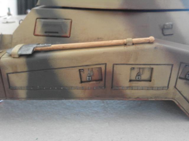

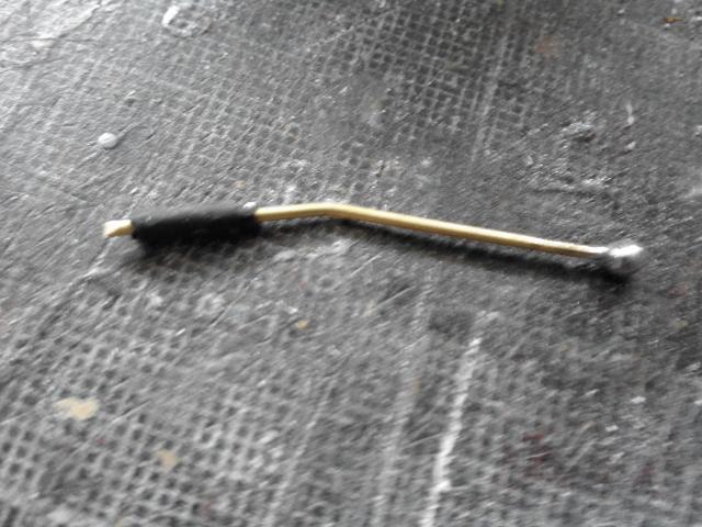

c.rainford73 wrote:Richard sounds excellentImage Sorry you've run into trouble with those parts. Do you have a picture of the bits that broke off? Looking forward to seeing you finish this Image
This is the one remaining intact one.
This is the base of the broken one.
I have the broken off part, but somehow don't think trying the glue it back together is a viable proposition.

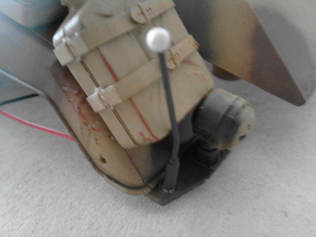

And this is my first attempt at making a replacement. It is bent brass rod, with some heatshrink at one end and a load of solder to represent the ball on the top. It was all I could think of.
It's not a perfect sphere, but every time I heated it up to reform it it went completely t*t* up.
If any of you expert builders have any ideas they would be very gratefully received.
Richard
Re: Metal Origins SdKfz 234/2 Puma
The rod looks perfect I like your idea of the heat shrink could you use some epoxy to make the ball for the end and mold it and then sand it
