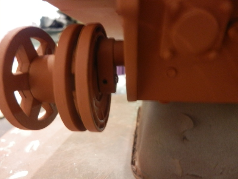

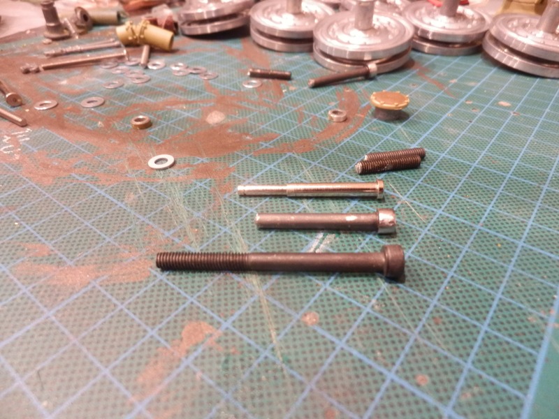

Got new axles for the idlers.
As the tensioner was slightly wider than the plastic moulded ones (plastic at 140mm o/A and the tensioners 143mm o/A) plus the reduced diameter of the stock axles being 3mm where the holes in the new tensioner hubs are 4mm, needed to make new axles.
Went to the bolt shop & got M4 cap head bolts(grade 8 HT) with sufficient plain shank to allow the thread to be cut off & the remaining shank fit into the new tensioner hub perfectly.
The stock idlers have 2.5mm spacers inside over the axles and I had 3mm to much over all across the new set up.
So a simple addition of a 0.5mm flat washer on each side will be fine to reinstate the idlers into position on the new mounts.
I will fit the suspension arms & clock the first & last springs.

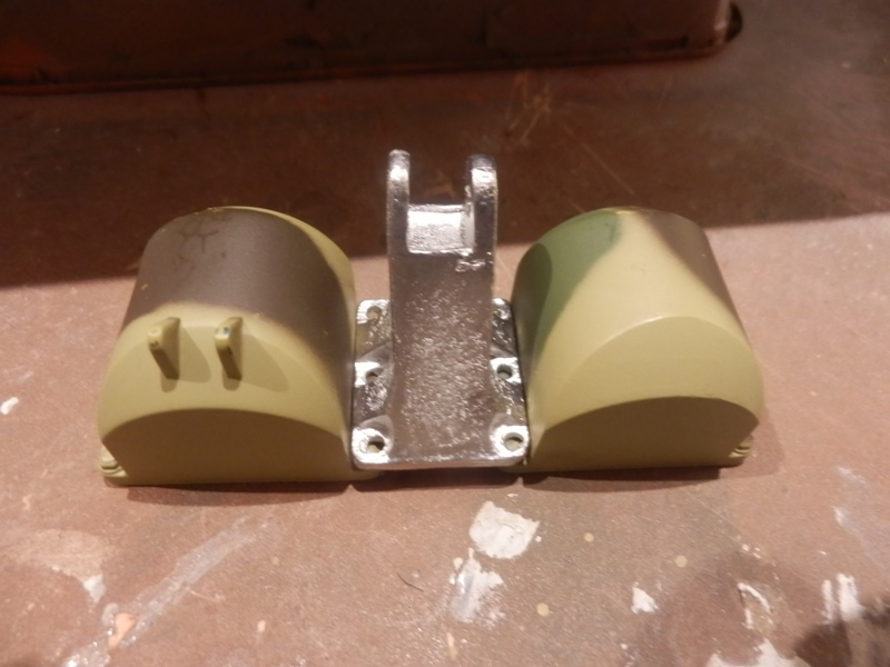

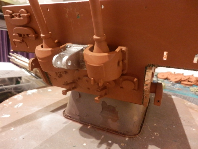

Thanks to Mr Sassgrunt from Hawaii I am now a proud father to a Kubinka style tow hitch
It only needed a minor sanding off the outer edges and it will go straight on.
Only thing I have to do is remove the metal bolt heads off the shrouds & fit the hitch, then place new bolt heads onto it.
I think carefully recovered plastic bolts from the stock shrouds will do for that.
Assuming I cant get proper bolts, that will do.

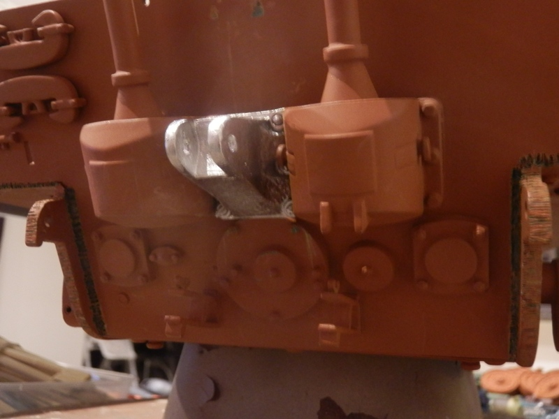

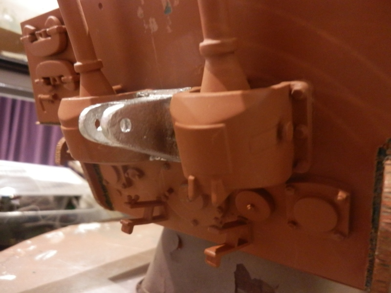

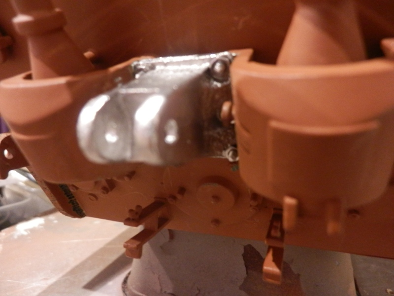

Its on. The tow hitch is secured.
Got a diamond cutter on my dremmel and mowed the cast nuts off the metal shrouds.
Finished with a file.
Pilot drilled one hole where I thought it needed to go and checked the hitch.
Drilled the bolt hole to 1.8mm and secured the hitch to the back plate.
I found some 1.8mm bolts & nuts in my spares box, again, no idea why I even have them
Once on, used the hitch as a live template to drill all the other holes.
Filed off the burrs & on it went.
Backed the bolt heads with washers to spread the tension on the inside of the plate & I reckon that thing will pull Jesus off the cross
Thanks again Mr Sassgrunt...............I love it and its miles better than a made up one.
All thats left on it is to secure the pin & chain.
