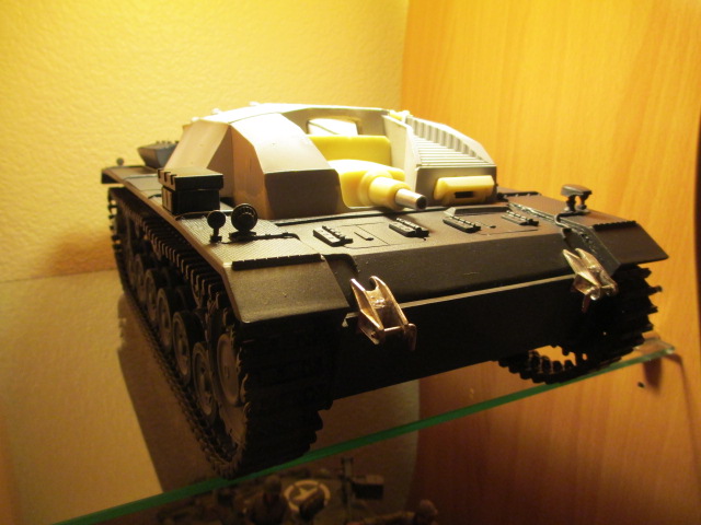

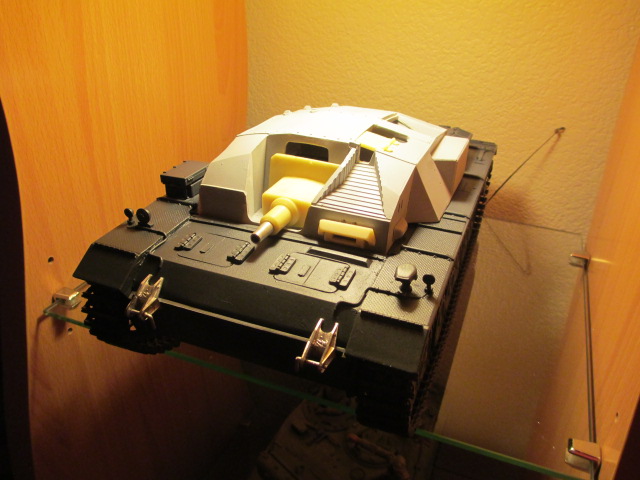

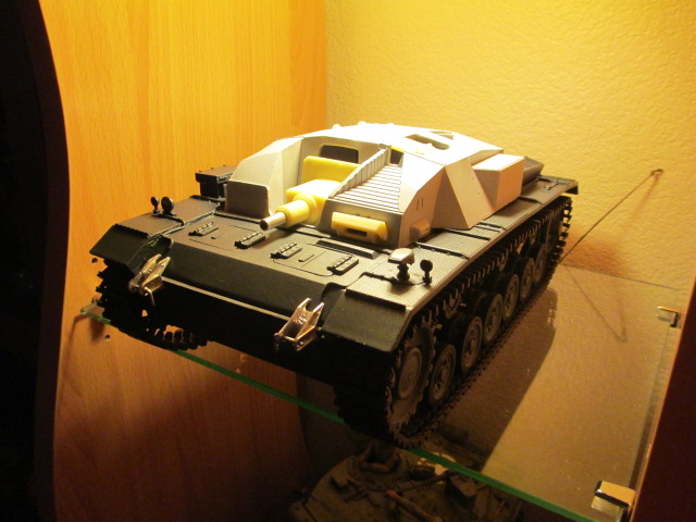

*chuckles* Great recipe for cheap pizza. I will definitely try it one day with some crusty French bread maybe. Kiaser got me thinking so I just ordered a few Pies for dinner for the house. Jack, Alpha is exactly right. I've seen your work so don't put yourself down. When the day comes that you find something different that you want that will require a Frankenpanzer build, I know that you'll do excellent work on it. Here are a couple of shots for tonight. I didn't get anything done today as it was Lawn and House chore day but I'll have plenty of time this weekend to start working on installing more detail on the Deck.
R. Bow Partial
R. Bow Partial
L. Bow Partial
L. Bow Partial
L. Bow Partial.JPG (98.94 KiB) Viewed 3987 times
Bow Partial
Bow Partial

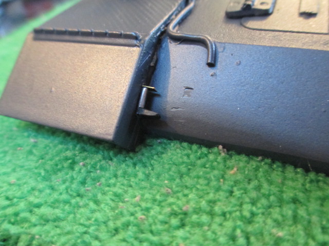

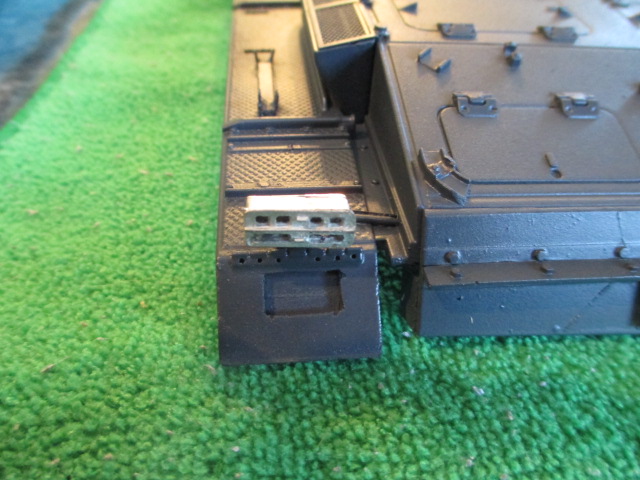

Yes, Sass' Books have saved me a ton of time and allowed me to add detail I would have missed otherwise without extensive page flipping on a number of other websites. Those indents go all the way through the rear fenders so that if the upper fender is flipped up, the light shows through it. ;o) There is an under fender section bolted on that braces the upper fender when it is down. Looking forward to pics of yours and Herman's StuG builds.
Tiny bolt holes underneath.JPG (88.35 KiB) Viewed 3968 times

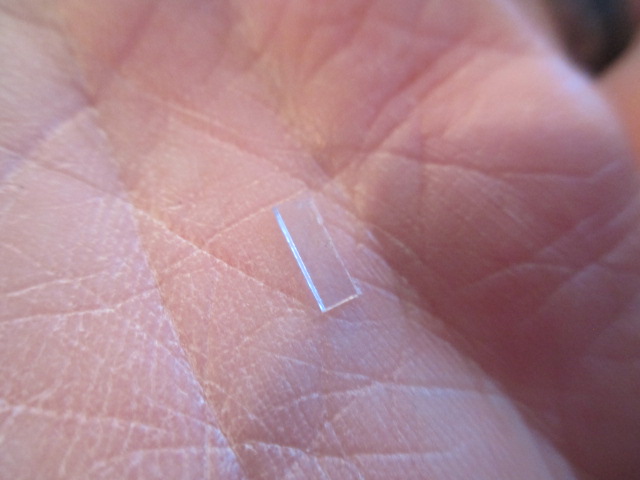

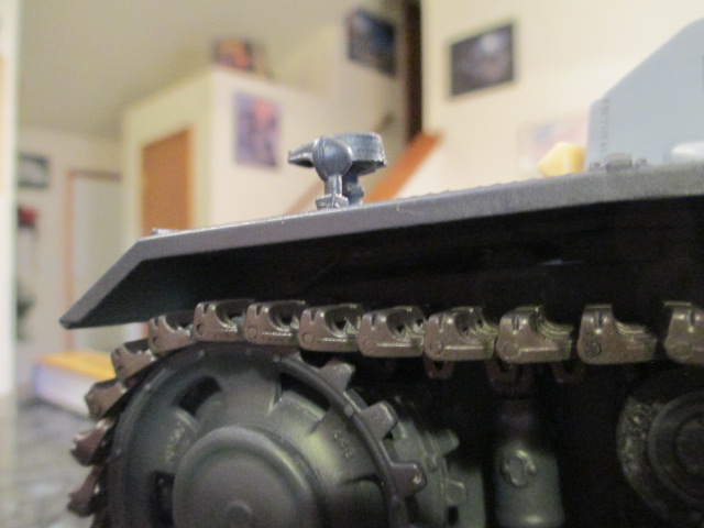

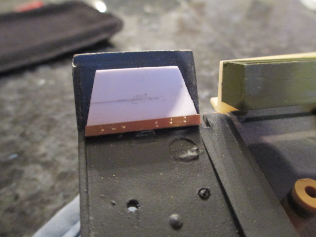

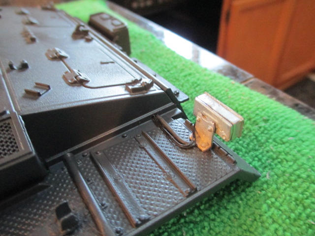

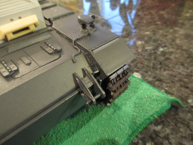

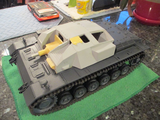

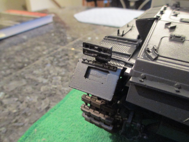

Today was a Deck day. I was able to use a new tool I had found some time ago and only recently purchased as they were on sale. The 'Stix' were very useful in assembling the tiny scratch built Fender stays. A little touch up painting was performed then since the previous spray job had thoroughly cured. I usually just spray a little of the matching color in a disposable plastic container and brush up any thing needed. After the Fender stays were assembled and mounted, I worked on getting the Convoy lights wired and mounted front and rear. All in all a good afternoon's worth of fun. Pics:
More progress made...
Front details painted
Convoy light painted
An-Bri-RC rear Convoy light is a little bigger than my prepped slot in the rear fender but not much help for it now.
Nicely detailed light with wiring mounted in place.
Front Notek light wired and lens in place
Front Notek light wired and lens in place.JPG (87.2 KiB) Viewed 3816 times
The An-Bri-RC kit for the Notek light did not come with a lens so...
The An-Bri-RC kit for the Notek light did not come with a lens so....JPG (79.29 KiB) Viewed 3816 times

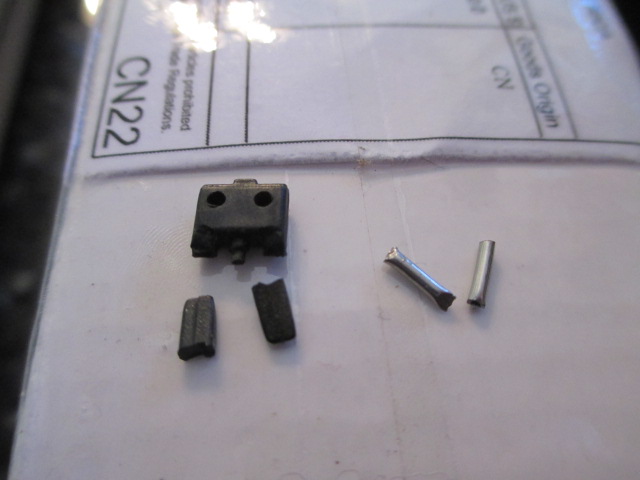

...makes a set of Fender stays for added detail up front.
A couple of pieces of solder, and a chopped up Pershing tank center link along with two small brass squares...
A couple of pieces of solder, and a chopped up Pershing tank center link along with two small brass squares....JPG (71.86 KiB) Viewed 3816 times
Stix are little sticky tip handles that aid in tiny parts placement.  Just place, let the glue set then rotate the Stix and it releases.
