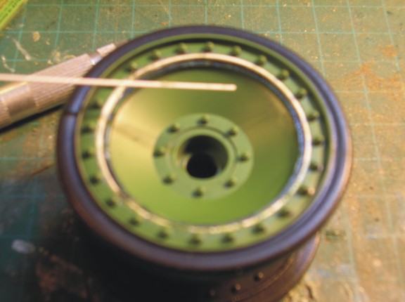

Enough playing with brass So now I want to address the HL road wheels ridge issue. I see some different methods tried by lots of people usually involving putty which I wanted to try and avoid so I choose styrene itty bitty strips and some knife work. So first here is the pic showing the ridges that everyone talks about.
Panther A 212.jpg (65.33 KiB) Viewed 4077 times

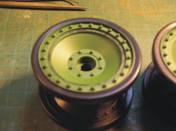

Take a new xacto knife blade and snap the the tip off. I use this to scrape the paint off so we are gluing directly to plastic.
Panther A 213.jpg (49.11 KiB) Viewed 4077 times

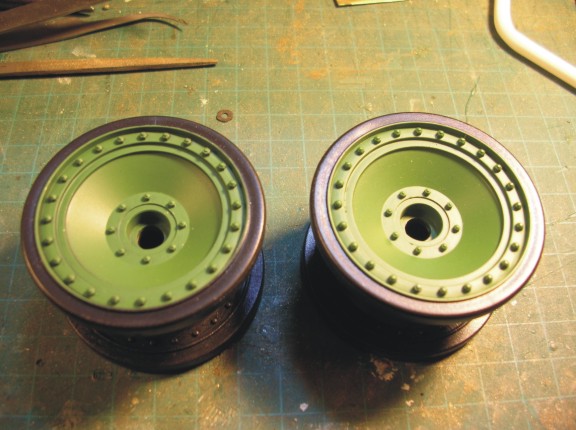

I am using .020 x .030 strips of styrene
Panther A 214.jpg (57.92 KiB) Viewed 4077 times

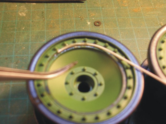

Sorry these are a little blurry. So using Tamiya extra thin glue I dab a little on the wheel and dab some on the beginning of the strip and wait 30 seconds till it gets a bit tacky and then using the curvd tweezers I start putting it into the groove
Panther A 215.jpg (47.87 KiB) Viewed 4077 times

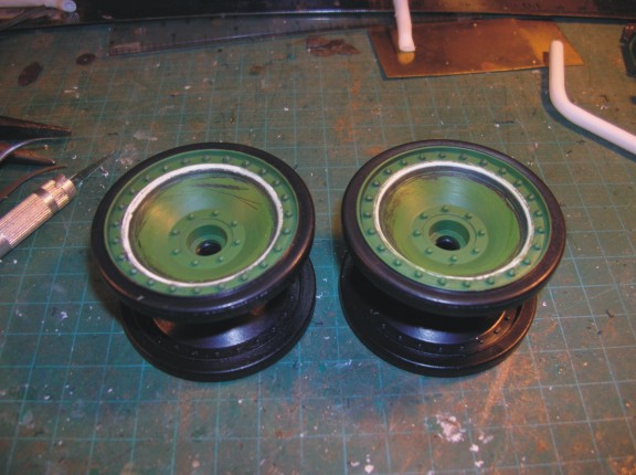

It takes 2 strips with this method so started the next one
Panther A 216.jpg (44.77 KiB) Viewed 4077 times

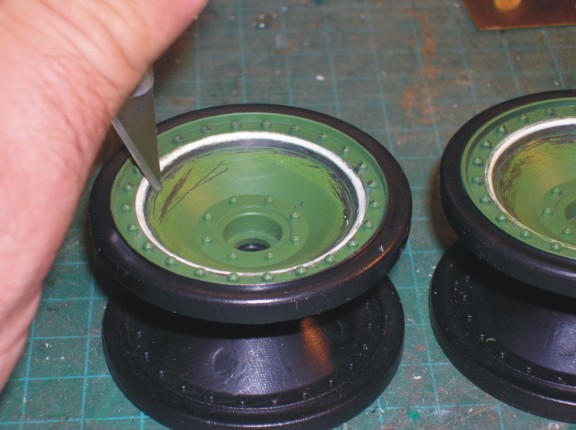

Let these dry OVERNIGHT!!! if you start on them any sooner the styrene will still be soft and it will mak a mess. Then using the knife with the broke off tip start scraping away any ridge that is left and rounding the new white styrene into the wheel.
Panther A 217.jpg (54.73 KiB) Viewed 4077 times
And finally a little sanding and gentle filing making sure not to hit the bolt heads and you have a more realistic road wheel.
Panther A 218.jpg (62.15 KiB) Viewed 4077 times
