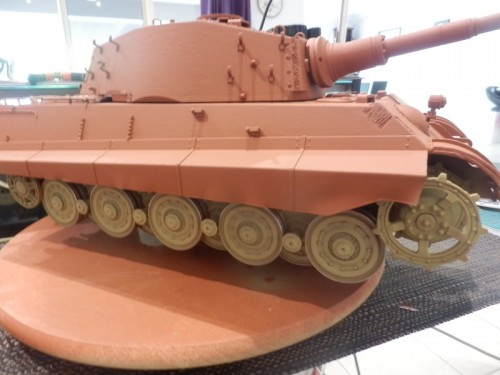

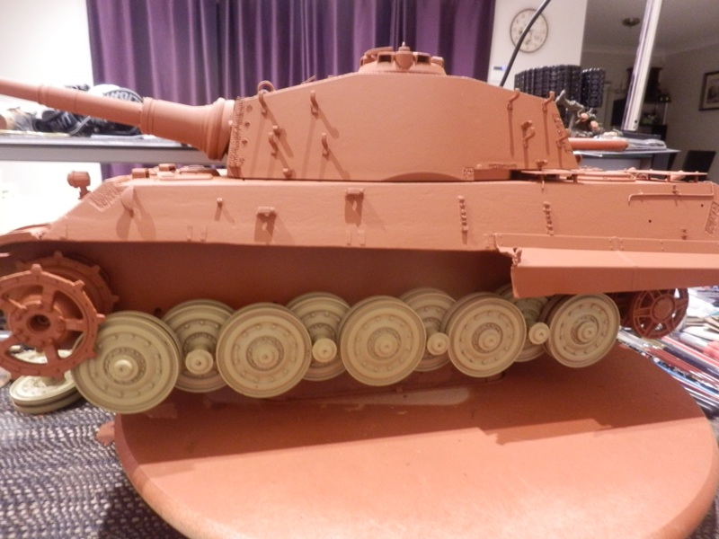

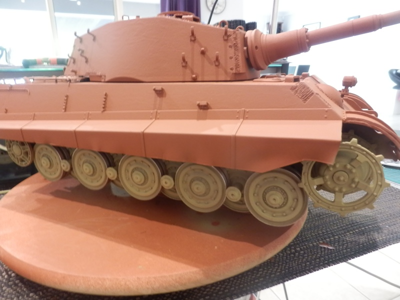

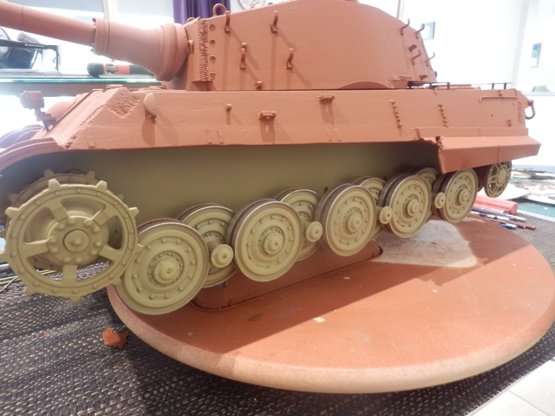

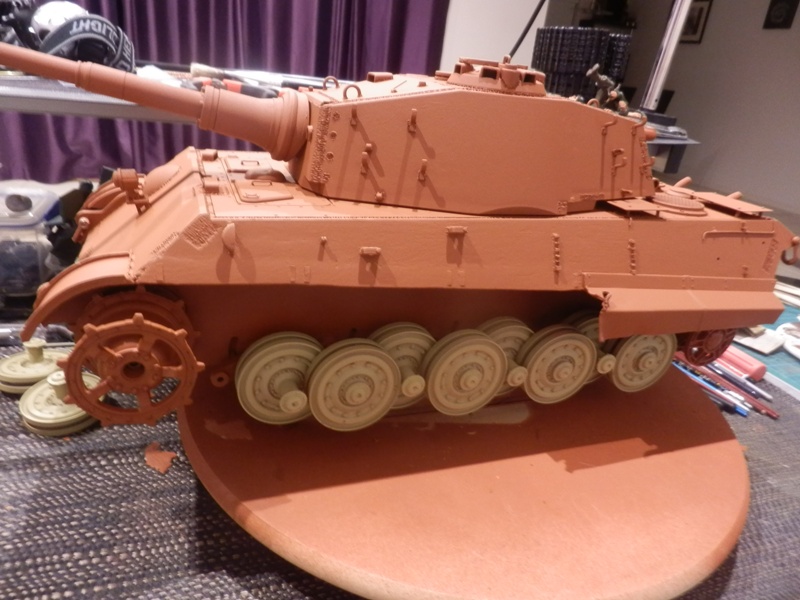

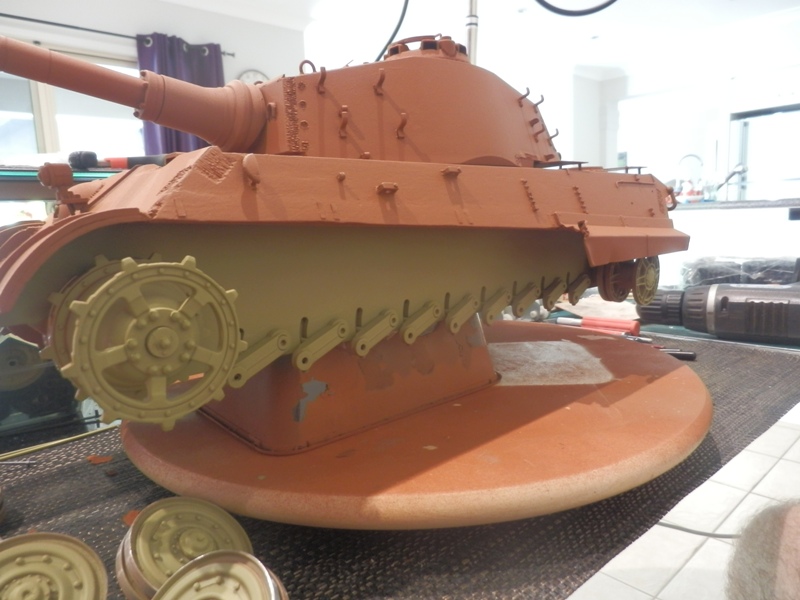

I dry mounted the road wheels today................something was not clicking ?
The dunkelgelb paint in the lower hull/sponson area was right, but once the wheels were dry fitted, things didnt look right.
Set to the resilient wheel 'tires' with a file & sand paper.
Took the coating of paint off the outside & then side filed the rim lips to remove paint as well.
All of a sudden things got right.
Once I attack the gelb covered hairsprayed wheels to get some- but not too much- weathering & scratches, the rims will look much more 'on'
The automotive self etch primer & Tamiya XF 60 dark yellow stuck like baby shit to a mattress cover
Round file & a cordless drill...............Herman 16- Babay shit- Nil

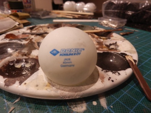

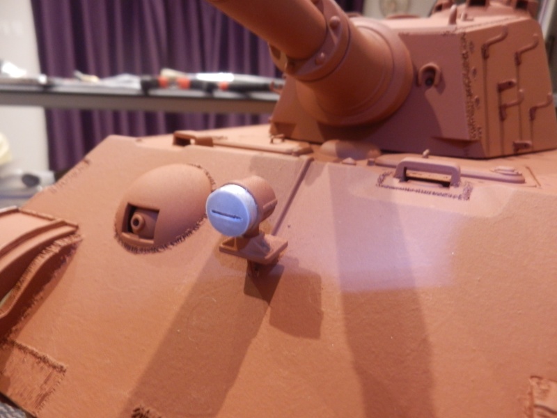

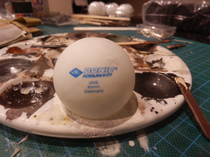

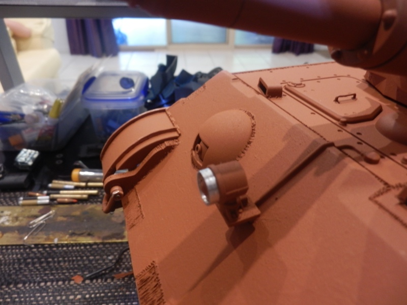

Messed about with the headlight today. Went out & got some aluminium tube (alloominum toobe) to make the surround for the single headlight. Needed a small length, approx 1/8" or 3mm long and 5/16" or just over 8mm I.D.
SO..........home I went with a 1 Metre long -10mm toobe.
Mrs B was out & about so the txt went out for to bring me home a slightly curved, thin section plastic material I could slot to make the cover aperture..................
Ping pong ball
High quality, German made ping pong balls in a blister pack, 6 of them for 5 bucks..............and I needed a bit the size of a 5 cent coin (thats about negative 8 million Pounds/2.7 million USD!!)

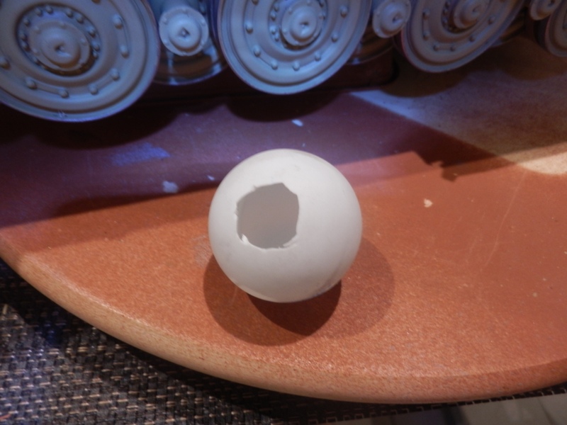

Drilled out the toobe to suit the light bulb & filed it down untill the H/L bulb was just below proud of the edges.
Hacked into the ball & set the two together with plenty of cyno & thinners to get the internal gunk off the skin of the ball.
Did the slit with my left finger
and the knife blade
Really need the light to operate so I dont leave him switched on by mistake.(I have a similar system installed in me as an early warning for the Mrs - it works for her every time !!
Ping pong ball
