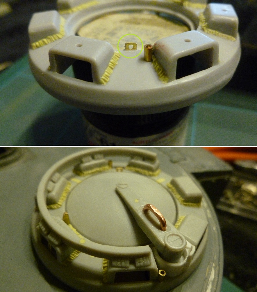

Next little feature was the stop extension that was welded to the back of the forward facing Commander periscope. This made sure the lid when swung forward stopped at the point directly over the aperture ready for it to be pulled down closed. This was formed by drilling into the back of the periscope hood and a small 2mm brass stop plate was fabricated and bonded in.
3mm drill holes to make slot in back of periscope cover.
Brass hatch stop
Brass hatch stop

A very small detail was the addition of a brass sighting vane on the inside of the Commander's forward facing periscope hood. This was bonded in from the Voyager PE detailing kit.
Commanders Sighting vane in forward facing periscope hood.
Another odd feature that makes for some amusement in the fact that a 50+ Ton tank was secured when not in use by a dinky little padlock on the commanders hatch. This hasp was added which came also from the Voyager kit. The last small change given to the Hachette cupola was using a 1.5mm copper wire to form a shorter hatch lifting handle. The original plastic version was too long as can be seen from the filled in hole. The AA rail was then attached, this may be changed as the real AA rail was welded in a position on the extreme outer edge of the periscope hoods and not in the centre as with the Hachette example.
Commanders hatch locking hasp and Shortened lifting handle

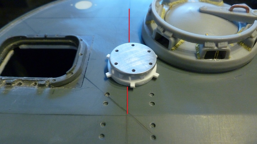

One thing that I have discovered by chance was that the vent was not located in-line with the centre of the roof. It was slightly offset to the left when looking from behind and should be almost touching the Commanders cupola. The offset was approximately 30mm on the real Tiger 1 roof.
Offset Vent from centre line of turret
