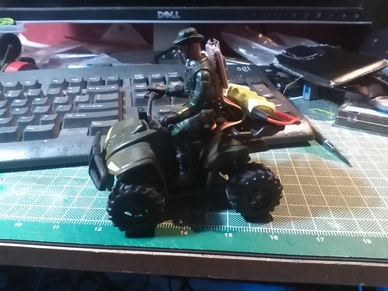

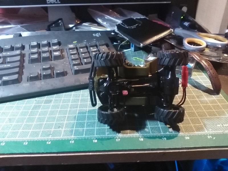

If you want to go to extremes, there is always the 'World Peacekeepers' Quad bike:

That Mini is so cool I'd have to get two so I could keep one to play with. 8)

Posts: 7614
Re: HL Truck Mods
You can get these, although they're more 7th scale and they are reasonably cheap. If you wanted a bit of fun with heng long truck running gear.
H M Armed Forces Desert Quad Bike | eBay
https://www.ebay.co.uk/i/202578178751?c ... 9fffeaf1c7
