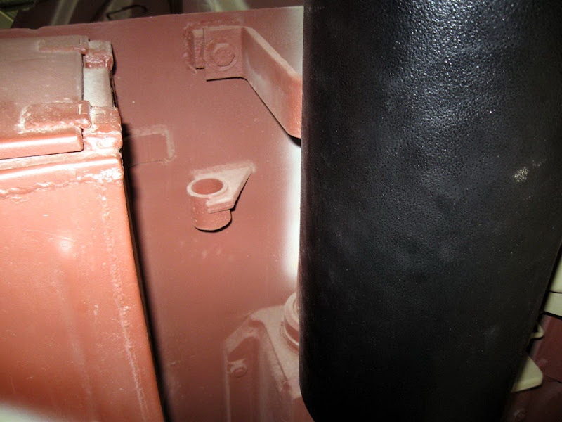

Re: HL Panther G customization diary
Updates contd.
One of the nice accessories that Modellbau makes are the exhaust brackets. I think these are details that HL should have included in its tank but its still nice that they are available from third parties. As you can see the kit comes in three parts, the brackets themselves and the metal base (standoffs) for the brackets that need to be cut and separated.
Here I cut the base into individual pieces. These are then glued to the ends of the exhaust brackets.
Again the Modellbau exhaust brackets lack the bolt heads. See the above pic courtesy of http://blog.net-maquettes.com/. I decided to add this detail to the kit using the bolt heads sourced from the damaged wheel.
Once the base have been glued, I sanded it since when I dry fitted the brackets to the exhaust, they were a bit tight.
I then gauged a small hole on the base since the bolt heads I cut up from the wheel will not be absolutely flat and this way the bolts can sit flush.
Then add a small drop of plastic cement...
Then attach the bolt head.
And here it is attached and glued to the tank.
Here is a back view to better show the bolt heads. I think It adds a nice detail to the brackets.
