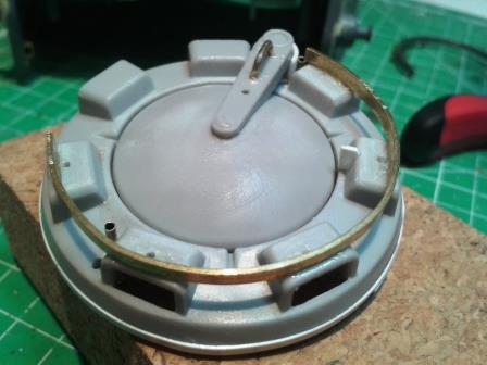

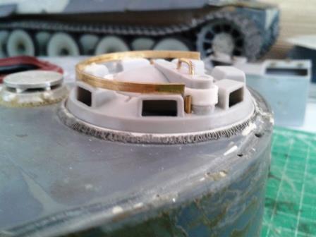

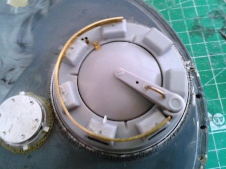

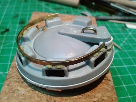

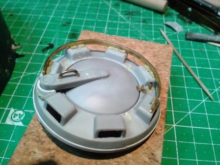

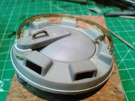

Meanwhile, a little more progress on the cupola:
Here I have added the armoured sleeve for the hatch pivot, the handle and one of the rain cover supports.jpg
Here I have added the armoured sleeve for the hatch pivot, the handle and one of the rain cover supports.jpg (26.29 KiB) Viewed 4792 times
Another view - there are still holes to be filled and texture to be added.jpg
Another view - there are still holes to be filled and texture to be added.jpg (27.75 KiB) Viewed 4792 times
View from the other side - hatch stop from plastic card, locking latch yet to be added.jpg
View from the other side - hatch stop from plastic card, locking latch yet to be added.jpg (28.95 KiB) Viewed 4767 times
Plan view showing both rain cover supports, locking latch (brass) and hatch stop (white plastic card).jpg
Plan view showing both rain cover supports, locking latch (brass) and hatch stop (white plastic card).jpg (28.83 KiB) Viewed 4792 times

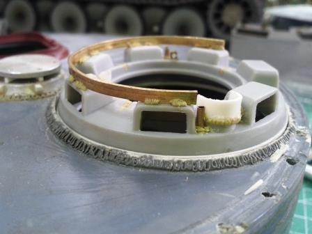

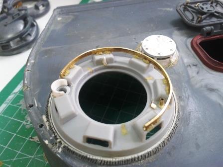

More cupola shenanigans
Weld beads added from Milliput.jpg (30.58 KiB) Viewed 4759 times
A view from the other side.jpg (30.13 KiB) Viewed 4759 times

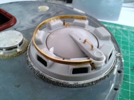

Anyway, one more good thing did come out of it - one of my boys was using some Milliput to fill in the cracks in his Dragon figures and when he had some left over I decided to have a go at the weld beads on my cupola.
The AA ring was attached to the top of each periscope cover with two weld beads.jpg
The AA ring was attached to the top of each periscope cover with two weld beads.jpg (30.58 KiB) Viewed 4759 times
Welding detail was also added to the hatch bracket shield and the sun shade supports.jpg
Welding detail was also added to the hatch bracket shield and the sun shade supports.jpg (27.69 KiB) Viewed 4759 times
The drainage channels have also been filled in - as has the hole in the top hatch bracket.jpg
The drainage channels have also been filled in - as has the hole in the top hatch bracket.jpg (34.86 KiB) Viewed 4759 times
The hatch handle on the Hachette cupola was completely wrong by the way - far too long (at least Taigen got it closer). I made a shorter handle from bent brass rod - hence the hole which needed filling. And yes, it really is that thick.
The armoured collar around the hatch pivot was made from a section of plastic tube, partially cut away to give it a 'C' shape. By the way, it's something missing from every version of this cupola I have seen - even the expensive Schumo set.
Now I hope that by eradicating those drainage channels I have at least made David happy... :D Er, what else have I missed?! :S
The weld beads were added using little 'sausages' of Milliput which I then textured with a fine point. There should be two each on the periscopes where the AA ring sits. Perhaps they're a little heavy-handed, but I'm hoping they won't be half as obvious once the paint goes on.
It just remains for me to add some light 'cast' texture - either with some Mr Surfacer, or by stippling a little PVA glue.

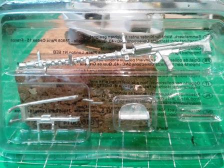

Now the next bit I have been looking forward to for a long time - the MG mount itself. This is another lovely part of the Hachette Tiger series [or maybe NOT - see below].

The Taigen cupola comes with an MG42 - but I've never seen one of these mounted on a Tiger 1. However, am I right in saying that this would have been one of the two MGs from the either the bow position of the co-axial mount? if so, would it have been the version with the armoured sleeve? Or were Tigers carrying a third, standard MG 34 at this stage of the war? David, I'm not throwing down a gauntlet, honest.

Yup, as far as we can see in photos, they were using armoured-sleeve MG34s on the AA ring. Which makes sense. Why would they carry two kinds?
