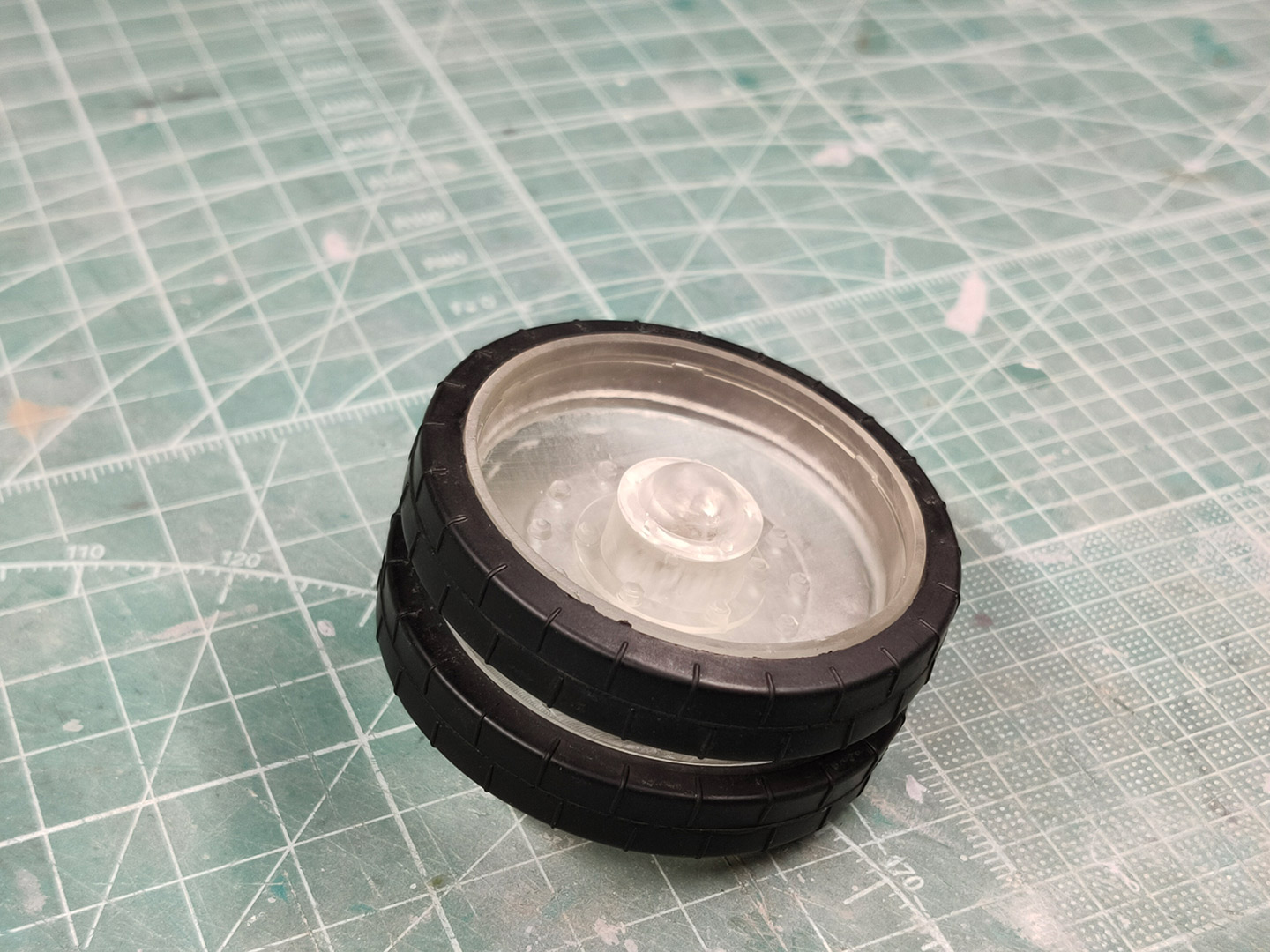

The new design was a success, first print came out well and is a good fit for the Taigen axles, bearings and tyres:
I managed to get close enough to the Taigen design that my outer wheel fits neatly with the Taigen inner:
I might try making a dummy dish to cover the spokes and fill the holes on the inner wheel. It'd need some filler and finishing, but since it would be up against the hull you wouldn't see too much of it. Weathering on the wheels would disguise it too.

Glad you had success with the outer fitting in the metal inner.
Gives us the easy option to retrofit existing tanks with the spoked metal wheels with correct looking running gear without the need to find a trumpeter kit, or entirely waste the metal wheels already to hand. Plus it would cut down by half , the number of items you need to make for the same visual result.

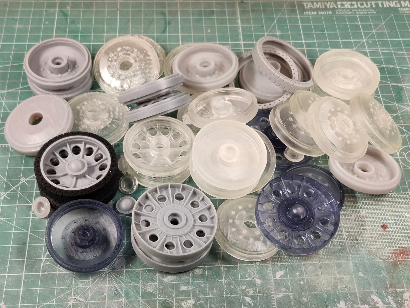

Some more experience would help, I haven't been terribly efficient so far:
There's probably $30-40 worth of resin in this pile of failures.

I'm still having trouble with the clear resin(s) pooling between supports and semi-curing in places it shouldn't. Test prints or prints attached directly to the bed come out perfectly, but anything remotely complex (or useful) needs to be supported and that's where I start to get problems. I am running out of ideas for how to do this and I can't find much useful information online since it seems like 99% of people using resin printers are doing things like tabletop miniatures or figurines, not functional parts. What I'm producing now isn't good enough, the wheels would need a prohibitive amount of work to clean them up and make them useful. I'll keep butting my head against the wall until something gives.
