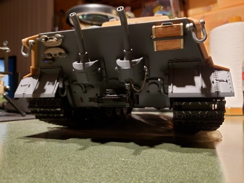

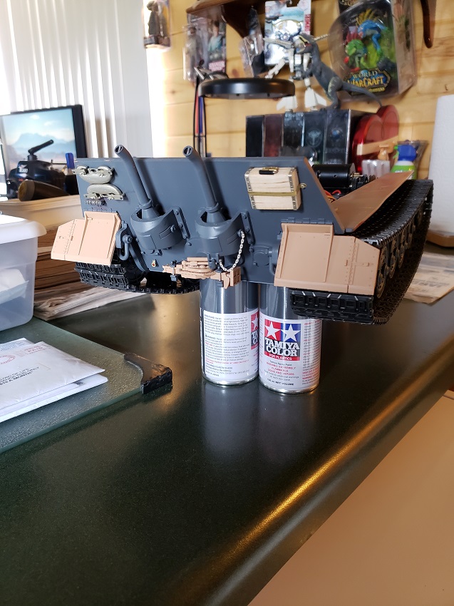

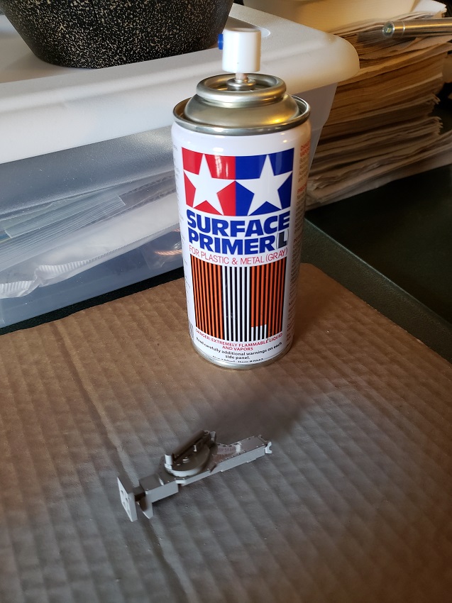

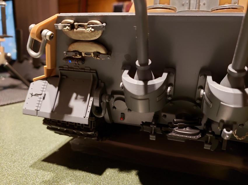

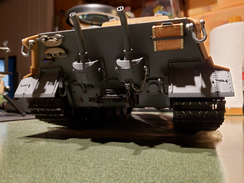

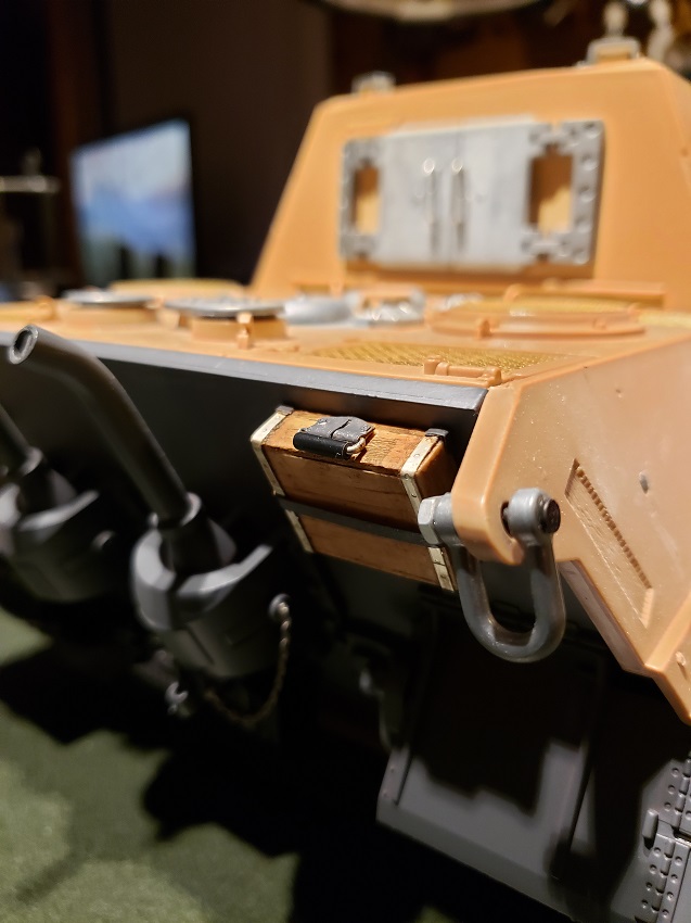

I got restless waiting for the seasonal ( now apparently ) rains to let up so I bit the bullet and did the detail painting in the kitchen. The primer is the worst but only small amounts were required this time. Rear armor is painted and detailed and awaiting the weathering of the panzergrau.
Pics: ( Click to Enlarge )
Steel for the chain and stain for the wood, black for the jack and panzergrau for everything else.jpg
The fenders got the rottbraun auto primer but the jack got the Tamiya grey for greater detail..jpg
Starting out by raising the rear plate to eye level when seated at the counter.jpg

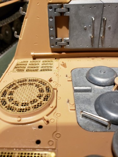

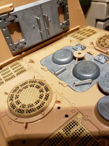

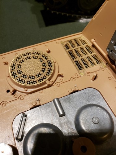

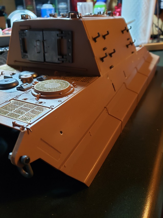

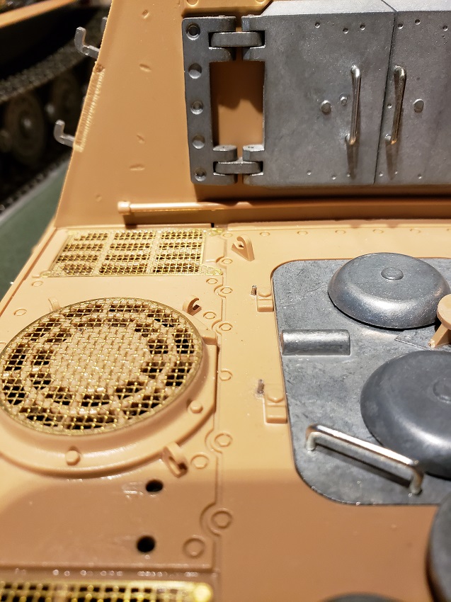

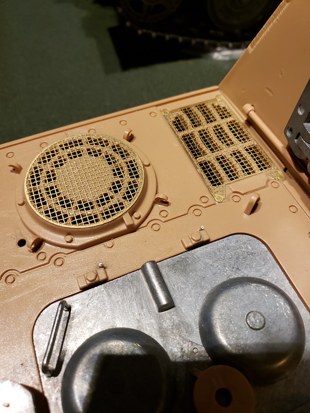

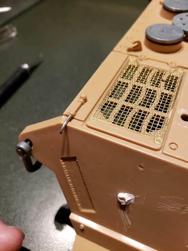

Beginning work on the Casemate and the books by Devey are invaluable! This will take time even at the level I like since there are some small details overlooked by the 1/35 scale Model Manufacturers ( not to mention
the 1/16 scale RC versions tho' I have to admit Torro did a RESPECTABLE job of it. ;o) The 1/16 scale Trumpeter is the one to look at for incredible realism there. The work is fun and I have some stunning Builds to look at here on the Forum for ideas and inspiration as well.

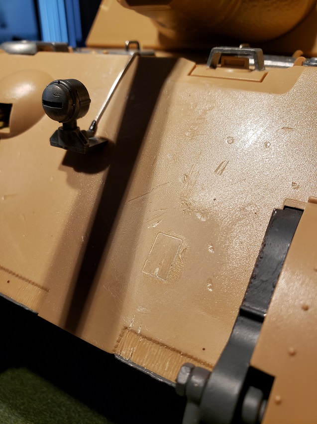

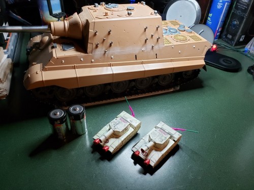

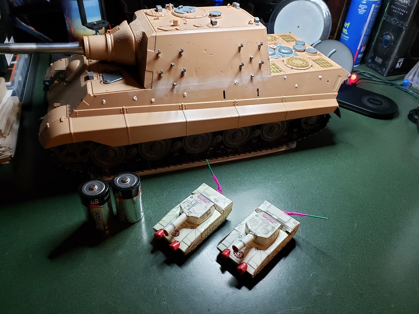

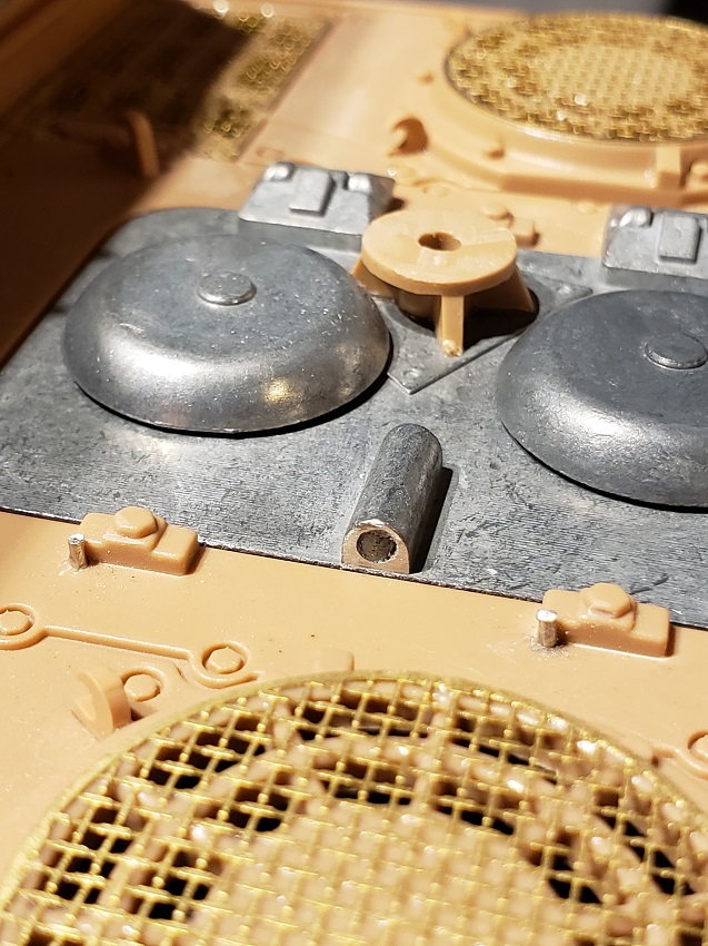

I'll have to get out the Dremel to drill out the engine hatch lift assist...Center marked it for later....jpg

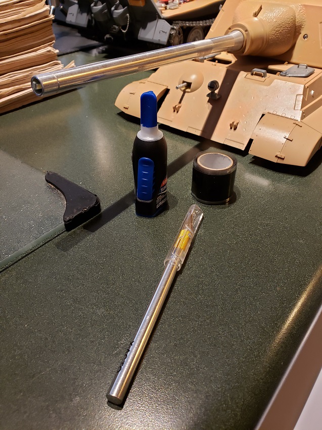

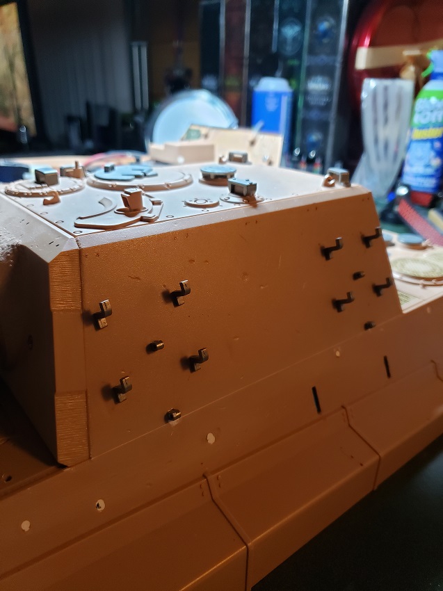

Tarp mount drill holes eyeballed in using the marks from Saturday and there was plenty of room for adjustment...Mounts made from lead wire....jpg

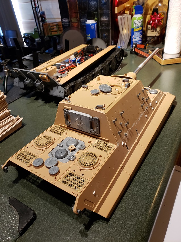

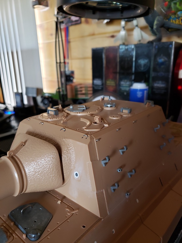

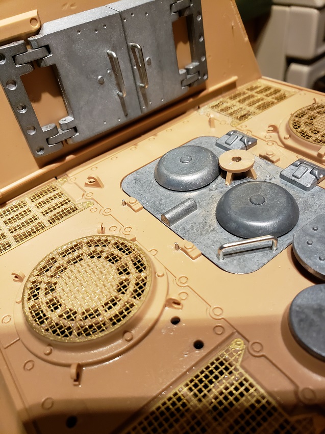

A little spare time time today saw me back at the Jagdtiger and working on detailing the Casemate...

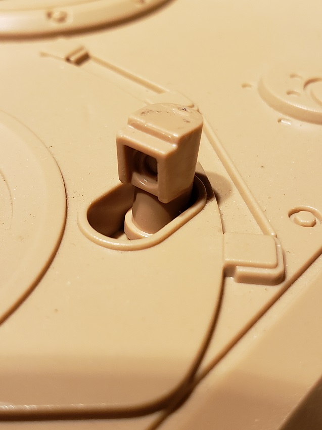

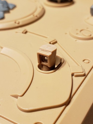

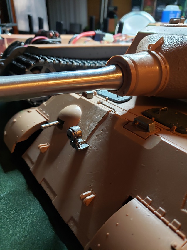

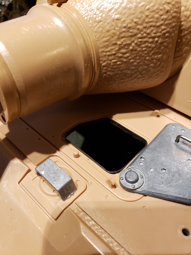

Careful drilling after applying the Mark One eyeball gives the cast Hatch some depth.jpg
Some cleanup with a file and the addition of a small mirrored lens produces a much better detail part.jpg
Basic Torro part.jpg (95.9 KiB) Viewed 2032 times

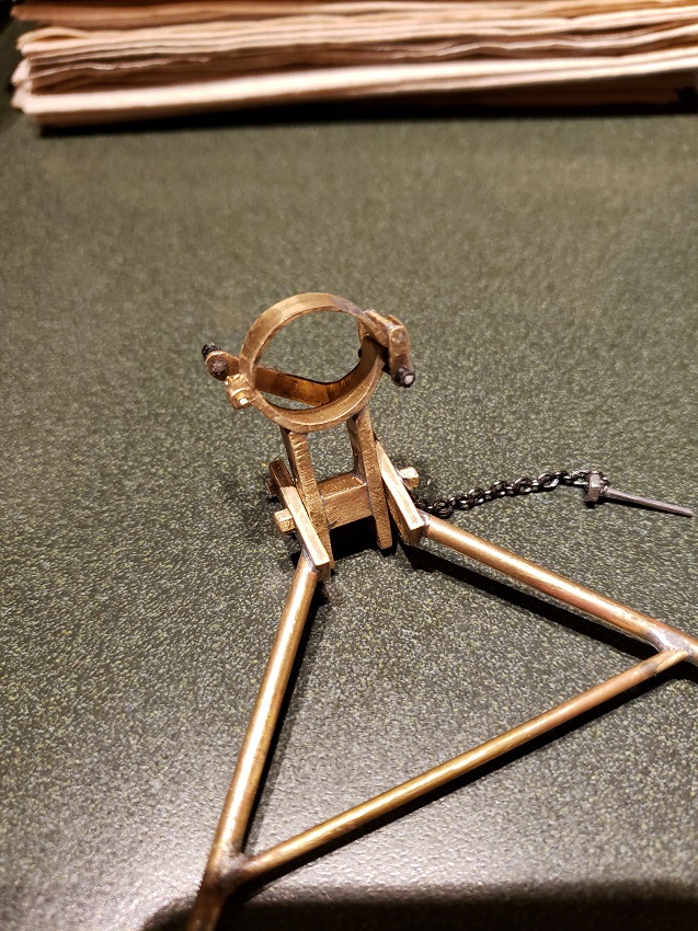

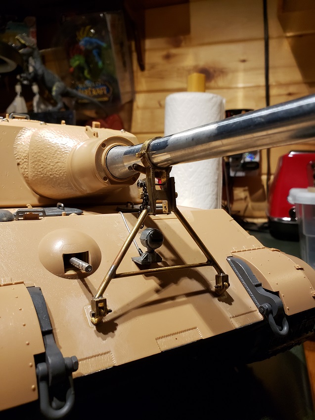

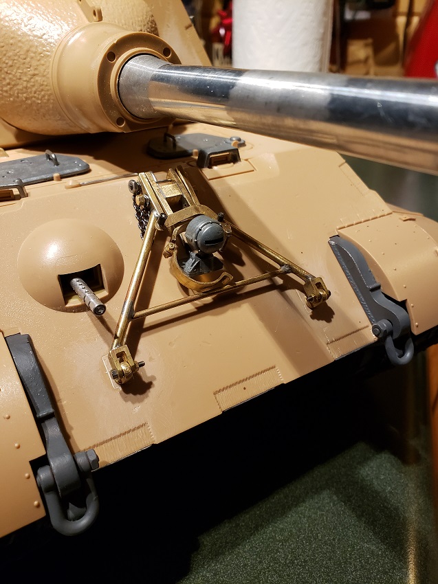

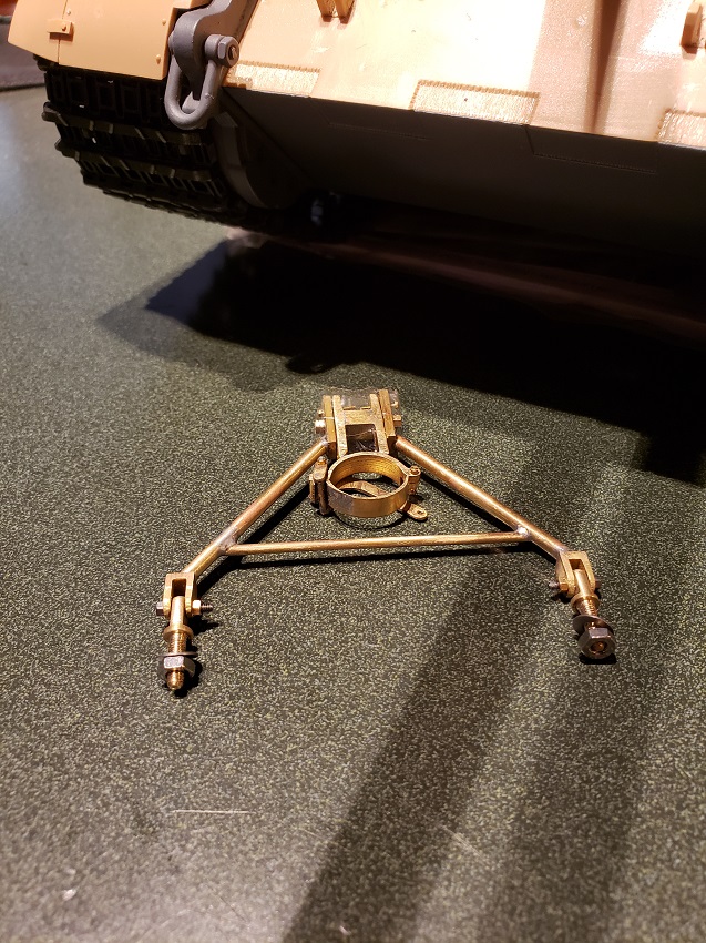

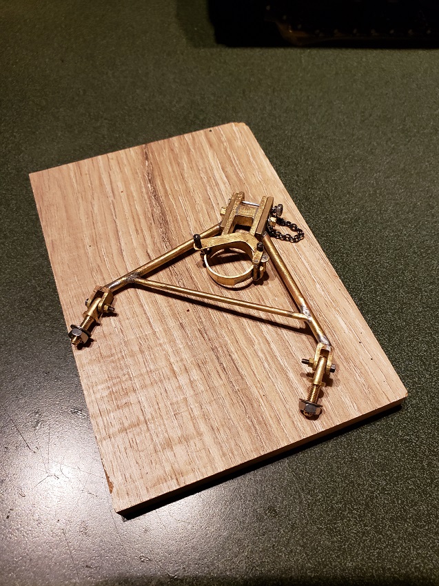

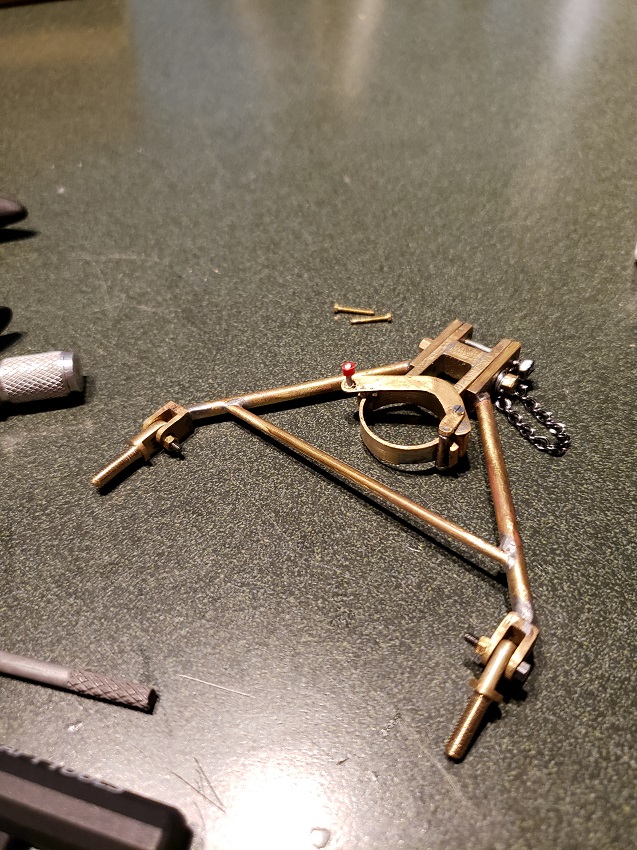

"Up Next!"...he laughingly noted... I hardly know where to begin. The piece looked great and I thought I could add a handle, drill a couple of mounting holes and install it. Sheared screw heads, broken solder points and a great deal of hours spent repairing and rebuilding the Brace finally saw it installed. More detail work will be needed to make it fit onto the armor like an original. Paint will definitely help.
Even with the Mounting Holes made into Slots to allow for mount movement...This was the best I could do to get it to lay flat..jpg
A goodly amount of diamond filing required to make those pieces rotate past each other.jpg
Seven hours later after things that did not fit began to break... All moving pieces and some non moving on the Brace rebuilt.....jpg
Addition of a simple handle and a long pin to replace the shorter screws used originally. One from each side again oddly enough..jpg
First disappointment was in having to remove my carefully preserved mounts...New piece was of the older variety with a later type crossbar oddly enough..jpg

You know, Painless; just because some of us don't post our feelings of jaw-dropping amazement with every update you show....does NOT mean that you're doing all this without a fascinated audience! I'm sorry for the frustrations you experienced in trying to get that gun crutch together, but it really was worth it - it sets off the front better than anything else possibly could! Your build is truly a reference for other folks' future Jagdtigers.
