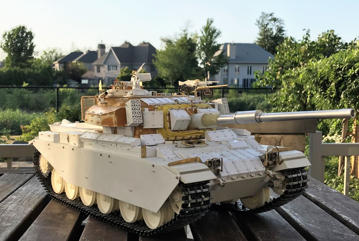

Now, to keep Mr Herman under control, let's give this Centurion its side skirts.

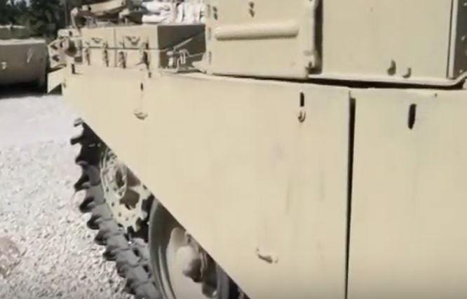

The Centurion side skirts are in 3 parts. For a realistic Sho't Kal, they should not be simply glued to the hull. I decided to install them as they are on the real thing, a 8 hour modelling task.

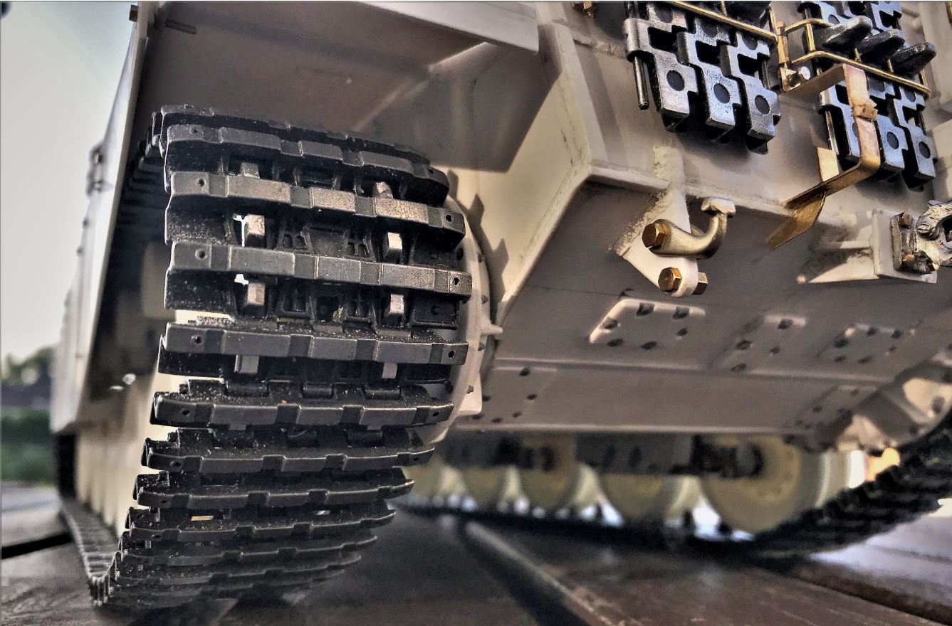

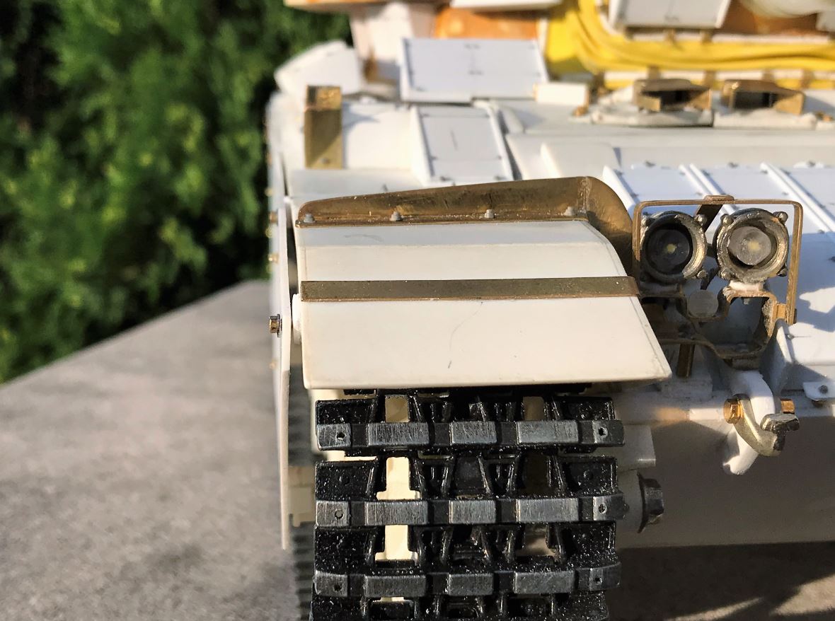

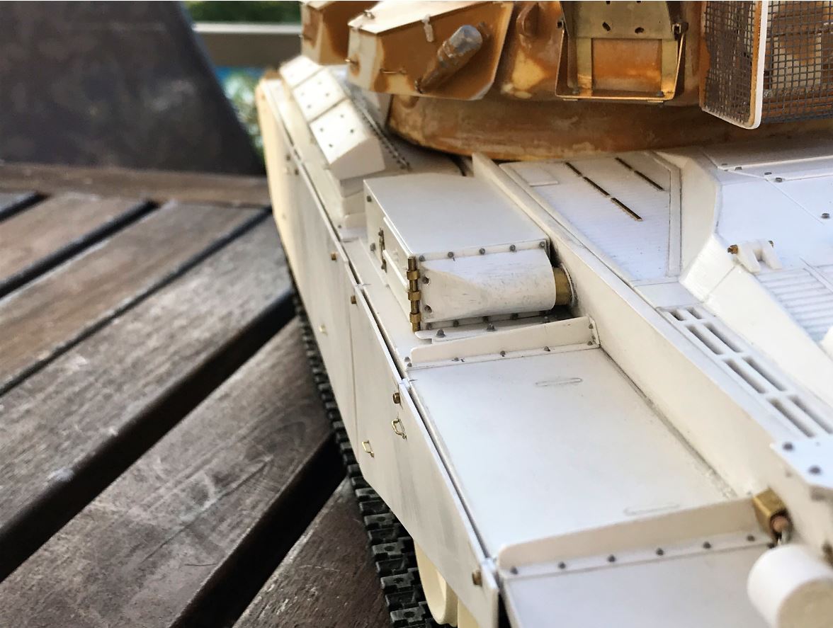

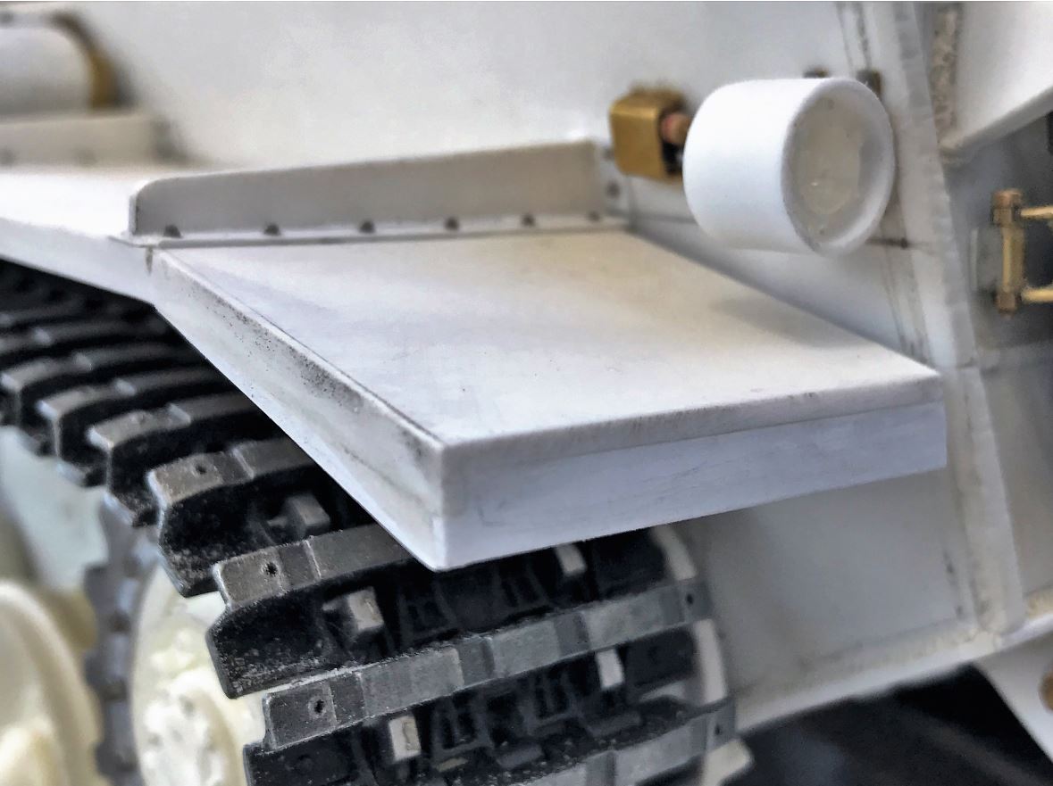

First task is to rework the flat rear mud guard and beef it up with plasticard to give it its proper shape.
1/16 RC Centurion tank IDF Sho't Kal Gimel Build

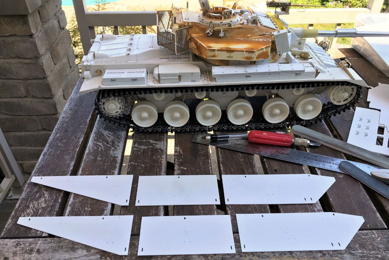

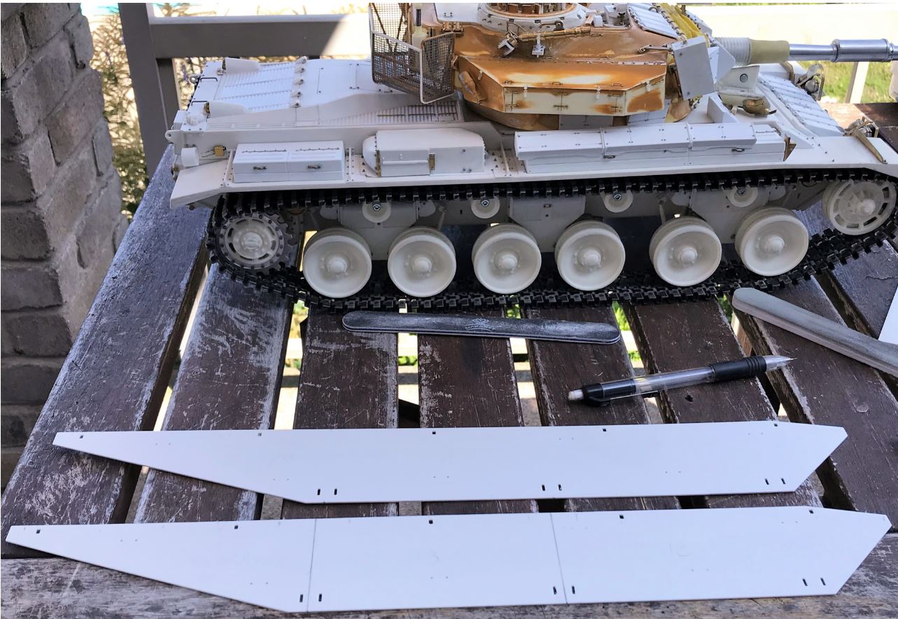

Ludwigs provides the skirts in one piece. They have the right shape but sadly full of positioning holes that need to be filled and polished.

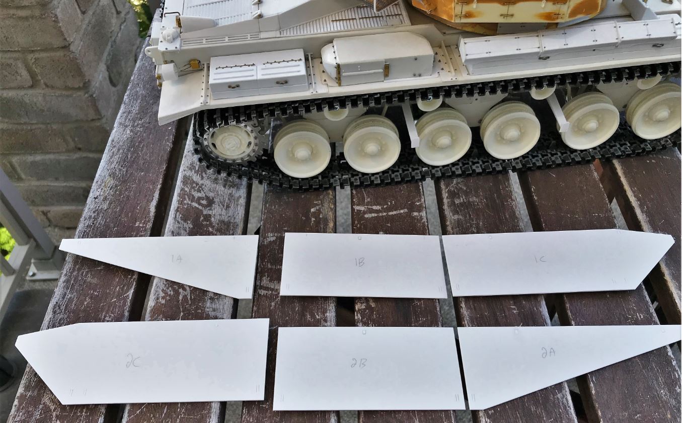

The skirts are cut in three parts.

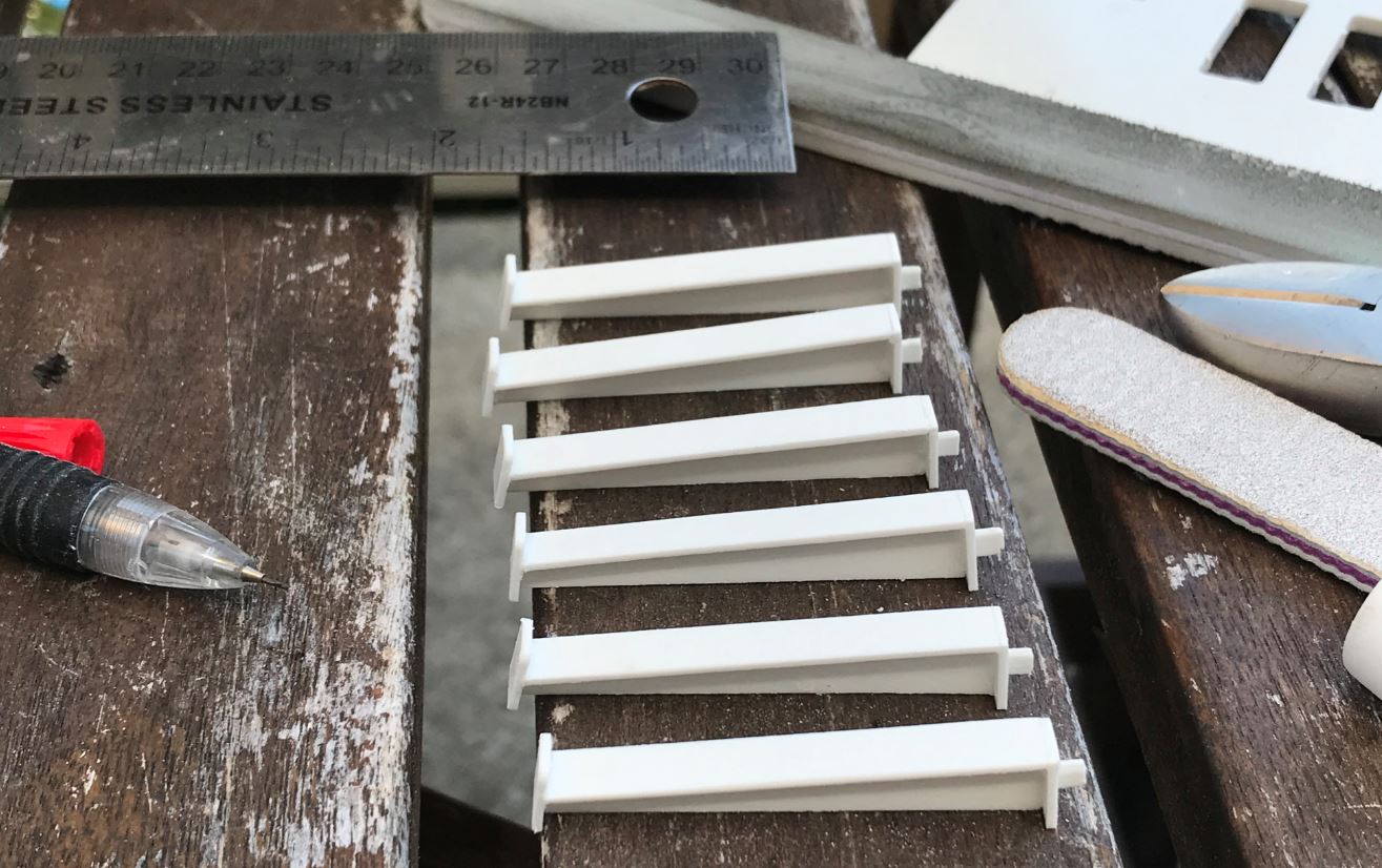

Ludwigs provides the inside struts that helps keeping the skirts strait.

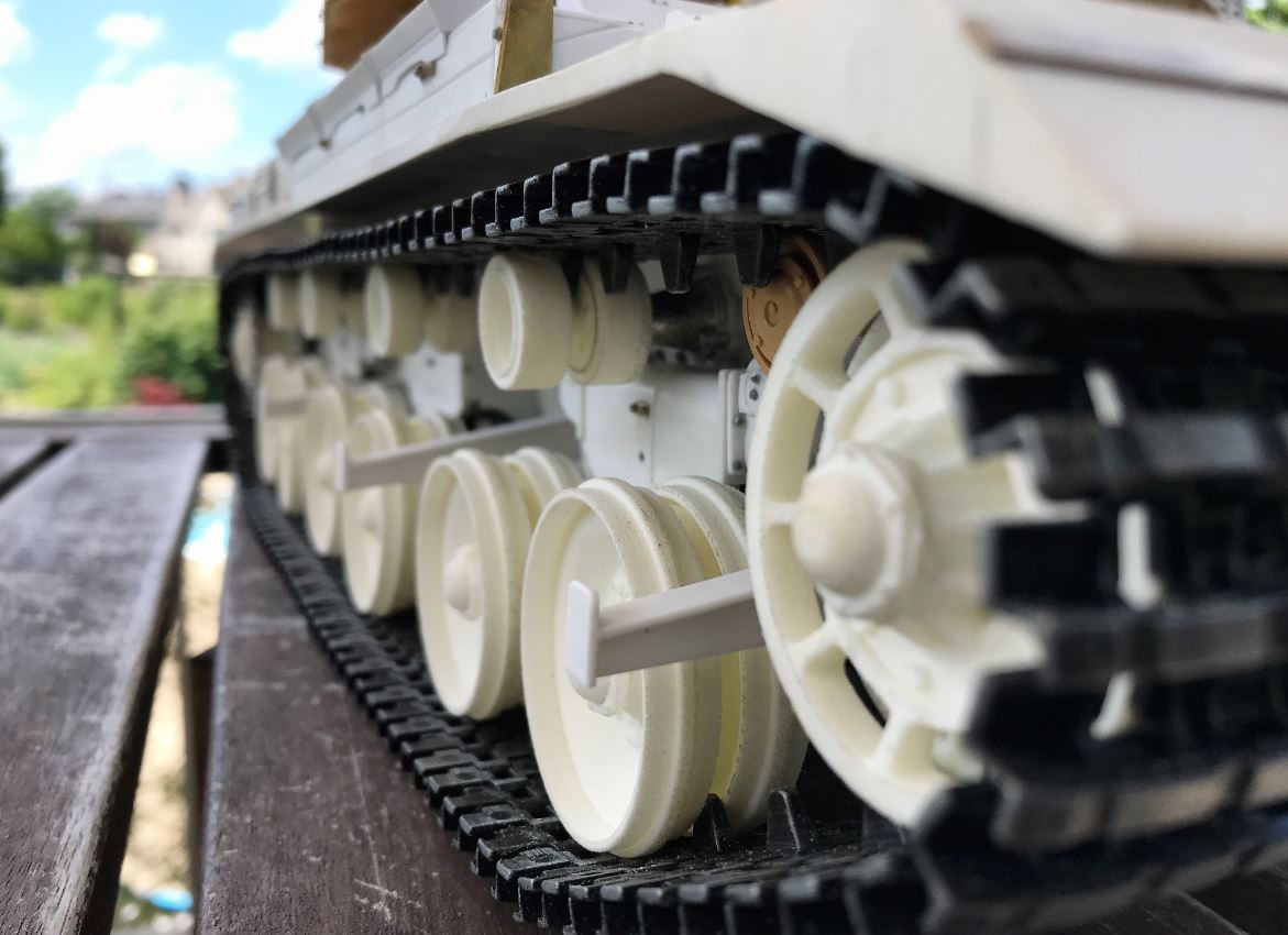

The struts are installed strait in their positioning holes on the hull. The locations seems good.
Notice the 8 small 1mm thick plates attached to the fenders side, this is where the skirts screws will go into, and also the position of the 3 struts on each sides. This is the last time you see the Sho't kal without its skirts.

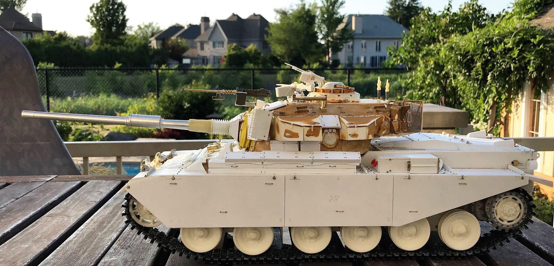

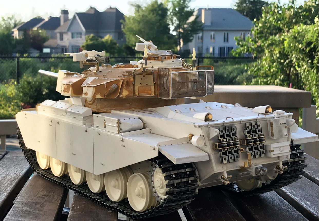

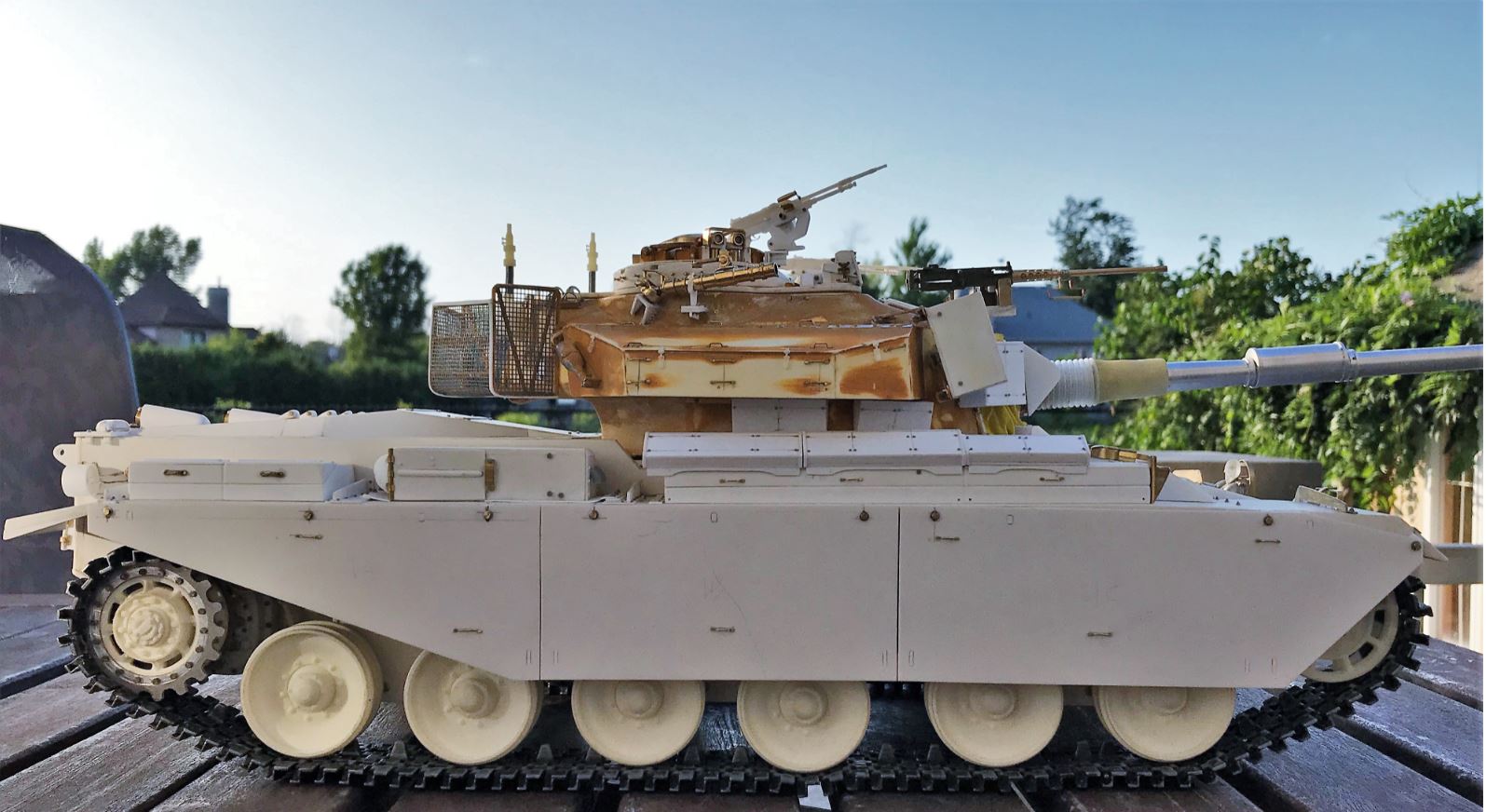

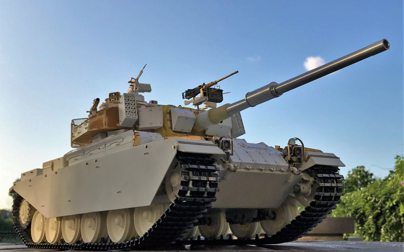

Here is the Sho't kal Centurion with its side skirts.

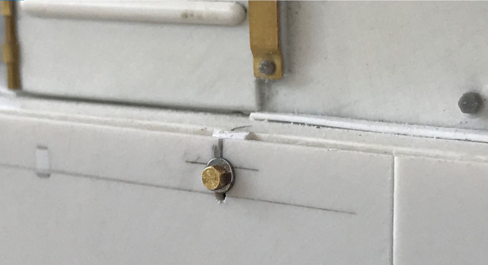

I used M1.4 brass screws and 1.5 metal roundels to fix the skirts on the hull. Smaller screws would become weak and might break after removing the skirts a few times. The skirts are therefore removable, a must for this tank. I ran out of roundels and need to order more. Notice how the holes on the skirts allow for vertical adjustments, very useful and similar ro the real thing. The skirts are usually not that strait on the real tank also, so putting them a bit unaligned is realistic.
Notice the 1mm space between the skirt and fender.

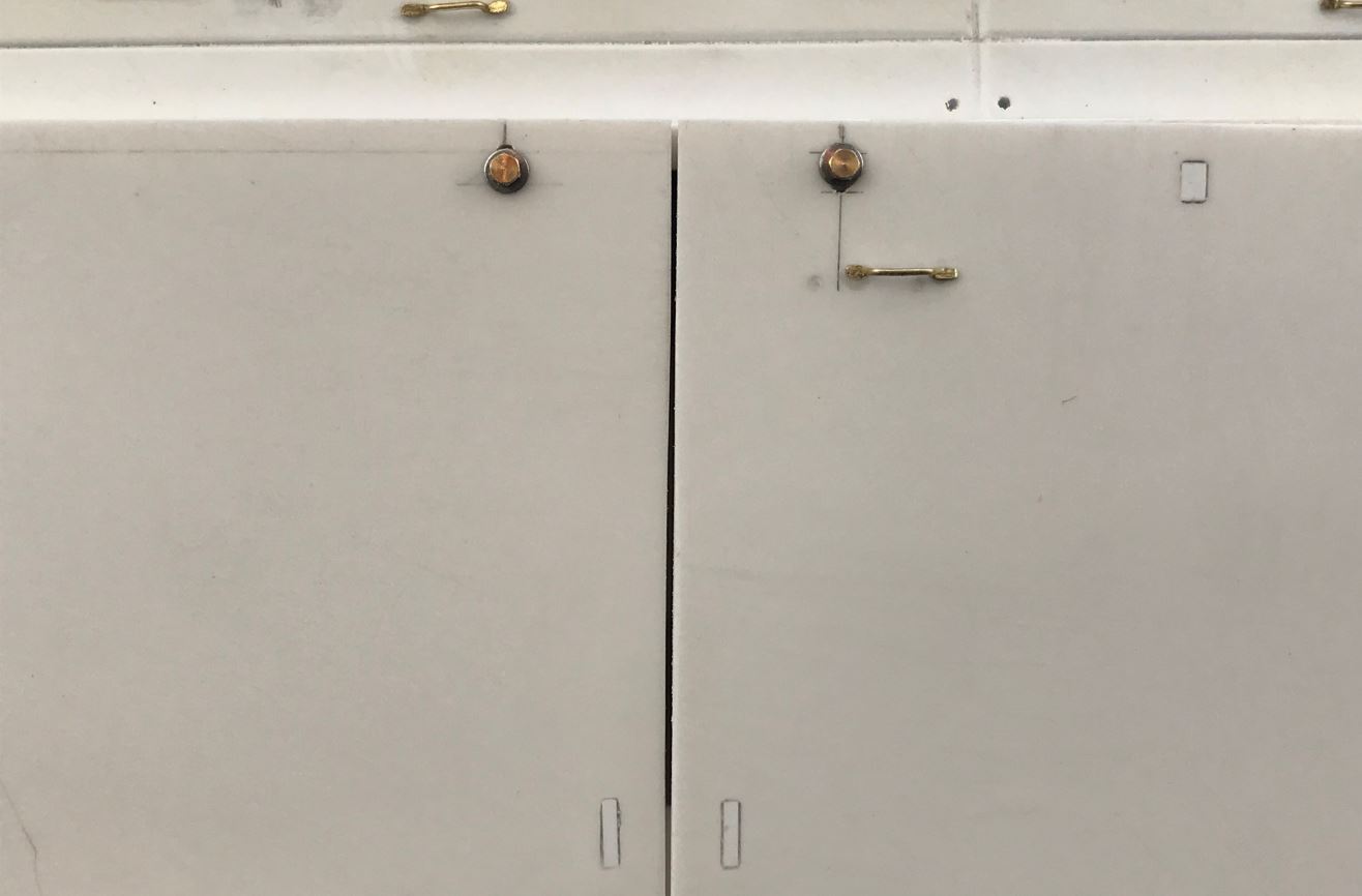

A realistic small space should be left between each skirts sections. This is important for the look.
Top view.
Bottom view.

Beautiful museum quality piece, almost a shame to paint it! The skirts really make it look incredible :clap:

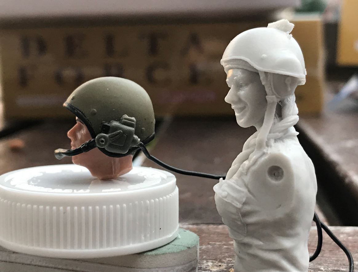

From the pictures i have seen, the tank crew helmets changed in the early 80s from the American type to a new helmet developed by the Israelis. Here is a crew with American helmets.

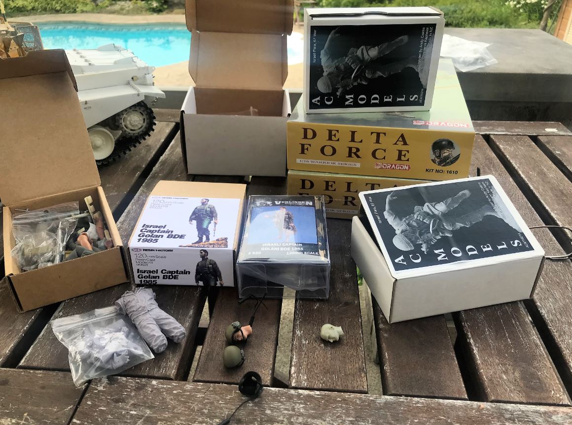

I have the two helmets available. The 1/18 Ultimate Soldier American helmet and the 1/16 Israeli from Sol Models, coming with the female crew. I was thinking about removing the female head and reuse the helmet on a man's head. I honestly prefer the shape of the American helmet. But I was concerned about the advertised 1/18 scale, being maybe a bit too small, but when I compared it side by side with the other, I realised the American helmet is actually bigger, so American it is. The cute babe will keep her head, for now. Its the men that will lose the top of theirs for a good fit.

Some of the figure material assembled for the crew and infantry build up.

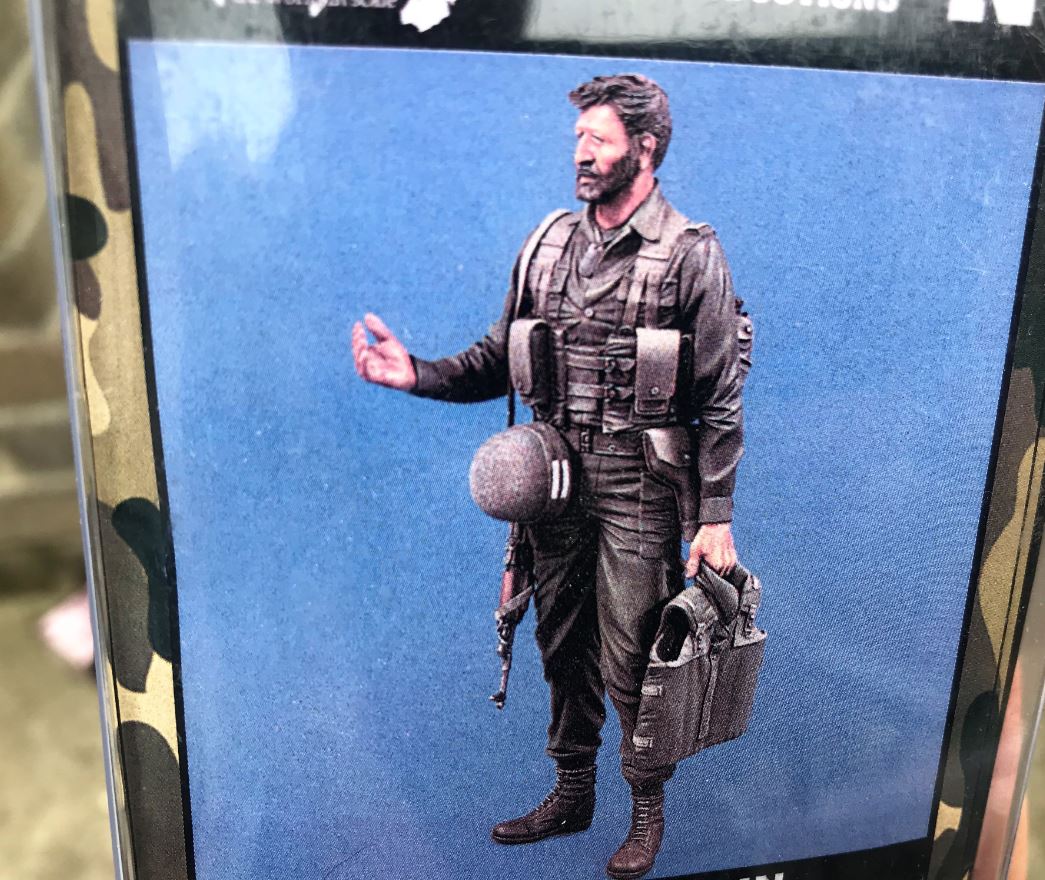

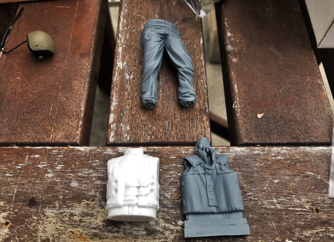

Most of the commander is from the Verlinden Golani brigade captain. Bizarre figure, a bearded man..., he holds a flak jacket on one hand, signaling on the other hand, AK on the side. A very similar figure is available from Sol models. Not sure what is the deal about this bearded soldier. He must be someone famous.

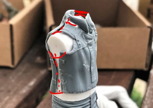

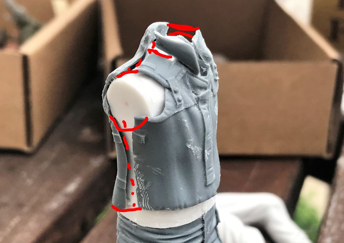

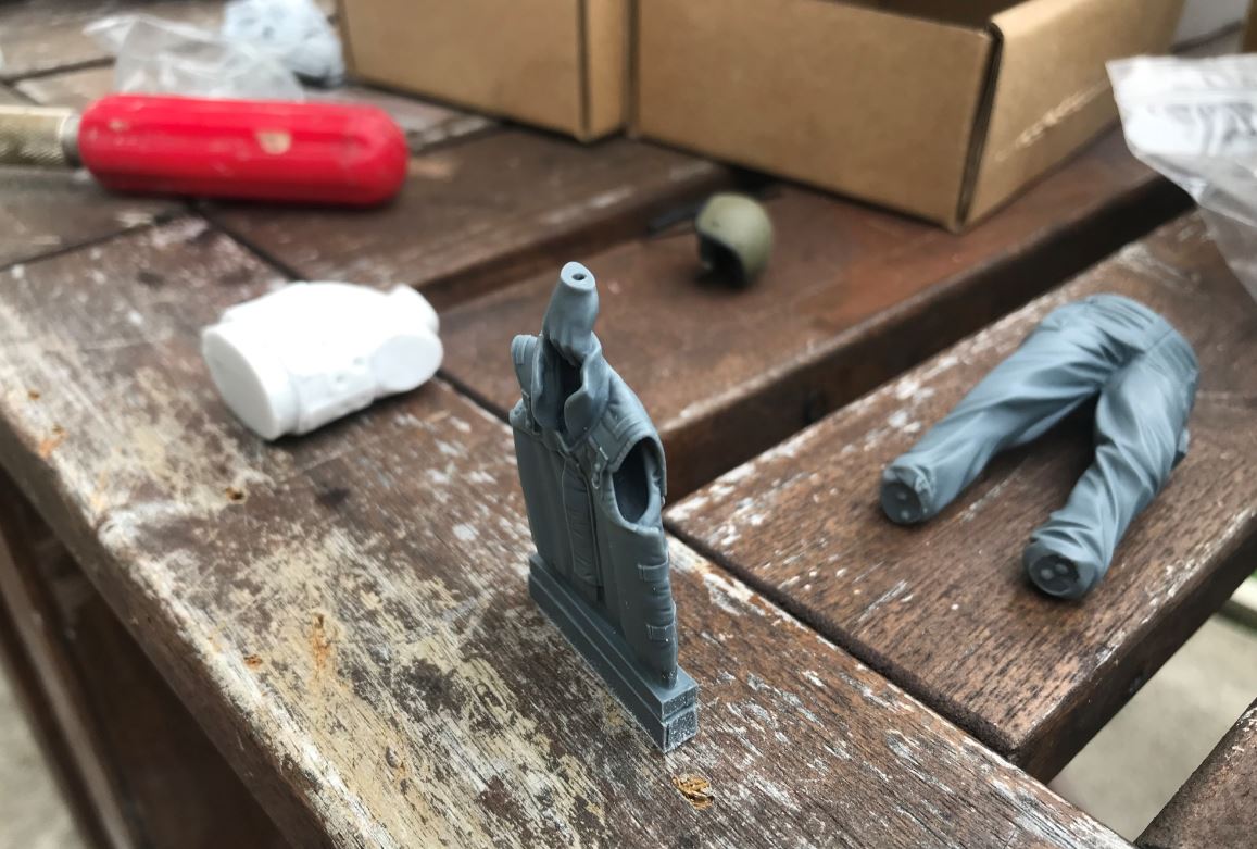

The infantryman torso with webbing need to be replaced by a simple uniform. But I really want to use that flak jacket, but its dead flat with a hand molded on the collar... there is always a solution.
After a couple of minutes of planning, I decided to use the flat jacket. Not only will I use it, i will actually make the commander wear it.

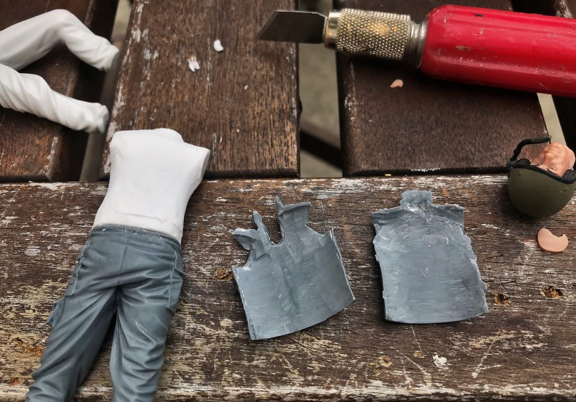

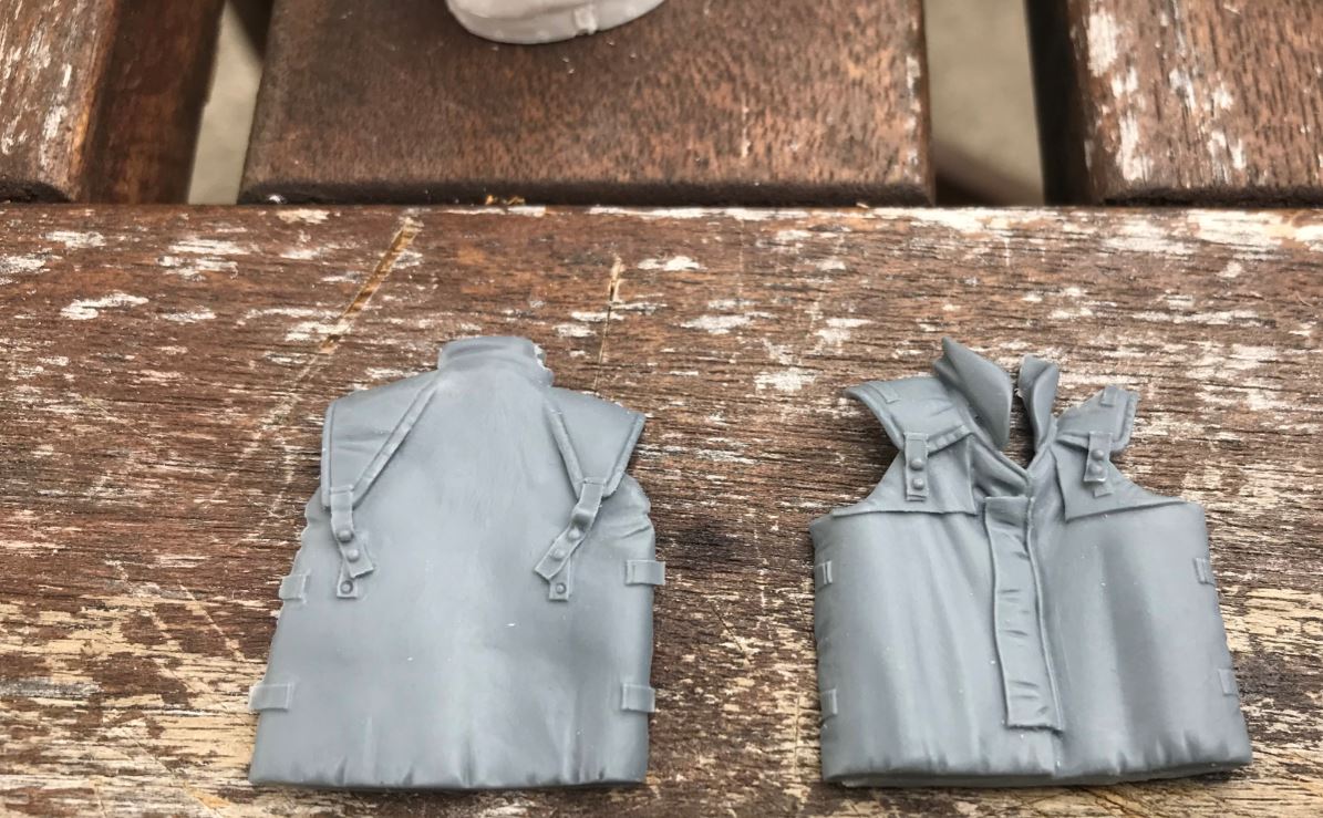

The Verlinden 2019 reissues are now using a new kind of resin, softer and easier to cut. After a couple of minutes in the micro wave, I was able to easily slice it in two flat halves.
The jacket parts are thinned from the inside with a dremel. I used the Sol Model torso of the Golani soldier for the commanderr. It had to be thinned. All features are removed so that a clean torso surface can accept the flak jacket.
After a couple of more minutes in the micro wave, the two halves are applied and pressed against the torso of the commander, then glued. Plasticard and putty will be used to bridge the two halves for a seamless joint on a commander that is now wearing a flak jacket.

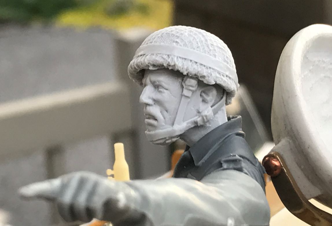

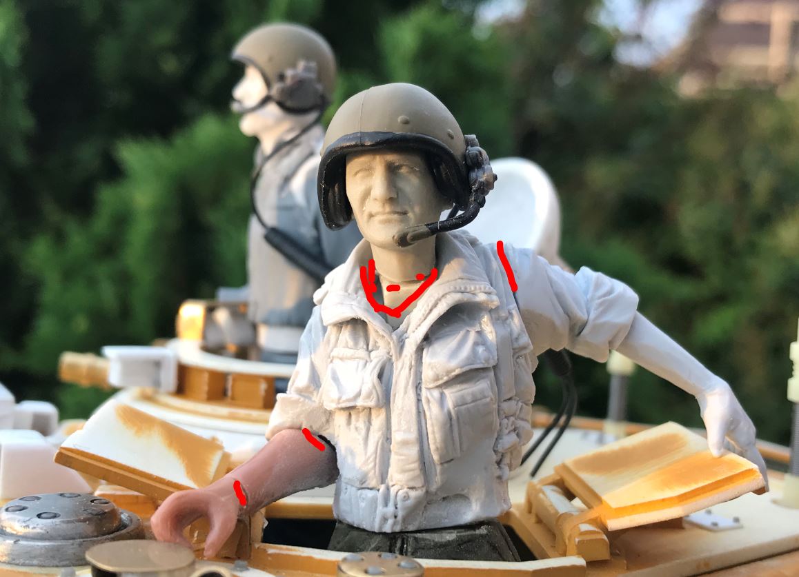

The Sol Model head is used for the commander, for now. I started to fix the joints, need sanding and putty. The Ultimate Soldier helmet will be improved.

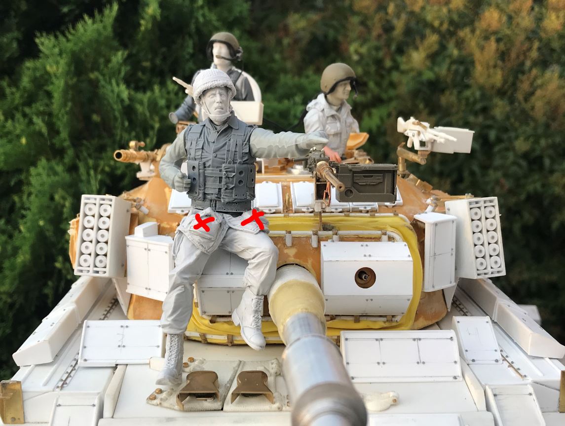

The spotter infantry rider is the AC Model head and helmet and bottom, with Verlinden Golani torso with the webbing of the time. The pockets on the legs will likely be removed, not sure yet. This figure is for static display only and will be removable. No one with his right mind would actually sit on a ERA block so I still need to find a better location for him if I decide to keep it associated to this model.

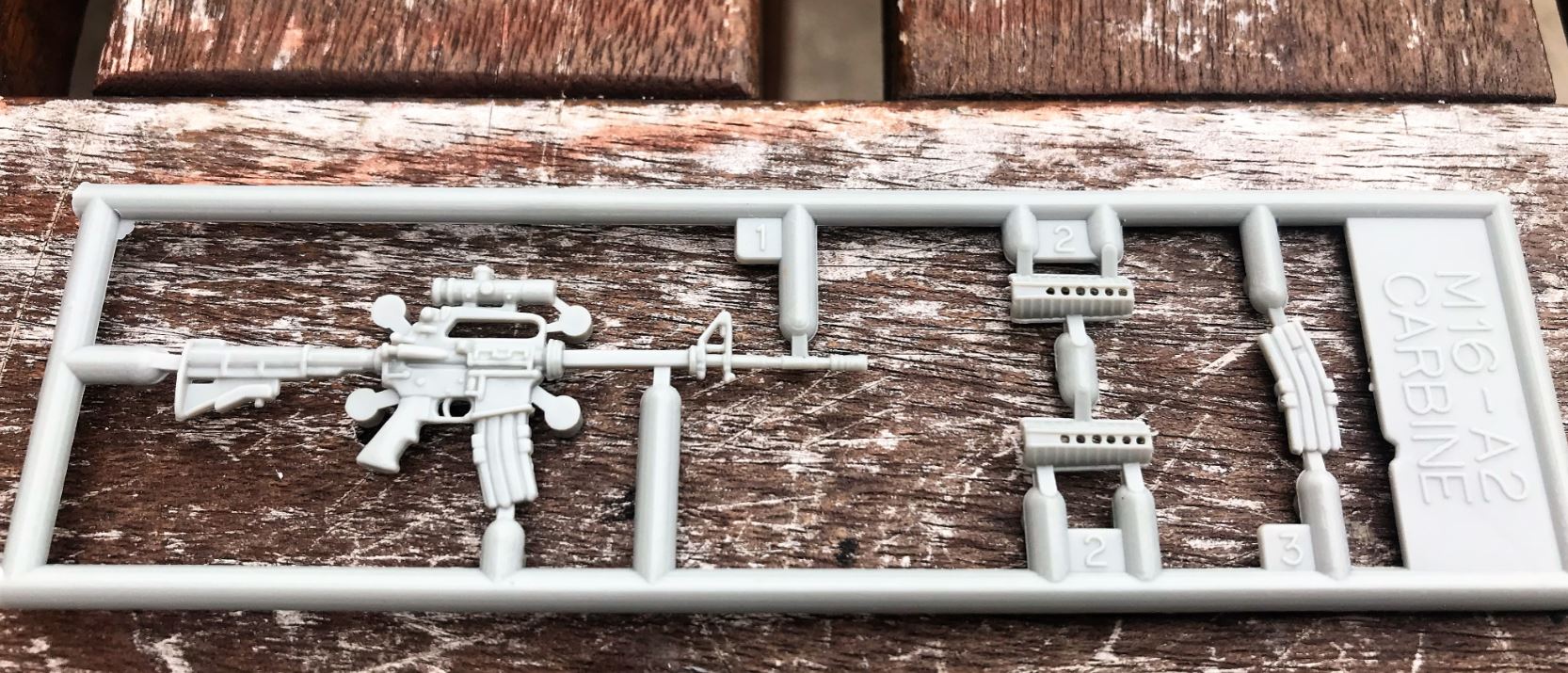

He will be armed with a CAR-15 carbine. The Israeli army of the 80s did not seem to have a standard weapon. Men can be seen carrying Galil, CAR-15 and AK rifles. The Galil being very heavy, many men preferred the CAR-15. I will need to retrograde this CAR-15A2 to an earlier version.
