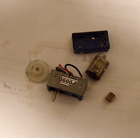

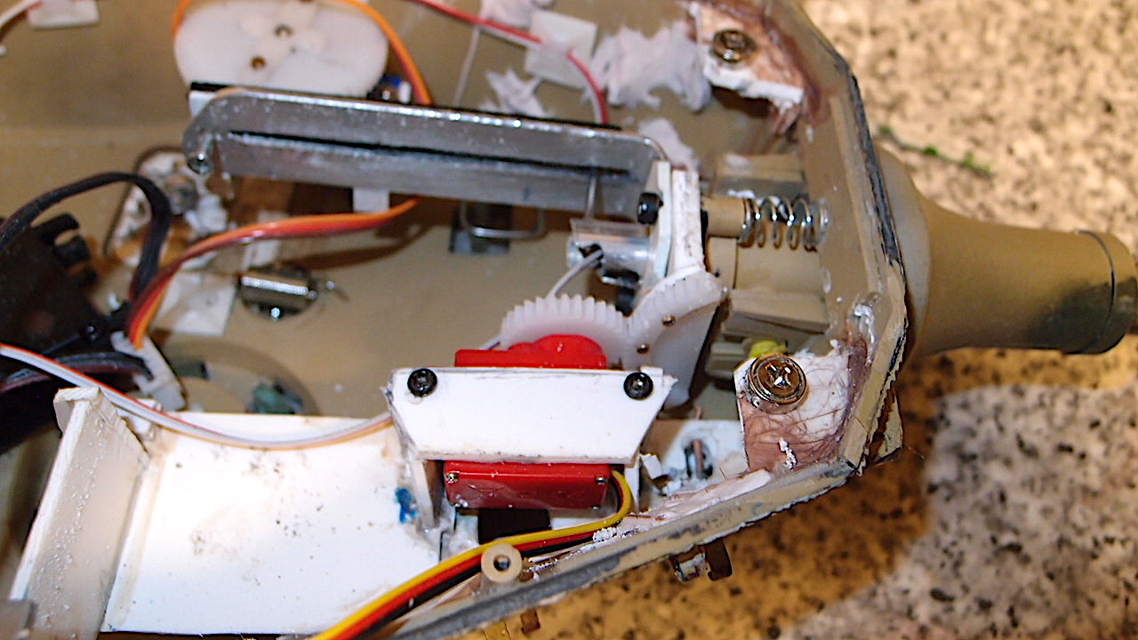

Time for an upgrade , the turret rotation servo has died . The little micro one with plastic gears stripped, metal gears from now on. Never liked the servo elevation with lever changed to a gear servo , fitted a spare to check while waiting for ones with more torque.
Plastic gears fail
Plastic gears fail
Elevation with the lever arm had too much play
New elevation setup with temp servo to test

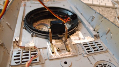

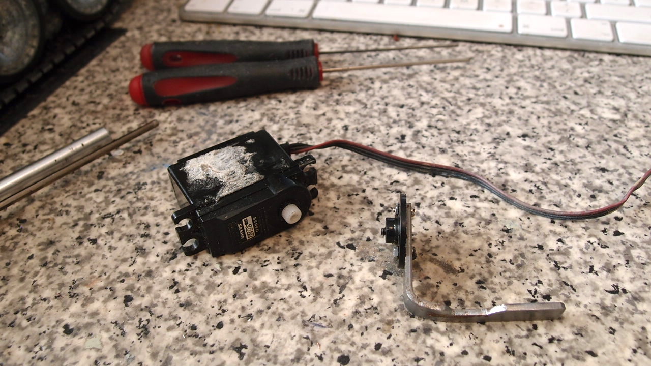

Post by ronnie42 »
Thanks mr rainford Servos with metal gears have arrived made brackets for the turret servo. Looked at the proper turret rotation unit for the leopard turret ring but it was 50 +euros with postage for the parts to make it up. Found a larger plastic cog , drilled out for a tight press fit in servo . Will fix the pot in the neutral position or use a couple of resistors.
Up and running again.
