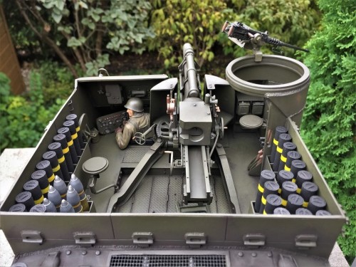

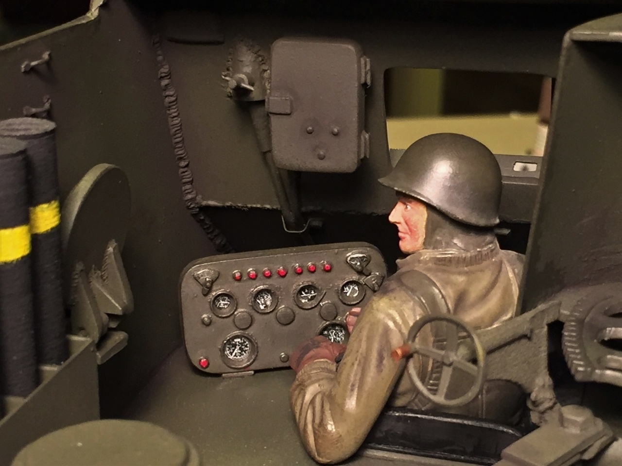

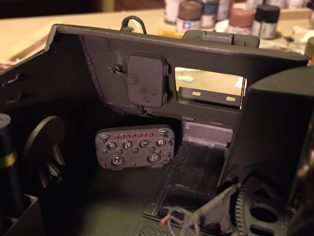

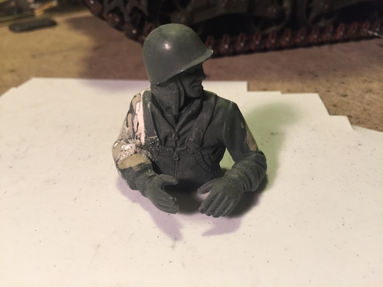

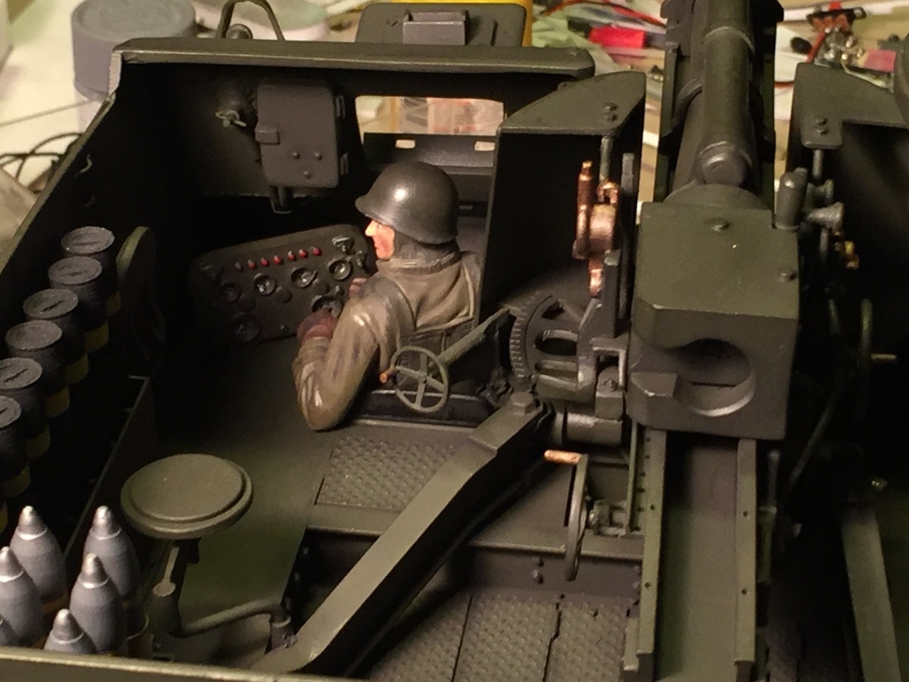

Now the driver area.
Remember those first posts where I showed what the kit provides for the driver's area, a big empty hole.
While scratch building the fighting compartment, I enclosed the whole area but it was always a concern to me how I would finish it.
I scratch built the driver's dashboard in an earlier step and today I took a reference picture of the driver's pit, scanned it, edited it and glued it on a thin plasticard with a simulated top of the driver's seat coming out of the picture. However, it was not very convincing and I was not too pleased with the results. It needed a driver...

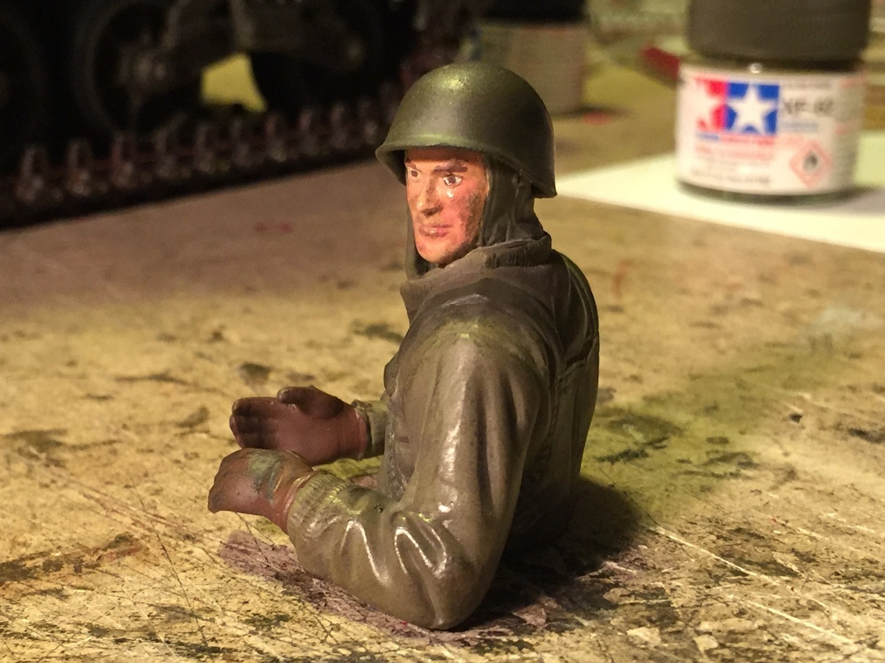

Taking the Heng Long figure coming with the Sherman donor (actually a Tamiya M26 commander), I modified the extended right arm and fold it so that it can fit in the M7 driver area, also removing the stripes on the uniform and reduced it in height.
I always disliked figure painting, and I am not good at it. It takes an eternity and the paint never seems to dry. That's why most of my tanks do not have any figures on them. A realistic paint job of the face is difficult and I rarely achieve good results. So I tried to do my best here. Not too bad though.
The driver has an original pose and fits well in the driver's area of the M7, his head is turning towards the back as if he was talking to the guy behind. I ordered the 2 Torro US WW2 tank riders available on ebay so I will likely put them on the available seats depending on how they integrate with the scene.
I find this arrangement rather convincing and much better anyway than the huge hole the area was before.
View from the front. The driver area is now done and satisfactorily. The big mystery as to how I would finally resolve this problem is gone.
Regards, Louis

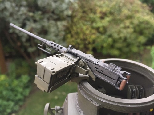

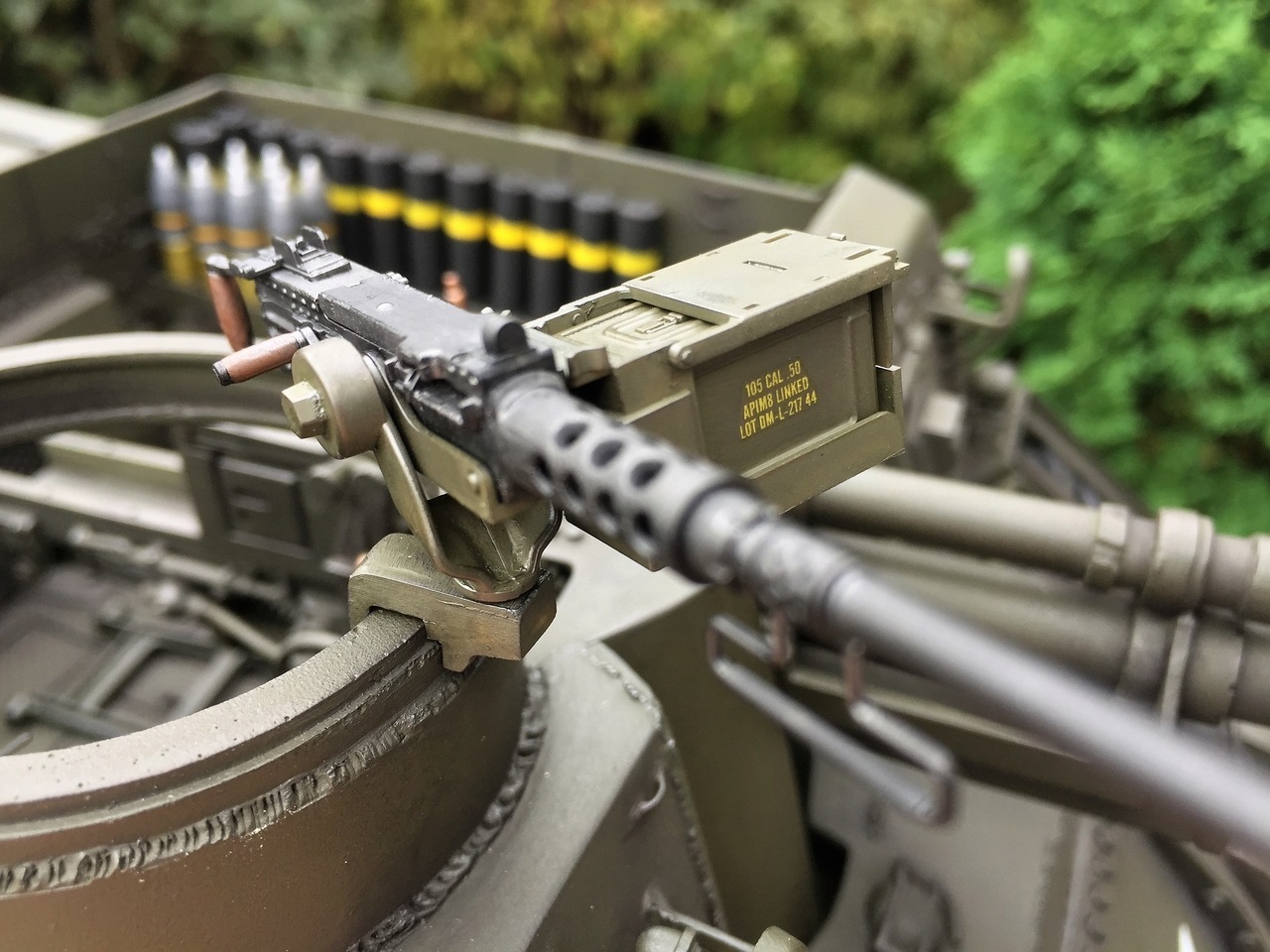

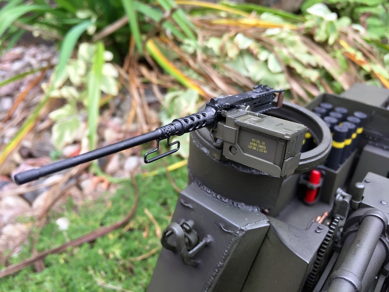

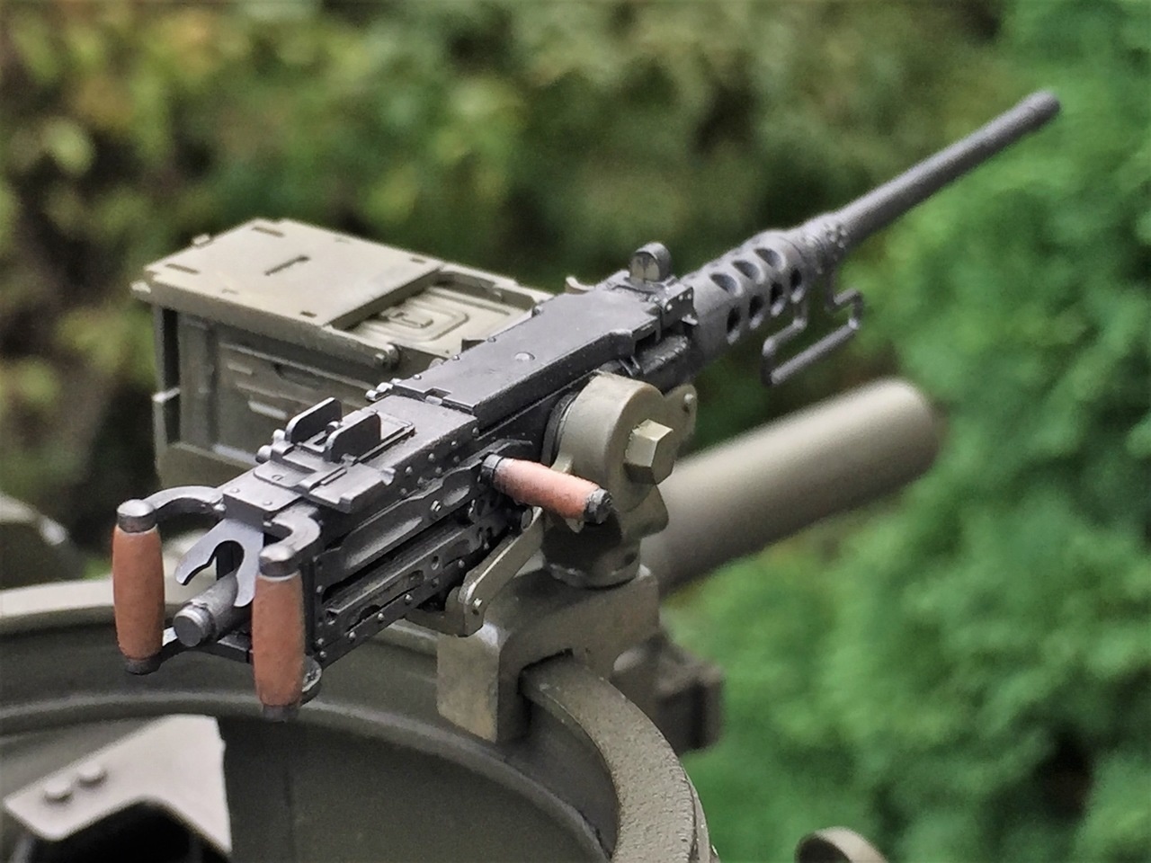

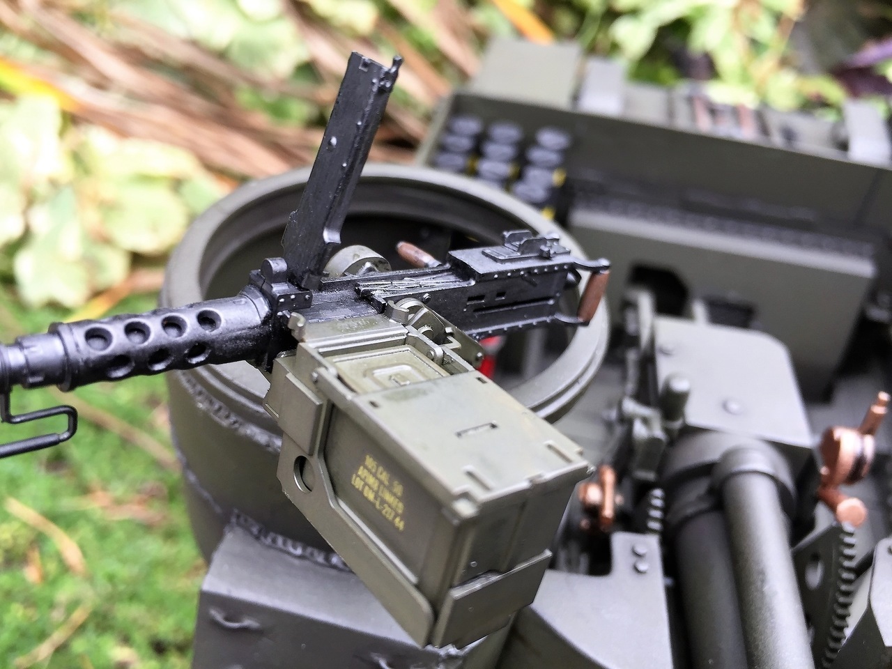

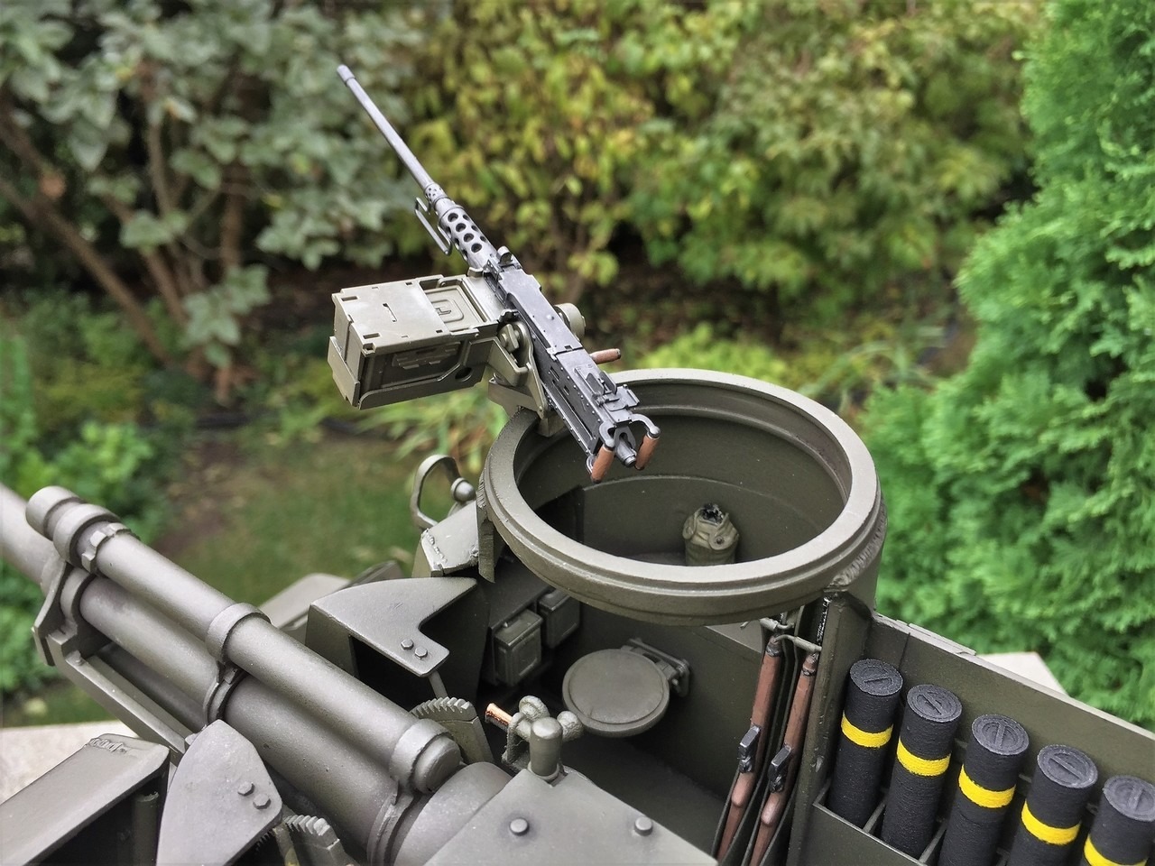

Here is the M2 .50 cal machine gun. This is the Tamiya M2 coming with the Pershing tank, I ordered a bunch of them years ago to put on all my US vehicles.
This is a very precise model kit on its own and should not be neglected. The gun itself was simply painted flat black and dry brushed with dark steel pigments, with brown color applied on the handles, that's all. The ammo box decal is from DGS. Although the Vandra M2 seemed ok, I preferred to use the Tamiya which is more detailed and functional.
Regards, Louis

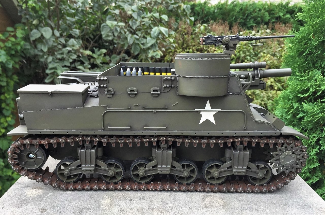

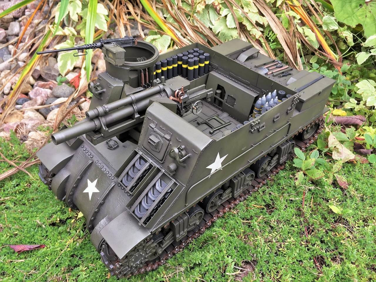

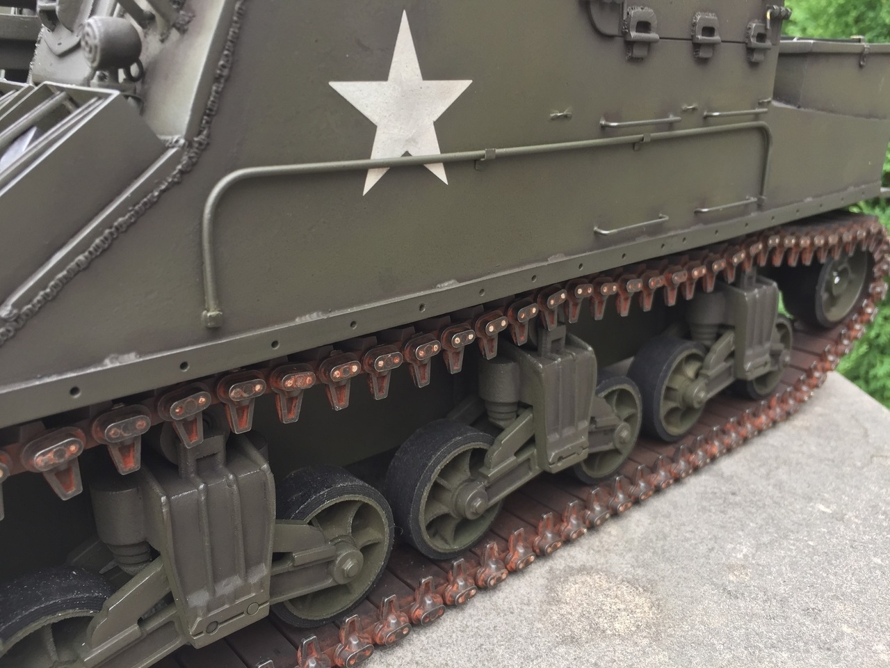

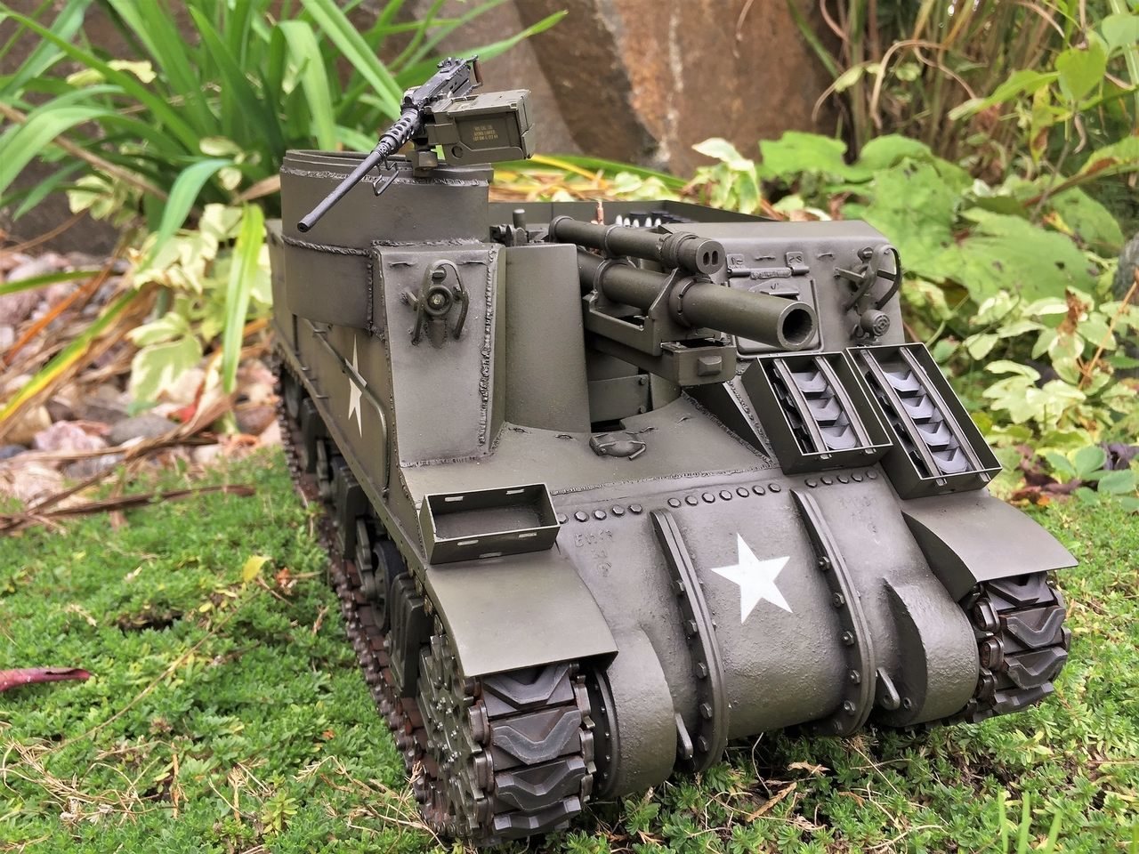

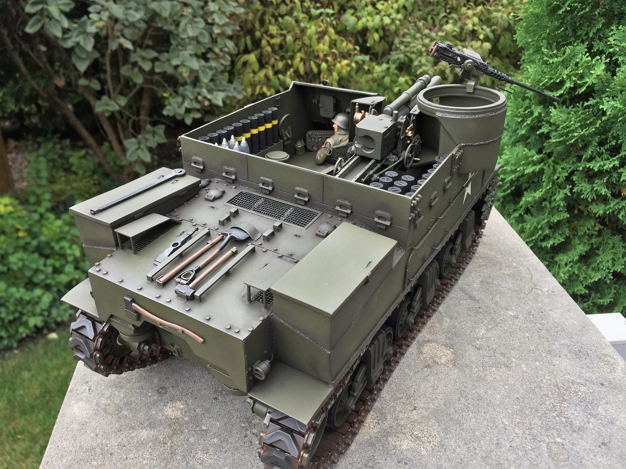

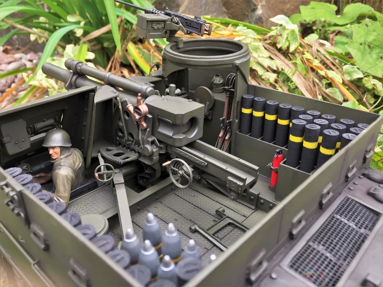

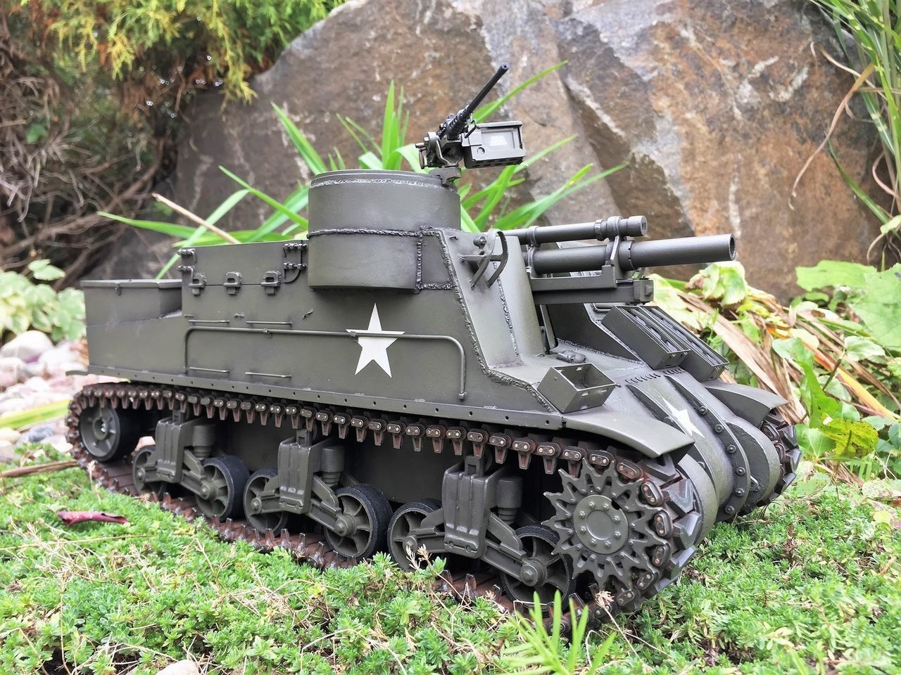

At this point, I went as far as I could with the material I had. I still have a few items in the mail and I will post updates later once I get them and have installed them. The model is not finished yet, but almost.
The proportions (gun vs hull) of the Vandra kit are reasonable and the model seems well balanced. However, rivet counters like me have noticed that the hull is a few mm too high. It would be too complicated to fix that.
The M3 suspension is properly visible in this shot below. Rear idler is temporarily installed as I am expecting a surprise from Sassgrunt...

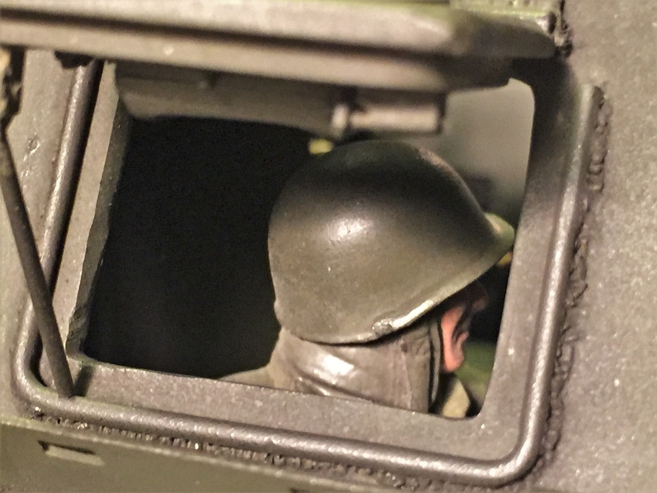

The driver position looks good.
This is the frame for the tarpaulin made of brass, installed on each sides. I never saw a wartime picture with these installed on top of the vehicle so it seems it may not have been too popular in the field. Likely used during storage only.
It is unclear for me if the installation arrangement for the side skirts were actually present on the Mid production M7. Many wartime pictures show these on the late and M7B1, but no clear pictures of them on the Mid version. I decided to leave them on because they look good and it is realistic that they might have been applied later by field depot.

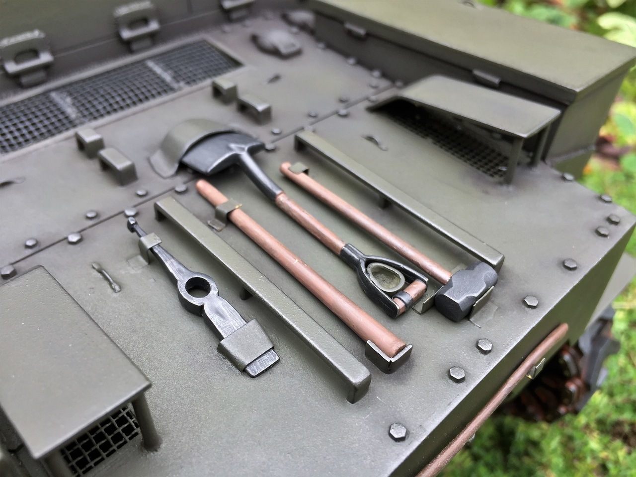

Tools are installed, mixtures of items from the spare box, mostly from Tamiya Sherman.
Spare tracks are on.
Now getting ready for the next project, to be announced soon.
Regards, Louis
