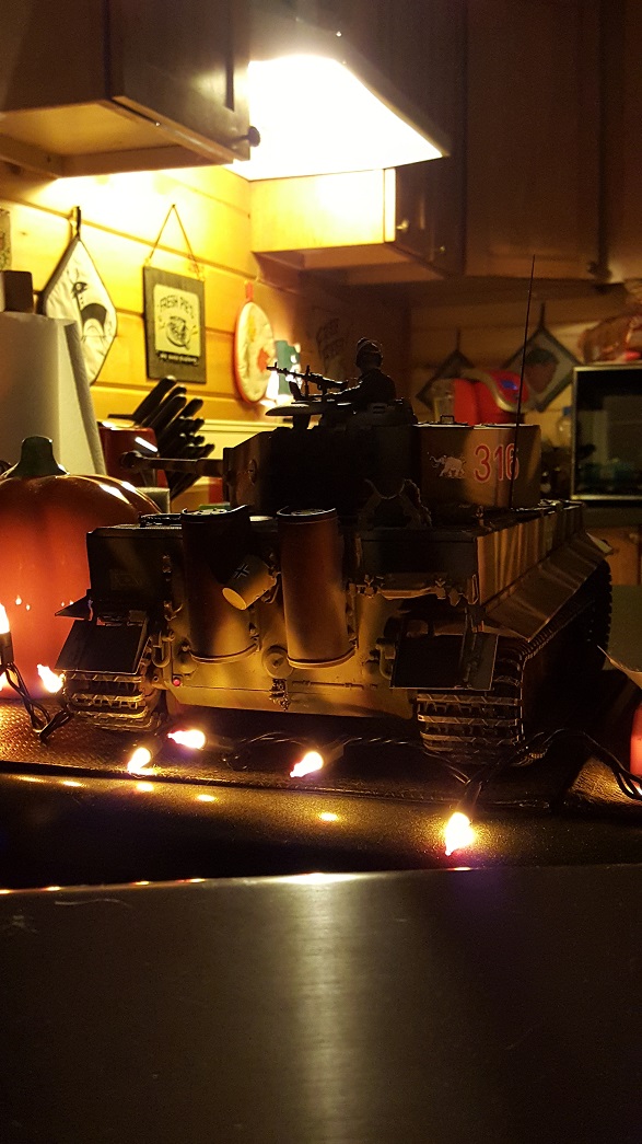

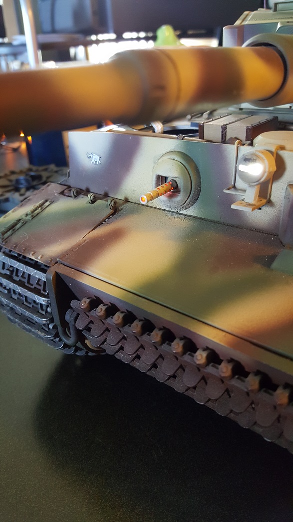

Lights on while the bow MG doles out some lead

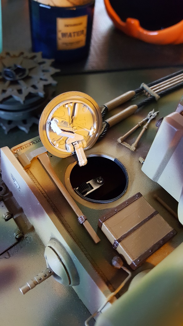

Hatch arm repaired with pin and bracing

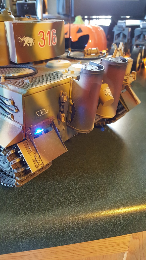

Convoy wiring was kept in the lower hull by connecting it to a servo plug and using channel 7 on the RX

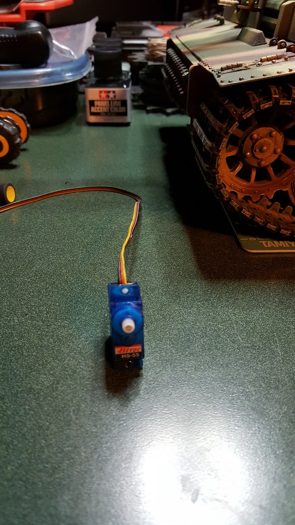

One of the original Hitec servos that packed it in all in one evening

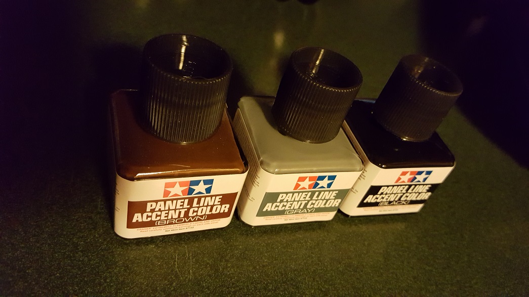

I had been getting mixed results with this setup and wanted to try the Tamiya product.  I had heard great things and am happy to report that they are true.

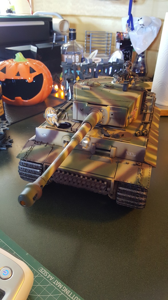

10.29.2017 COMPLETE!!!

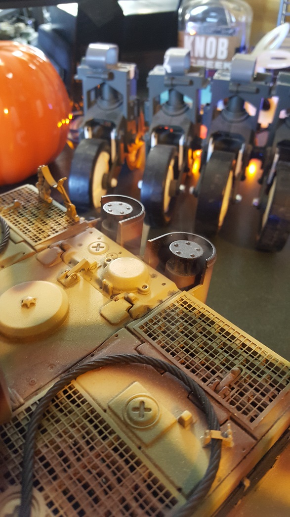

Interesting orange lighting effect on the rear armor plate.

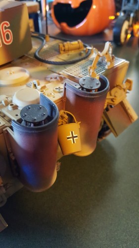

A closeup of side B of the must-have German bucket!
