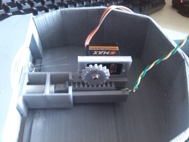

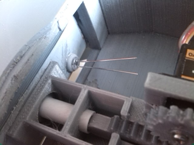

Decided to have a go at a geared recoil instead of the usual set up using arms and bits of wire. The amazing thing is that it works! lol. Should be a lot more reliable too. I made it as small as I could as there isn't much vertical space to play with in there. Cost about £0.30p to print?....but a few hours to get the design right.
Also added an IR emitter holder that will allow me to pull out the led in the unlikely event that it fails.
Muzzle flash led installed.
Turret rotation motor installed and tested, that all works, thank goodness.
Just need to lock the barrel elevation level, or install a mount so that I can use a servo.

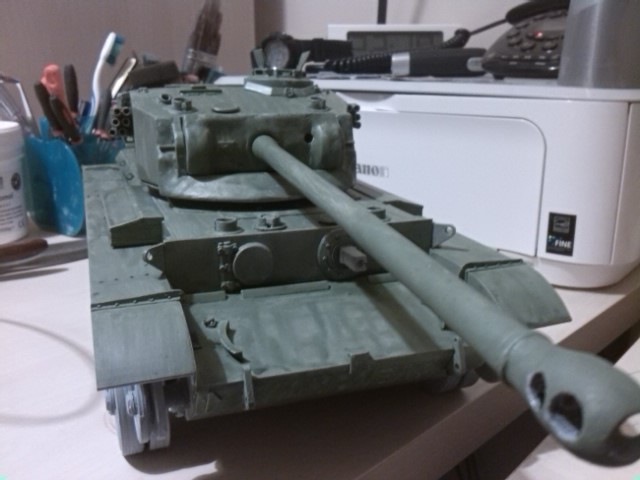

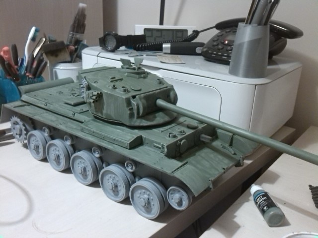

Managed to make a kind of ratchet system to keep the barrel where I leave it, I can clamp it solid when everything is completed and I know where 'level' is. Started giving it a brush over with a green/matt varnish mix, just so that I can see the last of any gaps.
