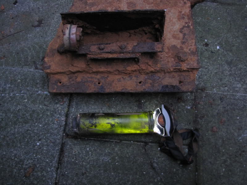

RESEARCH
RESEARCH
RESEARCH
RESEARCH

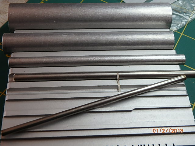

PLAN ON USING THIS PAINT BRUSH COVER AS MY LENSE, BECAUSE THE ONE THAT COMES IN THE WECOHE KIT HAS TO SMALL OF ID TO FIT THE SMD LED'S.
CUT TO SIZE
CUT TO SIZE

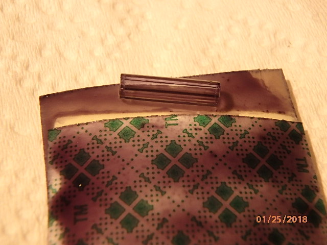

GOT SOME TESTORS LENSE TINT TO DARKEN UP THE LENSE
1st COAT OF TRANSLUCENT LENSE TINT.

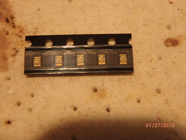

THESE ARE TINY LEDS!!
SMD LED'S FROM ELECTRONICS STORE
MAKE SURE ARROWS ON BACKS OF SMD LED'S ARE POINTING IN SAME DIRECTION FOR CURRENT FLOW.

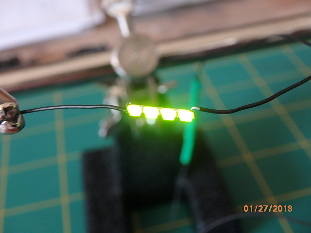

ALL SOLDERED IN SERIES

GOT THE WIRE LEEDS SOLDERED AND A 100 OHM RESISTOR...WE HAVE LIGHTS!!!

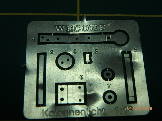

HERE IS THE PE DIRECTIONS FOR THE WECOHE KIT
THIS GONNA BE FUN!!
THIS GONNA BE FUN!!

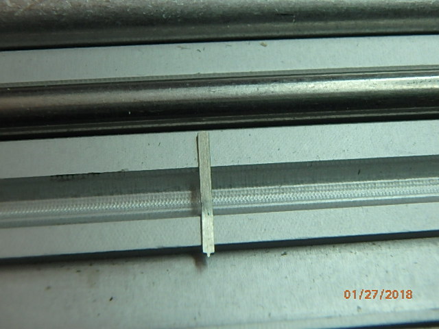

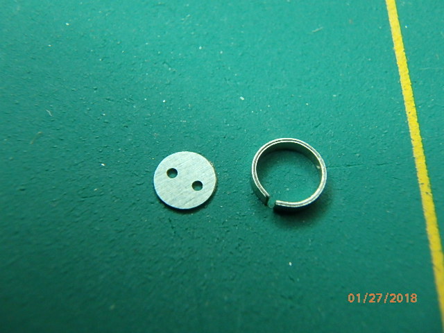

BENDING MAIN FRAME IN BRAKE
ROLLING SIDE STRIPS IN PE ROLLER

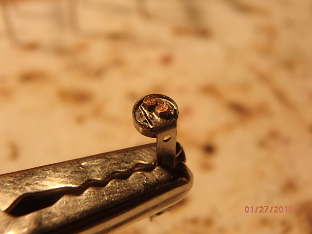

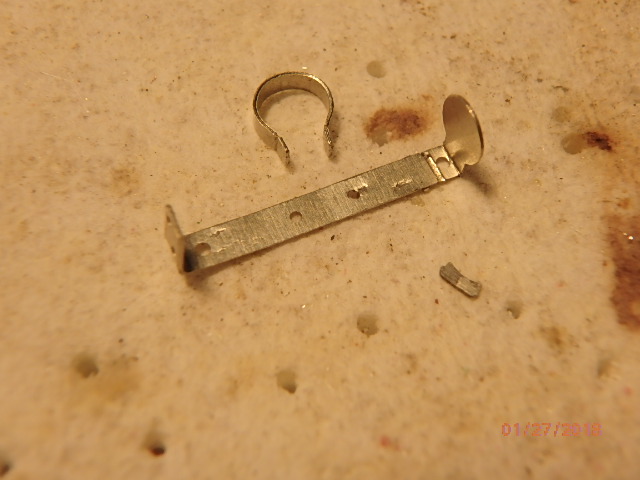

READY TO SOLDER FIRST PIECES

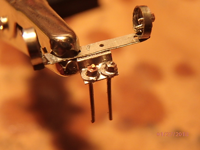

SMALL LENSE CRADLE SOLDERED IN PLACE ON BACK FRAME

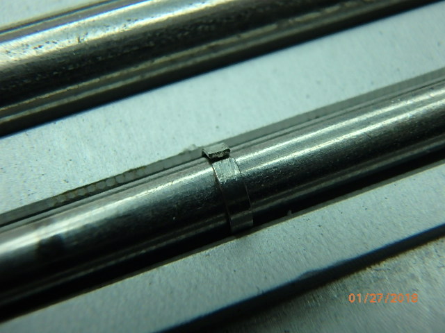

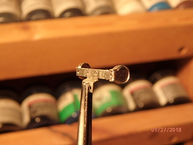

END STRIP IN PLACE
END STRIP IN PLACE
BENDING OTHER SIDE STRIP
OTHER SIDE PLATE AND SRTIP READY TO SOLDER

READY TO SOLDER OTHER SIDE, HOPEFULLY WITHOUT STRIPS FALLING APART
LOST TINY END BOLTS, HAD TO LOOK THROUGH MY STUFF AND FOUND THESE. THEY ARE TO BIG, BUT OH WELL...

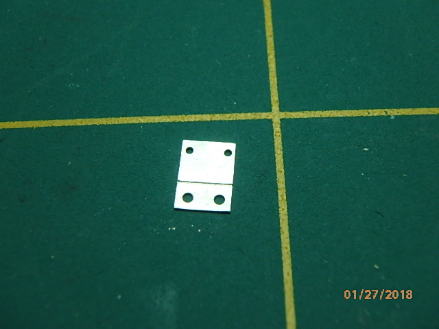

READY TO BEND MOUNTING PLATE

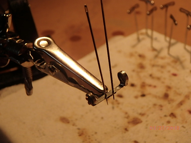

USING SEWING NEEDLES TO HOLD MOUNTING PLATE TO LENSE FRAME
TIGHT
TIGHT

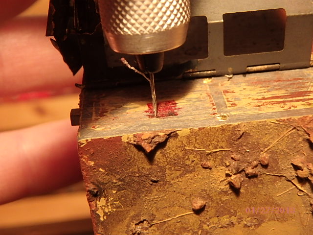

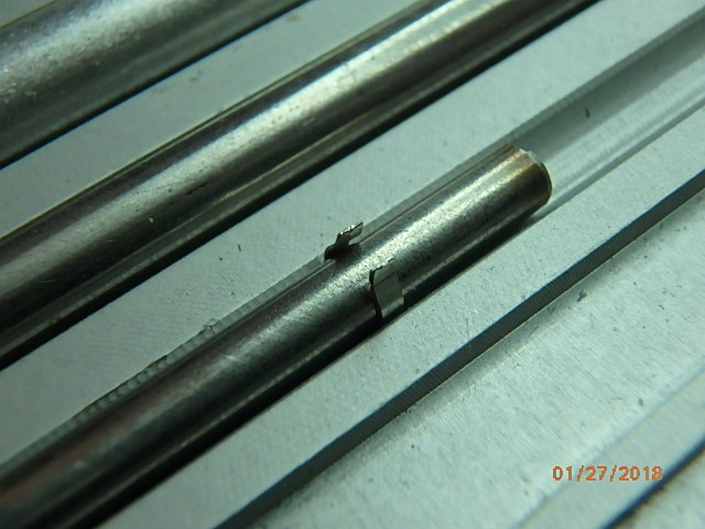

DRILLING MOUNTING HOLES. WILL USE EXTRA LONG BRASS RODS TO GO THROUGH THE REAR HULL.

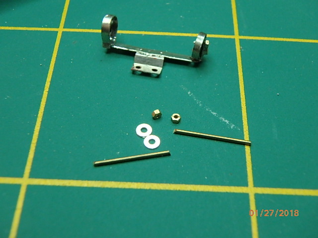

BRASS RODS READY TO FAB UP WITH WASHERS, &amp; NUTS
BRASS RODS READY TO FAB UP WITH WASHERS, & NUTS
