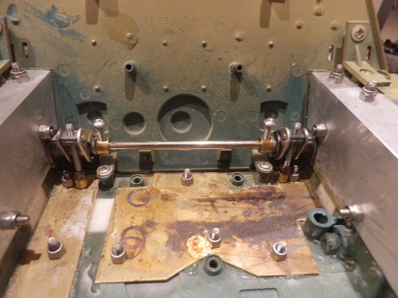

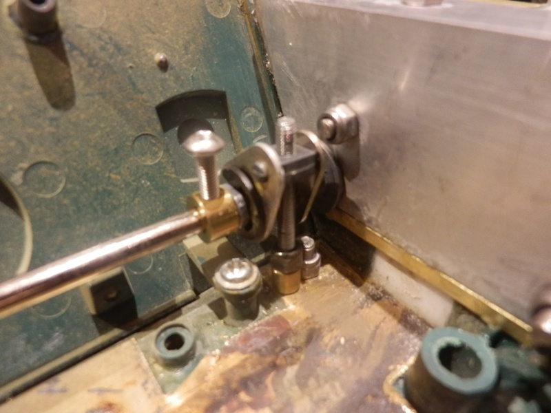

Its in
Looks a bit agricultural at the moment, but it works.
No slop, and the adjuster is going to allow all the variation I need to cover for the extra length in the lower hull.
All thats left is to get 2 lock nuts for the top of the adjuster bolts, and set the idlers in place at the correct width.
The standard idler axles are way to long and the smaller diameter that normally would be secured by the infamous E-clips is to small for the new arms.
This can be sorted by replacing them with bolts that have the thread cut off and the arm grub screws clamping onto the remaining shank of the bolts.
No big thing.
Once the back end is done, I can install all the running gear & get er moving.
No big thing.
