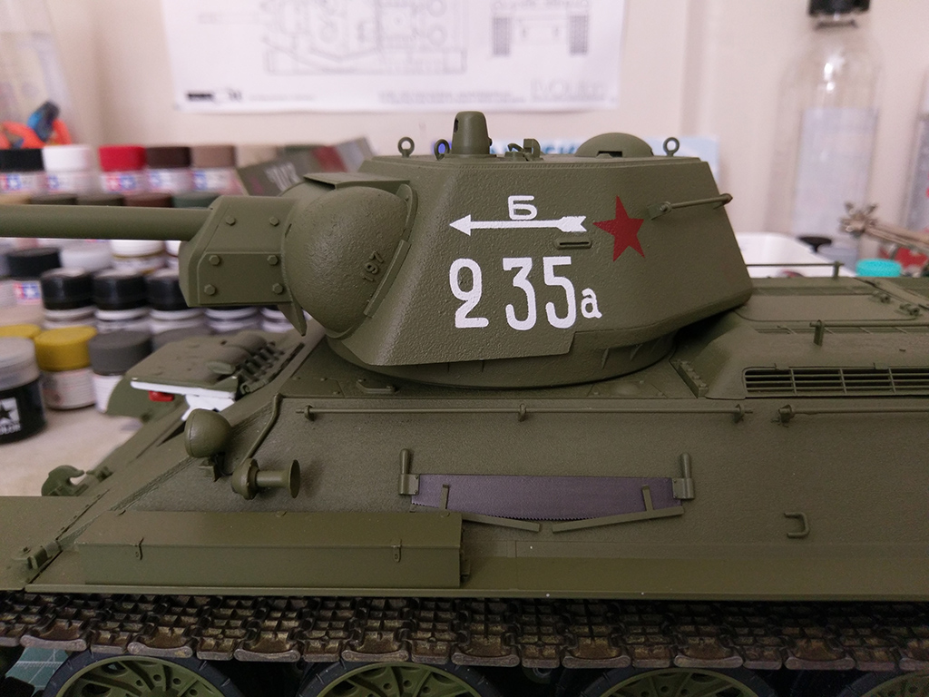

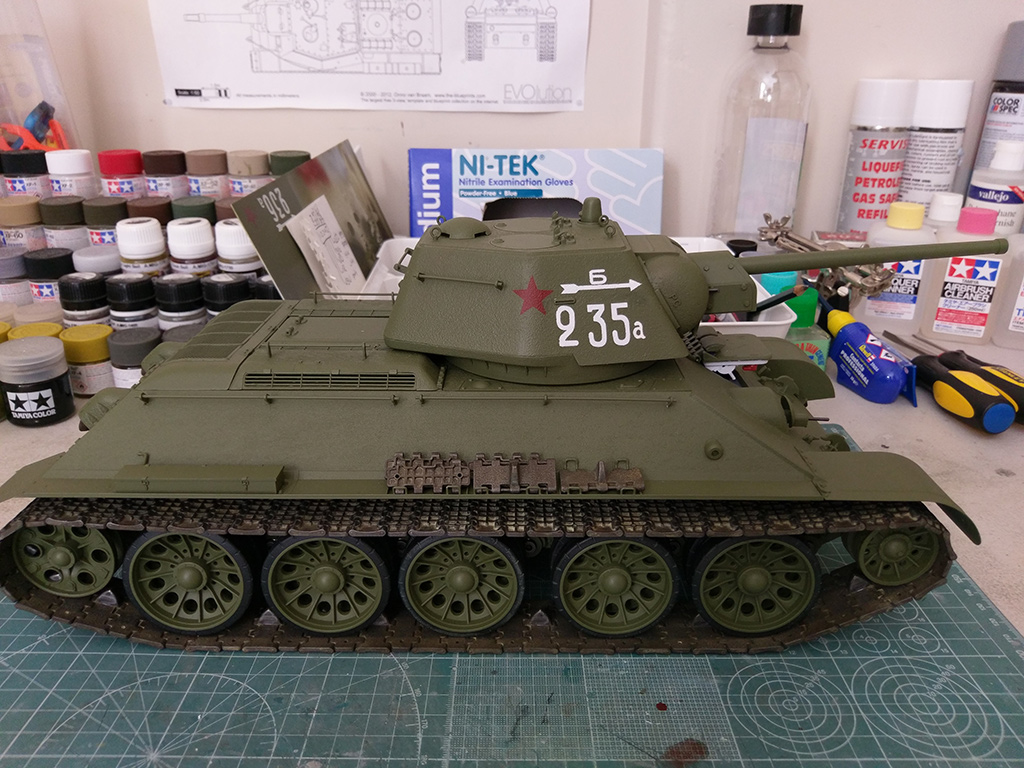

I spent some time this week sorting out the markings; they'll need to be toned down a little when I get around to weathering, but otherwise I'm pretty happy with how they turned out. My first attempt at using a paint mask, so there were a couple of rough edges that needed to be touched up with a brush. You need to be looking for it to see where I've done it, though.
