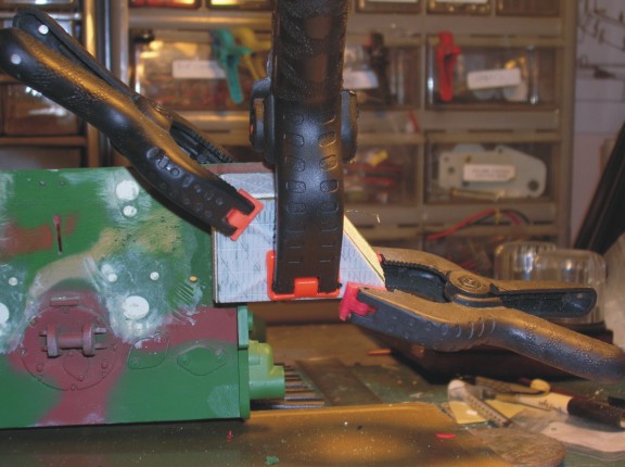

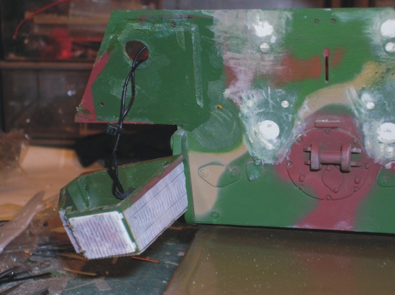

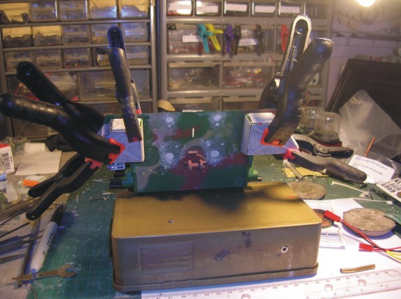

First laid up the storage bins on the back of the tank. I have the convoy light wired so drilled the hole out and set it up
Panther A 179.jpg (51.02 KiB) Viewed 4188 times
Then using Bob Smith Plastic Cure glue, (the best I know of) and some heavier clamps tacked the boxes on.
Panther A 180.jpg (58.45 KiB) Viewed 4188 times

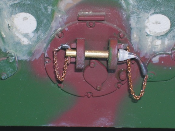

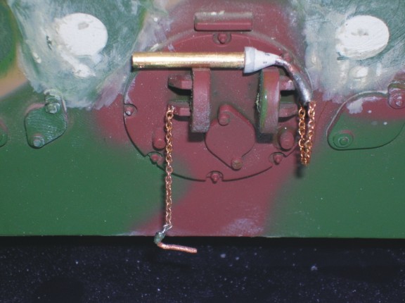

Well those dried and hardened thought I would tackle the towing pintle. The one that's modeled on the HL seems to be modeled on the "A" at Munster. So I started fabricating that from a reference book that Hotte sent me (thanks buddy!) and this book has been invaluable in planning and building this project. So spent a couple or 3 hours doing it it up BUT, from what I can tell this is not the correct one! The more I looked at other reference the more I realized at least for the "A"s, this is not the correct one. So I used some online illustrations and my Panther in Detail by Culver & Feist. A great reference book to start over :crazy: and build the one I think is more accurate.
And here are the results! Brass pipe, some putty, little chain and copper itty bitty drill bit a little solder and about 3 hours work!
Panther A 182.jpg (52.06 KiB) Viewed 4188 times
Panther A 184.jpg (49.03 KiB) Viewed 4188 times

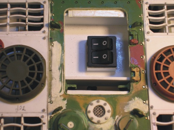

And fitted my power and smoker switch box into the upper hull. Just fitted it, didn't click it in yet!
Panther A 183.jpg (58.71 KiB) Viewed 4188 times
