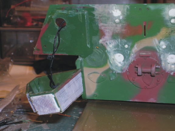

First laid up the storage bins on the back of the tank. I have the convoy light wired so drilled the hole out and set it up
Panther A 179.jpg (51.02 KiB) Viewed 4187 times

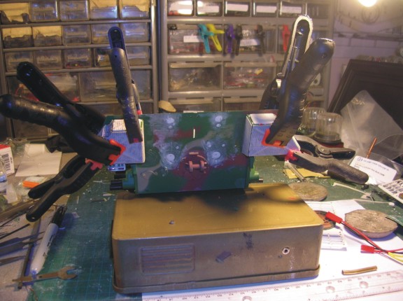

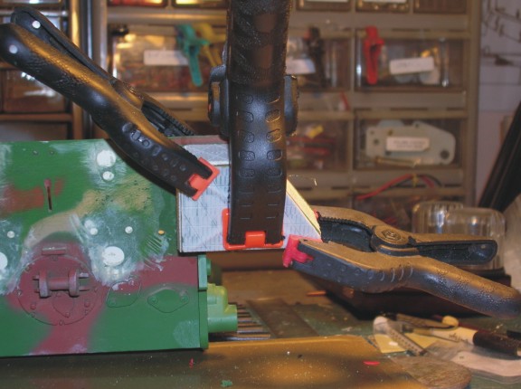

Then using Bob Smith Plastic Cure glue, (the best I know of) and some heavier clamps tacked the boxes on.
Panther A 180.jpg (58.45 KiB) Viewed 4187 times

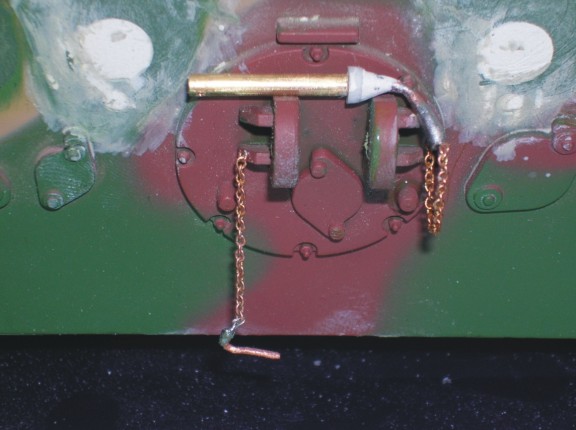

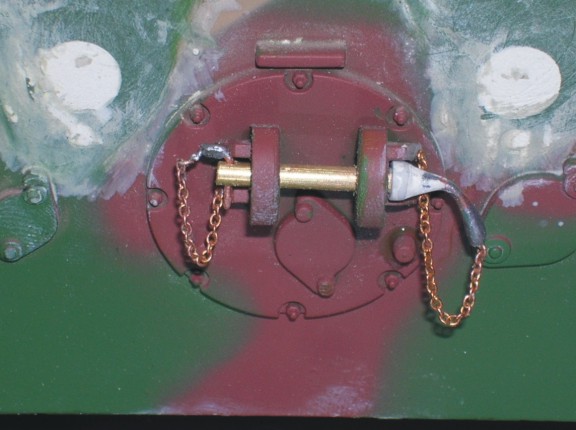

Well those dried and hardened thought I would tackle the towing pintle. The one that's modeled on the HL seems to be modeled on the "A" at Munster. So I started fabricating that from a reference book that Hotte sent me (thanks buddy!) and this book has been invaluable in planning and building this project. So spent a couple or 3 hours doing it it up BUT, from what I can tell this is not the correct one! The more I looked at other reference the more I realized at least for the "A"s, this is not the correct one. So I used some online illustrations and my Panther in Detail by Culver & Feist. A great reference book to start over :crazy: and build the one I think is more accurate.
And here are the results! Brass pipe, some putty, little chain and copper itty bitty drill bit a little solder and about 3 hours work!

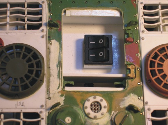

And fitted my power and smoker switch box into the upper hull. Just fitted it, didn't click it in yet!

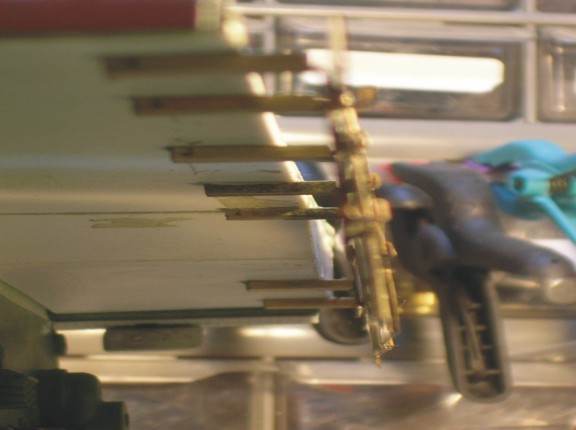

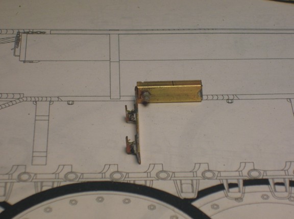

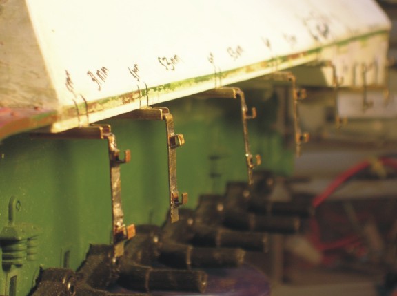

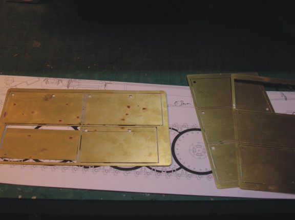

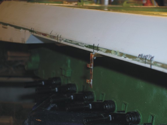

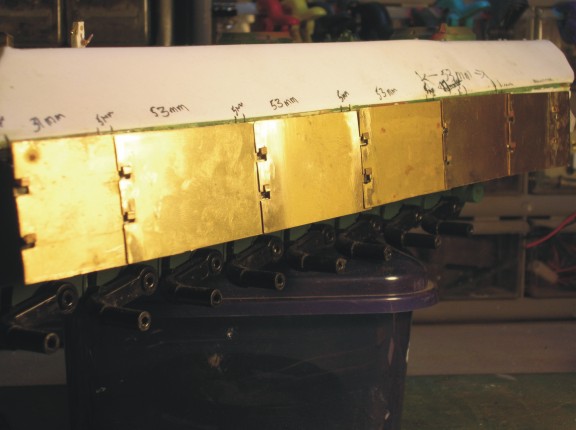

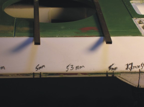

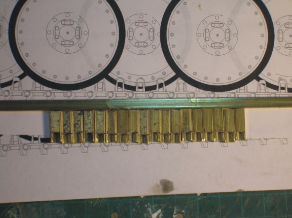

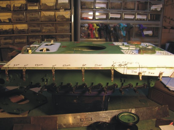

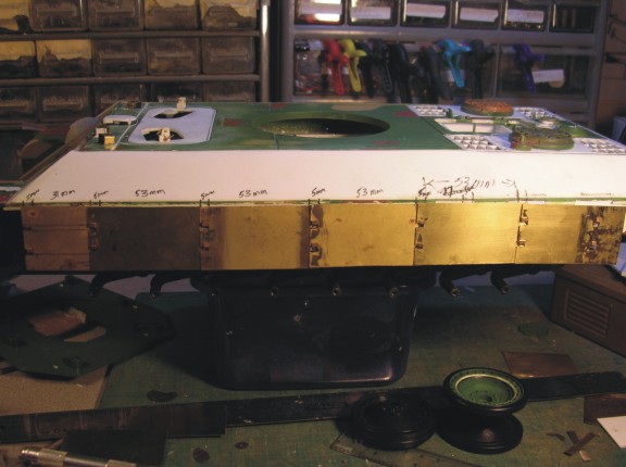

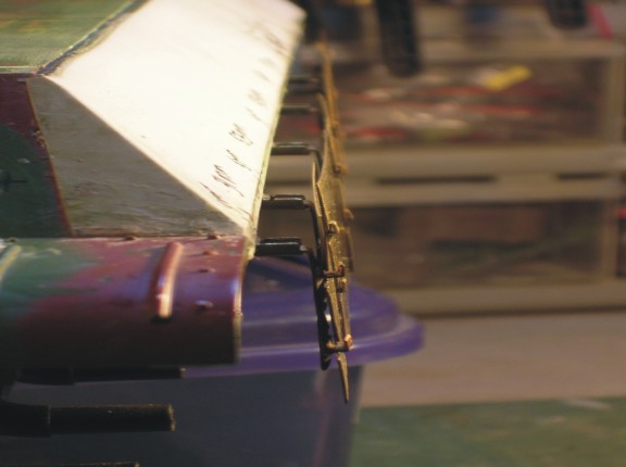

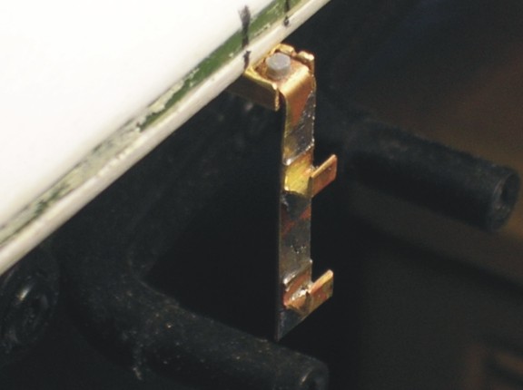

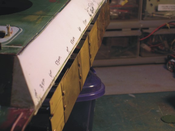

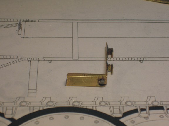

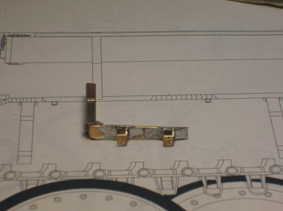

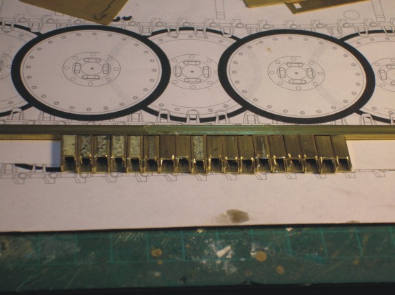

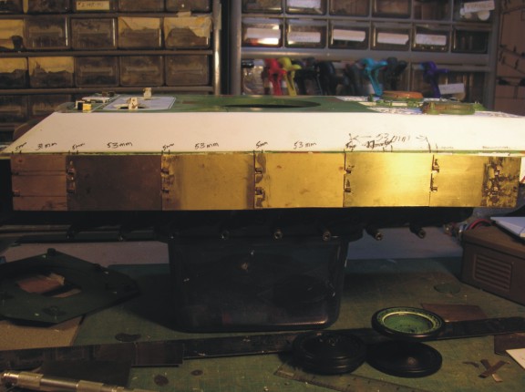

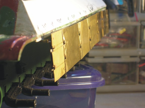

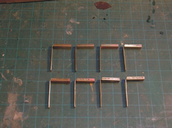

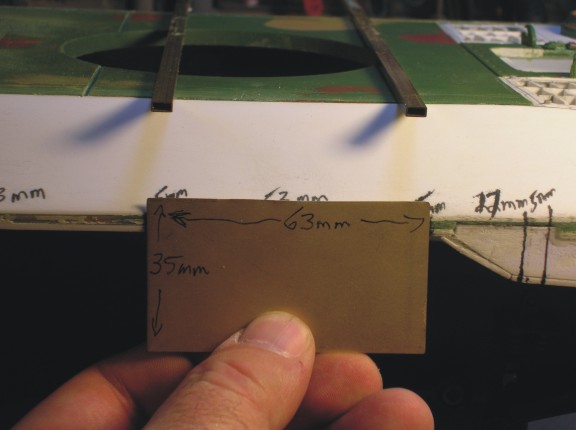

working hard on the next big thing to do on this tank and it is painful to the extreme... I wanted to add the Schürzen skirts to this tank, oh boy, more scratch building. I should mention I don't have any fancy tools, drill press, lathe, stamping equipment, etc... Just my exacto, dremel, the basics so these will look a little crude but 20 feet away on our battlefield won't matter. Plus they will be functional and I hope fall off on occasion just for fun! :D
So I will let the pics speak for themselves. Using my line drawings and pics from assorted sources I used brass rectangle and square tube, and impact skirts meant for the Tamiya "G" model cut down. You can buy these really cheap as they have cosmetic blemishes but won't affect the final look of course.

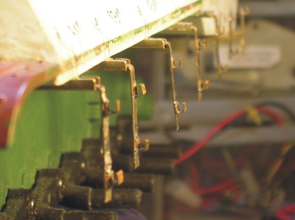

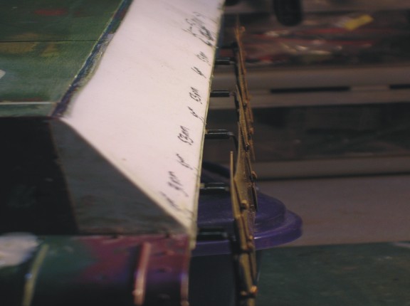

And here are some more. AA LOT of adjustment as I went along and still have some to do but I like the look of it so far...
Panther A 196.jpg (55.81 KiB) Viewed 4160 times
Panther A 197.jpg (57.01 KiB) Viewed 4160 times
Panther A 198.jpg (51.87 KiB) Viewed 4160 times
What I did was slide the arms into the bracket and soldered at the back. What this does is create a sort of spring effect that lets the arms move around but are very secure...
