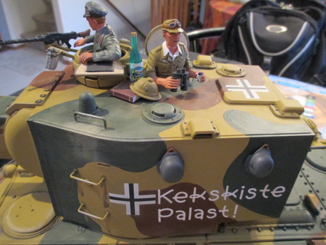

Your paint didn't turn out badly at all. *chuckles* See, I'm a fan of the style:
P.S. Thanks for the quick and dirty How-To on the track rust products. Those tracks really turned out sweet.

Posts: 7686
Re: My first tank build.
Jack,
The Commander is an old HL figure. The Gunner is a combo resin\metal figure from rctank.de. Their Afrika Korps tanker. Thank you!
