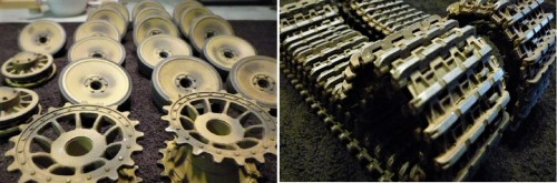

Although the drive sprockets and rear idlers are metal, the road wheels are the original Heng Long plastic fitted to the tank out of the box, they will be swopped out for Metal road wheels with rubber tyres. Same goes for the tracks, currently these fitted are "early" style metal tracks which on the real Tiger 1's from October 1943 onward were re-modelled to include cast Ice cleats in the cross bar rather than bolt on extra cleats at each end. So I will need to purchase a set of Late style metal tracks to complete the running gear.
Plastic original road wheels and early style tracks. Click for larger image

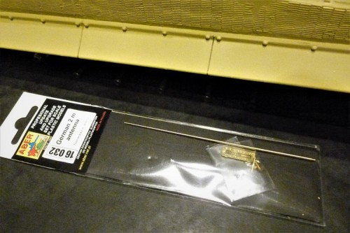

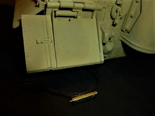

Managed to pick up a correct scale 2metre aerial for the right hull aerial socket. The Reference is Aber 16-032, this will be fitted last in the build.
Aber Scale aerial in brass. Click for large image

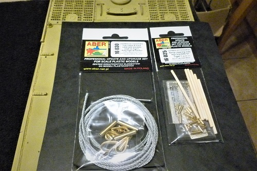

Picked up from a model fare for a bargin a few years ago, these Aber sets for the Tow cables (16-030) and the gun cleaning rods (16-025) should keep me out the pub for a while. will be intersting to see how they are put together as some features are brass proto etched parts for the clamps. Another first for me :S
Aber Tow cable and gun barrel cleaning set

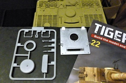

Now this bit gets interesting, while I was scanning ebay I came across a few items up for sale made by Hachette Partworks Circa 2010 . These as many know were a 140(ish) part weekly issue magazine build for a 1/16th scale Tiger Late model. Some of the parts can be integrated into the Heng Long Tiger Mid-Production very well including this Late model engine deck with all the bits in the right place ie... locking latches in front of lifting handles not under them, correct shape engine vent cap lug and holding latch in correct position more to the right. Comes with Mid-Late air intake more to scale (ish) and as a bonus you can make it an opening engine deck if you use the hinge peg lugs. Earlier In this build I re-modelled the engine deck to replicate a Mid-production example, this Hachette can be grafted straight in with the same basic level of build skills that i have, I would say it is a simpler fix. This was issue 22, not bad for £5.00 inc post (6 Euro/ $7)
Hachette Mid - Late engine deck set Issue 22. click for larger image

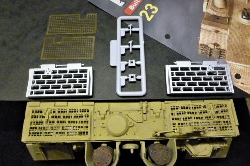

Also picked at the same time were these Hachette metal radiator grill covers with working latches Issue 23 Ebay £4.50. You could make these opening to place switches under them in a similar way the on/off switch are under the front opening hatches. I dont think you could have both the opening Engine deck AND the Opening pair of radiator grill covers as they would take too much material out of the hull top..but Im working on it B| , will be giving it some thought, have this idea of a dummy engine when opening the engine deck and dummy radiator & fans which are actually switches ?? Hmmmm.
Hachette opening Radiator vent grills and latches. Issue 23

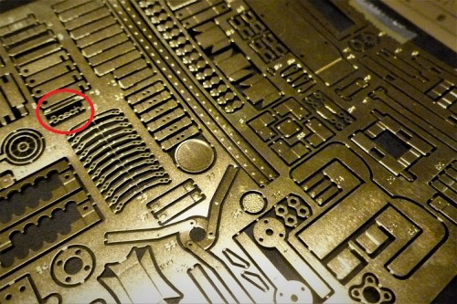

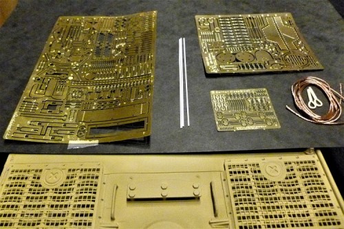

Oh and proof that you should not go internet surfing with a credit card and a tummy ripe with Whiskey... Voyager Brass PE set. Purchased for the Tool clamps initially but the more I look the more I want to make. The real fine scale Mid-late air intake looks promising as does the jack assembly, I just need to learn how to hold my breath for 2 minutes again oh and definately an alchohol free zone !
Mid Production Brass photo etch set 1/16 from Voyager. Click for larger image
Even Bosch lettering for the single headlight. how cool is that ! Click for larger image

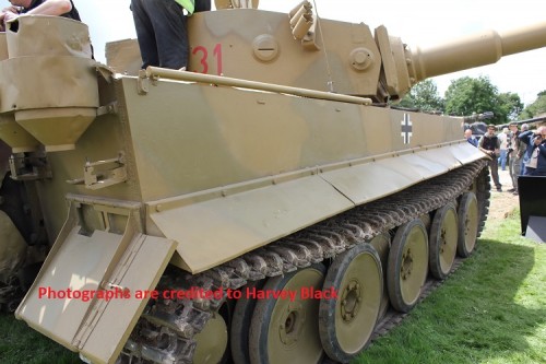

One last change is... I discovered only recently something I had overlooked...the aerial tube on the right hull should be slightly raised above the deck. So jarndice thank you for pointing this out, re-built it will be.
How the aerial stowage tube should look like,raised slightly above hull. Click for larger image

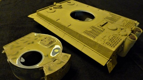

This Turret will be fitted with Zimmerit from the Atak's Tiger 1 Mid-Production Kit. IMHO with the horizontal split in order to separate the HL Turret in two halves you simply wont have many other choices. It will also make fitting the Schumo Turret track holders a lot easier, I have seen a few comment's on the use of Atak Zimmerit which IMHO are mis-placed, as the saying goes, necessity is the mother of invention.
Atak Zimmerit Kit. Click for larger image
