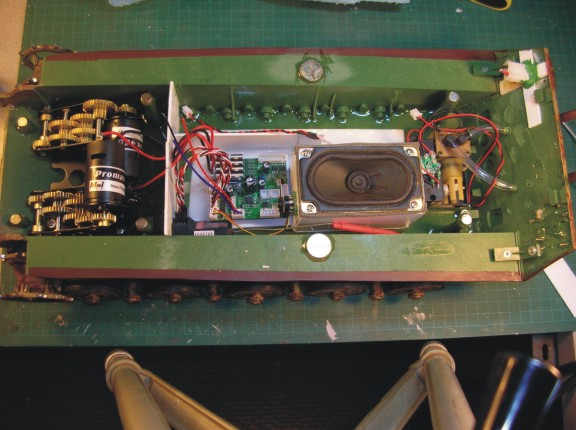

So, to the order of business... first up was gutting the interior of the lower hull with the main thing being removal of the battery box. Once this was done a couple of pieces of styrene were cut and fitted. This was the engine firewall, battery compartment, and the hole where the battery box was. and then 2 part epoxy was used to seal around the styrene and back hull seam and front engine firewall styrene. Next to create a nice smooth floor to work on I use 2 part resin but not like the resin you get in our kits. This is tough and hard. This reinforces the hull really well and is relatively cheap to use. For $25.00 I did 2 WSN T-34/85's and 2 HL Panther G's the same way.
Next was test fitting/installing all the components going on the floor beginning with the motors and gearboxes then making the cushioned mount for the Clark board, and mounting everything else.

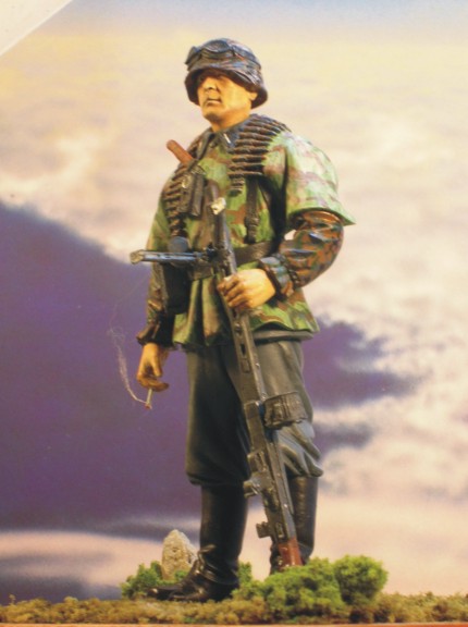

I also did an MG42 gunner for Michael and can't resist showing it off!
Lots of fun doing 2 different camos!

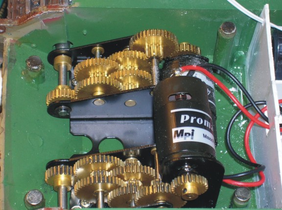

New 480 motors and Walterson gearboxes were put in. These are the new Walterson's with the stainless steel shafts. Again these are from Immortal Hobbies and actually were quite reasonable and WOW!
what a difference operating!!!
Since the is the King I wanted to improve the sound so I custom made a styrene sound box sealed it up real good and put in a 4OHM 20 watt speaker. This sucker is LOUD! Has to be because those Waltersons are a noisy pair!
Last pic is everything in place and plugged in to hull top and turret.

time for an exhaust change ... the one you have is a little rusty
and keep an eye on that gunner...his cigarette is getting awful close to burning his hand
- dgsselkirk
- Posts: 1510
Re: Old Modeler, new R/C KT build
What makes you think it is a cigarette?

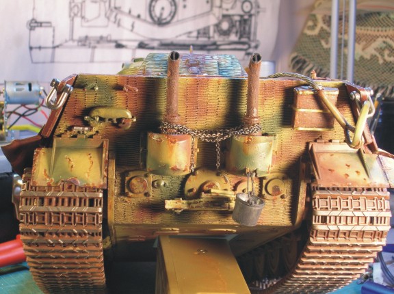

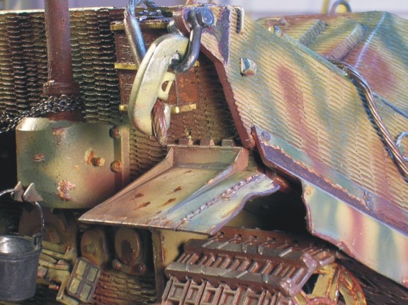

A little more detail work done. Thinned out the rear fenders more to scale (still a little thick but this is a fighting tank) Decided to break off one side just for asthetics. Put the exhaust pipe support pieces into the stacks. Installed the jack. Put some dings and dents and finished up with chipping and rust. Added chains and a bucket and the back end is done!

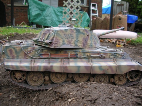

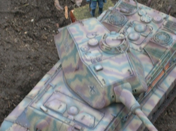

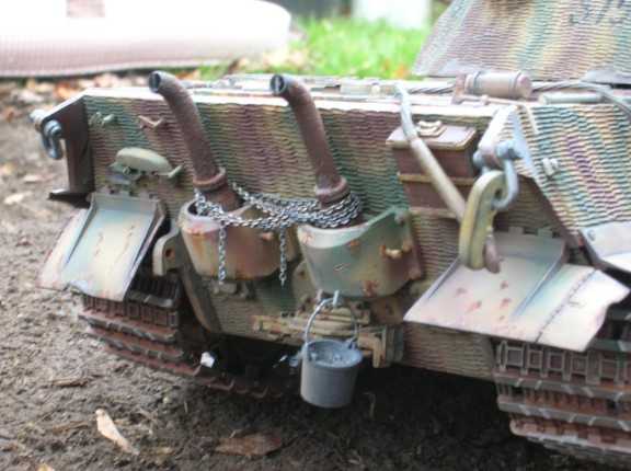

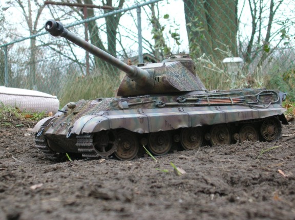

Well guys here is my final batch of shots that I will put in a few posts. ( you may recognize one or 2 from the new KT shots post...
)Everything is done except for a couple of add ons like the antenna, some folded tarps. Everything has been tested and is running perfectly. Had a go at my KV-1 and the clark system with Immortal Hobbies new Tamiya like apple works perfectly.
I want to thank this forum for inspiration, comments and all the help given to me over the past year on this build. My first in RC and my first in 20 odd years!!!
Special Kudos go out to Michael C who helped me with all the electronics, I'm slowly getting it!
I have other projects on the go but won't be doing such an in depth post and maybe no more at all!:
I just wanted to do a detailed start to finish newbie first build on the cheap to see if I could make something interesting. My KT may not be up to rivet counter standards but I like it! And I have learned so much to help me in future builds...
Thanks again everybody!!!

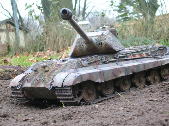

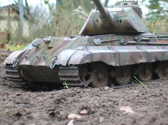

And some more....
